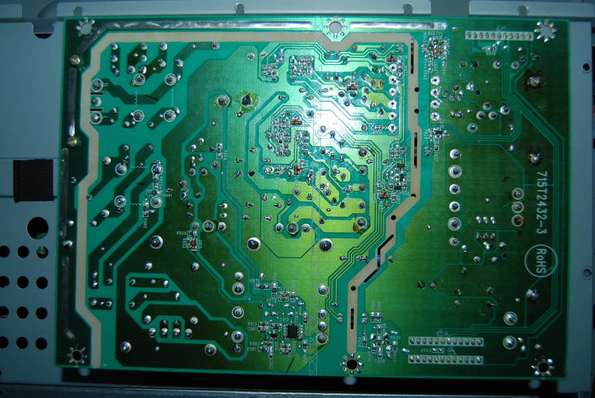

                                  Re: Philips LCD 42PFL5432D/37 - Bad PSU
                                  Originally posted by nuklear
                                  Well here are the pics.
                                  For the 10 inline pics hosted offsite, please read the following
                                  https://www.badcaps.net/forum/showpo...5&postcount=12
                                  for future posts.

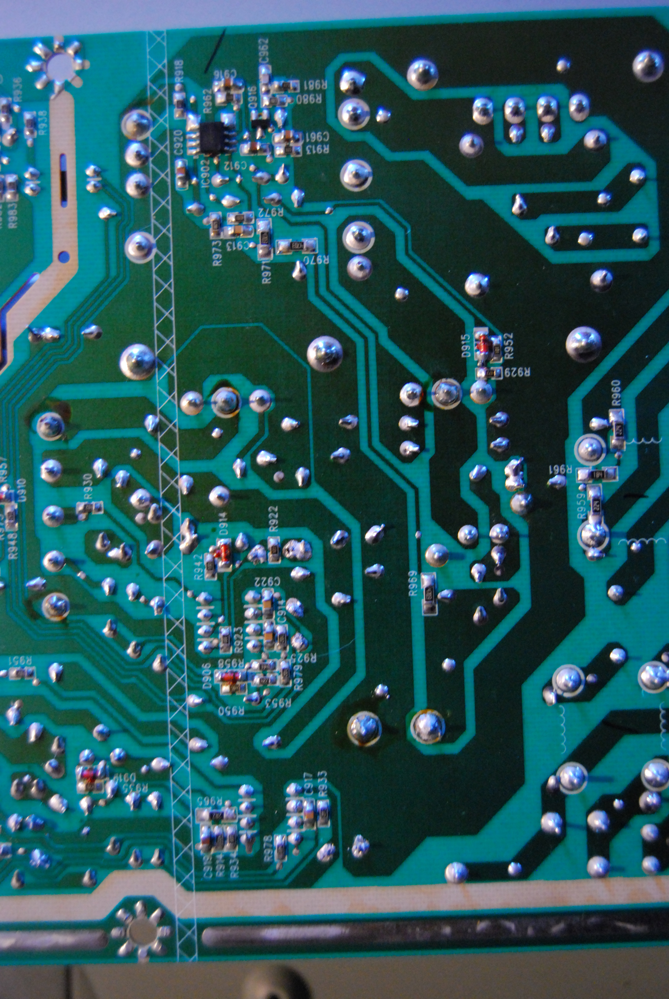

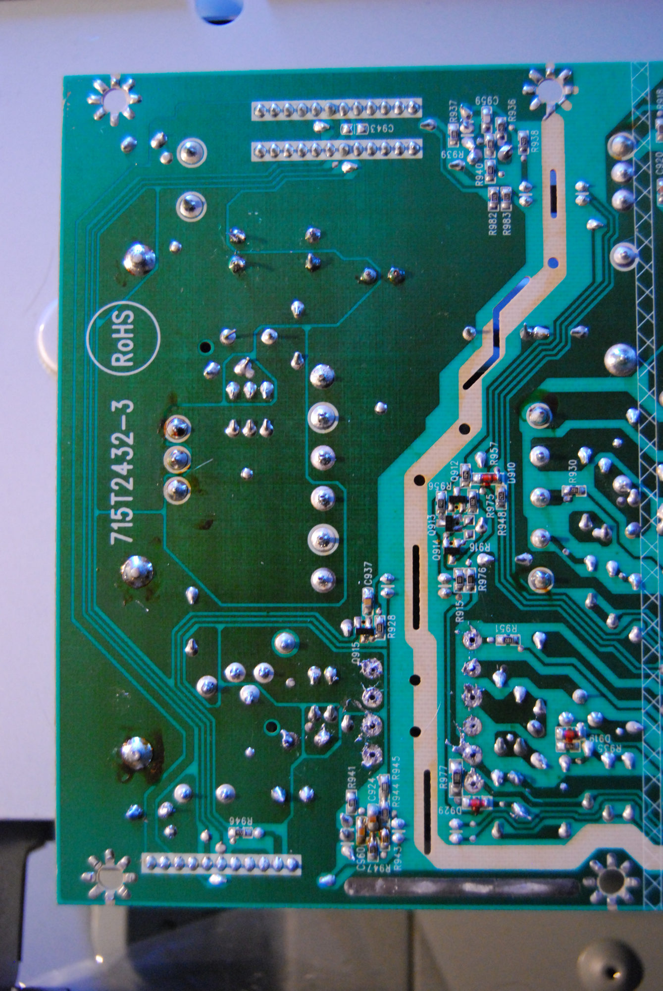

                                    I stand corrected.
                                    As do I. My appologies for wrongly accusing your friend.
                                    Yep, looks like it's time for a new power supply.
                                    ...Or is it?
                                    I've always been a bit optimistic about fixing things, even if they have to be cobbled and kludged together in an ugly way sometimes.
                                    Looking at this power supply, I'm pretty sure we can either wire it to an external power supply or reuse a transformer from another power supply to make it work again.

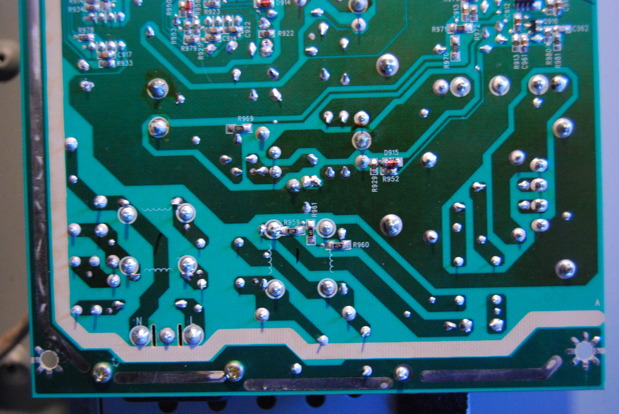

                                    If you want to try any of that, post an overhead picture of the back (solder side) of the power supply so that I can see what kind of transformer and/or voltages this thing might need and how they can be wired.

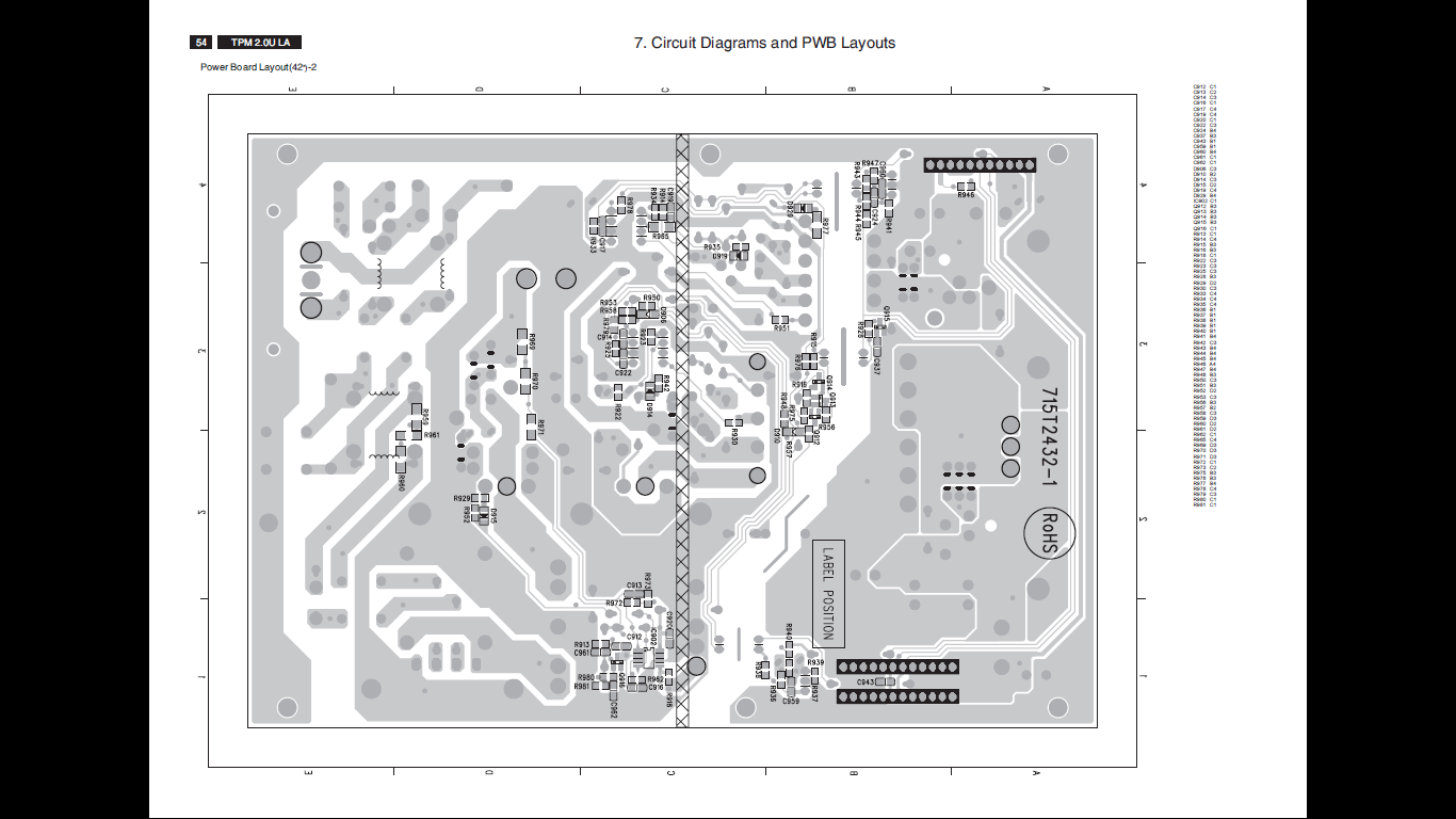

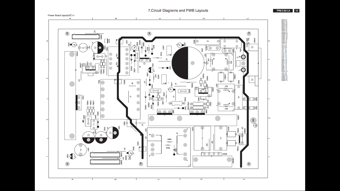

                                      Sorry about the pics, Thanks for the links! I am willing to try anything so here is more pics (hopefully done right this time). I want to fix this for my son as a "gaming tv" so it doesnt have to look too pretty but safe I also have the service manual if that would help.

                                        #39

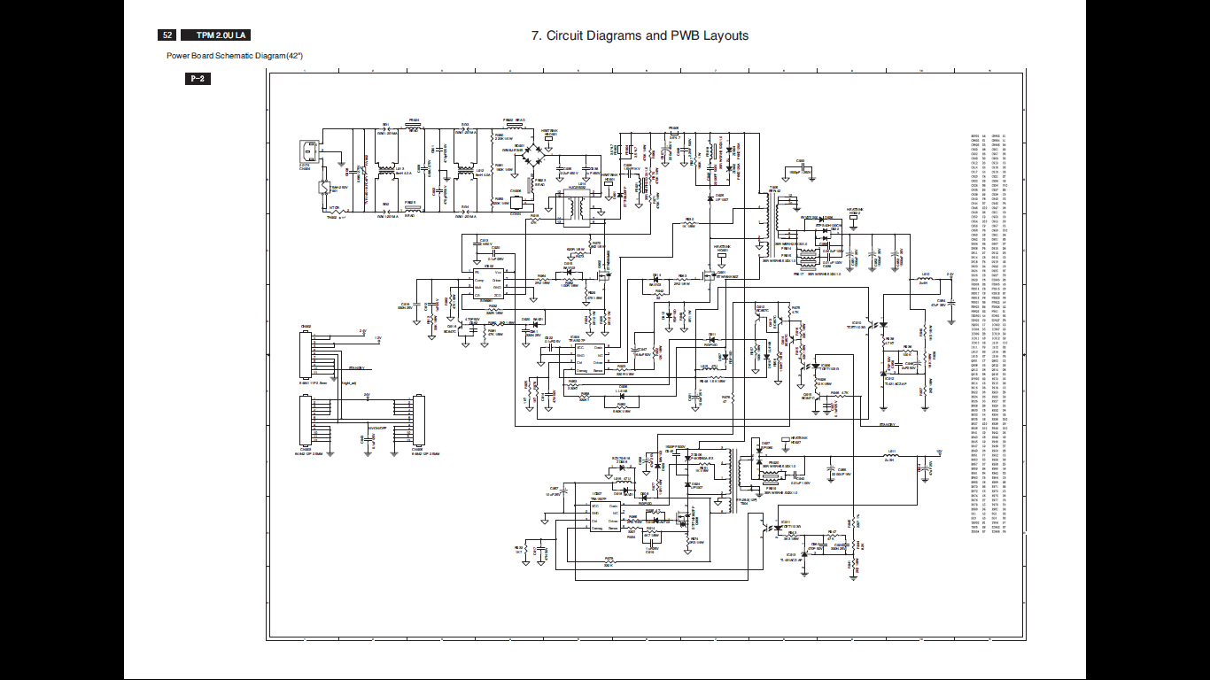

                                        Yeah, it looks like it should be do-able, since there's only a single output for the standby power.
                                        Does the service manual have a schematic of the power supply? If so, this would be very helpful. We need to determine what output voltage is needed for the standby power. If you know how to read schematics, look up the voltages on the connector next to that 16v, 2200uF Rubycon PX capacitor.
                                        Otherwise you can also post the service manual here or just take a screenshot (with Print Screen key) of the power supply schematic and upload that.
                                        Lastly, can you tell me the part number of IC907? Thanks.
                                        *EDIT*
                                        Actually, just post a screenshot of the schematic if possible. I just saw something that needs to looked at in more detail.
                                          I hope I did that right lol. and this is what i seen in the "spare parts list" IC907 9965 000 43345 TEA1507P/N1. Again thanks for helping!
