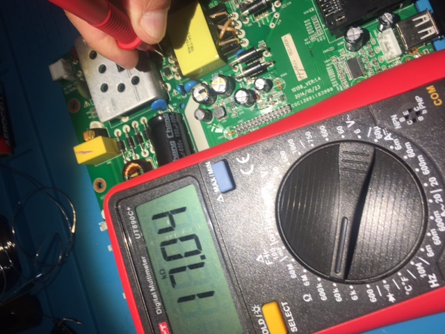

    I understand what you mean but this diode is not conect to the LNK6777E it , the anode goes straight to the transformer and the cathode goes to a resistence that is under the heatsheld and then goes to de 103m blue capacitor thats near the main capacitor

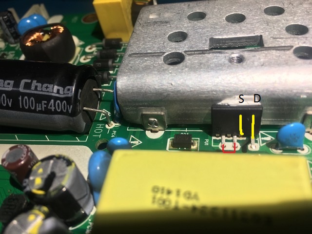

      With no power applied, check the resistance between drain and source of the controller ic. I suspect the resistor under the heatsink could be open.

        Re: NEVIR NVR-7402-40HD-N no standy by light
        Hi R_J i dont know how to check the resistance as i dont know the pinout for the controller LKN7666E
            First you need the correct number of the controller. then you can look up the datasheet.
            you posted : LNK6777E and LKN7666E
            Is it a LNK6777E? if yes here is the datasheet

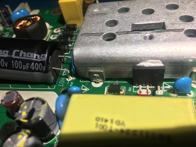

              whit the power suplly off i have the only 2 pins that gave some value is the mark in red
              so the feedback and bypass pin is the only ones that gives some value
              • R_J
                • Jun 2012
                • 9588
                Those are not the pins I asked you to check, Check between pins 5 and 7
                • mi16rs
                  • Jul 2015
                  • 43
                  • Portugal
                  yes i know i have got nothing in those 2 pins 5 and 7
                    Then I suspect the controller might be ok. Check the voltage between the main capacitor negative (HOT GROUND) and pin7 of the controller ic.
                      290v same as iff i mesured the capacitor direct
                        Check the voltage between the HOT Ground and pin 4 of the ic, this should be around 6VDC
                          no , got nothing betewen hot ground and pin 4
                            Check that there is no short between pin4 and hot ground, if nothing is shorted I suspect the ic is bad, the internal startup cell is bad or something inside is killing the 5.75v startup voltage.
                              no no short to ground , i will order a new ic , and let you know , thanks for the help
                                HI,
                                Finaly the Ic as arrived , and the tv is working .
                                Thanks a lot for all the users that help me on this one .
