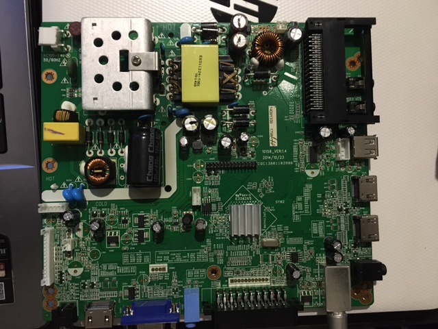

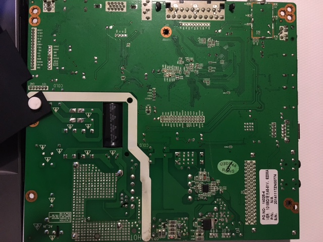

    Hi
    i have a NEVIR NVR-7402-40HD-N whit powersuply board CQC13001103908
    the tv as no stanby light and wont turn on , i find a Diode faulty and replace it but still the same , i dont have any electric schem for it , could some one help me whit this ?

      Some straight on focused pictures of the whole back and of each board would help a lot.

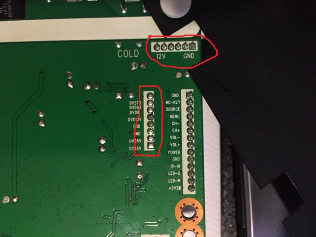

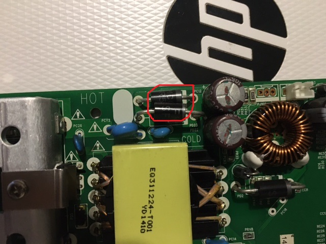

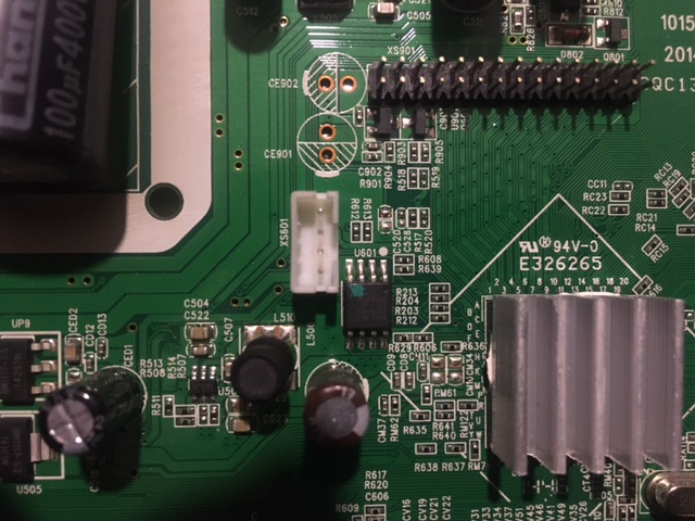

        Re: NEVIR NVR-7402-40HD-N no standy by light
        Hi
        Sorry for the late reply , in attachments are the pictures off the board
        the diods mark in red one of theme was faulty so i replace it but still not work
        i have meseured the voltage on the white conectors and it as no power so the problem on power suply but im not able to manage were the problem is , the main fuse is ok .
        please could some one help me on this ??
            Yes i have measure the voltages on the white conectro that goes to the logic board and i dont have any voltage on it

                  Picture of powerboard isn't very clear, need standby voltage or nothing's going to work, simple things first, test power cord for continuity, make sure fuse on powerboard is ok, if ok, maybe move on to check bridge rectifier.

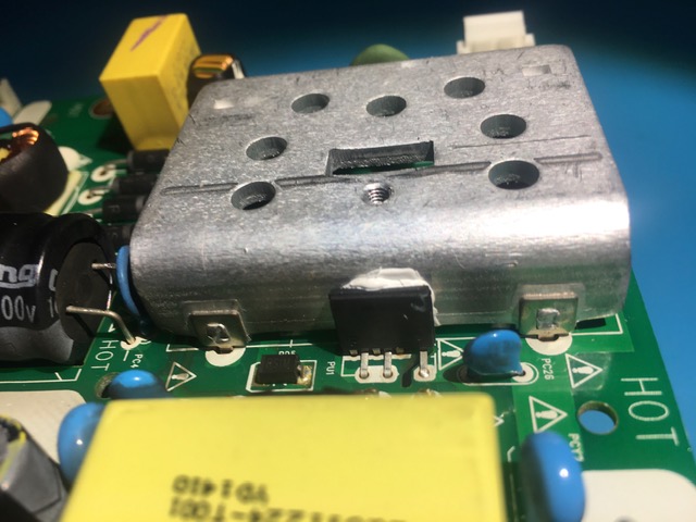

                        Yes i have done that and its all ok , this board as a ac/dc converter LNK7666E but i dont know how to check if this is ok or this is the one its faulty .

                          Can't zoom on picture. Center white connector is 12v? What voltage do you have on main capacitor? Your mosfet on aluminum heatsink has a diode that is connected to drain of your mosfet. What is voltage across that diode?

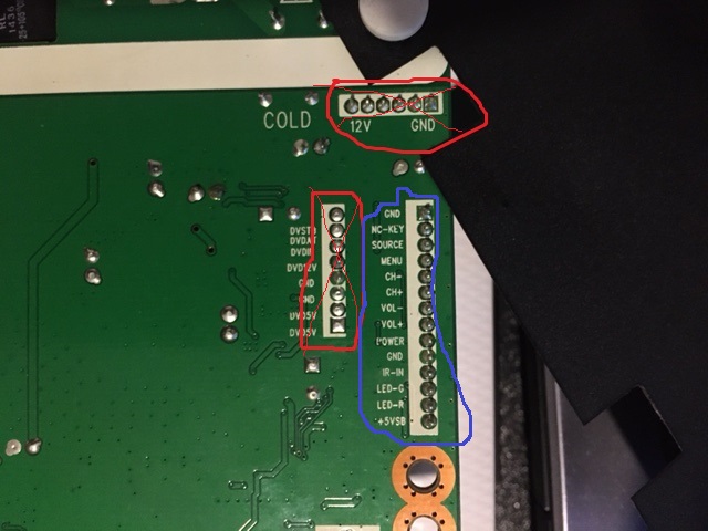

                            only the blue mark conector as the stanby cable on , the red ones does not have anything conected , as for the main capacitor voltage this is a 100uf400v and i read 300v
                              Does white connector in center of board say power upgrade? Your pictures aren't good enough to see.
                                its not a mosfet its a LNK7666E ac/dc converter
                                  see iff helps
                                    Looks like diode next to switching controller. What is voltage across it?
                                    • mi16rs
                                      • Jul 2015
                                      • 43
                                      • Portugal
                                      do you mean the one is mark in red??? puting the multimeter on it in DC does not show any voltage
                                      • dskall
                                        • Oct 2016
                                        • 2905
                                        • usa
                                        If one end is connected to last pin on controller and measuring across diode shows no voltage, then I would say you have bad controller.
