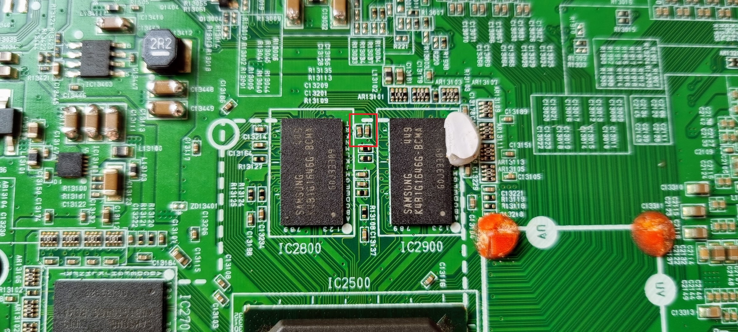

          Removed the heatsink from above IC2500 and the DDR chips

            Re: LG55UB850V no picture or audio - flashing LED's help please?
            align and solder the marked cap

              #126
              OK done
              and I've also straightened out C2348

                #127
                Originally posted by Scoff
                OK done ....and I've also straightened out C2348
                good work.. please after any attempt for repair or corrector you need to test the TV.
                this time if it remain same issue i would like you to feed the tv HDMI signal so we will know if the circuit of HDMI work video and sound.

                  #128
                  Thanks, that tiny cap was tricky with a small basic magnifying glass and a steady hand!
                  OK I plugged the MB back into the TV and still exactly the same behaviour as before.
                  Oddly, I was seeing the LD1900 flickering on and off randomly at first, so I immediately thought "oh no I've introduced a new problem with my soldering"
                  Thankfully not - it turned out to be a bad connection between the LVDS cable and the T-Con board. Fiddled about and unplugged it a couple of times and back in again and now it is working solidly. I've tried getting it to fault again by poking it and moving it a little but it's working fine so must have just been a bad connection.
                  I have plugged an HDMI device into each of the 4 HDMI connectors and the TV displays both video and audio output on all 4 ports absolutely fine - just with the 2 second cycle of buzzing and bad picture still. So the HDMI side of the board seems to be fine.
