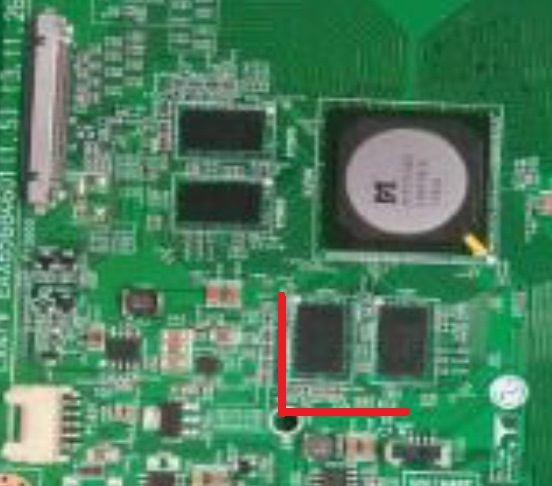

    good work.. LD1900 lit on when there are video signal go to LVDS
    did you look on the screen if there picture complete? if not
    the slight voltage fluctuation at F1 and the buzzer sound you hearing much high caused by one bin or more cut or moved to aside at ribbon cable. if you saw the picture on screen fine then they are fine. but could be the LVDS cable.
    BTW: the area you heat it are the DDR

        Thank you for the picture and clarifying those DDR chips, that is helpful.

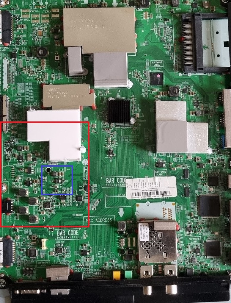

                          I removed the main board and took some pictures as requested, hopefully they are clear enough. I have also reconnected the board so I can measure as suggested the voltage at F1 while heating the area that you marked out in blue. This unfortunately made no difference. The heat setting was 2 out of 3 on the hair dryer so not as high as my heat gun but should be hot enough to try to show a difference by heating that area. The voltage reading didn't change from the fluctuating figures from before.
                          Can I ask what you mean when you say 'if you are not able to track hardware measurements' please?

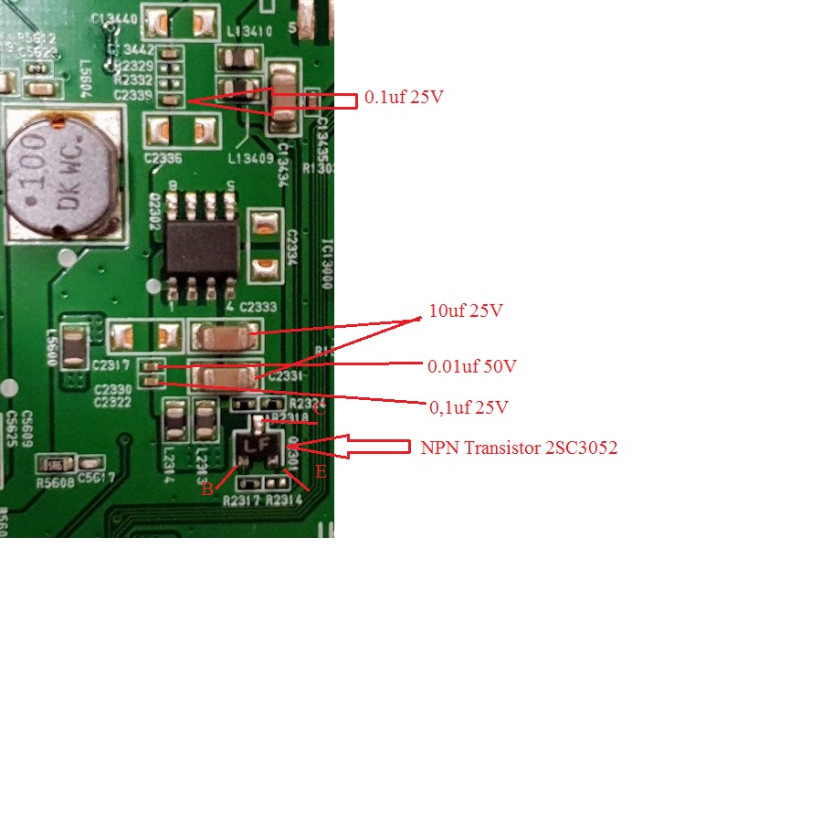

                            using DMM testing SMT/SMD parts not easy matter. users used to replace complete boards. but i would like to help and narrow the things to you as i am now have yours MB under my hands.

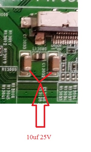

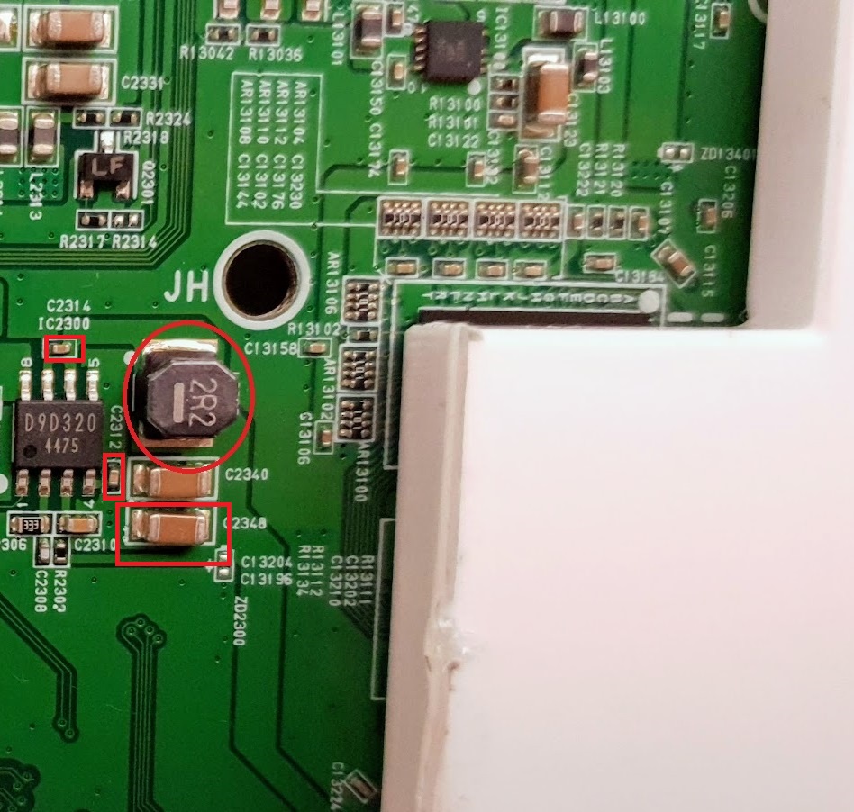

                            the critical parts at panel_Vcc 12V. i remarked them to you. the most parts could effected by heating are C with low uf. such 0.01uf / 0.1uf /10uf
                            also the transistor NPN one could leak. so all what i marked need to measure them with yours DMM.while the set out from wall socket .. if you don't know how just ask. if i am not here of sure other will help you too.

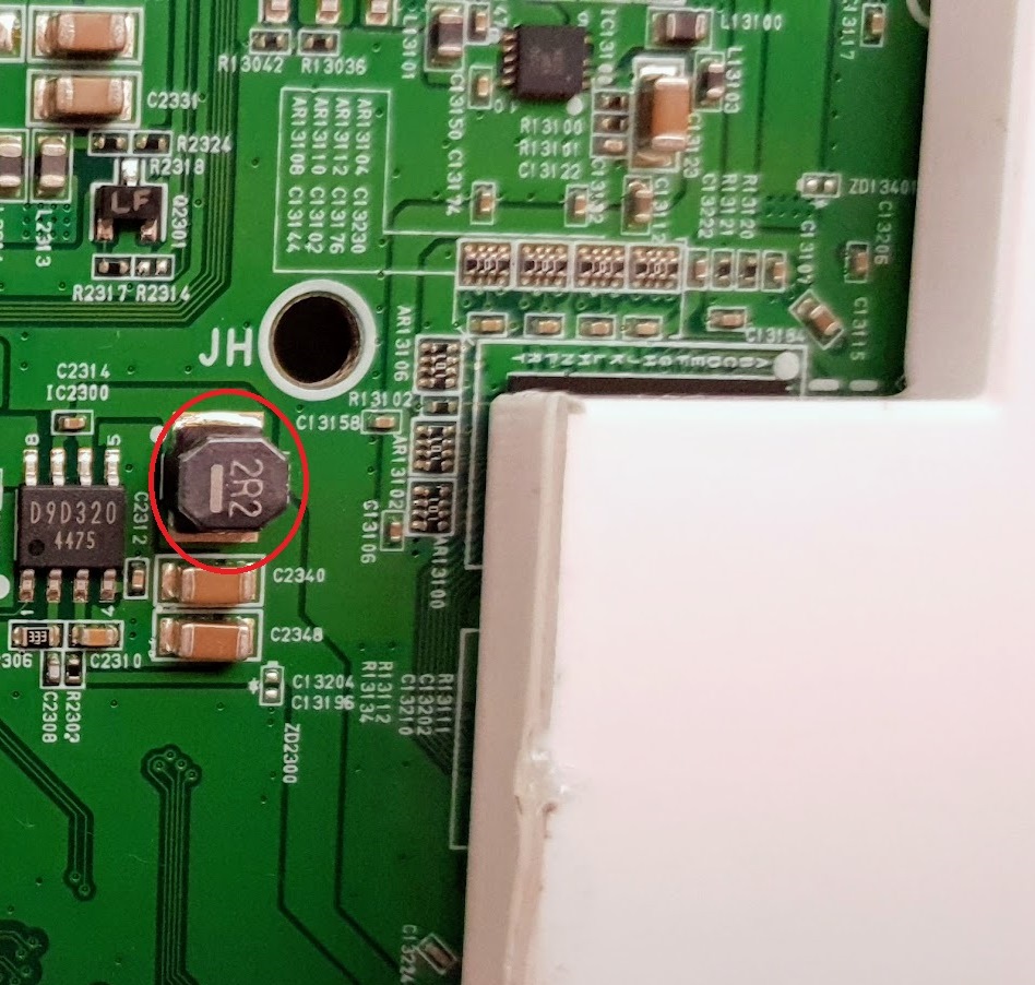

                            EDIT: this Coil Filter 2R2 for reduce Noise to my poor eyes are damaged by heat see photo 2R2
                            • Diah
                              • Feb 2013
                              • 6355
                              #74
                              Re: LG55UB850V no picture or audio - flashing LED's help please?

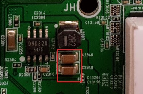

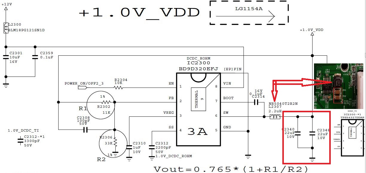

                              Part 2 EDIT:1.0V VDD circuit really effected by hot air pressure.
                              C2348 22uf 10V moved from it place , C2312 2200pf 50V, C2314 0.1uf 16V

                                Thank you Diah. I will aim to test all of the components which you have marked in red outlines on the pictures.
                                My DMM can measure a range of 10nF up to 100uF so should be fine. I have never measured SMD capacitors before, or attempted to remove/replace one.
                                Measuring them in situ on the board would not give the correct reading as there will be other components on the board that would affect the readings - is that correct?
                                Is it worth checking each ceramic SMD capacitor for short circuit while fitted to the board? Can this be done in situ while on the board by checking each side of the capacitor against a ground point on the board? Or would this not work if they all use different a ground plain within the board?
                                This is all new to me but I am enjoying learning and enjoy troubleshooting so hopefully we can narrow down or pinpoint the issue

                                  first things you need to do soldering C2348 22uf 10V at its place. who knows could be the reason. other caps i don't think there short. just need to put the soldering iron on the each side to stick them in place in case they are to your eyes not correct soldered
                                  EDIT: 99.9% yours issue this 2 caps .. need to solder them in place

                                    Thank you. I can see what you are saying about those caps, especially C2348, as it appears in the photos like it is either mis-aligned or not making proper contact at one end. I have checked back through my photos and this C2348 was exactly like this when I took the back off from the tv for the very first time before I touched anything, so it hasn't been moved or affected by heat or anything I have done. Perhaps it has always been like this since manufacturing of the board...
                                    Regardless, I have tried to heat it with soldering iron and solder to straighten it up on the board slightly, but it doesn't want to move. I wasn't able to straighten it up or remove it - I had hoped I could remove it to test it before re-soldering it back on straight to the board. Feels almost glued to the board after heating both ends carefully - zero movement. So I have just applied a bit of extra solder in order to try to ensure a good contact / reflow at either end.
                                    I have done the same with the other 10uF caps around that area in case of a bad solder joint, but while reflowing I didn't spot any cracks. If there were any that were too small to see under magnifying glass (smaller than hairline), then hopefully the reflow on each side that I have done might help.
                                    I don't know if it is possible to test the NPN transistor you highlighted in red?
                                    I have been unable to try any reflow on any of the smaller 0.1uF and 2200pf caps as my iron tips are not small enough for that sort of delicate work. My eyes would struggle also! I used flux and you can see the ones that have been soldered as they have some additional solder on the ends now, but I made sure there were no shorts anywhere or any new damage from the work I carried out.
                                    After all of this, still the exact same symptoms

                                          Thanks for the suggestion. I have done this, and the readings on C235 are as follows:
                                          Everything plugged into T-Con board = 8.81kOhms, diode mode = 2.430 stable
                                          cn3 ribbon unplugged = 8.81kOhms, diode mode = 2.465 down to 2.250 and back up again and repeats - unstable
                                          cn4 ribbon unplugged = 8.81kOhms, diode mode = 2.430 stable
                                          lvds cable unplugged = 8.81kOhms 2.456 stable in diode mode
                                          cn3 and cn4 unplugged = 8.81kOhms, 2.470 stable in diode mode
                                          everything unplgged = 8.81kOhms, 2.465 stable diode mode
