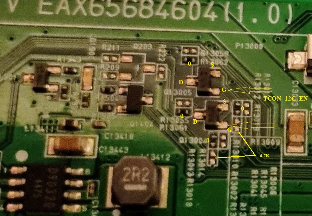

                          #152
                          Re: LG55UB850V no picture or audio - flashing LED's help please?
                          When you say 'rand' of panel, can I ask you to explain what you mean please as I don't understand the term?
                          I continued to install older and older firmware, to try to find one that uses a different MICOM version that 3.00.3 as per the latest firmware 05.05.90
                          I tried several versions, even going back to the original firmware version for this model, and they all use the same MICOM version. The Boot version did change though, if that makes any difference.
                          Performed IN_STOP reset after each firmware installation, but none made any difference to the screen and buzzing problem. I found one screen menu which highlights the screen problem very clearly:
                          https://photos.app.goo.gl/ZAjkg9gSuoqAnZ667
                          I have also tested the transistors on the MB as requested, although measurements are with this components still in circuit, so I don't know how helpful they are:
                          Transistor Q13005
                          - probe Gate, + probe Drain = 2.152
                          + probe Gate, - probe Drain = 2.666
                          - probe Gate, + probe Source = 2.359
                          + probe Gate, - probe Source =2.666
                          - probe Drain, + probe Source =0.618
                          + probe Drain, - probe Source =1.625
                          Transistor Q13004
                          - probe Gate, + probe Drain = 2.158
                          - probe Gate, + probe Source = 2.364
                          - probe Drain, + probe Source =0.621
                          + probe Drain, - probe Source =1.627
                          Resistor R13062 = 0.8 Ohms
                          Resistor R13061 = 0.8 Ohms
                          Resistor R13013 = 0.7 Ohms
                          Resistor R13014 = 5.775MOhms? This is supposed to only be 4.7 KOhms
                          Resistor R13019 = 5.775MOhms? This is supposed to only be 4.7 KOhms

                            #153
                            MOSFET Q13004 &5 reading fine as the diode between D & S intact.
                            bezel frame of the TV protect the area of the panel from 4 sides. this what i mean.
                            nothing remain in my head. if you didn't touch T-CON and some how static electricity damage it... stay only only Could COULD BGA issue in DDR.
                            i read you have flux .. so need to mask all parts from top side and down side around the first and second DDR where you did align the caps before.. put flux under the chip and with cold air pressure try to push it deep under the chip then apply heating.

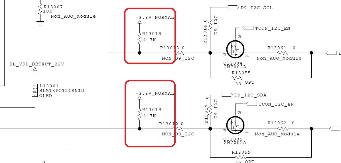

                                #155
                                LVDS was disconnected during testing. I double checked with the magnifying glass, and it turns out that both R13018 and R13019 are actually empty - just pads with solder on, the same as a lot of other R numbers on the board.
                                This is obviously different to the service manual as seen in your picture of the circuit. Perhaps certain revisions to the board and this particular one doesn't have those 2 resistors?
                                The freeze spray arrived today so I will attempt this to see if I can alter the behaviour at all, as per your previous suggestion. Are the DDR chips ok to be frozen one at a time, or only the main IC chip - IC2500?
                                If no difference can be detected, I will move onto the heating of the DDR with flux as you also suggested.
                                EDIT: Just done some more reading and it seems these R13018 and R13019 resistors could be 'embedded' resistors within the PCB - is that correct? If so, my readings stand as above, although slightly higher when checking today, just over 6 Mega Ohms each.

                                  #156
                                  hold on.. dont do any further steps unless we clear the condition of R13018 / 19
                                  they are not OPT on service manual.. and they are the feed of V to source. how it come they dont put them..
                                  turn on the tv normal and read the any pins on those empty R one should 3.3V so about the other pins

                                    #157
                                    PHOTO so the service manual says .. yours Panel ( Module ) NON D9_12C (this why you have R13012 / R13013 0 Ohm connected to R13019 /R13018 4.7K ) and there are NO R13014 / R13017 0 Ohm )
                                    also because yours Panel ( Module ) not a AUO brand so you don't have R13061 /R13062 0 Ohm )
                                    so my mind tell me as S.M there are R13018 / R13019 .

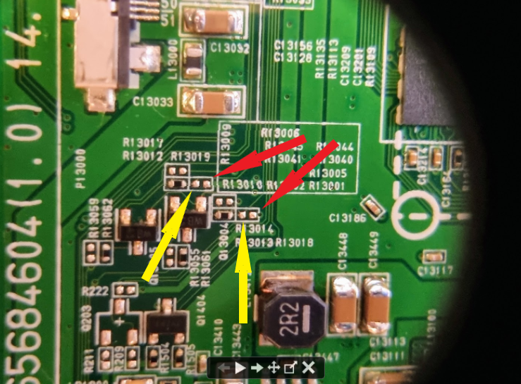

                                      #158
                                      Yes so R13012 and R13013 0 Ohms are both present and surface mounted R as per the service manual, so my module must be NON_D9_I2C like you say.
                                      My module DOES have R13061 /R13062 0 Ohms present as surface mount R, as you can see form my last photo. So yes it is a Non-AUO Module.
                                      I agree, there should be surface mount R for R13018 and R13019. Very strange...
                                      I have turned the set on and tested both sides of R13018 and R13019. I get a different voltage reading from either side of each 'resistor'.
                                      I have uploaded a picture to illustrate:
                                      Red arrow side of R13018 and R13019 = 3.272v STABLE
                                      Yellow arrow side of R13018 and R13019 = Fluctuates in time with buzzing, between 3.299v and 3.304v. During each 2 second 'buzz' the voltage climbs from 3.299 up to 3.304v, and when the buzz stops, the voltage falls back down to 3.299v.
