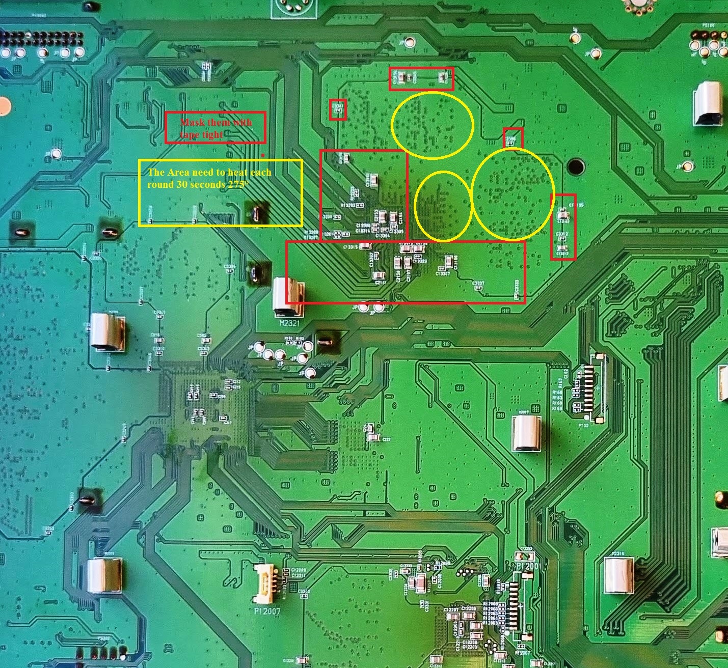

            take out yours MB from the TV and upload clear photo of the boards back side. there are way to handle this.
            also show me yours heat gun you used before-

              #86
              Re: LG55UB850V no picture or audio - flashing LED's help please?
              Here is a picture of the entire back of the board - let me know if you need a close up picture of any parts in particular
              I have 2 heat guns - one large generic 2000W with 2 settings, and my gas powered Dremel soldering iron which has a much smaller hot air tip

                #87
                i do suspect ONE DDR make this issue.. also
                i do hope you didn't used the flame heat before..LOL .. so use the big one.
                put yours MB as the up side to the top on 4 legs stand. ( belong to yours fantasy ), put load round 1/2 Kg on the main IC sink to preform pressure down of the chips and DDR.
                after you masking tight all caps in RED. you stand the heat gun under the Boards ( yellow areas ) to start heating leave it cool then install.

                  #88
                  Yes it was the heat gun I used previously, not the dremel flame one lol although the dremel is good for gas level control to control the amount of heat in a small area.
                  I did laugh when I read your "belong to yours fantasy" comment - I think I understand the translation - hopefully you mean "use your imagination"
                  I'll get things masked up on the board to protect them and find a way of propping the board up allowing access for the heat gun underneath. I have a 0.5kg weight I can use on top of the heatsink too. I'll report back once I've let it cool down and reinstalled it.......

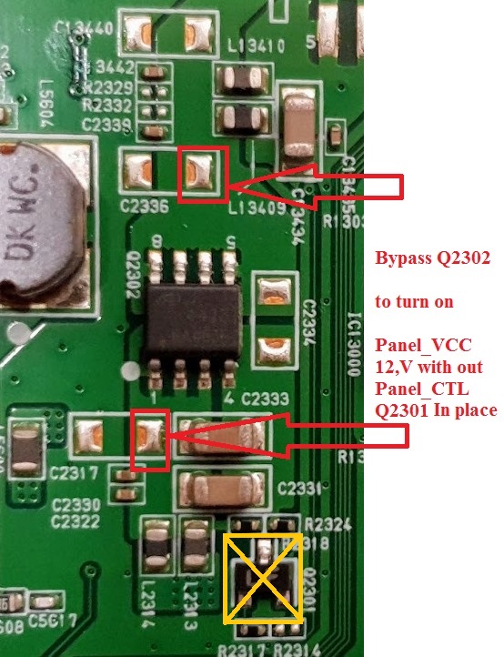

                    One other finding I meant to report, was in response to your picture highlighting the Q2301 NPN Transistor 2SC3052 in your post #73.
                    These are the readings I have taken with my DMM in diode mode:
                    - probe Base, + probe Collector = 2.914
                    + probe Base, - probe Collector = 0.716
                    - probe Base, + probe Emitter = 2.578
                    + probe Base, - probe Emitter = 0.719
                    - probe Collector, + probe Emitter = 1.577
                    + probe Collector, - probe Emitter = 2.682
                    As I am new to these type of device I read up about them. If I understand correctly, the transistor is effectively 2 diodes. Therefore readings should only work with the probes one way around, and you should read infinity with the probes the other way around? If that is correct, then there is something wrong with this transistor?
                    For reference I carried out the same checks on another transistor, Q2303, which is also a 2SC3052,
                    - probe Base, + probe Collector = 0L
                    + probe Base, - probe Collector = 0.707
                    - probe Base, + probe Emitter = 1.805
                    + probe Base, - probe Emitter = 0L
                    - probe Collector, + probe Emitter = 1.804
                    + probe Collector, - probe Emitter = 0L
                    Does this confirm a faulty transistor Q2301?

                                • Diah
                                  • Feb 2013
                                  • 6483
                                  #96
                                  Originally posted by Scoff
                                  Thanks for the link. There are a few similar transistors, however I do not know which values are ok to be different to the values of the 2sc3052?
                                  maybe you are excited about yours measurements of Q2301 and yours compare with Q2303 specially both the Emitter goes to GND. this reading could confused you.. the only correct matter when this Q2301 to take it out of the boards then you can continue the excitement. WHY :
                                  Q2301 Base receive Panel_CTL from IC 3000 ( MICOM ) Pins 4. .Micom the one turnoff the set if there are error.. and it send not ONLY CTL to Panel but also the WIFI power_ON too ( we are back to first time when you get run the set only when you disconnected the WIFI Module ) also now you have just TIMING CLK each 2 seconds the buzzer and dropping Panel_VCC which this ( MICOM ) the one send switching Panel_VCC 12V. via the Panel_CTL.
                                  this short explanation i hope to give you the courage to mask all components round Q2301 and take it in one piece to measure it out circuit.

                                    #97
                                    Thanks very much for the explanation of the transistor Q2301.
                                    I masked the area on the MB surrounding Q2301, and found a smaller soldering Iron tip so instead of hot air I used the soldering iron tip plus flux and some de-solder wick. I was able to keep the heat isolated and away from the nearby tiny resistors and caps.
                                    I successfully removed Q2301 from the board The brown marks on the tape are just solder flux and not burn marks!
                                    I measured Q2301 in diode mode while off the circuit board and here are the results:
                                    - probe Base, + probe Emitter = 0L
                                    + probe Base, - probe Emitter = 0.703
                                    - probe Collector, + probe Emitter = 0L
                                    So does this indicate a problem/failure between Collector and Emitter?

                                      • Scoff
                                        • Jul 2017
                                        • 101
                                        • Uk
                                        #99
                                        LOL you're right - it was very surgical looking! My first time soldering any components this small so I thought better safe than sorry, especially with all the surrounding components that are ever smaller!
                                        So after cleaning up I left the transistor on the side and fitted the MB back to the TV.
                                        System went into standby and then powered on via RC like you said. Backlights came on, and the following stable voltages:
                                        23.98v
                                        11.89v
                                        3.533v
                                        Back to 0.835v at fuse F1 which seems to be a 'normal' reading when no panel_VCC 12v is present - which is what I was seeing back in post #39 when the screen was not turning on.

                                          #100
                                          okay... now we are going to see the buzzer caused by micom panel_CTL or the T-con the caps you before talked about, or we do have other issue we can narrow it by this work.
                                          we are going to bypass panel_CTL by keeping Q2301 out side the boards and put jumper (see photo just connect the 2 points with soldering wire between them ) this is by pass Q2302 to feed panel_vcc to the T_CON.
                                          TV should turn on normal with screen complete with hope no buzzer.
