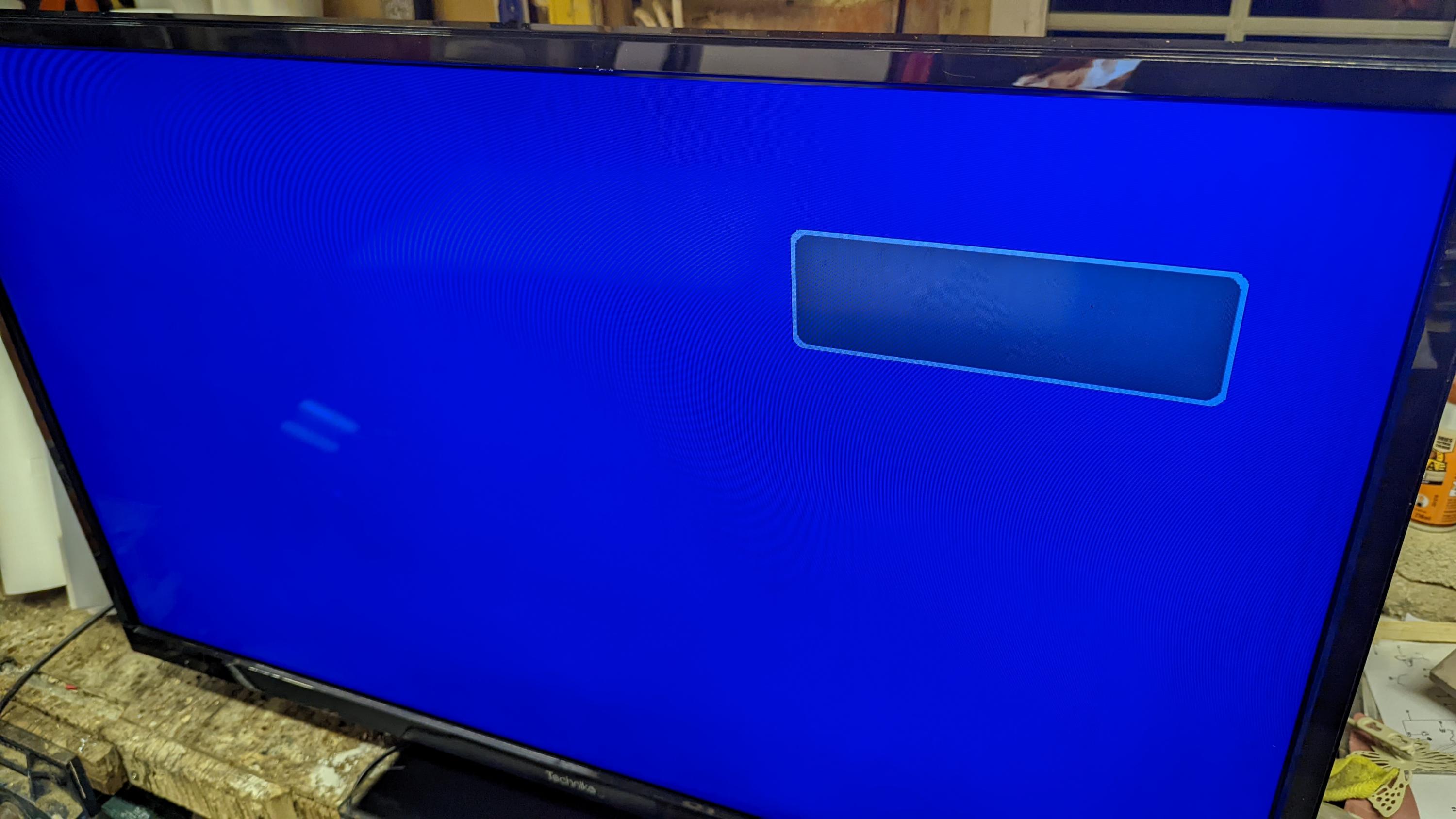

    Hi
    See attached.
    Powers on and TV repsonds to remote buttons - but just recently the menu has stopped displaying. Only this grey box moving round the screen.
    Tried the firmware flash files on eeprom thread but can't see what's happening.. if anything.
    Tried factory reset remote proceedure, but again TV seems to respond but can't see anything happening.
    Any ideas?

    Try to reprogram Flash: W25Q32BVSIG through the programmer, if you need a dump, I'll post it here.

      Re: Technika 40-E271 menu not responding
      hi, yes please. that would save me some time. thanks.
        Try Dump, write to new spi flash.
          This thread also has a firmware link if needed
            It turns out that this TV has two different motherboards "T.MSD 306 69A 12023" and "TP.MSD309.BP86"
