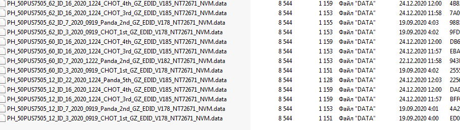

                    • lotas
                      • Jan 2016
                      • 4550
                      • Russia
                      Rather, you need an NVM file. bin for your panel (58PUS7505_NVM...), something like this and update via usb.
