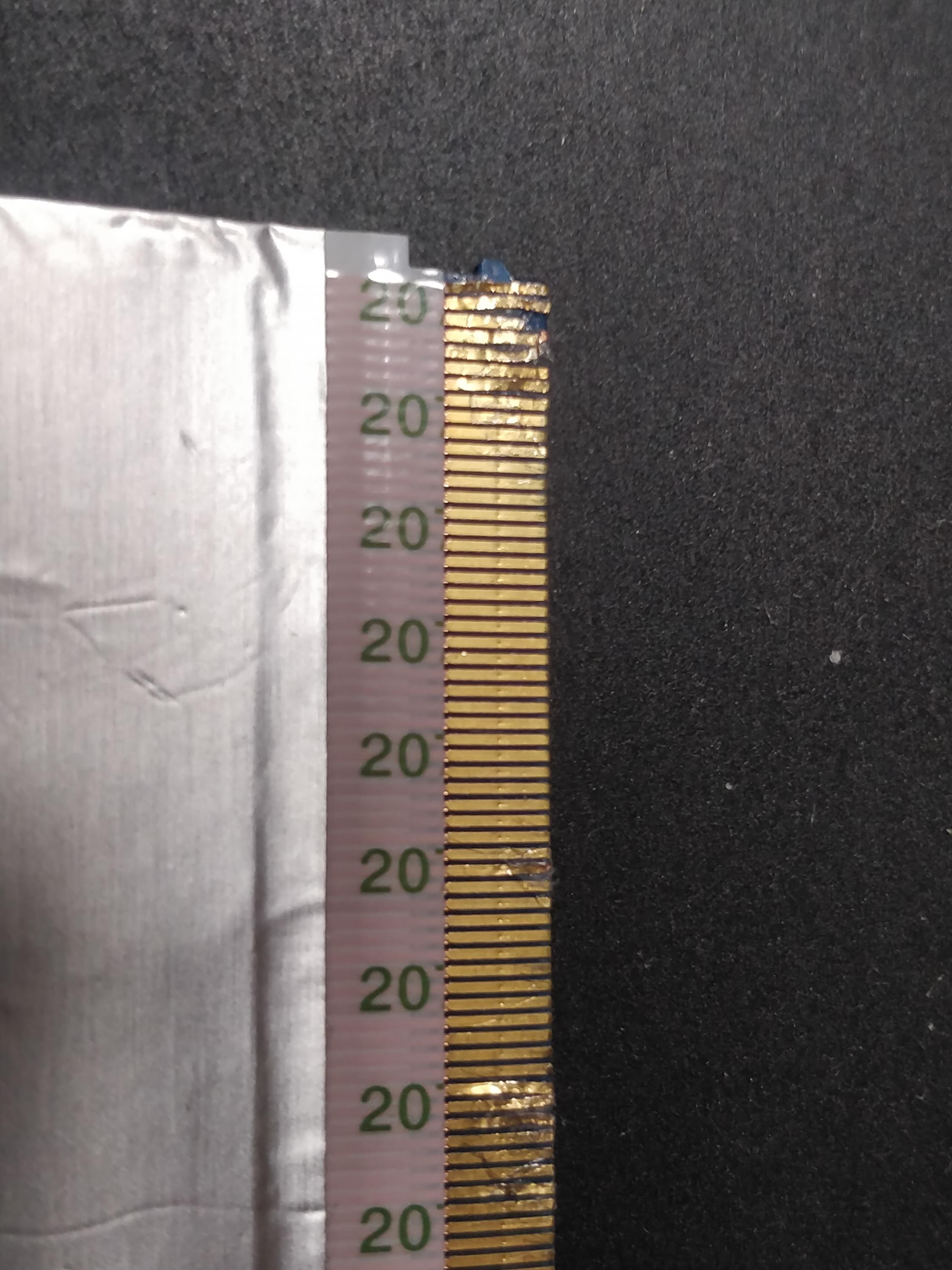

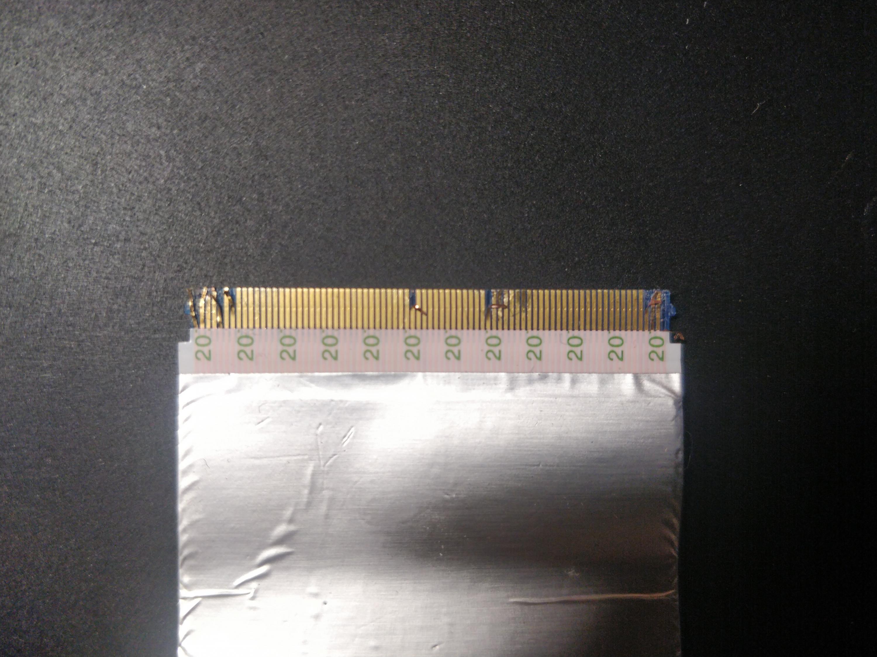

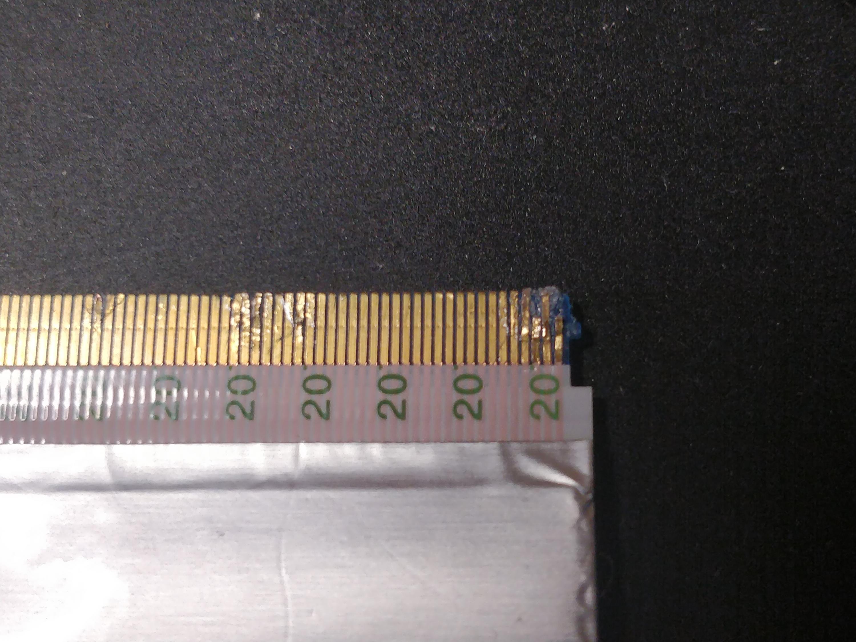

                                Hey people, I'm back and I have some progress with the TV!
                                So after checking all the connections I found out that the right t-con flex cable was damaged. Few of the pins were bent, so I took some glue and a tweezer and I tried to put them back into their places. This is how it went, I tested the pins with my multimeter and they show continuity and no short between the lines as far as I see.
                                Now since this the display do turn on but with pink-blue bars across the screen.
                                I looked it up and in a SONY service manual, it indicates T-CON failure.
                                What do you guys think?
                                Should I replace the flex cable first or should I try to repair/change the T-Con board?
                                Thanks in advance!
                                • diif
                                  • Feb 2014
                                  • 6978
                                  • England
                                  Re: Phillips 55PUS6561/12 Black Screen
                                  I'd replace that chewed up cable first.

                                    You will not find out the cause of the defect until you replace the defective ribbon.
                                    Change the ribbon.
                                    • nomoresonys
                                      • Jan 2013
                                      • 12097
                                      • U.S.
                                      Sure, that bad cable is probably the reason for the tcon error.
                                      • unimatrix93
                                        • Oct 2021
                                        • 341
                                        • Magyarország
                                        Thank you for the replies, I'm looking for a new ribbon cable right now. Will report back once I changed it!
