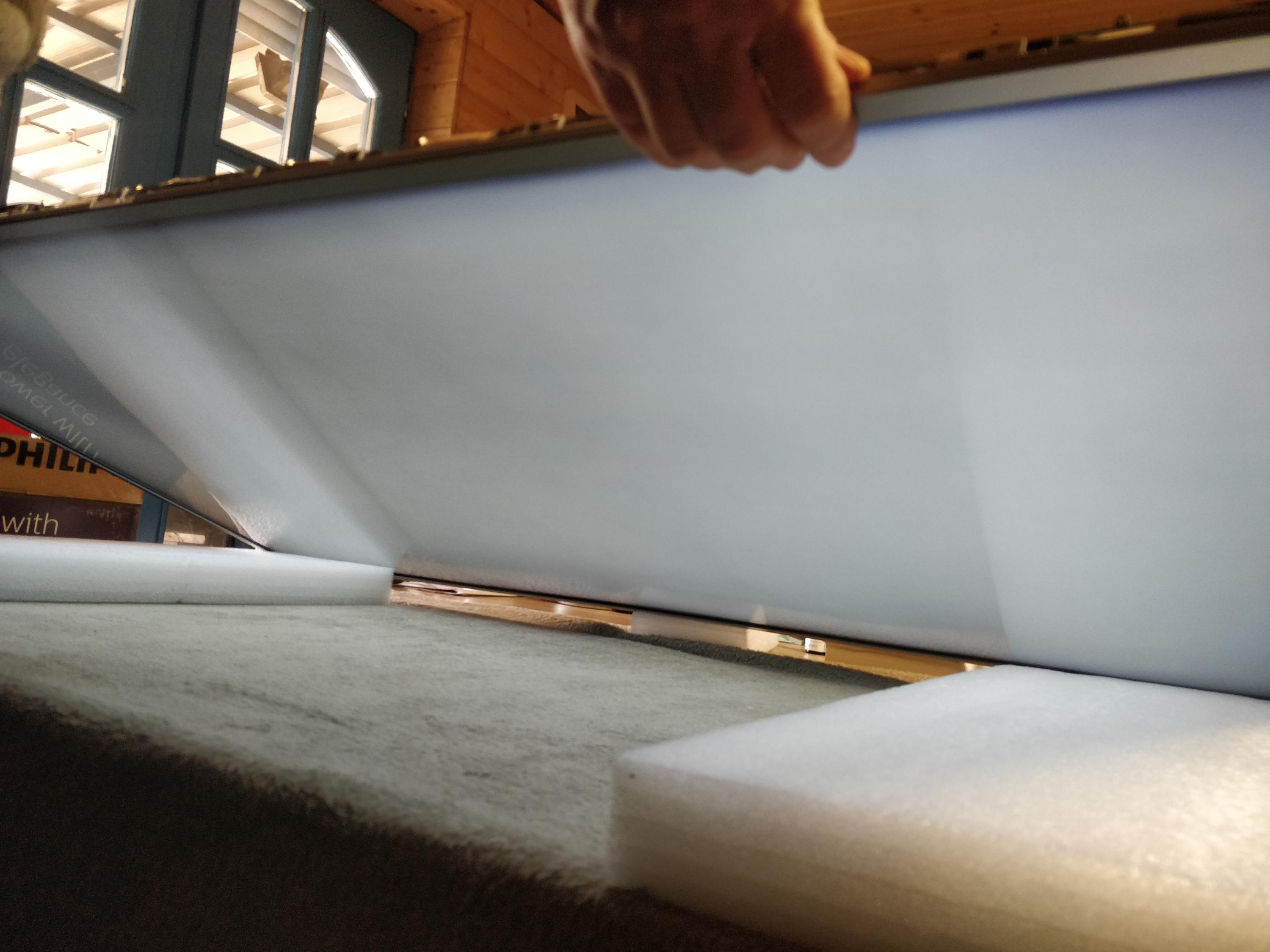

        Sorry for the late reply, I had to order the cable from the Netherlands.
        So after I connected the new tcon ribbon cable the whole screen turned white bright like this:

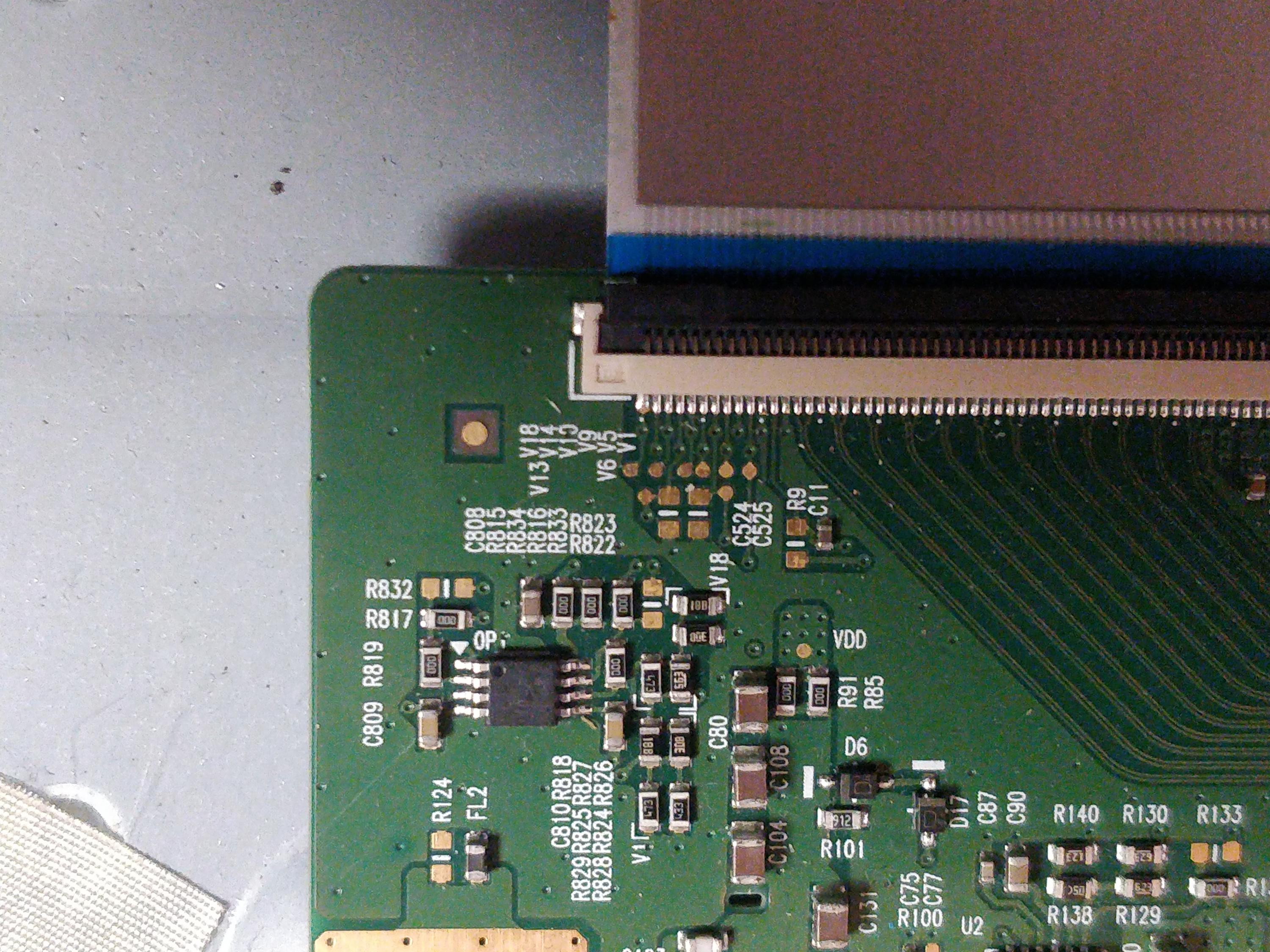

        After that I mesured the voltages on the T-CON board.
        Here are the results:
        Vcore: 1.05V
        PG: 0.18V
        VCC18: 1.8V
        VDD: 15.7V
        VCC33: 3.3.V
        HVDD: 7.8V
        VGH: 28V
        VGC1: -5.1V
        VCC5: 0
        VComLFB: 5.7V

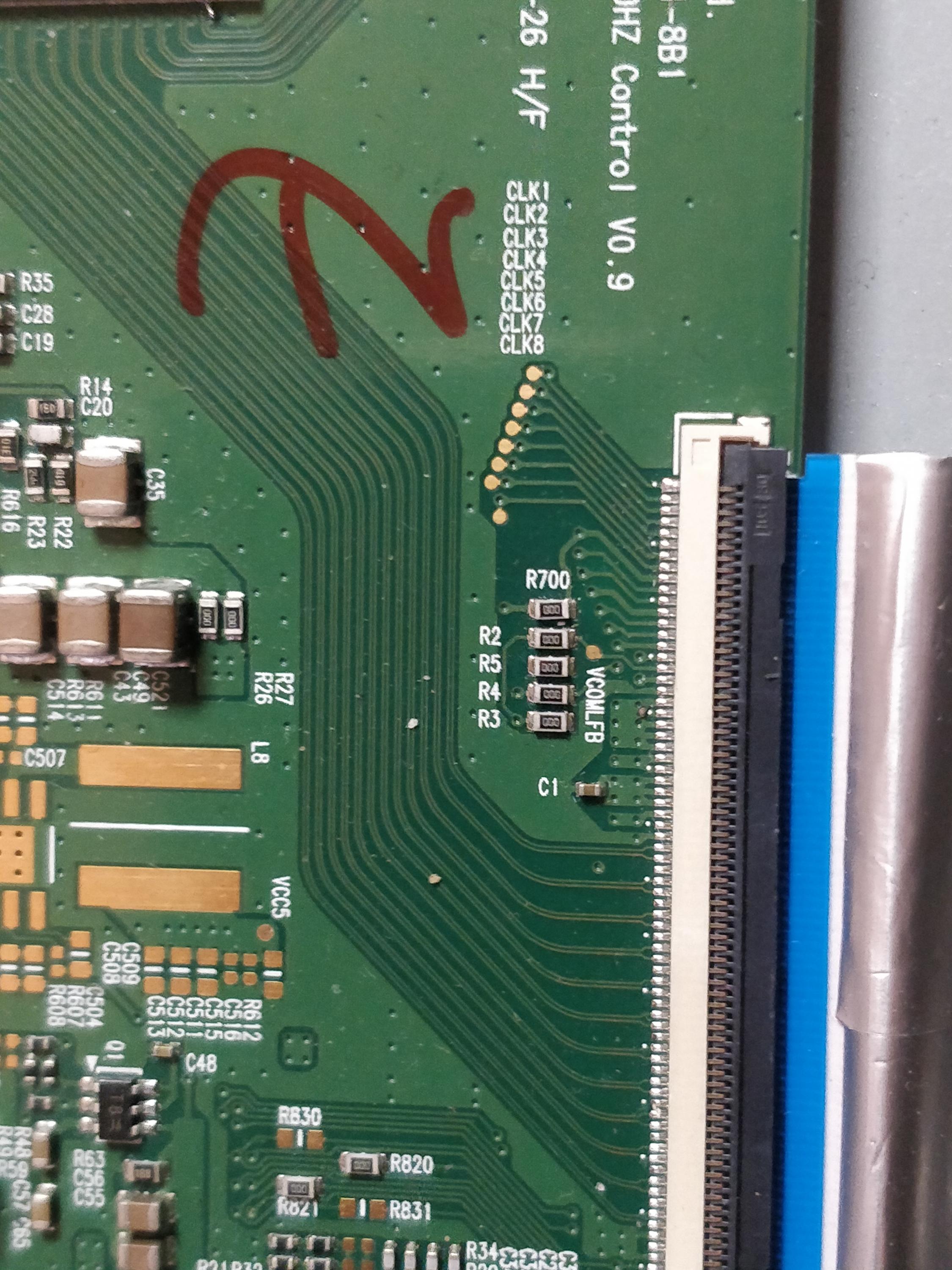

        There are next to the right tcon cable:
        V18: 0.5V
        V13: 5.1V
        V14: 3.9V
        V10: 7.6V
        V9: 8.2V
        V6: 10.7V
        V5: 11.8V
        V1: 15.2V
        And next to the left side tcon cable:
        CLK1:-3.1V
        CLK2:-2.8V
        CLK3-CLK7: -2.7V
        CLK8: -2.8V
        What do you guys think?
        VCC5 is missing (5V maybe?).

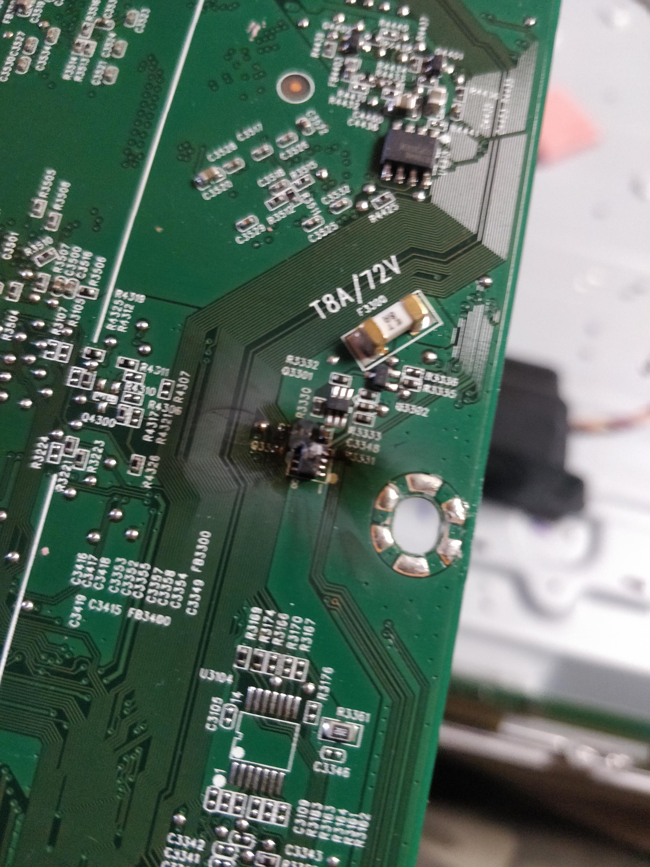

            UPDATE
            I got a new T-CON board for the TV today.
            Hooking it up caused some ticking noise from the PSU and the Mainboard. No display, power LED for a few seconds then nothing just the ticking noise. Putting back the old TCON board produced the same symptoms as before.
            After I put back the new TCON again, I measured If 12V were present on the new TCON, and indeed it was not. Then as I tried to locate the source of the ticking noise I noticed the smell of burnt electronics... then BAMM. Explosion on the motherboard.
            I disconnected the TV from AC and I took out the mainboard.

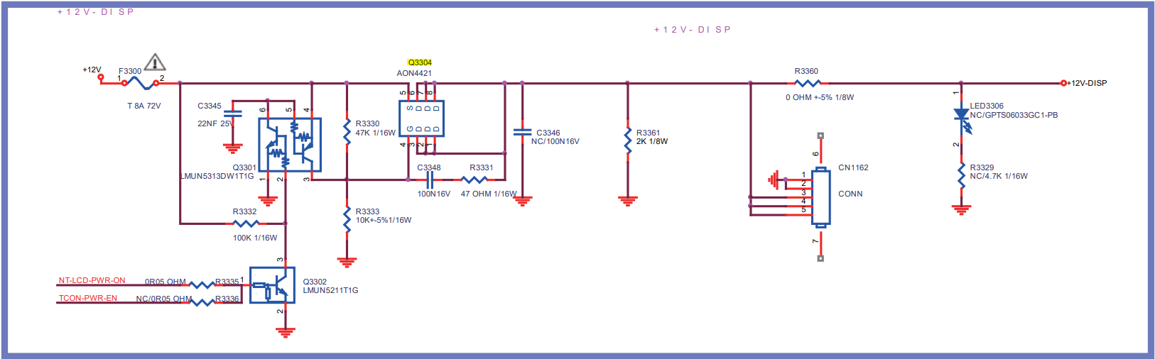

            Q3304 died. It's an AON4421 P-Channel MOSFET. I could order replacement part from Aliexpress.
            However I want to know first what could have caused this.
            Do you guys have any idea? Could it be the new TCON panel? It wasn't receiving power during the ticking.
            I'm getting really desperate from this TV.

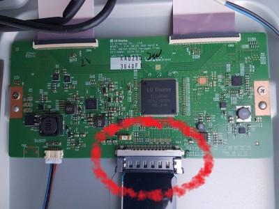

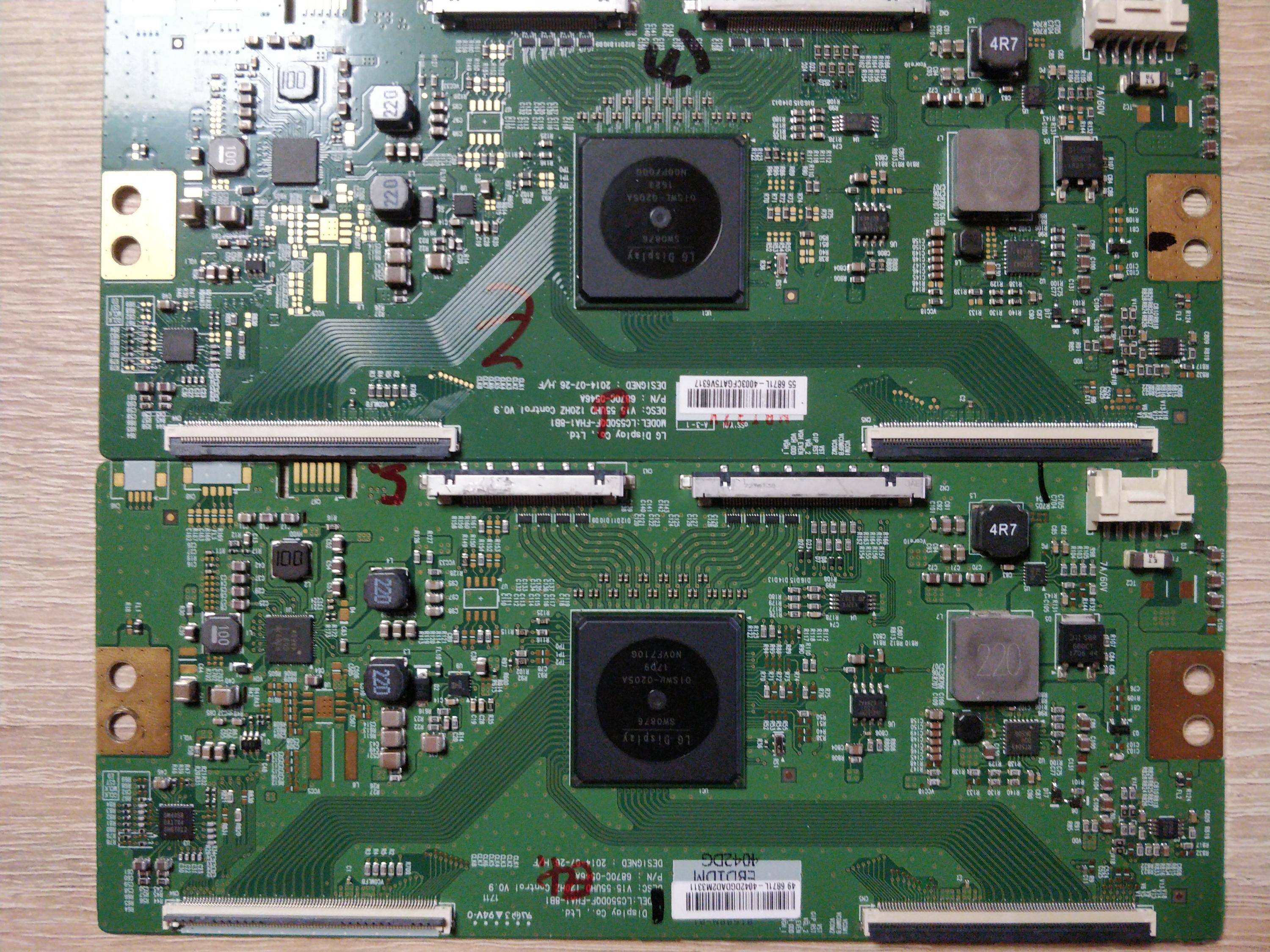

              Make sure that new tcon is an acceptable match to your tv, usually done by matching up the numbers on the white sticker, you may have gotten a defective one or mismatch.
              • unimatrix93
                • Oct 2021
                • 343
                • Magyarország
                Re: Phillips 55PUS6561/12 Black Screen
                The printed numbers match up.
                But the sticker is different.
                Is this the problem?

                  If you have a metal connector on the main / t-con ribbon towards the precise t-con, you have inserted it in reverse in the t-con. You shorted the t-con power supply to 12V.
                  Example

                    looks like one is from a 49 inch tv and the other is from a 55 inch, im not sure if that matters tho?
                        +1
                        but even will be not the reason of MB short.. it sound to me he had worked and tested long time with broken old ribbon. or he install the new one but didnt clean the sockets in case old pins rest stick inside
                          Example
                          But how could I insert it in reverse If its (the metal tcon ribbon cable) is fixed to the chassis with tape? I mean if its reversed, it should have shorted the older tcon panel too, no? While the olser once was just missing VCC5 and it made faint buzzing. But the display turned on, it was just white.

                              T-con is wrong, one is a 6871L-4042D and one is a 6871L-4003C. Never order a t-con with the 6870C numbers, those are plain pcb numbers and not the order numbers.
                                Hmm I see you mean. Should I contact the store that I bought it from and ask for a swap/refund?

                                      I did fix the motherboard with a new MOSFET. It was time consuming, because whole traces/pads got destroyed when it went poof. I can upload some photos of it If you want to check it.
                                      Unfortunately, the LCD panel was shorted, so I sold the motherboard and the PSU later. ��
