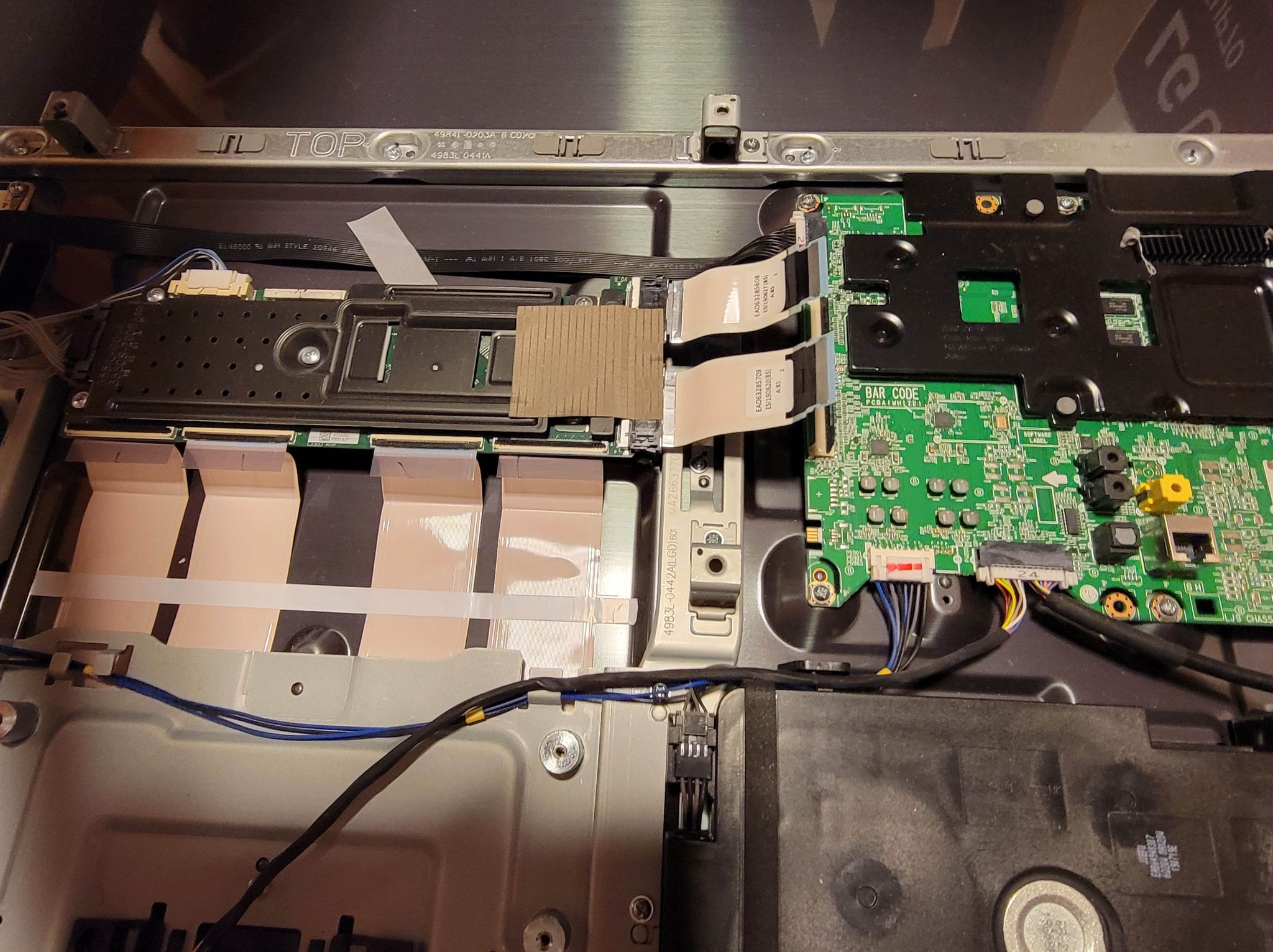

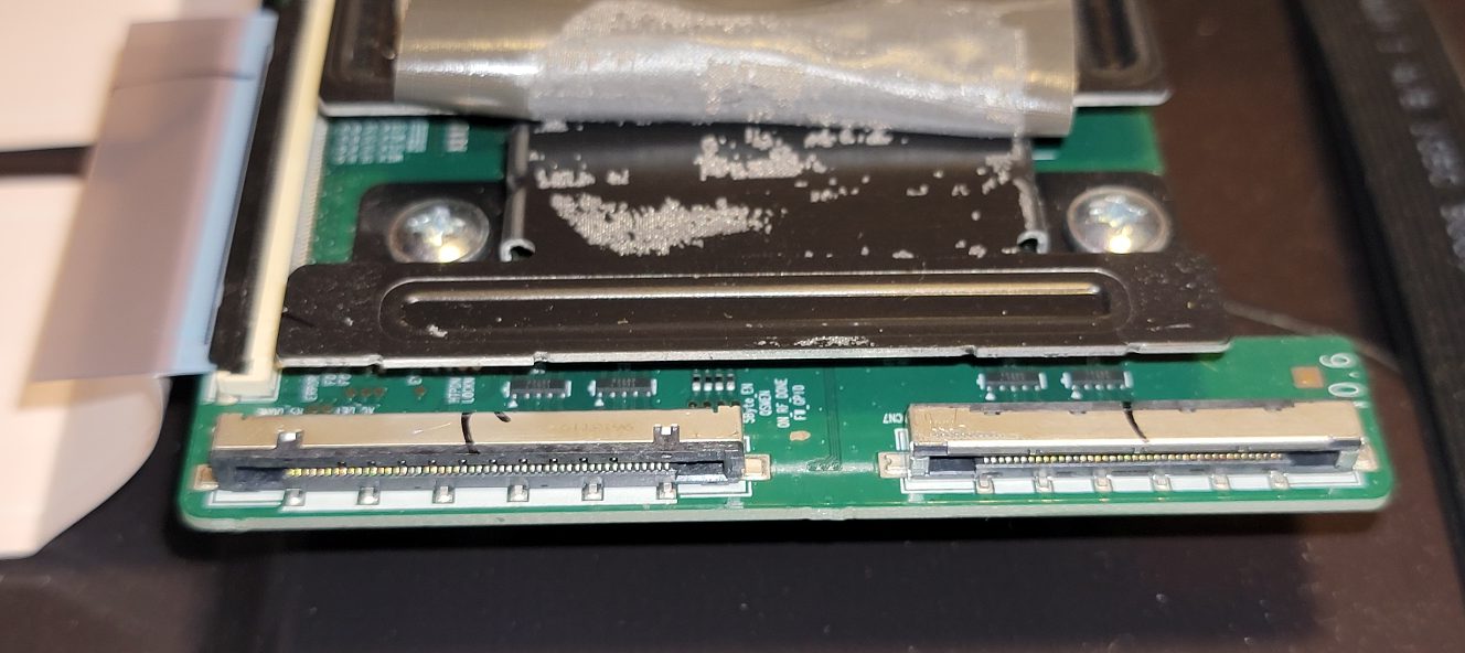

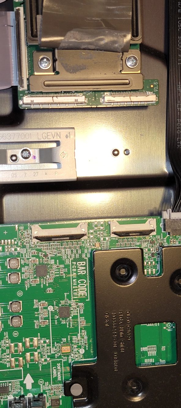

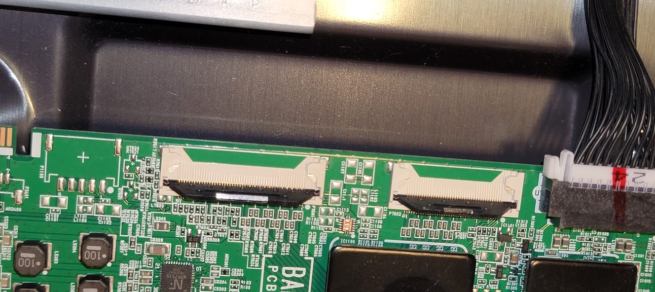

          So, here's some pictures of what I'm dealing with.
          If I unplug the 2 ribbon cables from the mainboard to the T-Con(middle board I'm assuming) board, the image persists on the screen without auto shutting off. So the yellow line persists when all 4 of the bottom ribbon cables are plugged in. The Green banding is what persists when I unplug the outer 2 ribbon cables across the bottom of the T-Con(?) board. The last image shows this scenario.
          Different combinations of bottom ribbon cables give slightly different effects, but generally limit the green banding to the left or right side, sometimes with a reddish hue.

            Re: LG OLED65C9PUA no audio/video after delicate move
            yours picture
            it show some one work on the LVDS cable before you bought it.. the carton paper glued over the 2 LVDS socket at the T-CON side doesn't belong to this TV at any way..
            so maybe the LVDS cable clips are broken before and they fix the cable with this way... any move ( could be happened by yours move ) the cable sliver pins sitting at wrong place which it will cause shout down.
            inspect them and don't forget to put the other No1 & 4 ribbon cable back between panel module & T-CON driver board.

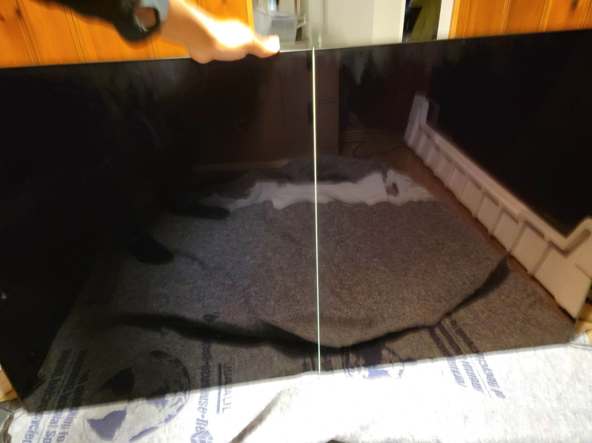

              • Diah
                • Feb 2013
                • 6439
                Hmmmm, unplugging the LVDS cables prevents it from shutting down but I'm still not getting an image on the screen. Do you think that Vertical Yellow line is indicative a broken panel?
                OLED. they are micro LED of R/G/B units group.
                from all what i experienced with this module, shorted / defect panel shows one color line or more of one group. Yellow mean the G & B (green -blue )working. also when you turn it on with out LVDS in place the T-CON will not able to refresh all pixel as there no signal command receiving it from main boards.. i would say you have broken LVDS as first suspected because as i mentioned before some one work on them before as yours photo tell this theory.. . take them out and under good loop, inspect them carefully.
                unless you hit the front of the panel within your transport..
                • Xavier847
                  • Sep 2016
                  • 17
                  THANK YOU! I was so careful with moving it that I couldn't believe it was a panel issue. I'll look over the 2 LVDS cables and ports.
