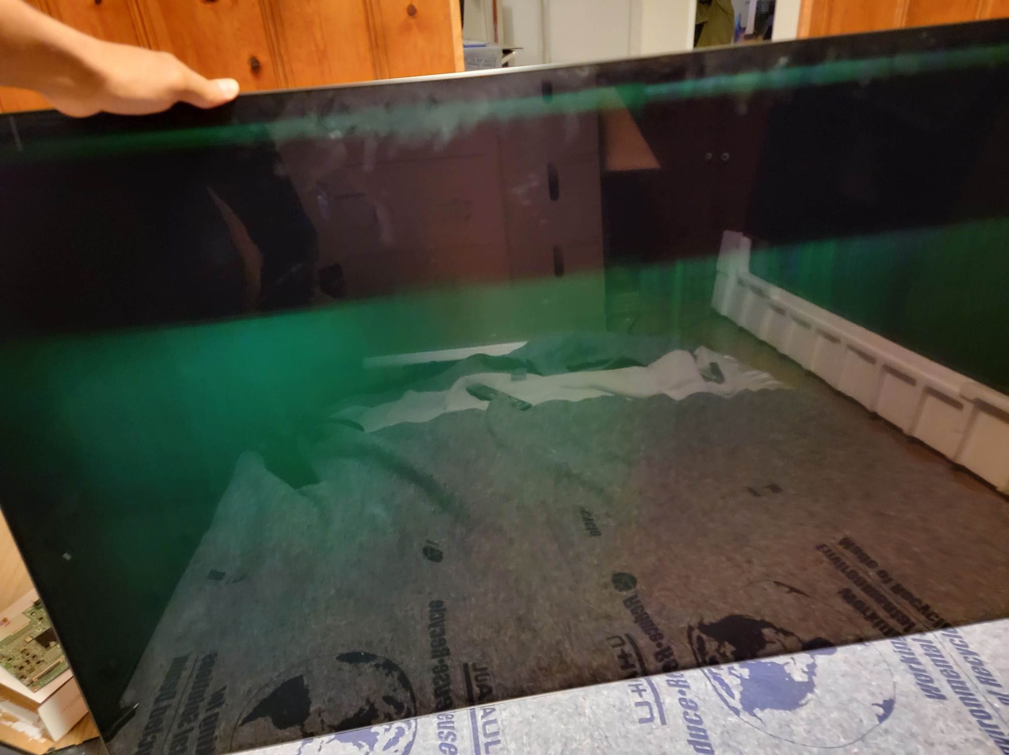

          So, here's some pictures of what I'm dealing with.
          If I unplug the 2 ribbon cables from the mainboard to the T-Con(middle board I'm assuming) board, the image persists on the screen without auto shutting off. So the yellow line persists when all 4 of the bottom ribbon cables are plugged in. The Green banding is what persists when I unplug the outer 2 ribbon cables across the bottom of the T-Con(?) board. The last image shows this scenario.
          Different combinations of bottom ribbon cables give slightly different effects, but generally limit the green banding to the left or right side, sometimes with a reddish hue.

            Re: LG OLED65C9PUA no audio/video after delicate move
            yours picture
            it show some one work on the LVDS cable before you bought it.. the carton paper glued over the 2 LVDS socket at the T-CON side doesn't belong to this TV at any way..
            so maybe the LVDS cable clips are broken before and they fix the cable with this way... any move ( could be happened by yours move ) the cable sliver pins sitting at wrong place which it will cause shout down.
            inspect them and don't forget to put the other No1 & 4 ribbon cable back between panel module & T-CON driver board.
                Hmmmm, unplugging the LVDS cables prevents it from shutting down but I'm still not getting an image on the screen. Do you think that Vertical Yellow line is indicative a broken panel?
                OLED. they are micro LED of R/G/B units group.
                from all what i experienced with this module, shorted / defect panel shows one color line or more of one group. Yellow mean the G & B (green -blue )working. also when you turn it on with out LVDS in place the T-CON will not able to refresh all pixel as there no signal command receiving it from main boards.. i would say you have broken LVDS as first suspected because as i mentioned before some one work on them before as yours photo tell this theory.. . take them out and under good loop, inspect them carefully.
                unless you hit the front of the panel within your transport..
                  THANK YOU! I was so careful with moving it that I couldn't believe it was a panel issue. I'll look over the 2 LVDS cables and ports.
