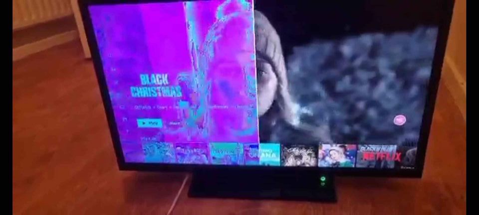

Any thoughts on this one ?
  • brianbelfast
    • Jun 2010
    • 29
    • Northern Ireland
    This one hasn't arrived with me yet, so I only have this photo to go on.
    I was thinking poorly seated left T-con ribbon but I'm not convinced that the fault is exactly 50/50 of the screen. It may not even have a separate T-con board.
    It's a Toshiba, and I'm guessing 43". Sorry no model number as yet.
    Any thoughts ?
  • dick_barton
    • Aug 2015
    • 6643
    • Wales
    Re: Any thoughts on this one ?
    It looks like a solarized image but only half screen which I have not seen before.
    What is the model number?
    • dskall
      • Oct 2016
      • 2905
      • usa
      I would defiantly reset cables to panel. I don't thing bad gamma chip can only effect one side.
      • CityZen
        • May 2014
        • 40
        According to a "how to fix LCD problems" video I saw recently, that particular issue could involve anything from the main board to its connection to the T-con board to its connection to the panel. Data is getting lost along the signal path somewhere.
        If you can bring up a service menu test image, you can rule out the T-con board and downstream of it. Either way, it's a good idea to check out all the cable connections.
