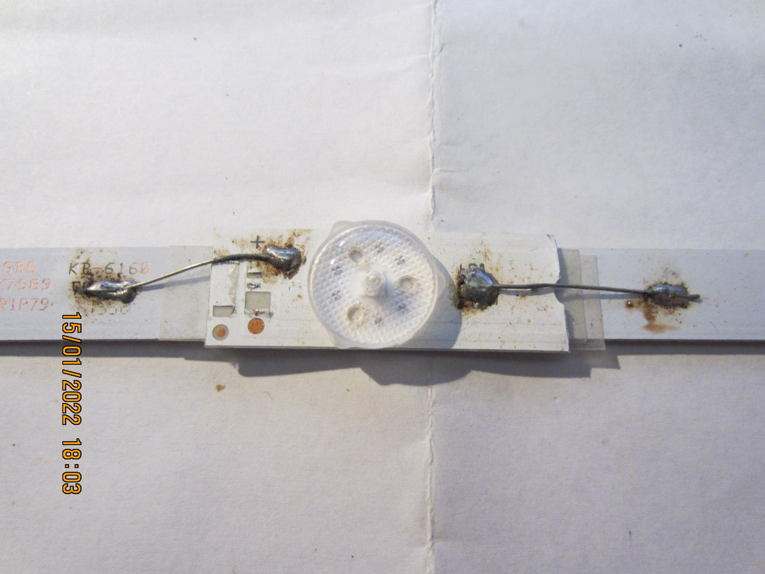

                          I got the TV with no backlight. It was previously serviced.
                          It had 2 new LEDs - see photo of a repair. I did the same with 2 others. and sold.
                          10 days later it was brought back. I mis-diagnosed : it had one more dead LED, but powering up, after I installed a new Set of 12 strips, I realized I missed the important issue, and this is why I came here, to repair the image issue

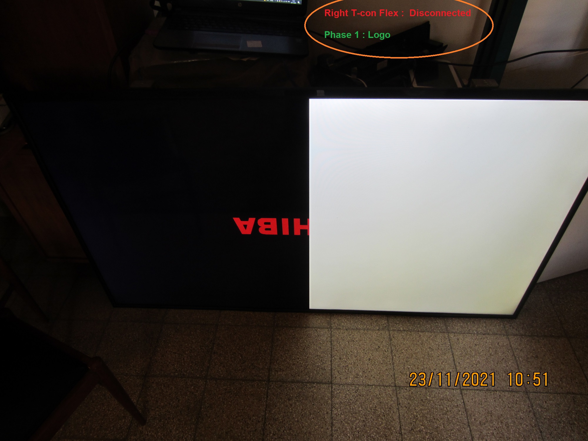

                          At first I thought it is Gamma, but with Davi.P we focused on VGH VGL and ended ripping a Side Tab, right after which the PSU Fuse blew with extensive damage that doesn't end. a TV from Hell.
                          I know how to diagnose and repair a LED TV, but not the electronics, something that Davi.P know, by far.
                          The diffuser sheets have to be spaced evenly from the LEDs , or irregular lighting will occur. Sometime the Stands Tips bend from the heat and the diffusers sag down, even to the point of burn marks, and that is a No Fix.
                          That, as you claim, did NOT happen. the shading in the photos are from the lighting in the room.
