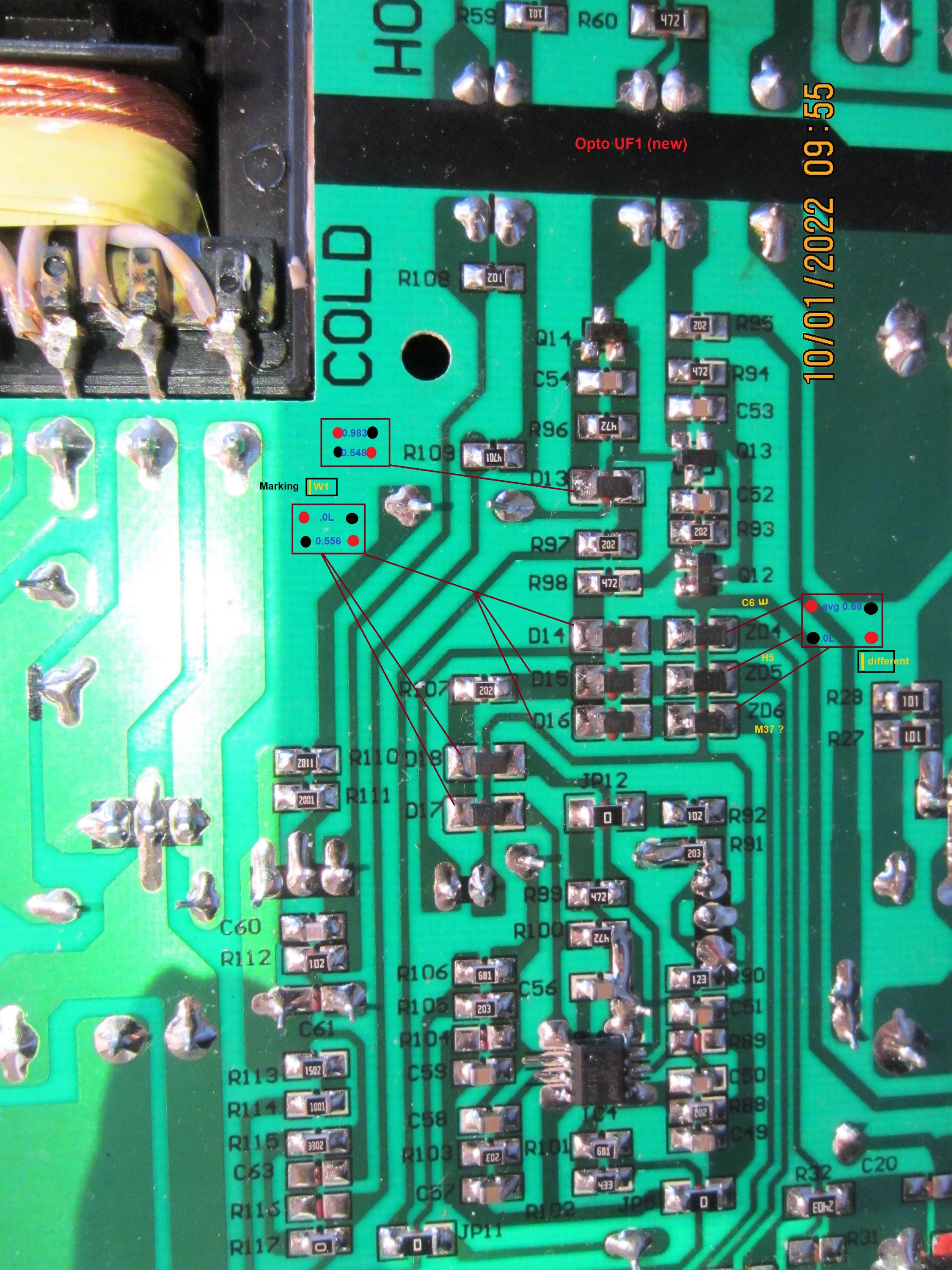

              #206
              Re: Can you dignose from the photo ? . Toshiba 65S2650EV
              Check this out
              D13

                  #208
                  OK. will do.
                  Do you think I should check D13 Diode Out-Of-Circuit ?

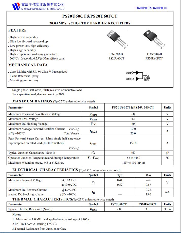

                        #211
                        Heatsink out
                        2 x 60FCT
                        2 x 100FCT
                        Any special way to check these Schottky ?

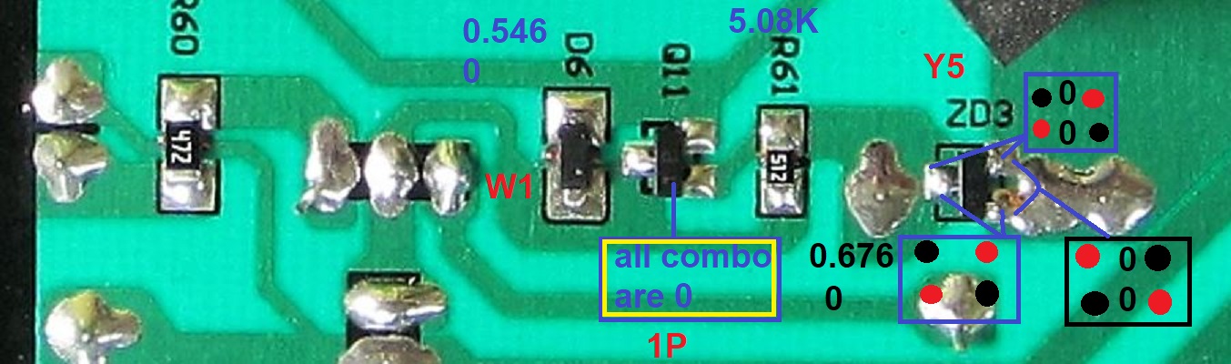

                                  Where it is the fast reply box??
                                  Check the path from q10 to ic2, so D6, Q11, ZD3, R81..
                                  • Ancient1
                                    • Dec 2019
                                    • 275
                                    • Israel

                                        #219
                                        See Photo
                                        Q11 is a transistor
                                        Resistors near IC2 are OK
