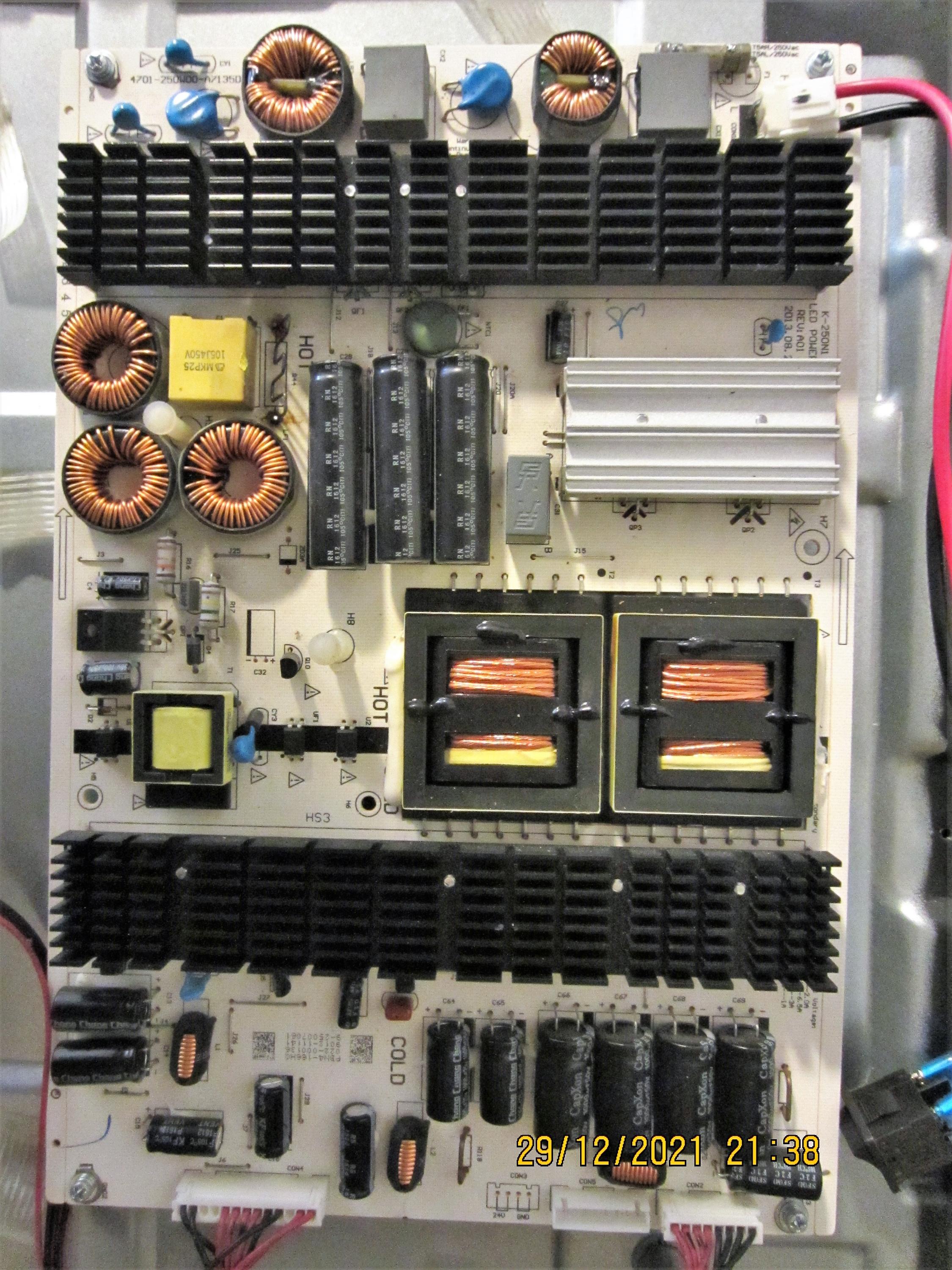

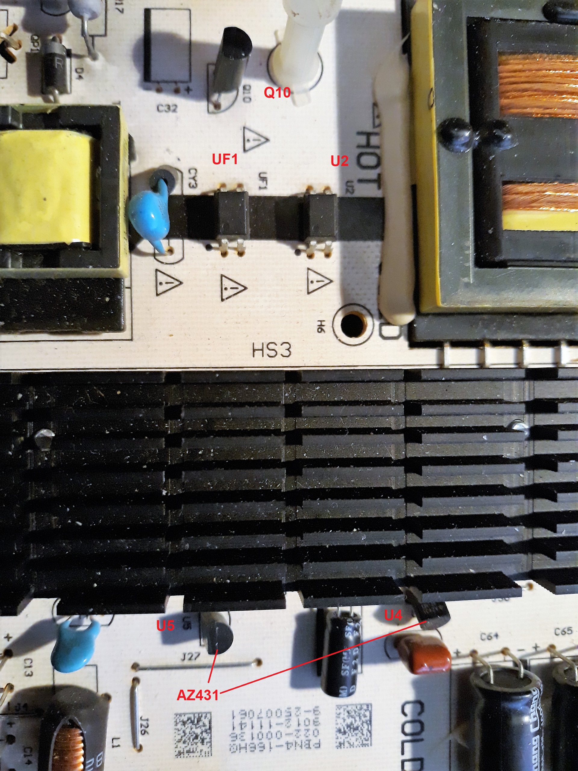

    lotas : I have "Transistor like", TO-92, AZ431. I got the PDF now.
    Davi.P
    1. I can replace , as I bought 2. But Vcc is now fine, last time I checked.
    2. What do you want me to do with U2
    3. " I see QF1/2 , it's not clear," = you made a mistake ? or .. where are they

      Re: Can you dignose from the photo ? . Toshiba 65S2650EV
      1. can you answer about plastic bag?
      2.to replace it, but i would put attention first on the ic2
      3. I mean the 2 mosfets on the large heatsink on the left on the previous photo top/bottom view, towards the ac input..

        I received new 2xIC2 in anon plastic bag.
        I attach a previous Photo of QF1 QF2 as a reminder: you saw correctly
        OK. So this is the plan :
        Measure V : IC2 and U2 and AZ431
        Measure Hz : QF1 QF2 Gate . and AZ431 too ( Cathode Anode Vref )?
        I will post results before I replace U2 and IC2 ( with the 2nd one I got )

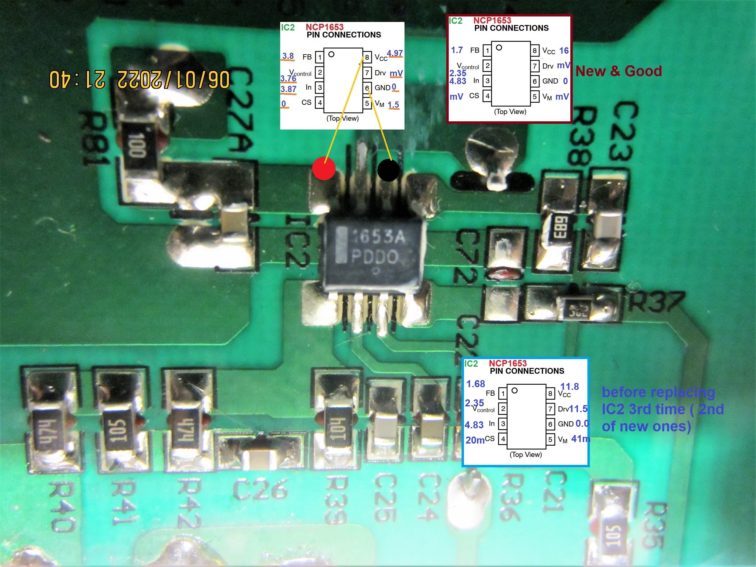

          No,some corrections:
          1-Measure V on ic2 / u2 is not useful, you have already seen V on ic2 is ok, on u2 you can apply 1,2v on the secondary side and watch if primary side conducts between 2 pins
          2-Measure hz on AZ431 has no sense
          3-replacing ic2 from the same lot has no sense, i suspect both are fake, better to buy from your country from big supplier, in my country there are 4-5 big ones like farnell, RS, Distrelec, Mouser..

            Its isn't simple to buy from Mouser here, the importer require minimum of ~$15. I will try and find..
            Do you think there is a way to test IC2 if it is OK ?
              I have no information of that chip, and how to test it..
                    Hi
                    So I measured :
                    Both QF1 QF2 measure ~3Khz
                    All the AZ431 pins fluctuate V.
                    U2 Opto : Cold side 11.4V and 1.5mV , Hot side Conducts.
                    3rd IC2 measures are in the photo .
                    I replaced IC2 and still no High V.
                    I also measured IC3 pins but ...
                    I'm done. Finito.
                    Why shouldn't I use a good PSU board instead ? I need 24V to the BL , and 12V. I'll check price of new one now

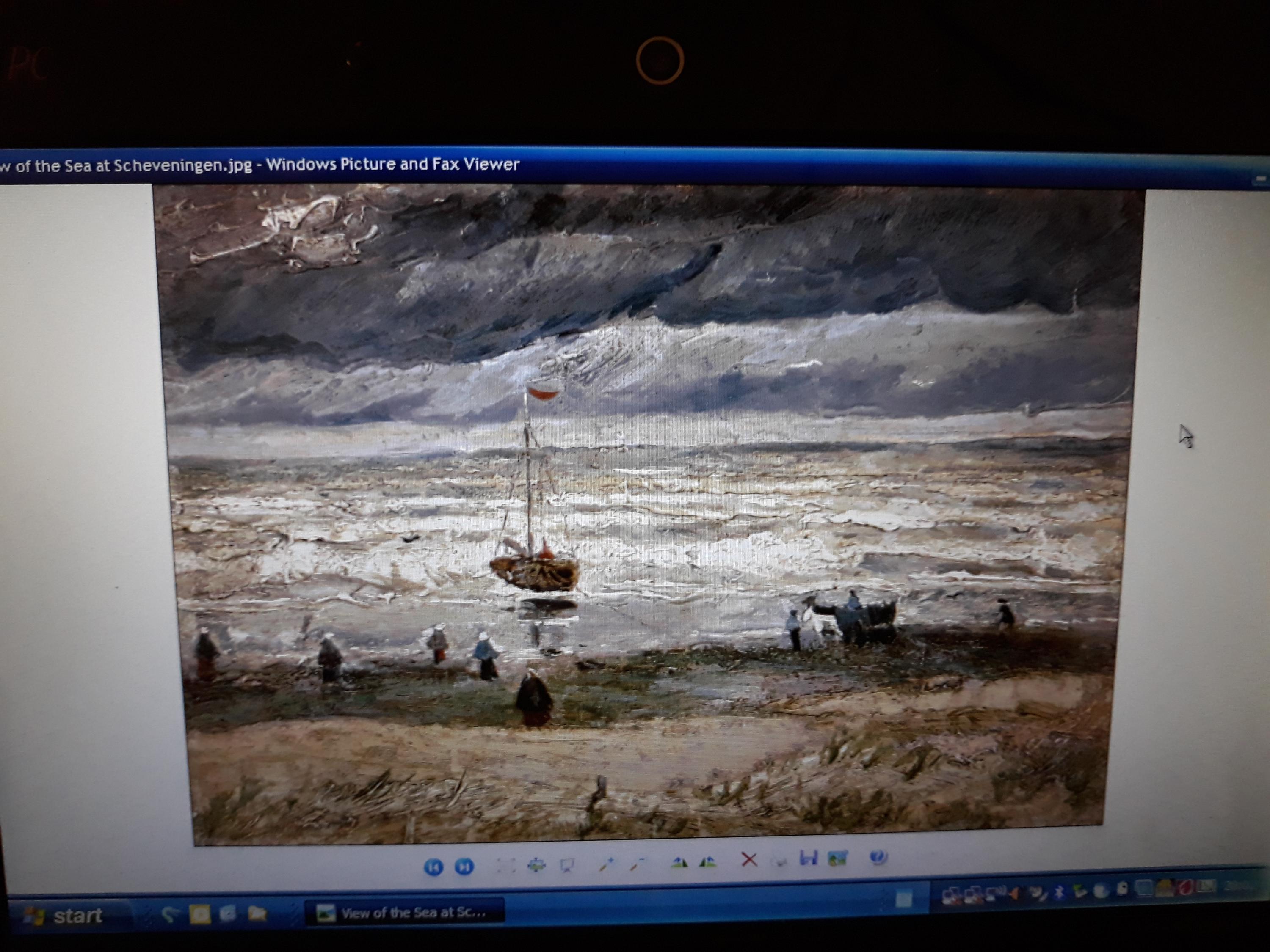

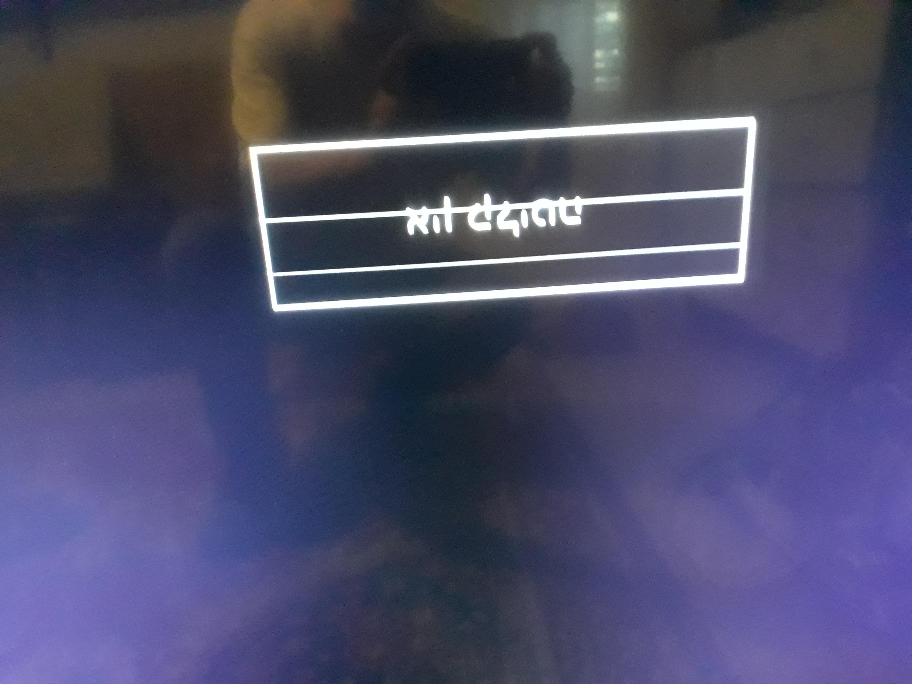

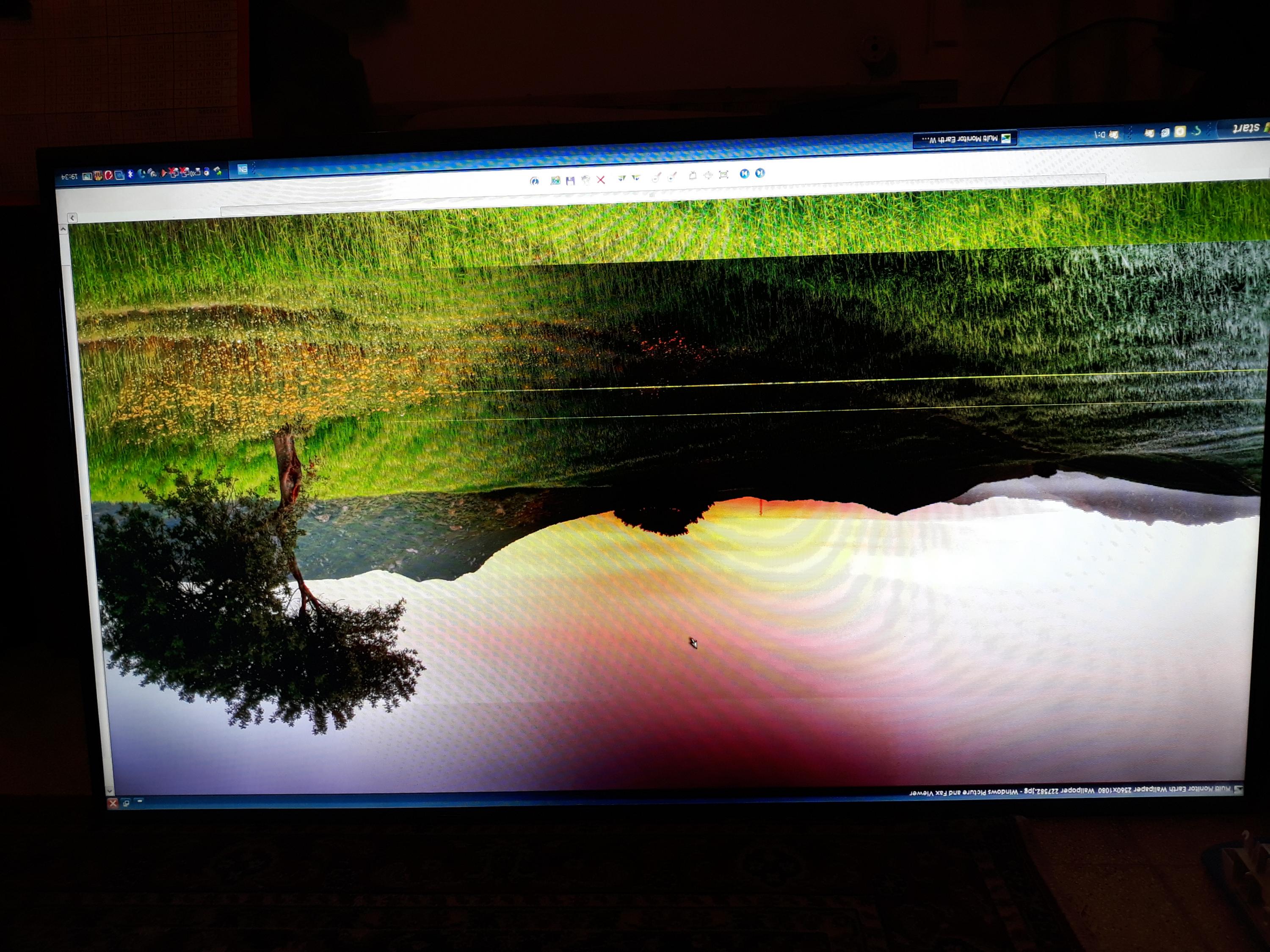

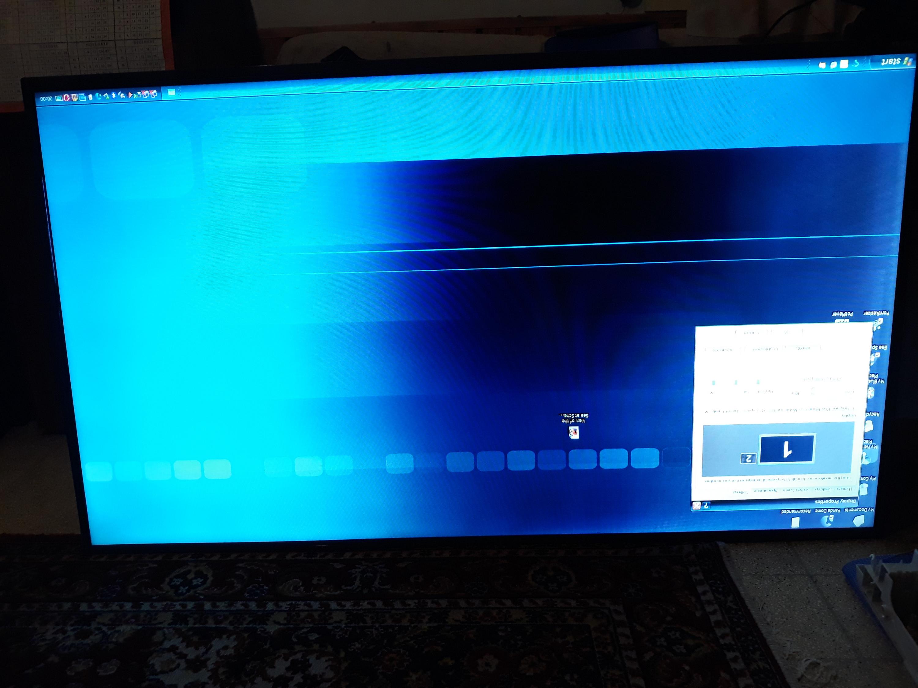

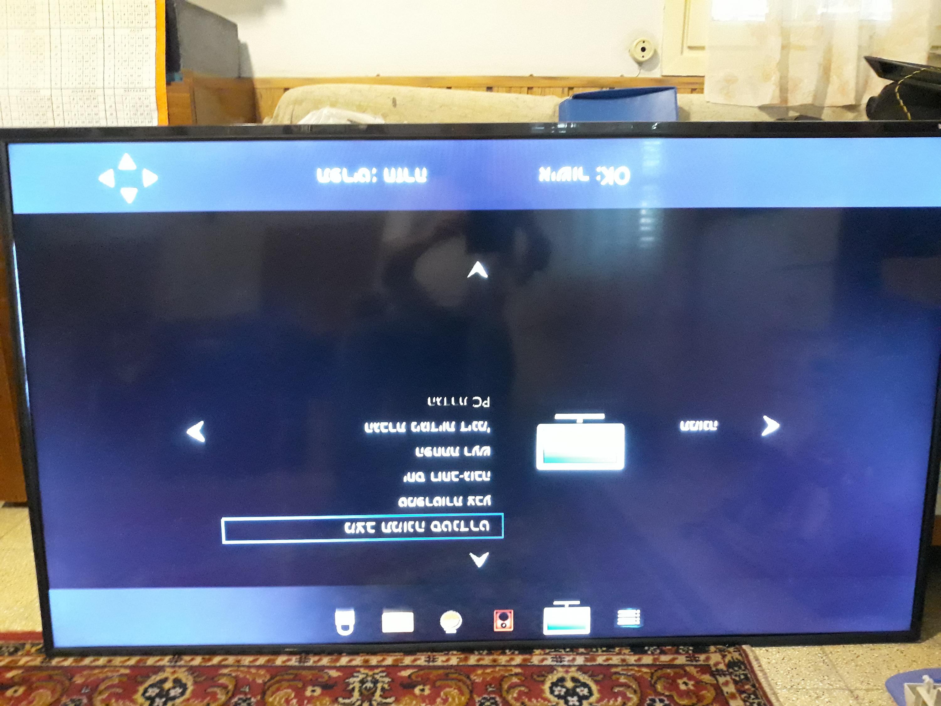

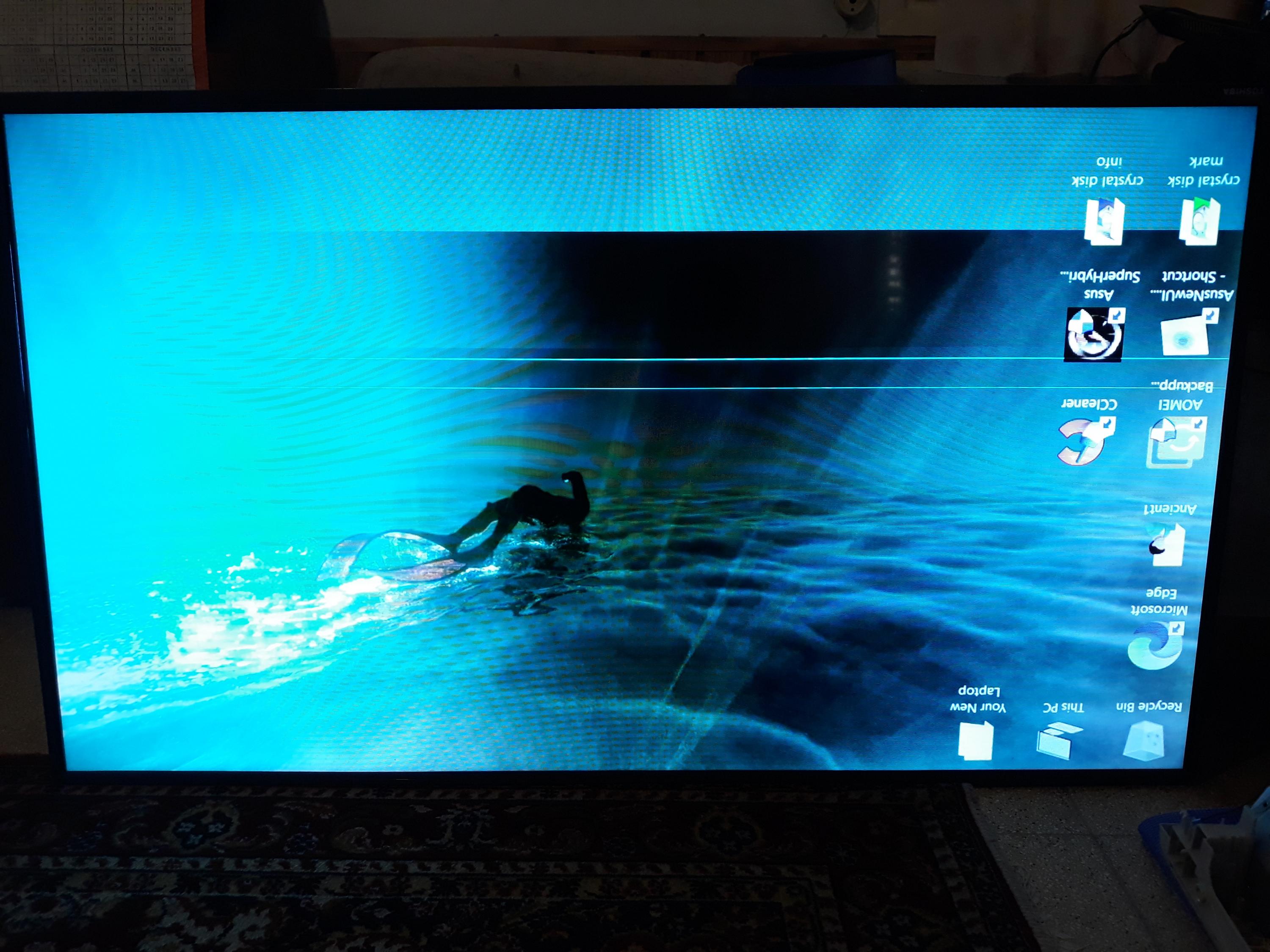

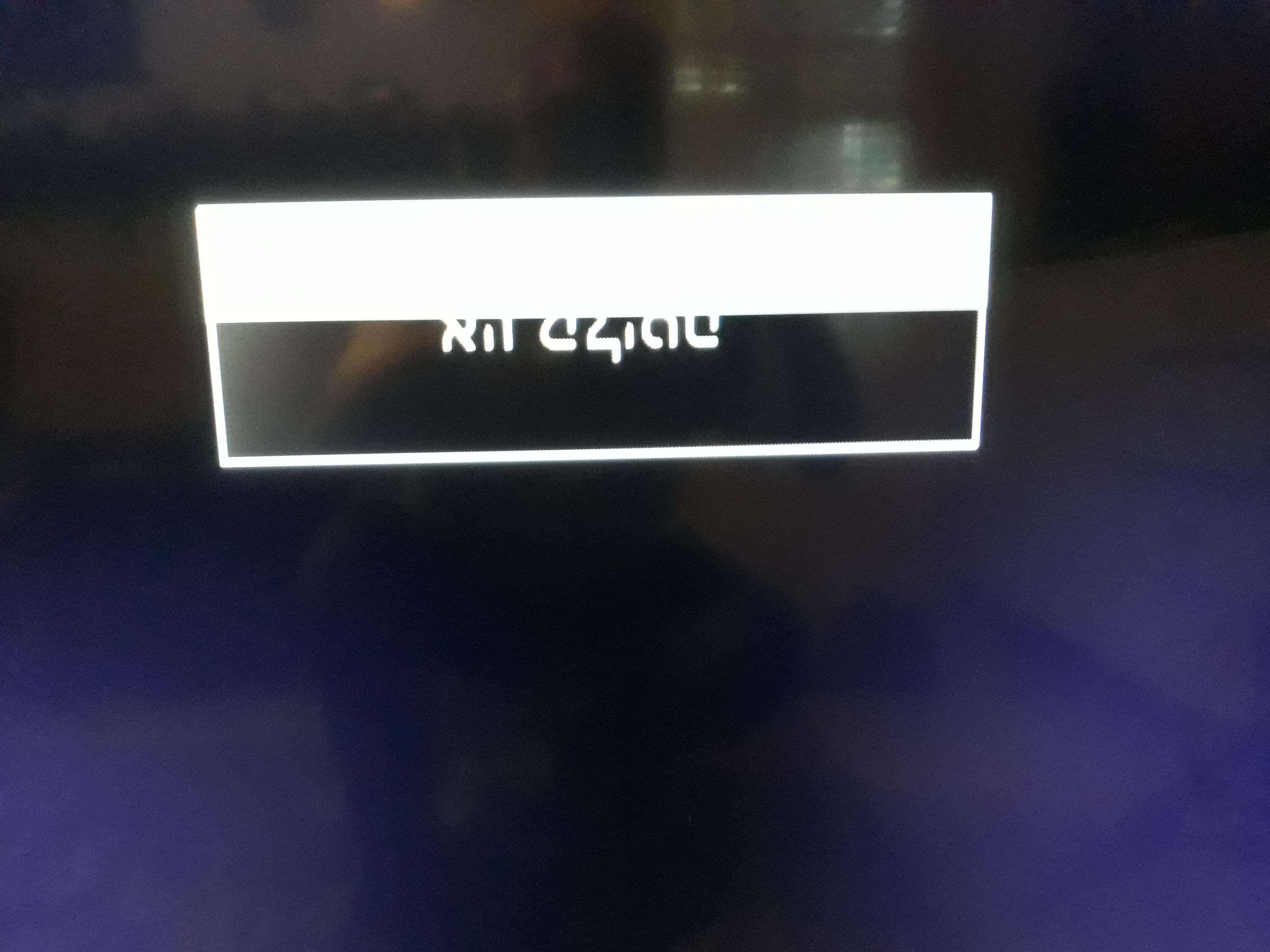

                                  WOW
                                  First try ! I was prepared for a completely messed up image !!
                                  Few anomalies :
                                  1. the "no Input" box insides split insides
                                  2. Few Horizontal lines showing
                                  But the Menu looks totally normal
                                  I will connect a laptop now, see how this go...
                                  • Ancient1
                                    • Dec 2019
                                    • 275
                                    • Israel

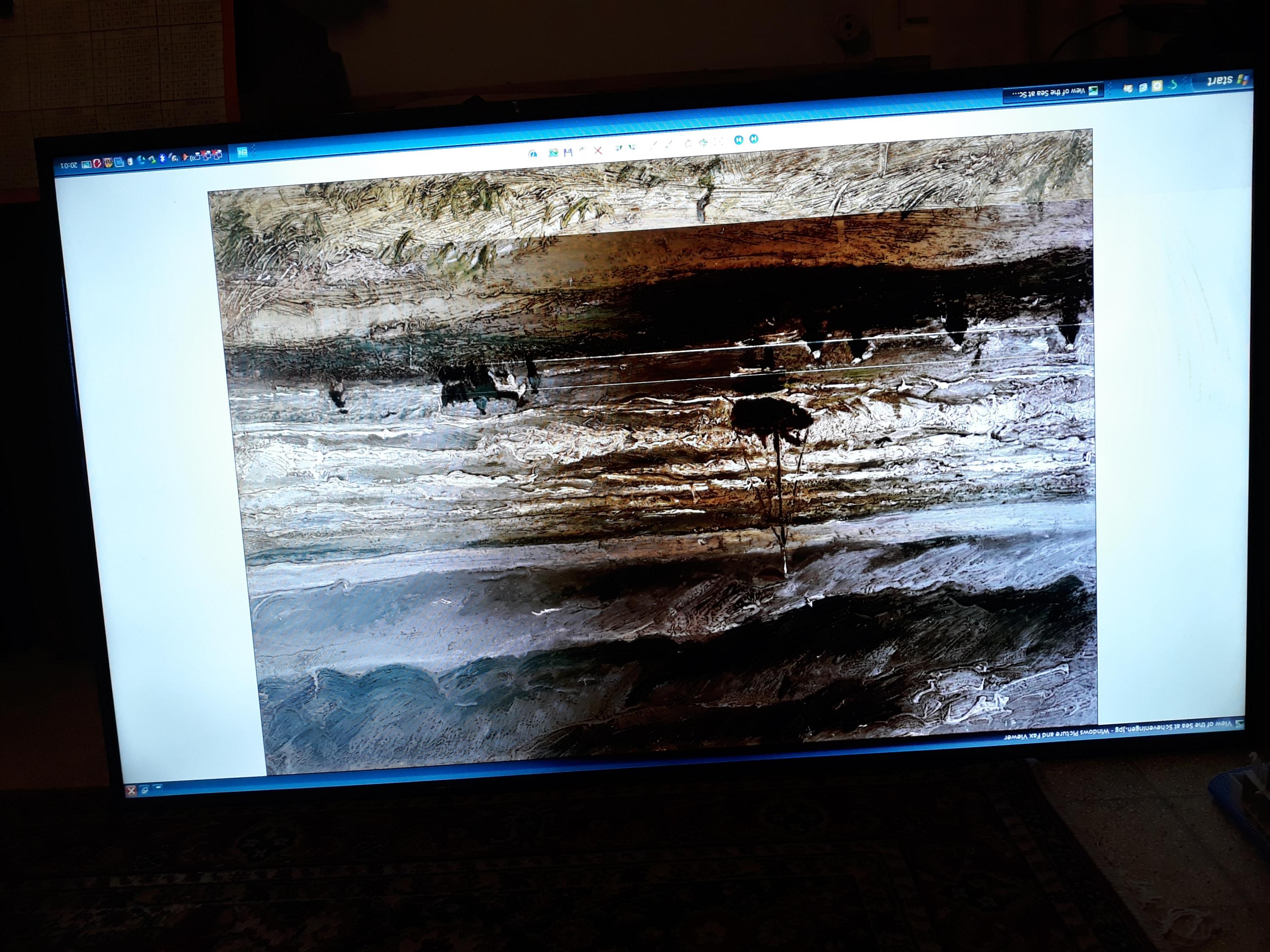

                                    #357

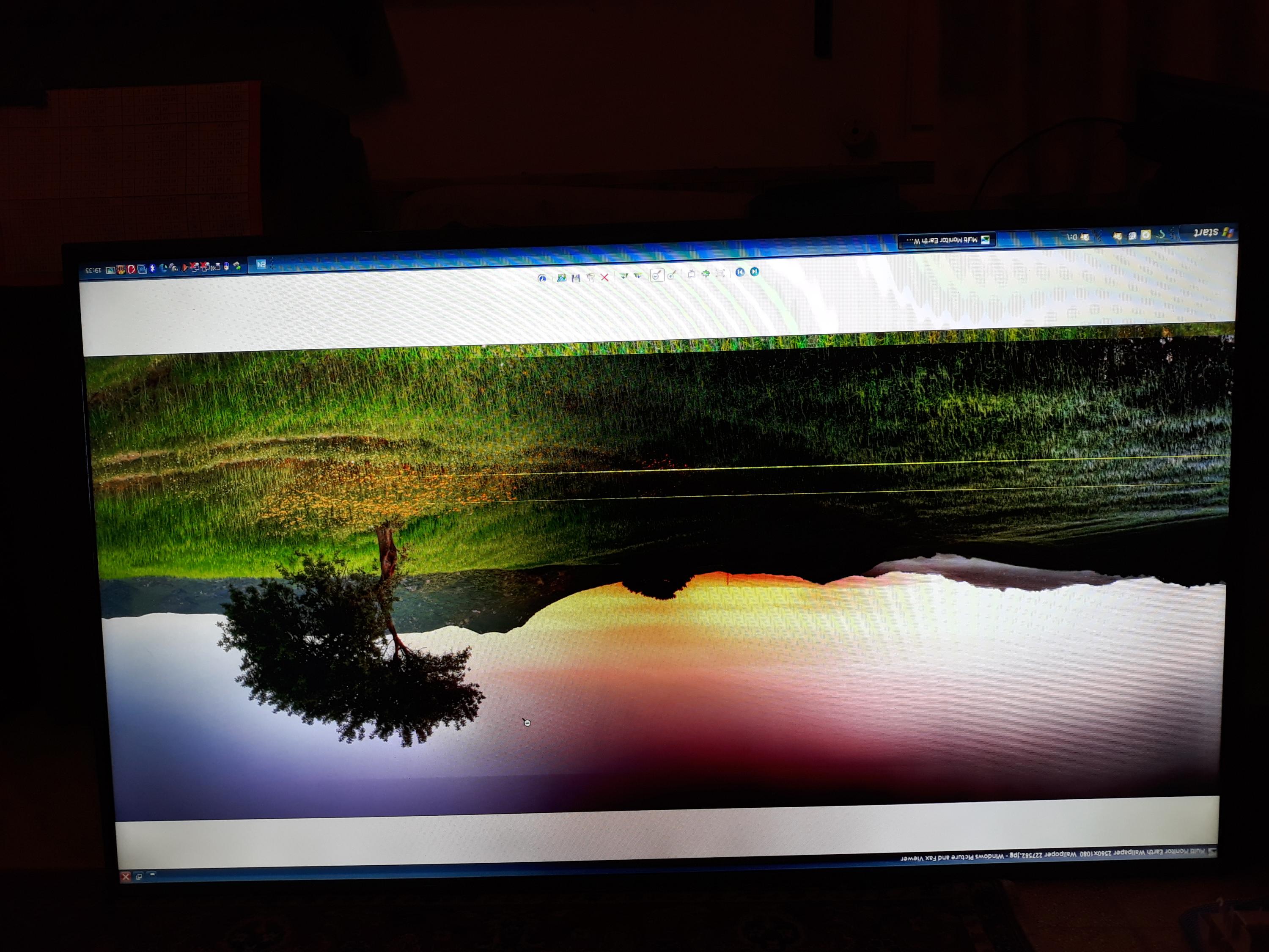

                                    Not Good
                                    1. Horizontal lines
                                    2. Horizontal Areas
                                    3. Middle Vertical area seems darker
                                    The last image (Van Gogh) painting is the original.
                                    I'll try a video to see how it actually looks = usable.
                                    What a saga
                                    by the way. the new board has a 4 Ohm metal film axial Resistor, not wire resistor

                                      #358
                                      Sorry, the patient gone... Not good new because i have a tv with similar image
                                      for the 4 ohm resistor this can explain maybe the bad experiments around the pfc area..
                                      • Ancient1
                                        • Dec 2019
                                        • 275
                                        • Israel
                                        #359
                                        I tried a youtube video too, but clearly , the image is very bad
                                        I offered a guy to give him the TV, but its not worth the effort. Clearly unusable
                                        I flipped the TV image vs the Laptop, for better appreciation.
                                        The white strip is in fact where we ripped the Tab off.
                                        The new board R was 4 Ohm and the Wire one ~2 .
                                        I'll take out what I can and put for sale. I doubt I'll get back what money I spent on it - ~$80.
                                        Oh well. Was very interesting ! Thank you so much !!

                                          #360
                                          this is interesting... indeed i was in doubt if ripping off all or only that tab on the side, but seeing this the tab must be removed all , those maybe interferes with others side, stupid me..
                                          the image on the ripped band appears ok..
