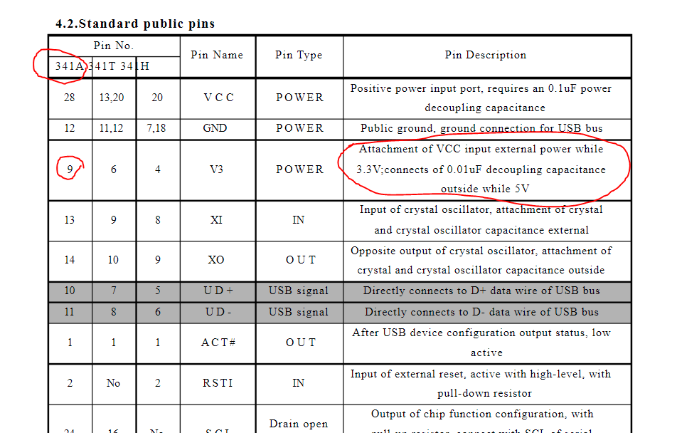

    Sorry Lotas. My programmer is the one in the attached picture. What are the improvements I need to make to make it work better?
    • lotas
      • Jan 2016
      • 4597
      • Russia
      #442
      WARNING: If the /WP or /HOLD pins are tied directly to the power supply or ground during
      standard SPI or Dual SPI operation, the QE bit should never be set to a 1.
      To correct this drawback, you need to disconnect the legs #WP (pin 3) and #HOLD (pin7) from VCC
      and connect them to VCC through 4.7 kohm resistors.​

        #443
        Basically, should I make the two changes?
        • lotas
          • Jan 2016
          • 4597
          • Russia
          #444
          Yes, above is a diagram with modifications to the power supply (blue, don’t forget about 9 pin) and the addition of resistors.

            #445
            Some doubts:
            Should C1 and C2 be eliminated, and should the tracks be connected or left open?
            Is there any connection to be broken beyond contact 28 of CH341A ?​

                    #449
                    Originally posted by lotas
                    Yes, above is a diagram with modifications to the power supply (blue, don't forget about 9 pin) and the addition of resistors.
                    Some doubts:

                      #450
                      Originally posted by Salvocchio
                      Some doubts:
                      But everything is clearly drawn in the diagram, remove the ceramic capacitors, put tantalum capacitors in their place (the capacitance is written in the diagram), the resistors are placed in the gap (the tracks are cut).

                            #453
                            this diagram old version of the programmer... the black one only need the vcc to move it to 3,3V.. that's all . i have one just have this modifying of VCC,, no need connect it to pin 9 other wise it will be short circuit on the black one

                                #455
                                If you completely switch the programmer to 3.3v power supply, then 9 pin is connected to 3.3v (there is absolutely no need to install a jumper for 5v power supply!)
                                https://vil2.livejournal.com/780.html

                                    #457
                                    NO lotas.... pin 9 on black one.. no need to connect at all.. even remove C or add R no need too.... just VCC bridge it to 3.3v to protect spi eeprom if they cant handle 5 V... again only the black ONE samre to post photo # #441 with out any add of r or cut rail

                                      #458
                                      Open the datasheet on CH341A and look at 9 pin if you switch to 3v power supply. In the circuit for modification, there is no need to remove the capacitors, but replace them with tantalum of higher capacity.
                                      https://4pda.to/forum/index.php?show...st&p=125980884
