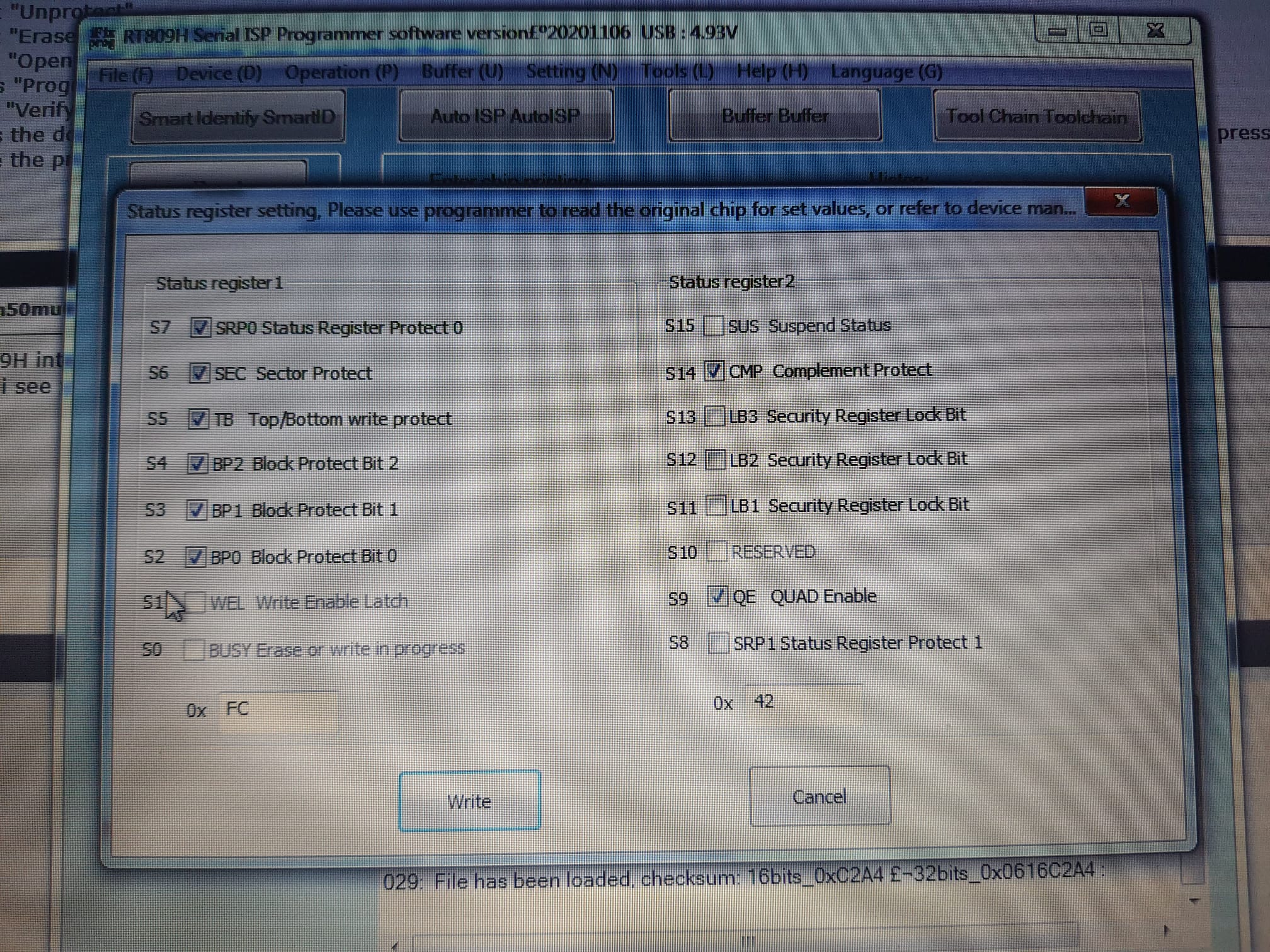

            • crym1111
              • Feb 2022
              • 20
              • Romania
              #66
              Re: Un50mu6070 Mainboard issue
              On RT809H interface must be set anything in tab Protect when you read W25Q40 ?
              Because i see your info when you have to click to programming IC's...

                #67
                https://www.badcaps.net/forum/showpo...1&postcount=17
                Try

                        #71
                        Originally posted by crym1111
                        I see that you write in the post:
                        In the program:
                        1. Click "Detect Chip" and select W25Q40CL and "Select IC".
                        2. Click "Unprotect".
                        3. Click "Erase IC" and "Yes".
                        4. Click "Open File" and select your corrected Dump.
                        5. Press "Program IC" and "Yes".
                        6. Click "Verify IC".
                        7. Press the down arrow to the right of "Unprotect" and select "Edition SREG", put a check mark on S7, S3, S14, S9 and press "Write" and "Yes"
                        7. Close the program. Ready.
                        I wrote this instruction for CH341A (AsProgrammer and NeoProgrammer)

                                        • Diah
                                          • Feb 2013
                                          • 6501
                                          #80
                                          lotas modifying are correct , the problem with active STBY LED indicator are HW issue not SW.
