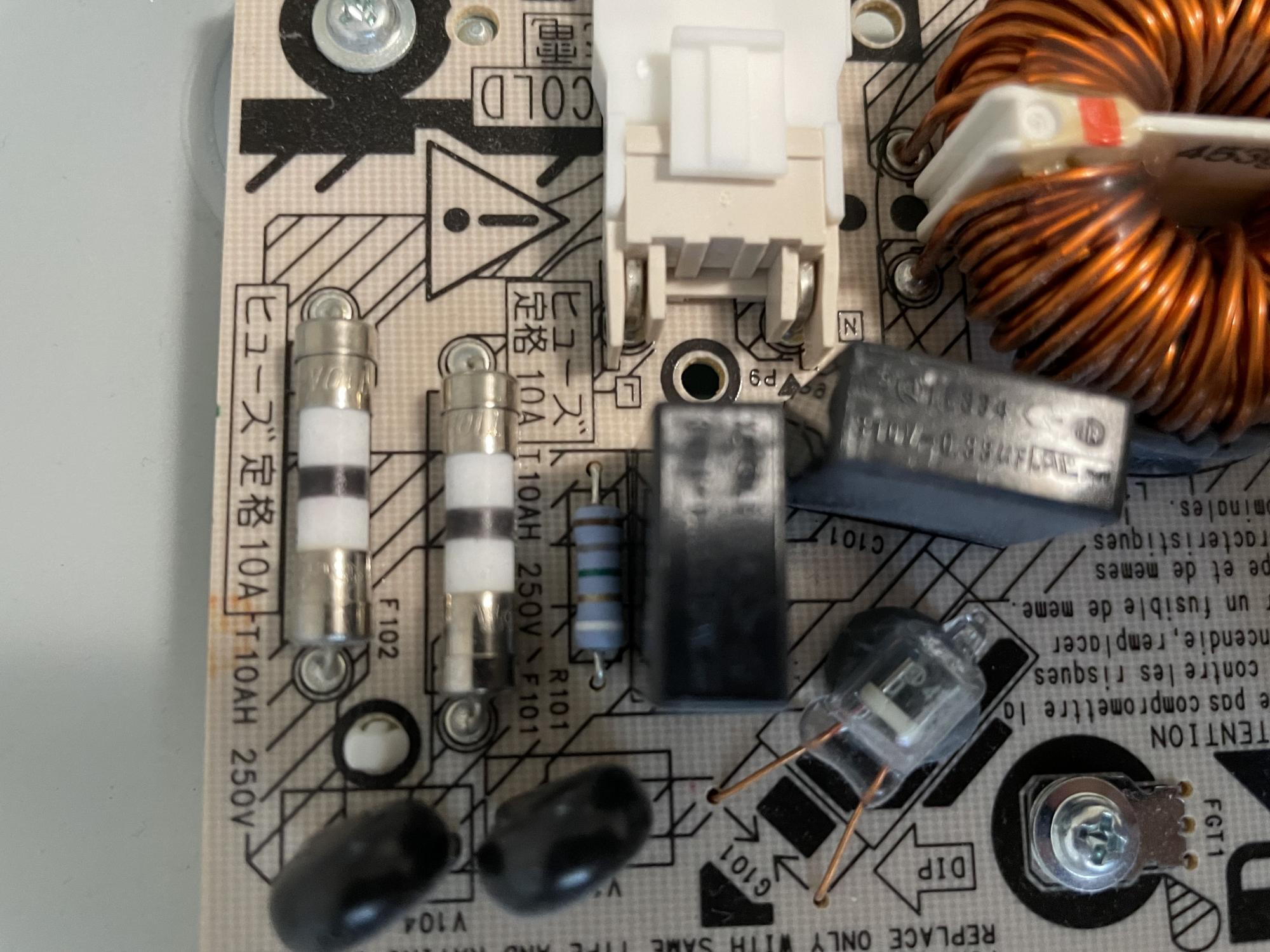

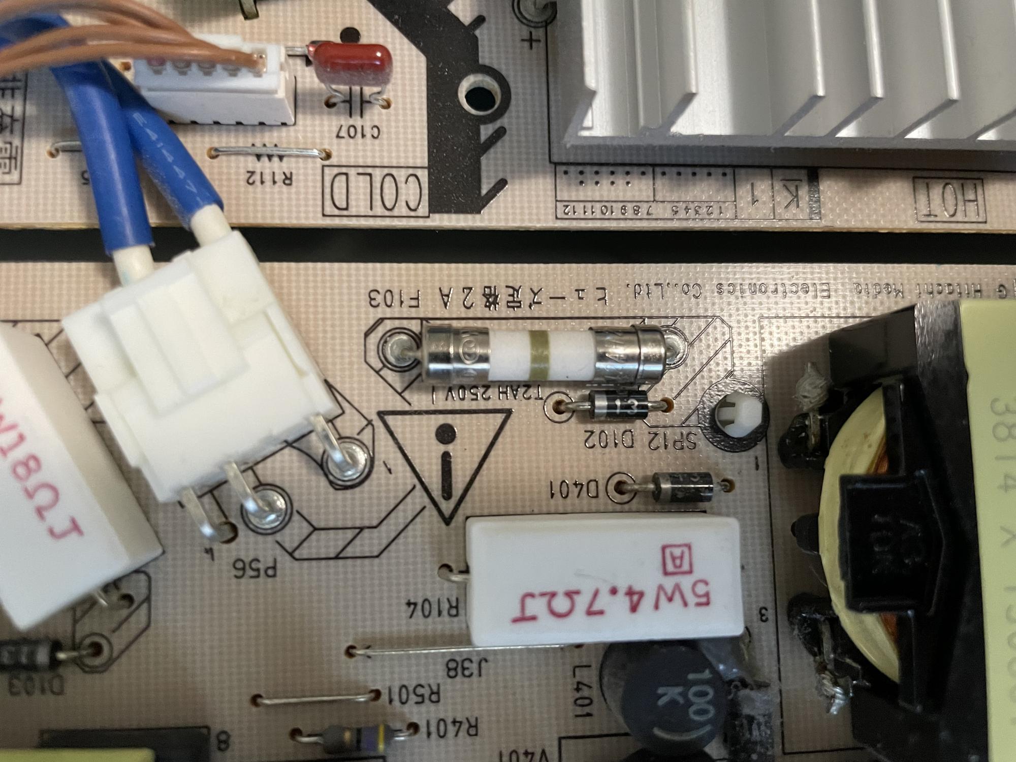

      Originally posted by Davi.p
      Yes for the 1 & 2 pins, but since there is a source pin there is / are also a 2w less than 1 ohm resistor connected to source or many smd resistors in parallel (1/2 ohm). Why you have guessed 470pf?

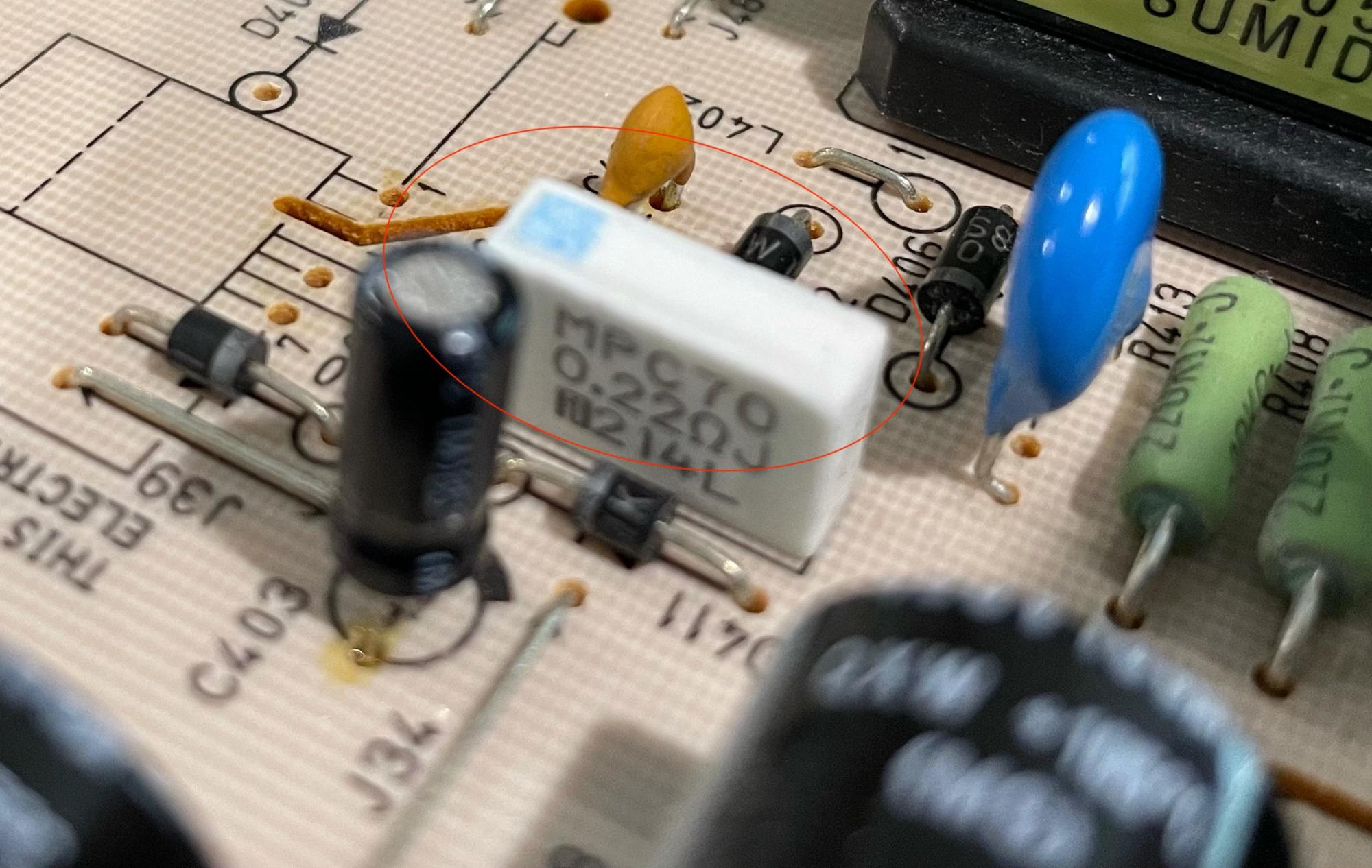

      There is a ceramic resistor beside the blown capacitor around 0.32 ohms. It seems to still be good, but my multimeter is not accurate enough to say for sure.
      I had to guess the blown capacitors value by comparing the size of what was left with the rest of the capacitors on the board. Not very scientific haha.

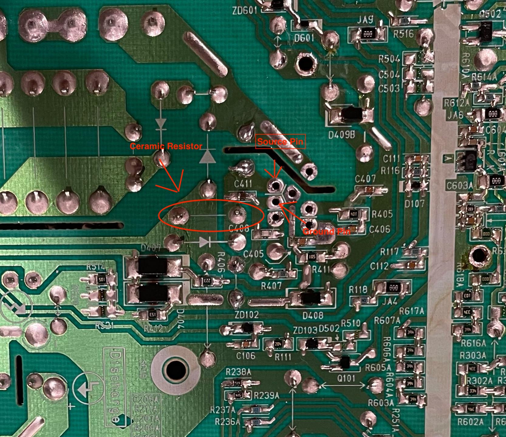

          Looking closer at the pcb, I think c411 is in parallel with the ceramic resistor Davi.P mentioned. That would explain the short right?

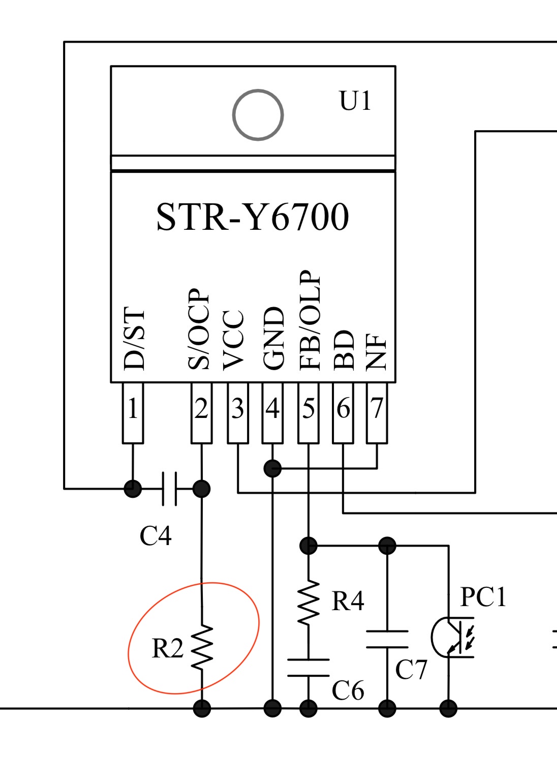

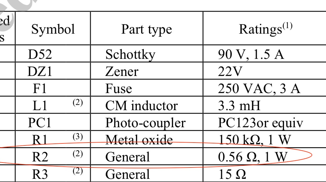

                    #29
                    Re: Please help me fix my beloved Panasonic TC-P65ST30
                    I don't advice to you to sleep quietly waiting, check the datasheet for the typical application circuit, if connected to the source pin there's a small value resistor to ground, then you surely have to change that resistor...
                    I think I found the resistor you mentioned, but previously you said it wasn't it? Can you please confirm. I've attached the following:
                    1) The data sheet example circuit showing there must be a resistor attached source, R2
                    2) The example value of R2
                    3) A picture of the ceramic capacitor that I think is R2 (can't measure it well resistance too low)
                    4) A picture of the opposite side of R2 facing the side where the ceramic capacitor blew up showing a slight black mark.
                    5) the back of the of the PCB showing that Source and ground are both attached to each other via this resistor in parallel with the capacitor C411.
                    Sorry for all that. Are you saying I should replace this ceramic resistor?

                      #30
                      Ok maybe that resistor is good, But with the shorted mosfet, where the circuit is open? if not it can catch fire..

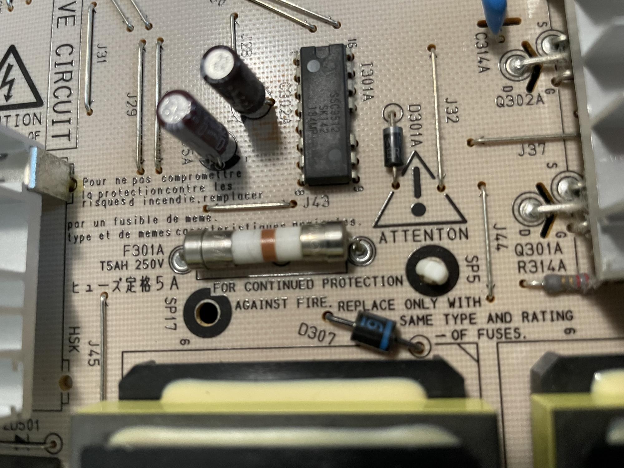

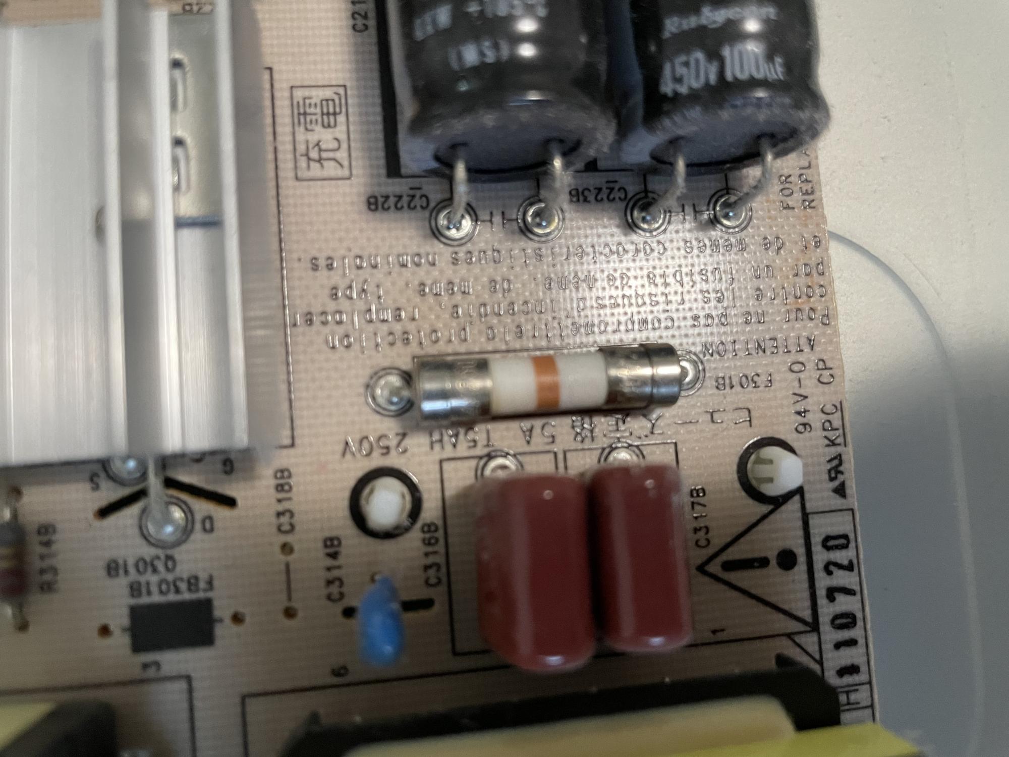

                                      So, new mosfet from China arrived with new caps from digikey. Replacements parts were soldered in, but still no power at all
                                      Maybe it's a fuse?

                                        #39
                                        You told that fuses are ok... Measure D pin of I401, if 320 or 160v is present Replace R403 and check again I401 for short on D-S

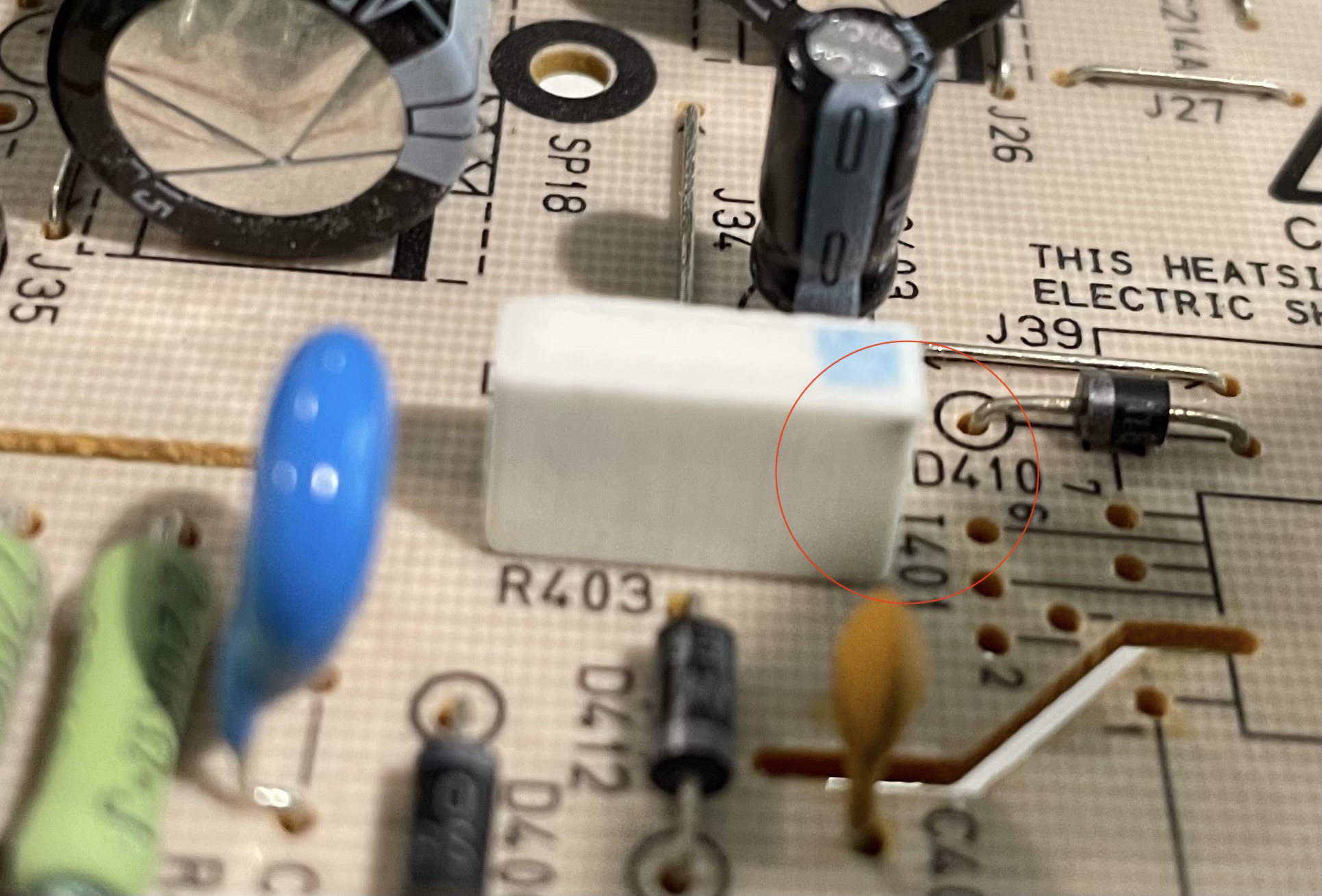

                                          Sorry it took so long to reply, life kept me busy. No short from drain to source and double checked all pins soldered correctly. Not sure I can check the voltage while plugged in with my cheap meter safely. Since drain pin is right above the heat sink, it would be easy to short. I could buy a replacement resistor on my next order instead.
