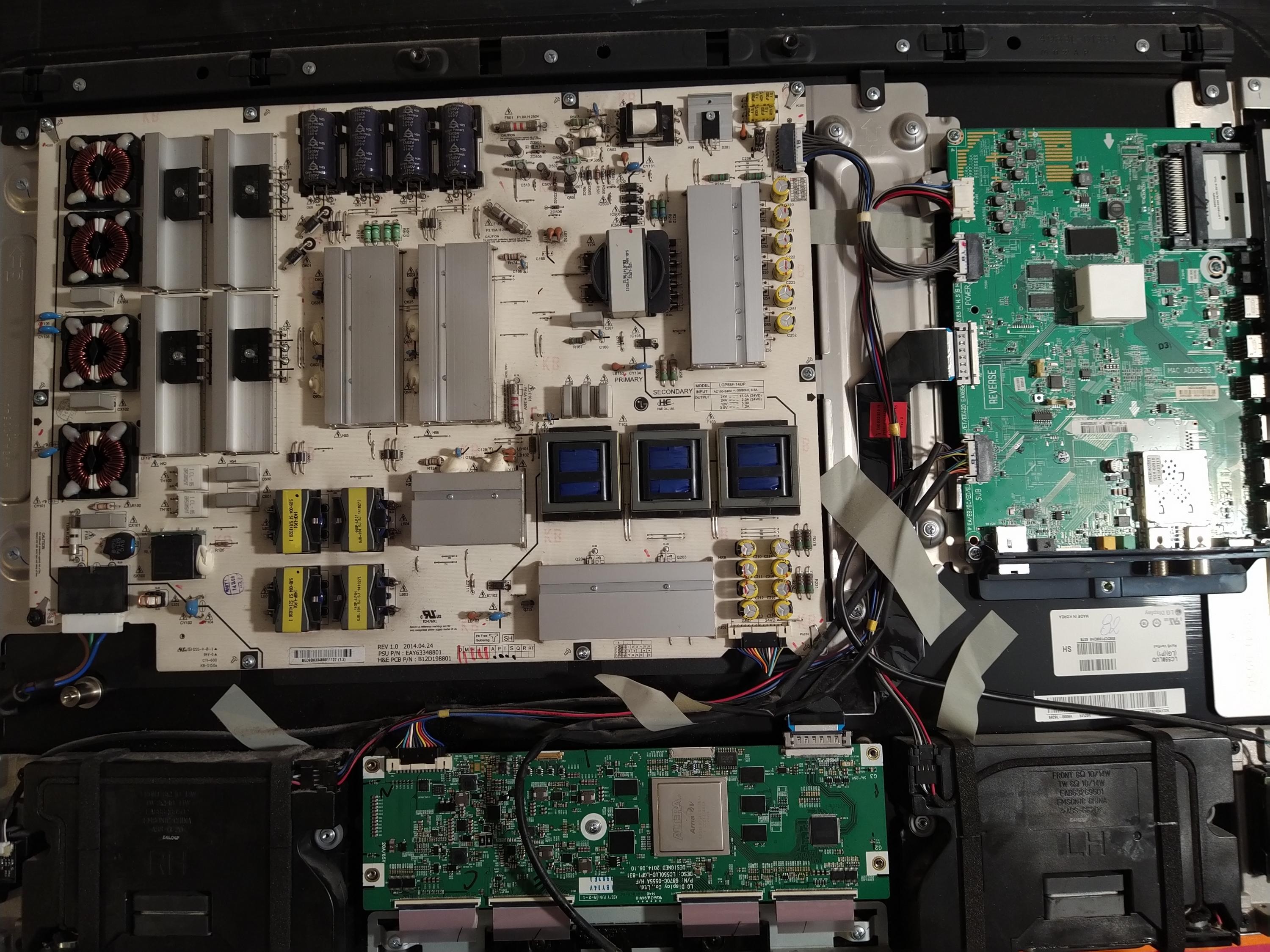

    Hi everyone. I am trying to fix my LG curved TV.
    So i have been checking the several topics on this TV here at the forum but i am struggling into solving the issue. I am not a pro with electronics, so i will try to provide every detail i know:
    - Screen is all black, i've never managed to have anything shown at it during my repair "tries"
    - If i use the remote to turn it on, the "LG" led goes off after a couple of seconds.
    - Inserting a USB Pendrive feeds it correctly, i can see the pendrive led flashing correctly.
    - If i connect HDMI source with sound, it will play the audio, but no pic whatsoever
    - Tried to follow the SMPS testing procedure, to my best knowledge all the voltages are as they should, although i have not checked comprehensively
    - The Mainboard shows the red led when "turned on", but no image
    - P202 24v voltages are all in good shape, measured with multimeter. No problems here.
    - I've tried to get a TCON from another TV. It isn't exactly the same (i mean the board chip layout, for example it does not have the "metal covered" chip that mine has. But hey, it's from the same TV model so it should work right? But it doesn't... maybe it is also not good?
    - Screen has no apparent cracks or dings
    I can't seem to show anything at the screen. Always black. Tried to remove the 4 TCON LCD connectors, still black.
    I don't have an IR blaster. I don't know what else to i can do.
    Please someone may help?

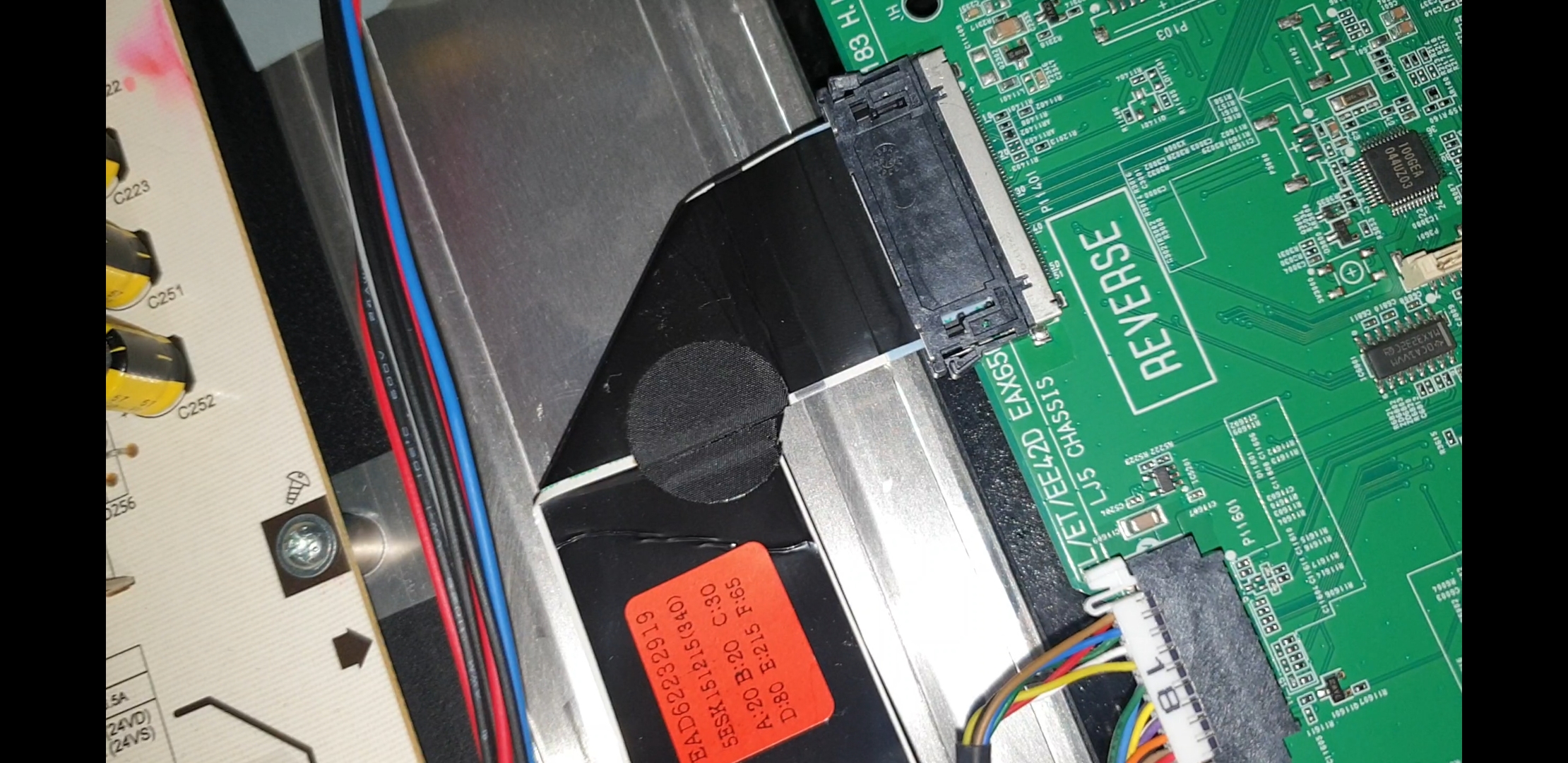

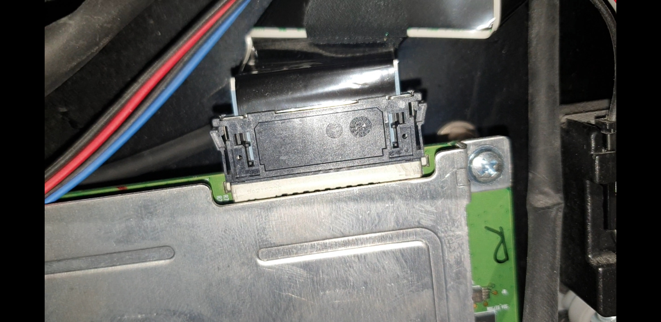

        Do you have pictures of your LG ?
        And please a good Picture of your LVDS Connector.

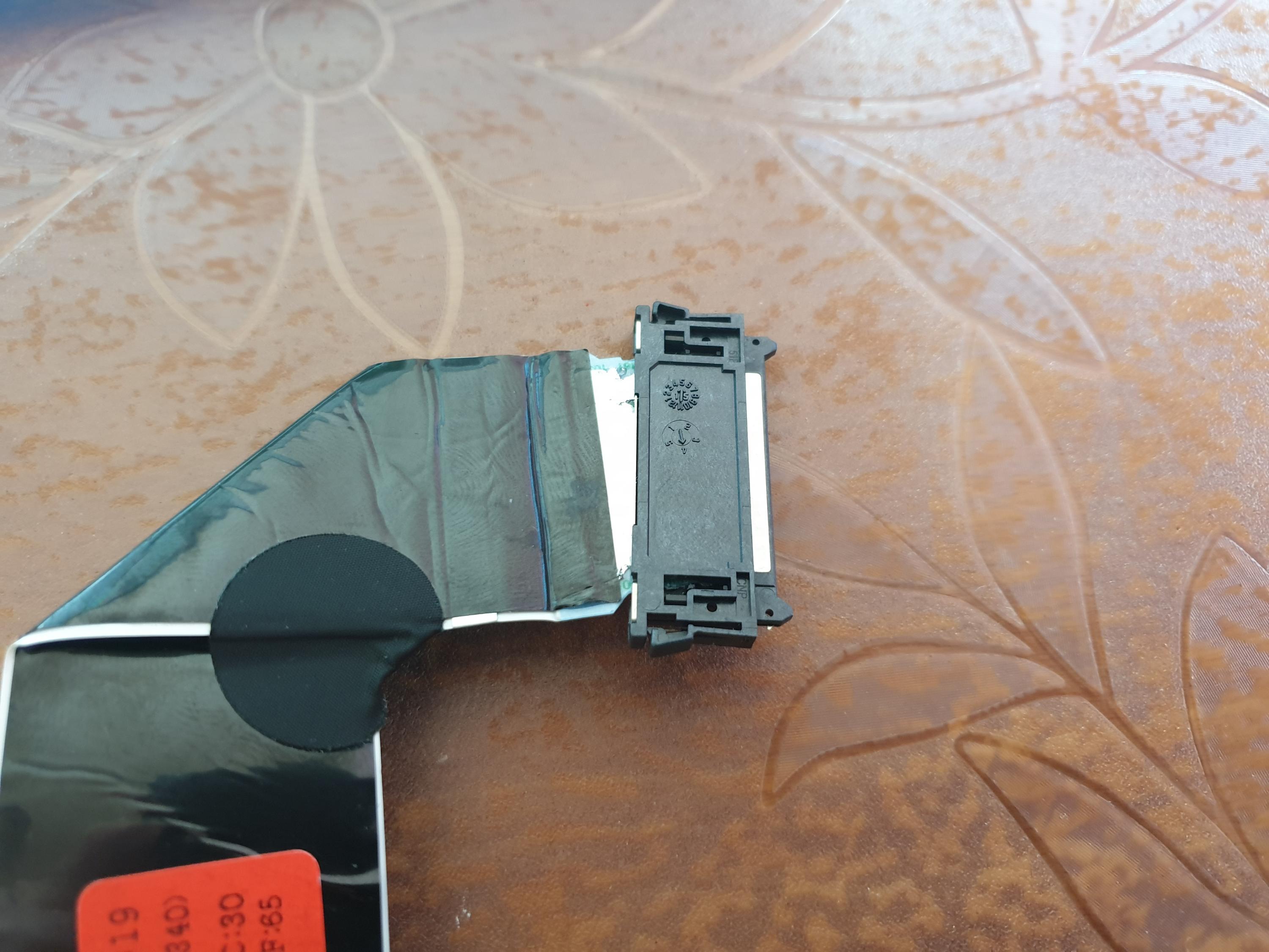

        I will upload some images, where my LVDS cable was broken. ( i broke it lol)

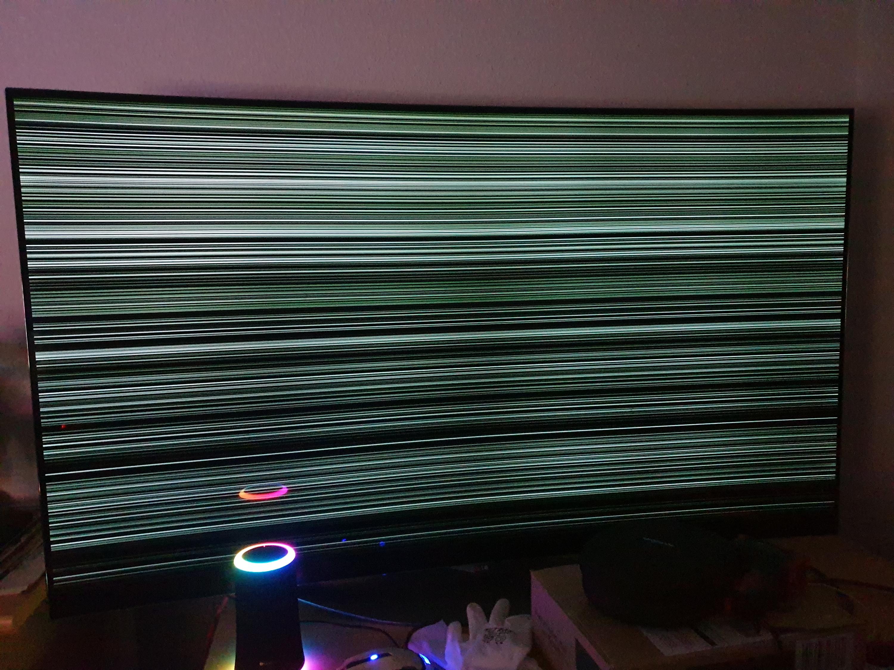

        • TeslaMichael
          • Oct 2020
          • 102
          Re: LG 55EC930V - Sound but no image - Please help
          Ok, here some Images.
          This green Line Image happens because my LVDS cable was missing. Maybe your LVDS has a little damage, that the screen is dark. i don't know.
          Or you Image Driver is sleeping, like someone said in this forum. i read, it helps if you plug in a USB Stick with a video in mp4, and a mouse. then you have to click often the mouse buttons and move it.

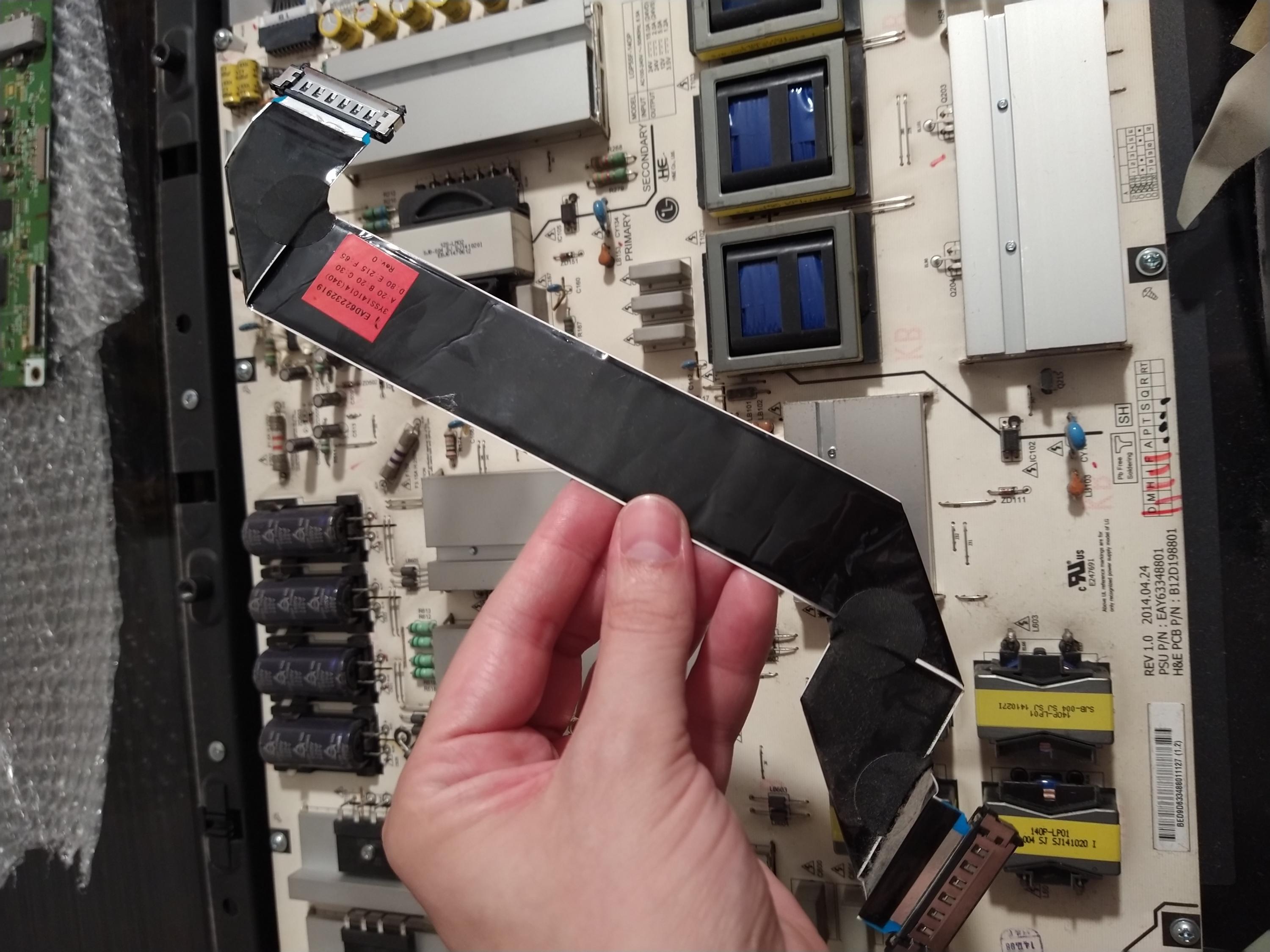

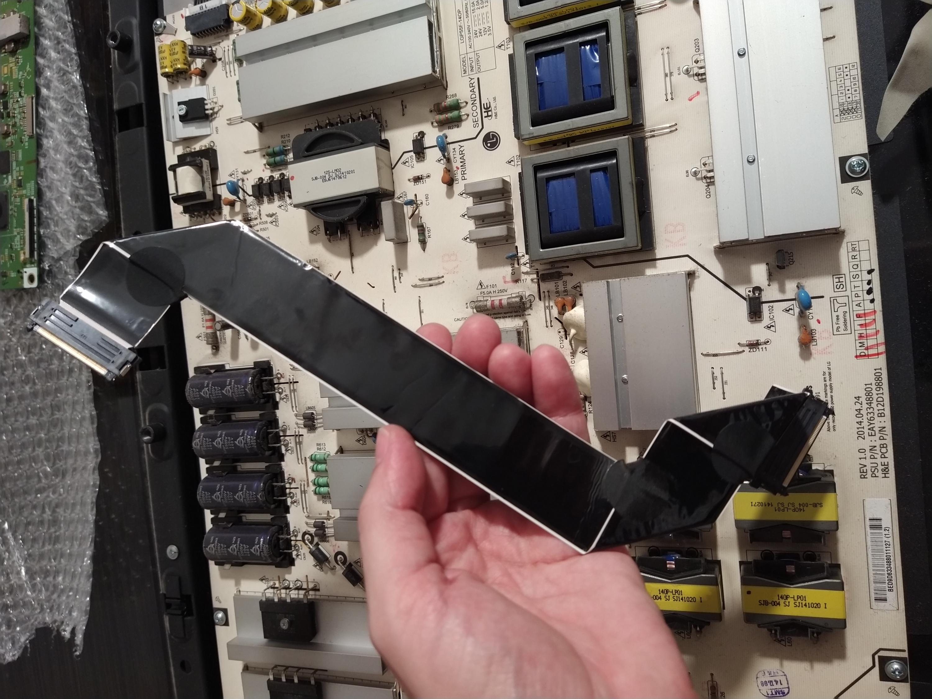

            @TeslaMichael thank you a lot for your replies!
            If i disconnect the LVDS cable out of the TCON board, and turn the TV on, i keep hearing clicking noises every second or couple of seconds - before it didn't do that. But the screen is still black as hell - no change whatsoever. The LG logo light, doesn't turn off, however.
            So here it is a pic of the whole board set and two pics of the LVDS cable. Everything seems alright i guess?
              Looks like the cable is not perfect in the connector. Did you remove it often already ?
              If my lvds cable is connected, i see no metal body of the cable, only all black. I try to upload a picture from my phone.
              And I don't know if it matter if you remove lvds from t-con or Mainboard side. But i can say, my TV was running when i removed the lvds cable. But the first try to turn it on didn't worked. I had to try again to power on.
                My new lvds cable, should look like this.

                      Interesting. I had never removed it before, so i guess they have installed it like this when assembling the TV. Maybe this cable is not the cause of the malfunction, even if has some bare metal showing
                      Yes, it definitely looks different from yours. I'll keep an eye to try out another cable if everything else doesn't work.
