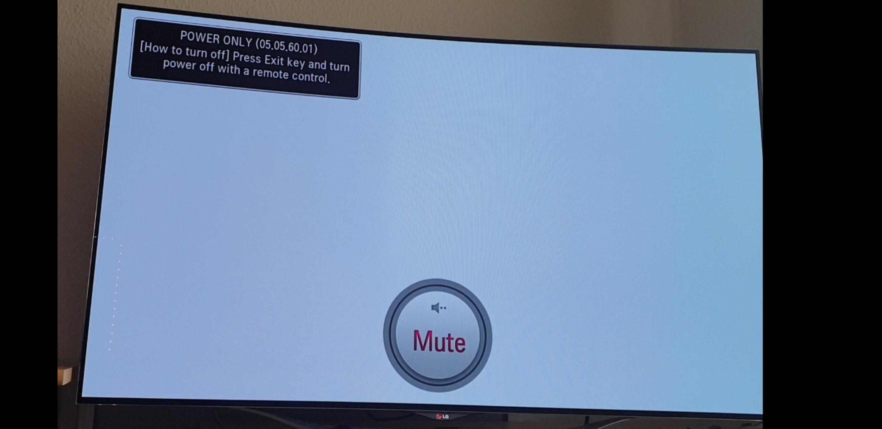

    Re: LG 55EC930V - Sound but no image - Please help
    Pic
    • TeslaMichael
      • Oct 2020
      • 102
      BTW. you could reset the TV with the Service remote.
      How to:
      1. Boot TV in Power Only Mode, then turn off by pressing Exit key, followed by power key on remote.
      Then he should go off and clicks.
      (Please make the room a bit darker, to see if there is anything on the screen.
      2. TV is now in Standby. Press it on by Remote. You can't hear a sound if TV is on, but you could switch the Inputs with the Service Remote i think.
      3. Then if he is on with standard boot, then take Service remote and press in-stop.
      This should reset the TV. Then if you turn it on again, it will take 3-4 Minutes to intialise. But you should see already a text, "WEBOS".
      Maybe this works to get the screen working again. Because i read, everything get's reseted (Eproms and other things)
            Originally posted by TeslaMichael
            Okay thats good. What happens if you press the Power Only button ?
            The tv should start with a white screen. And the lg logo should be bright if he is on, in power only.
            You leave the mode with the the key exit and power off. Then the tv turns off.
            Pitch black.
            I see the LG logo led glowing without desapearing, though.

                  • TeslaMichael
                    • Oct 2020
                    • 102
                    #29
                    The screen flashed white, the complete screen ? I would say, panel ok, and the issue is on t-con or Mainboard. But we need to know more.
                    It sounds to me that you removed the cable from MB to T-con while the tv was running?
                    If yes, did he shut off after that flashing screen or the was TV still on ?
                    And if the the LED is off, tv is telling, there is a issue with the video output. The LED should be always on.
