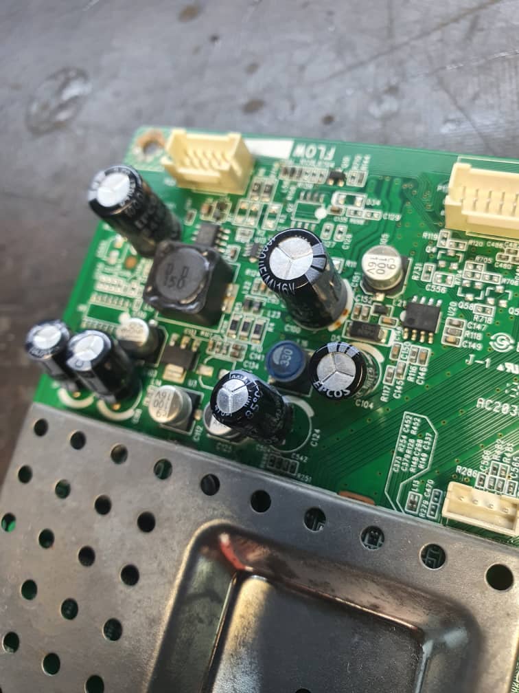

    Hi.
    I have a Philips 42PFL3609S/98 TV that shuts down after some time. If the TV is not power overnight and is powered on in the morning then it will last longer sometimes up to 2 hours. After the first shutdown, it will be more difficult to switch it on again. It would be easier to restore power if I remove the AC cord and plug it back again.
    Replacing capacitors C805 and C804 didn't solve the problem but made the running time last slightly longer. The old capacitors were giving me a reading of 920 uf. C840 and C840A are giving out a reading of 72uf and were not replaced. The rest of the capacitors and diodes were checked and found to be within tolerance.
    Could the problem be with a faulty CCFL? I have no idea how to get to them? There is a barely visible dark horizontal line across the screen. Any help would be highly appreciated.

            However, I noticed a bulging cap on the mainboard. Bad eyesight made me miss this cap the first time around. Removed it from the board and found the 470uf / 10V cap is giving me only 100uf. Replaced this cap now waiting to test it tomorrow.

                The service manual refers to DV10 on page 16 and it looks like the capacitor C124 is one of the filter capacitors on that line. DV10 feeds the supply to quite a few IC's so could well be the issue.

                  Today is an old lesson to understand, when caps fails them shows defect at cold... never seen one that does different... please update...

                    After replacing the 470uf/10v cap on the mainboard the tv is even more difficult to turn on. This is the symptom of failure, sorry for the background noise, getting the little one to reduce the volume is not easy. https://youtu.be/gRlltDRHOVQ
                    Disconnected the TCON connector from the mainboard and tried to switch on the TV, still unable to on. The symptom is the same as the youtube video.
                    Disconnected the power to the CCFL tubes, The symptom remains the same as the youtube video.
                    After knocking the power board, the tv came to life but didn't even last for 1 minute and the power begin to cycle as per the youtube video. All the time when the power cycles on and off the relay can be heard energizing and de-energizing.
