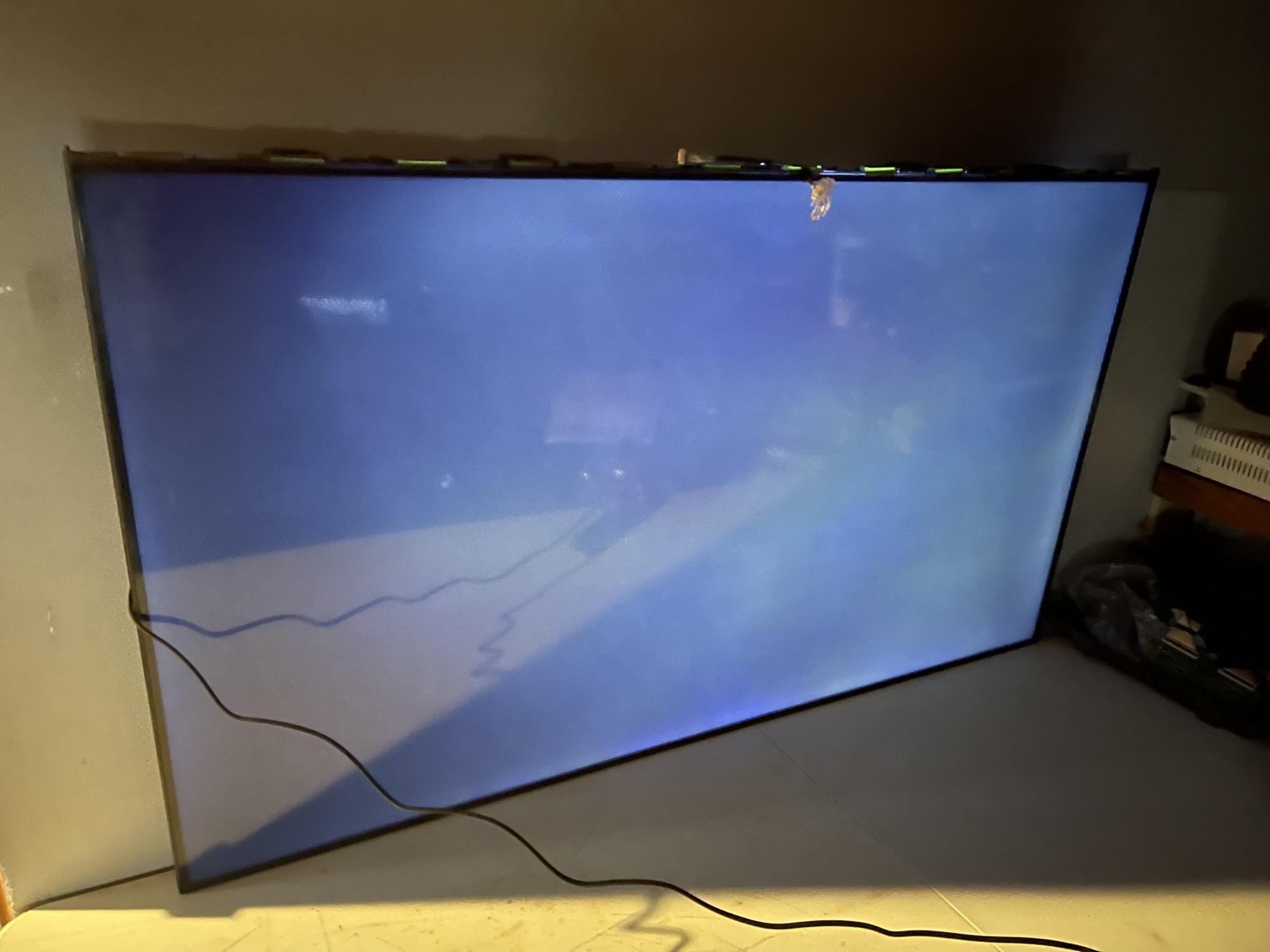

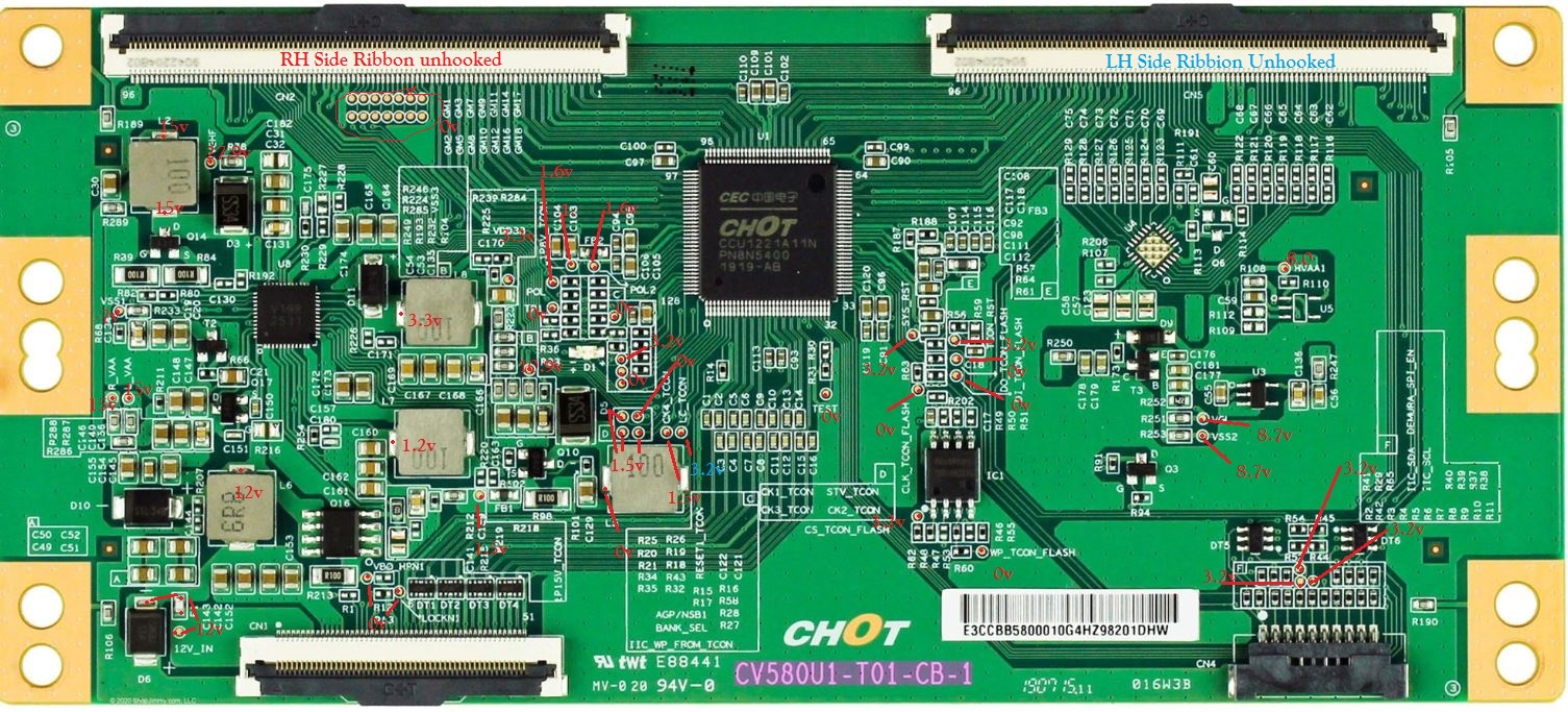

                      Re: Hisense 58R6E3 (Backlights, sounds, no picture)
                      Looking at the back of tv.
                      unhook left ribbon and tv show half white screen other half black.
                      unhook right ribbon and tv show whole black screen.
                      testing tcon test points now to. Showing the issue is lcd panel on left side

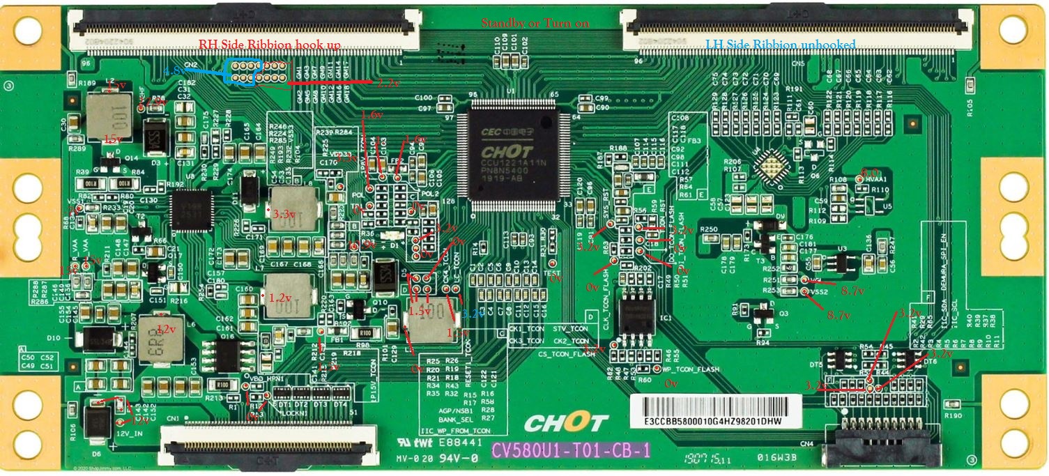

                        Below is images of Test points results. Image A is Standby with no ribbon cable plugged in. Image B is with RH side ribbon plug in and LH Side Unhooked.
                        Voltages is the same on Image B if in standby or Turn on. Also you have the Gm voltages on Image B
                        IF RH side is hook up and left unhooked. The screen is white on the RHside and LHside is black looking from the back side.
                        IF both cable is hooked up. The screen is black on both sides.
                        Same is the LHside ribbon is hooked up and RHside is unhooked. both is black.
                          Did this step and my result are posted above. Anything else i can do or is panel down.
                            can try the "tape cut-off" method, there's a crapload of how to videos on youtube if needed.
                                    This tape trick will not work with a grounded panel. After testing, The right side of panel works fines. The left side reads grounded. So still testing. Going to induce voltages to fine short.
                                    Any one have another way?
