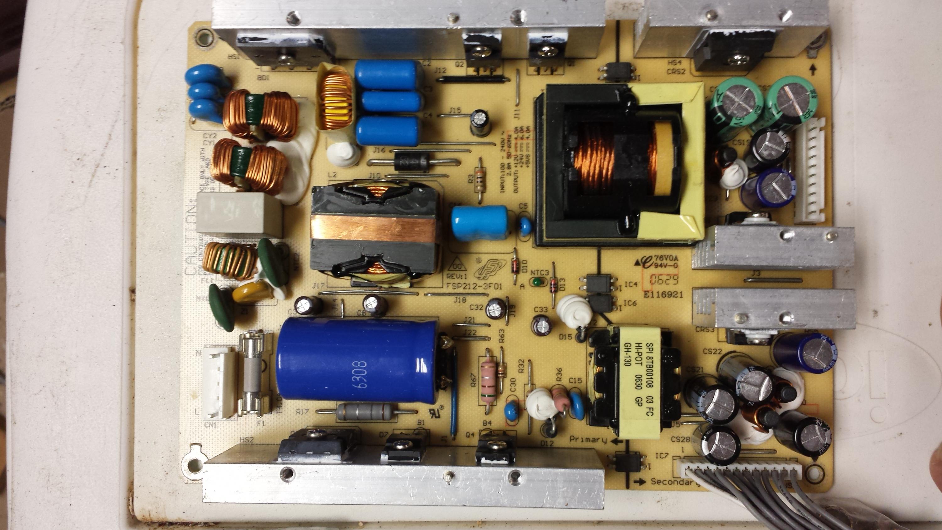

                        hello gentlemen,
                        came across this thread while trying to finish repairing a fsp212-3f01 psu in a viewsonic n3251w. I started with a dead totally dead tv - even after replacing all the visibly exploded electo caps. replacing q7 and the adjacent zener brought the +5vdc portion back to life, giving me a red led on the front which will turn green when pushing the power button. My problem is that now i don't have the +12 and +24. Any thoughts as to where to start?
                        Thanks!
                          #52
                          Re: Fixed a ViewSonic N3260w
                          Check and see if the power supply board is getting the PS_ON signal or not, also check the DC Voltage right at the two legs of the main filter cap in the primary side, if the PS_ON is good, then you should have >360VDC on the filter cap.

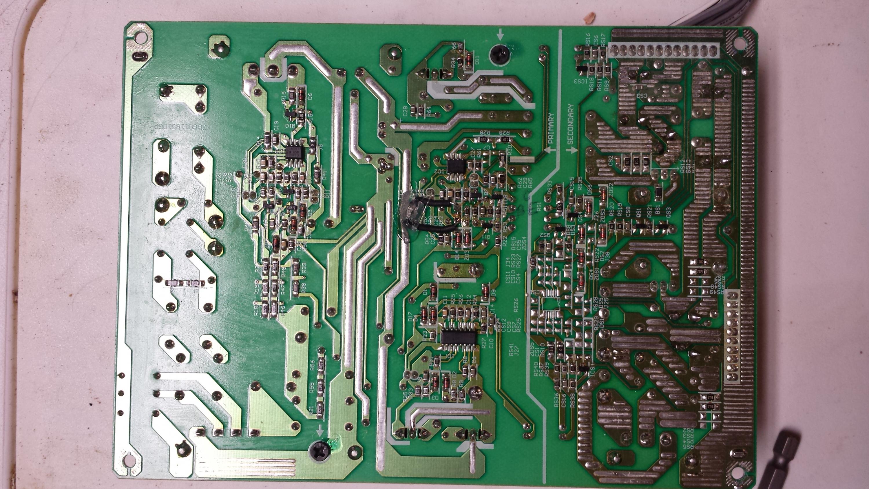

                            getting a psu on signal at p10 of cns1; going from ~60mv - 3.4vdc, which i believe is too low (5vdc normal high?). only 153vdc on primary side of big cap whether led is green or red. psu isn't turning fully on, correct?
                              #54
                              PS_ON >2.5VDC = ON, <1V = OFF. So you are getting 3.4VDC and the Voltage on the cap did not go up from 170VDC to >360VDC.
                              Can I see good clear pictures of YOUR board, both sides of the board?

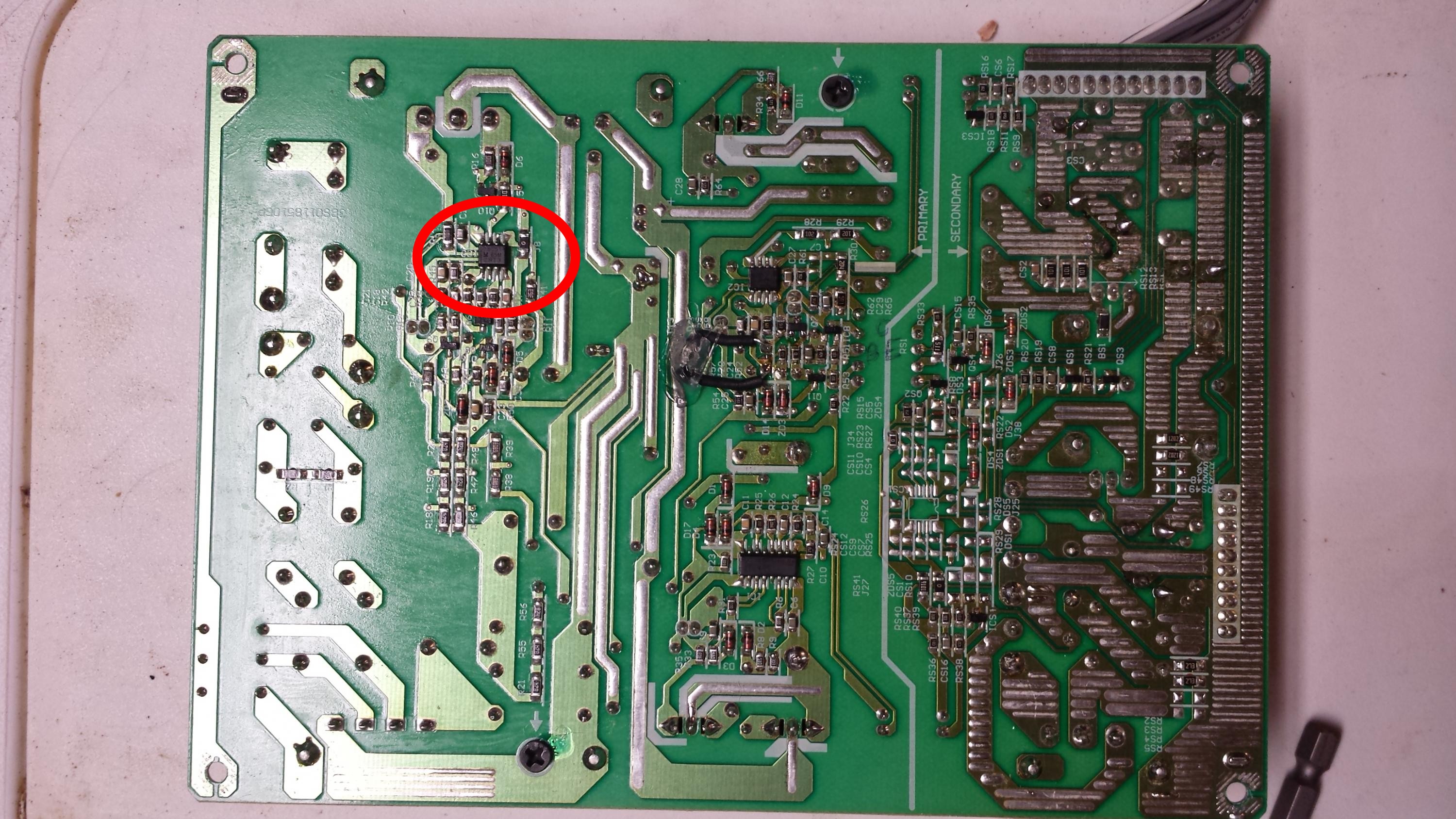

                                  OK, we weed to find out if the PFC IC is getting the Voltage for the VCC pin or not. Please get the numbers on that PFC IC, see if it matches the SCH.
                                    i have its datasheet - i will check tomorrow after work. its a 28051; i believe its a TI component, ucc28051.
                                        found that a bit earlier today... didn't have time to start going through and verify it is accurate - weird drawing name and part designators, but it looks pretty close. is it completely accurate?

                                          so the PFC ic is not getting voltage on vcc. it is reading like this:
                                          p1 vo_sns = 0.97v
                                          p2 comp = 0.5v
                                          p3 multin= 1.22v
                                          p4 cs = 0
                                          p5 zdc = 80mv
                                          p6 gnd = 0.2mv
                                          p7 drv = 220mv
                                          p8 vcc = 200-230mv
                                          looking at the schematic that you had attached, i don't see any of the discretes required to operate this ic. going to look at the reference design and see how close the 2 are.
                                          other thought - i should be getting much more voltage through the rectifier bridge than i am. metering out the bridge (diode check, in circuit) shows it looking ok, except when reading though 2 diodes (negative out to positive out). i would expect to read the drop on both diodes in series ~ 0.7, but i am getting ~0.4 from line/neutral in to + out and - out to + out.
