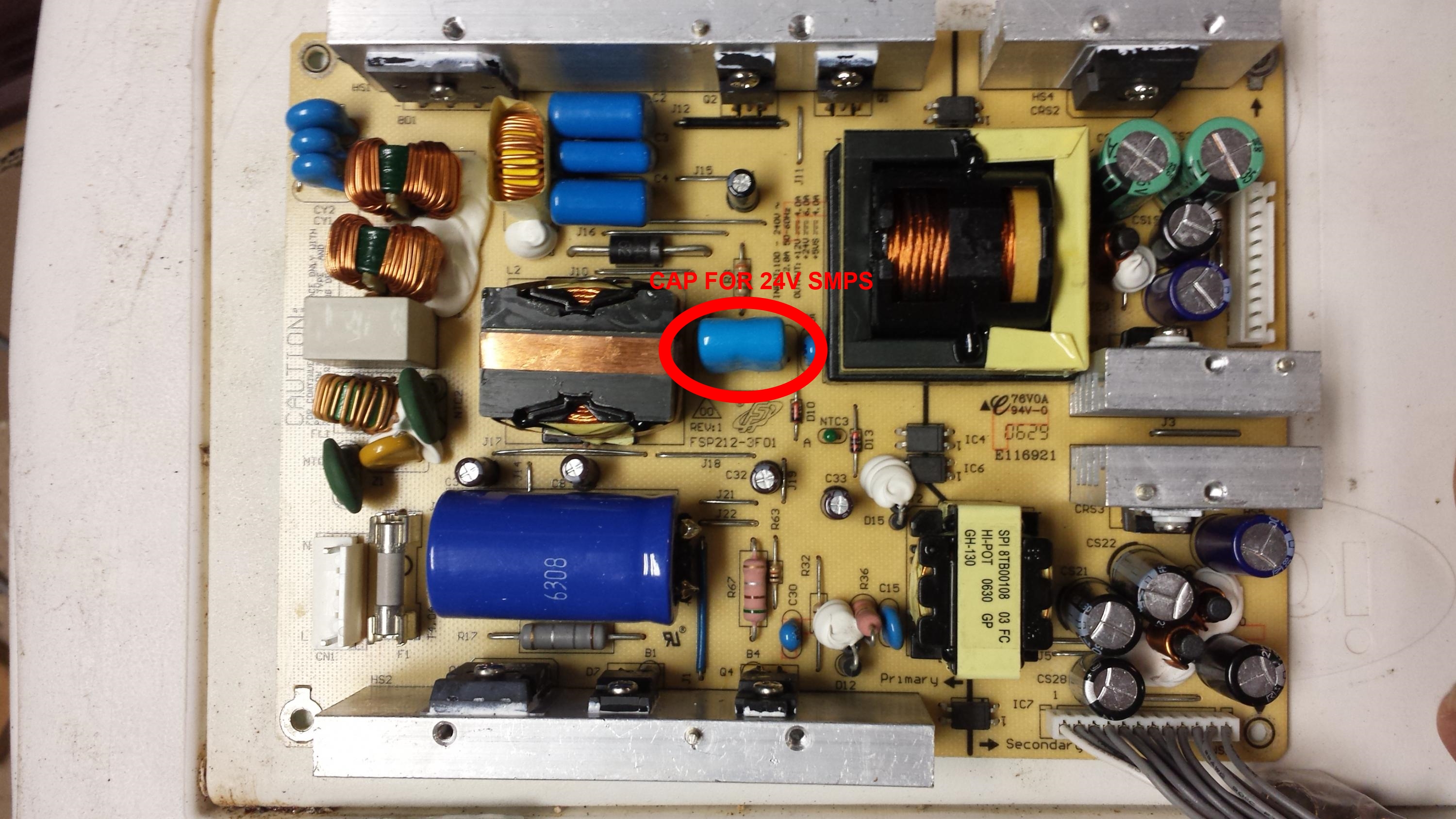

    i am not getting 12 or 24v. i am getting about 65v in both of these places. there is also something wrong with q1 and q2 - possible with ic1. i get 346v on q1 drain, a pulsing low on the gate and what looks like nothing on the source. i have pretty much nothing on q2 anywhere.
    i have 13.2v on p12 of ic1 so it is getting voltage. i have nothing on the EN1 line (ic1p8). i think that i have an issue with optocoupler 1c4 - i see that there is 5v on p1 and 4v on pin2, so the diode should be coming on. on the primary side of the coupler i have 14v on p4 (collector) and -8v on the emitter (p3).
    i don't really know where to go from here. is t2's only output 5v? and t1 12 and 24v?

      "i am not getting 12 or 24v. i am getting about 65v in both of these places." I do not understand on 65V reading.
      "t1 12 and 24v?" That is correct, IC1 L6598 is the SMPS for the 12V/24V power supply.

      So if pin 8 sees 0.6V 200 nano second pulse, it will then trip the shutdown.
      You should check C15 (0.022uF 1KV cap) which is connected to one end of T1 Primary winding to ground, if the capacitance goes down, it will produce enough pulse to trip the IC.

              "i switched my reference. still getting the weird 65v. it doesn't make any sense" OK, in the primary side of the circuit, you have to use negative leg of the filter cap as the ground ref.
              The CNS1 and CNS2 are in the secondary side so the ground ref is the chassis, so CNS2 PIN 1~5 (24vdc OUTPUT) you are getting 65V? are you sure you have the meter set to VDC? How about CNS1 pin 9~11, are you getting 5VDC?
              Bottom line, what are you getting at 5V PINS, 12V PINS, 24V PINS?
              Do not try to measure the voltage at the Source of Q1,if it is running you can have very high voltage that can damage your meter, it will be high frequency AC that meter cannot measure.
              How about C15 capacitance?

                      tried to measure cap c15... i think i have an issue, but i don't know if it is equipment or the part. i have a fluke12 to measure capacitance. 0.022u is out of range so i figured i could connect in series with a cap of known value and read the sum and calculate. i think that the meter has the resolution to do this in the 1u range. i get a reading of 0.001u when i do this. is this a equipment problem or a bad part?
                        #111
                        Re: Fixed a ViewSonic N3260w
                        You hook up a know value cap (something close to the same range) in parallel with C15, if the C15 is good then the reading should not be the same as the known good value, it should be = known value + 0.022uF. You will do the test with cap off the board.

                          question- the marking on the side of c15 is:
                          rr
                          102k
                          1kv64
                          doesn't that make this a 0.001uF cap?

                            measured c15 in parallel with another ceramic disc which measured 0.117u. I get 0.118u, which is right on, I believe. I don't have a way to measure esr.

                              So the know ceramic cap is measured at 0.117uF, then you connect the C15 0.022uf in parallel, then the total capacitance should be = 0.117 +0.022 = 0.139uF.
                              Am I reading your post correctly?

                                C15 is marked as 102k making it a 0.001uf cap. Unless i am misunderstanding the code.
                                  #116
                                  .001 will be way too small, I think the SCH we are using does not have the matching designators to the board we are working on.

                                    hang on... on a different page again. talking about c15 i referred to the schematic. after looking at your picture i realized that you are talking about something different! Let me pull that cap and check it
