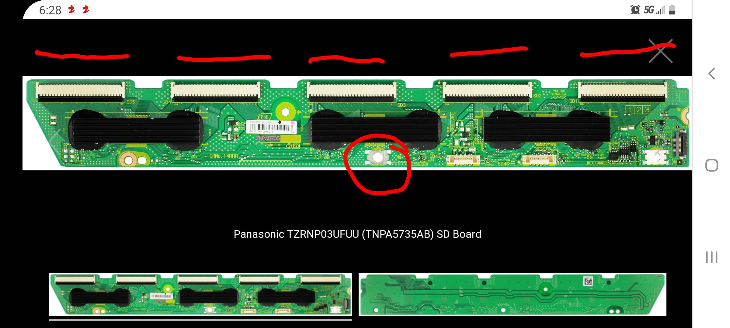

    I opened the tv and saw a bed diode that exploded in the SC board and some of the transistors*malfunctioned .
    The SC board number is*TXNSC1UCUUTH*.
    I also see 2 boards connected*to the SC board (SU board*+ SD board)I can not see any visual sign of a malfunctioning but maybe there is a problem on them too.
    I would be very happy*if someone how*familiar*with this problem in the plasma*65vt60 panasonic can tell me:
    What are the odds that they broke down too?
    When i replace the sc board Do I need to also replace these 2 boards ?
    Thank you very much!

    To test the buffer boards, put your meter in continuity mode. Your meter should beep when you touch the leads together. Place the black one on the screw hole circled in red, and drag the red lead across the ribbon connectors (red lines above them) and listen for a beep. Beep means there is a short, and it's bad.

      Can I do this test when the buffer is inside the tv or must disconnect them from tv?
      Also I need to disconnect the ribbon cable from the connector in order to drag the red lead on the connector?

          You can test the buffers in the set with the ribbons connected. Take out the screws and the white connectors going to the sc board.

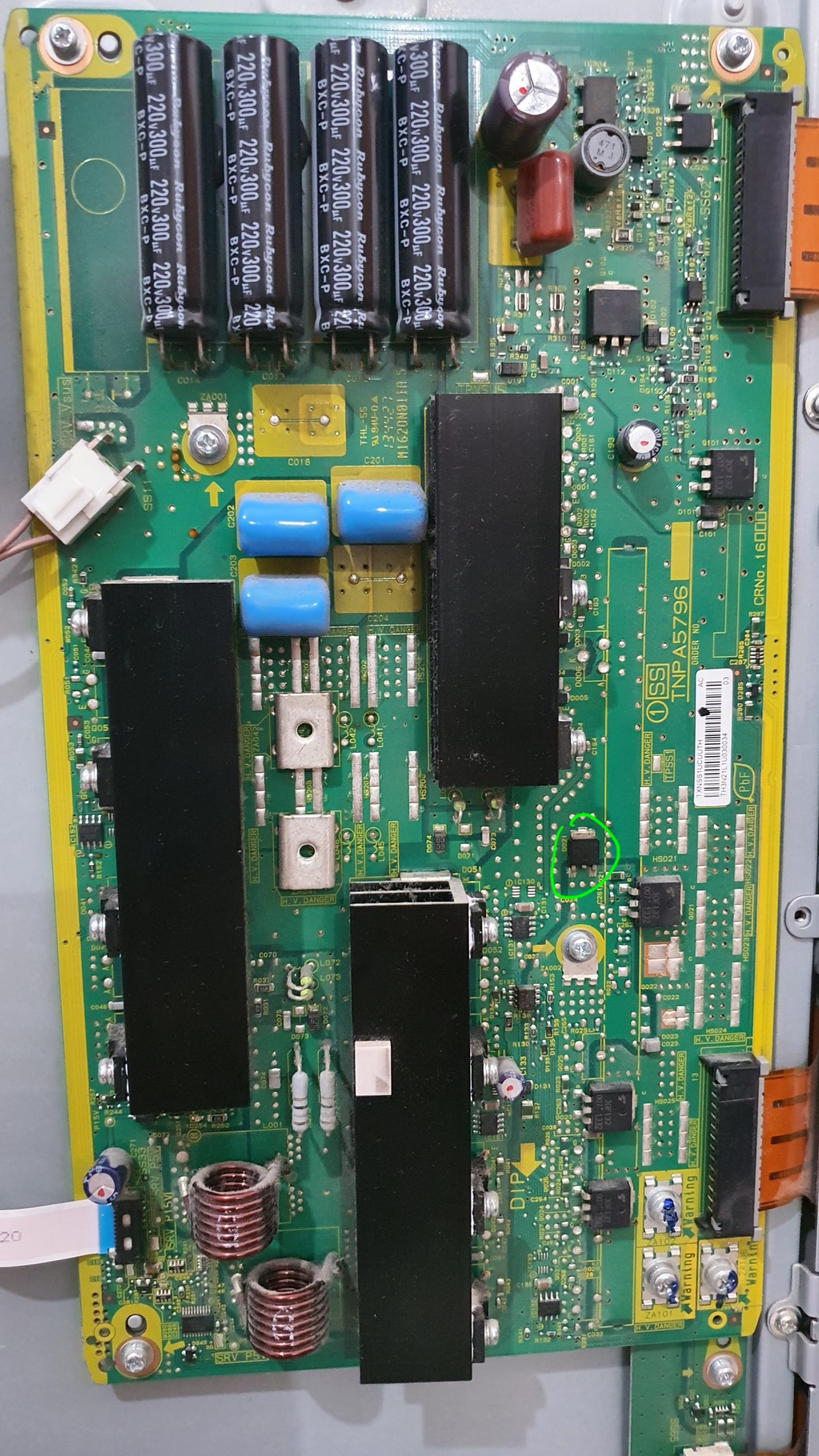

                                    I attach photo of*my ss board i dont know where*to find the*TPVE*or if there is one
                                    I managed*to find diode that failed in the*continuity check*of my multimeter i measure it between the 2 legs and the multimeter*beef and i saw zero on the screen
                                    I also check the power connector*of the ss board SS11 and no short*
                                    Does it mean that I also need to replace the ss board because*of the diode?

                                      my mistake a frienf told me to mesure again the diode is ok, it is somthing alse that when i conect the ss board ribbon cable to the main i get 7 red blink
                                      the tv turn on with fan if i disconect ribbon cable from ss and sc and from the C2 board data driver (lower center)
                                      if this 3 ribbon cable disconected the tv on with click sound and the green light blink a few seconds and then the green lifht stay on, also the 2 fan spining.
                                      no screen.
                                      what board can cause this problem?

                                        Re: 3 red blink in panasonic 65vt60
                                        The diode has those two pins shorted by design itself, it's how they work, the big tab (case) is the kathode, the two pins are anodes, goes for any diodes on this TV with 3 pins/pads, so two of those contacts are always going to be "shorted", it just cannot be shorted from anode>kathode or vice-versa, that indicates a problem, IGBTs are much more likely to short than diodes when an SS or SC board failures occour.
                                        Oops I wrote this before your latest reply acknowledging a misread on the diode.
                                        You need a replacement SC board for sure, the SS board's IGBTs need to be tested for short-circuits too.
