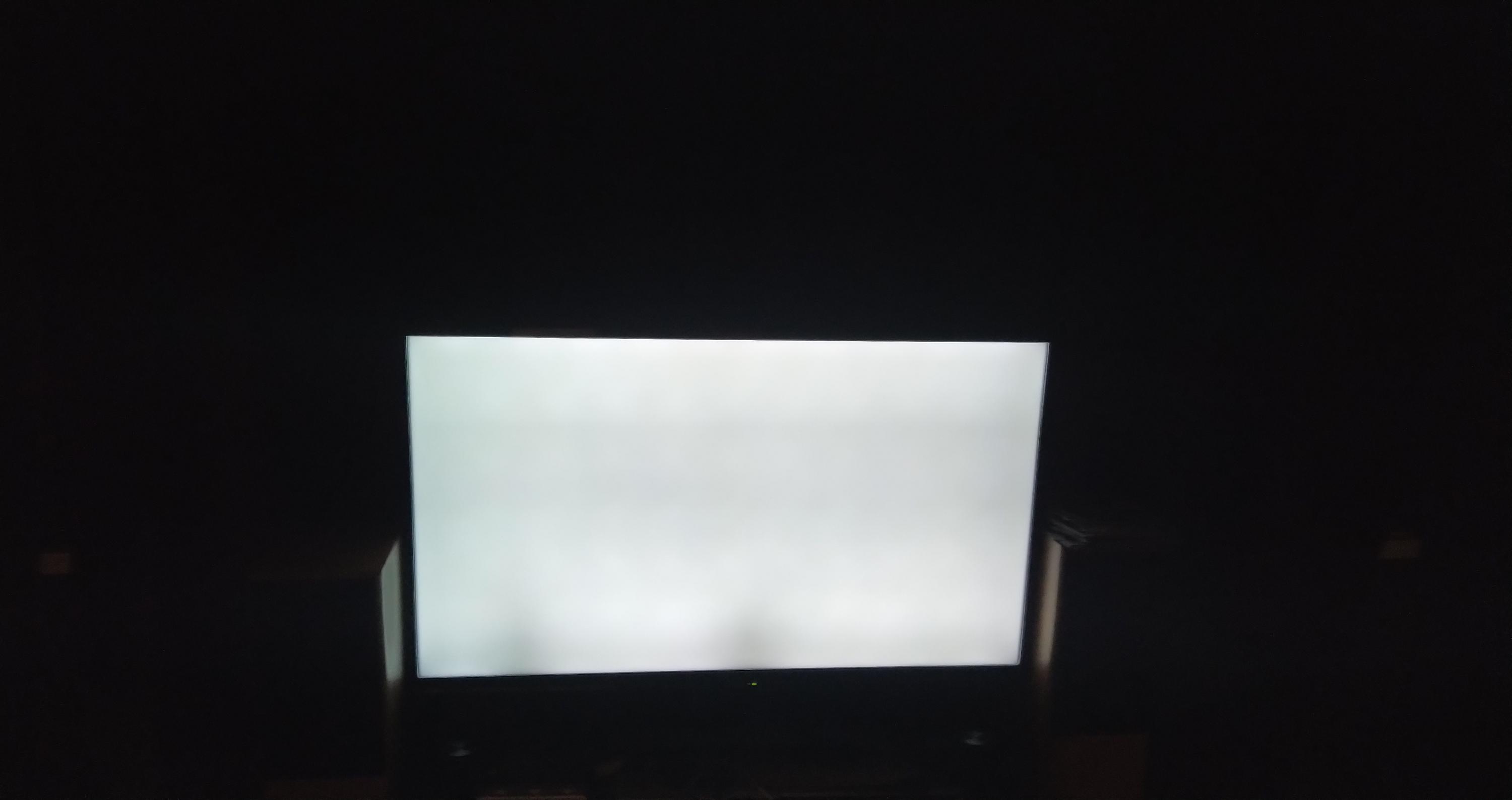

    This post is more a "what's going on here" thing than anything else but here goes.
    The above Panny 1080P LED back-lit TV is about eight years old now. About three years ago the dark blotch that can be seen in the lower middle of the image appeared, and it has now been joined by its brother to the lower left. I was able to get used to the first blotch but this second one is annoying.
    Both appeared in a similar way. They started off only being dark when the set was first switched on from cold. They'd start off dark, then flicker dark and bright for a while before finally disappearing and staying bright.
    If the set was set to low back light setting (30%), they'd be more prone to staying dark for longer. At full back light they'd go bright.
    This state only lasted a few weeks before they became permanently dark.
    My first thought was dead LEDs but surely these are series-string so if one goes (and certainly two, with one being dark for years) they all go?
    Or is this something else - warping of one of the layers inside maybe? The flickering goes against that theory though.
    Just curious as to what the failure is here and ultimately if it's going to result in eventual total panel failure.
    Any views gratefully received. Ignore the dark horizontal band BTW, that's a camera/PWM artefact in the image.

    That has faulty LEDs (or LED controller/driver) written all over it!

      Thanks - I get that but is it actually possible for LEDs to fail and the rest to stay operational?

        It is likely that the individual led has shorted allowing the rest of the string to still work, most led driver circuits would normally shut down the backlights but not always.

          That was my original thought when the first LED went a few years back but I was advised at the time by someone who professed to know what he was talking about that they don't fail in that mode.
          That doesn't matter though, if it is indeed a case of two LEDs failing short then I suspect that the TV isn't far from a failure due to, I assume, higher stress on the remaining LEDs.

            That tends to be the correct conclusion. Shorted leds place higher strain on the remaining leds.

              Led failure I have had the set myself with exactly the same issues. I have replaced about 4 led strips since I have had it for about 3years.
              The leds before tend to blink then finally for about a week then die. After about 3 fail the backlight of the screen dies!
                  Not necessarily.
                  Is same current is maintained, no additional stress.
                  But old LED's are still wearing out like the first ones that failed.

                          Well yet another LED has failed so I suspect this is happening sooner rather than later.
                          The LEDs are normally £70 a set, which frankly is a lot to pay on an 8 year old TV... But, I've seen that you can get complete sets from China (this is an LG panel, LC500DUE) for a fraction of this (about £20 or so). Are these cheaper kits any good (I imagine the more expensive ones aren't original LG!) or do I avoid?

                            My thoughts would be buy the china set replace them and then sell the TV. I haven't rated the Panasonic TV myself as I had the smart version of the same set. The apps gradually stopped working as did the leds. Replaced around 4 or 5 strips on this set in the lifetime I had it. Pretty much all the apps failed on the TV.

                              Luckily, it looks like this model uses the same strips as LG 50LN series which are a common failure. Otherwise, Panasonic parts can be impossible to find. I have used new substitute strips from Chinese sellers on both ebay and Aliexpress for this model with no repeat failures. Just turn down the backlight after and do it for all inputs and all apps.
