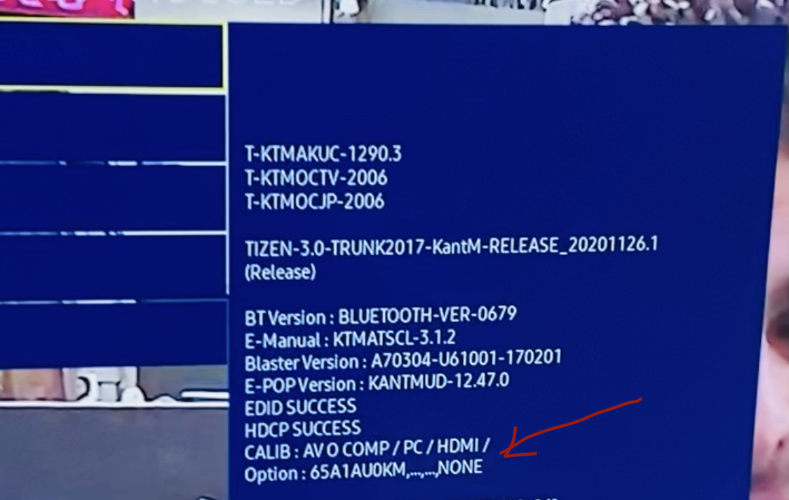

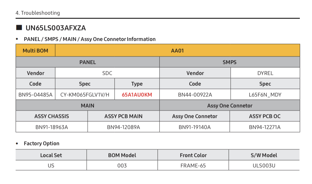

    Hi. I'm busy troubleshooting my Samsung Frame TV UN65LS003 on another thread, but I had a separate question I'm hoping someone here may have an answer for.
    The service manual states that after replacing the main board you should "change the factory option. The options you must change are 'Type'." I've linked the service manual (page 57). It also states you should "change option bytes when replacing Main Board".
    The only change I made was going to service menu -> Option -> Type -> 65A1AUOKM
    That's all I did. I checked firmware was updated (it was). My intermittent issues continue as before. Is there something else I need to do to "change option bytes"?

    Re: Replacing Main Board on One Connect Samsung
    The service manual refers to when you get a NEW board from Samsung for replacement, not a used board.

        Could you maybe clarify something for me please? I notice on my service menu the "Option" parameter is set as "65A1AU0KM,...,...,NONE"
        The service manual lists the following information under "Factory Option" settings: BOM = 003, Local Set = US, Type = 65A1AU0KM (and a bunch of other default settings).
        Is it safe to say I'm fine leaving these settings alone? It seems technicians hardly ever need to change these settings. Just need some reassurance I'm covering all my bases for troubleshooting. Thanks!
          If you want to change those settings you will need the Factory Remote (pdf, page 56)

            I've been using the generic, IR remote to access the service menu. I take it you mean some of the options mentioned are only accessible with the official, service remote, right?
            I noticed the setting "Deadkill Lock" was ON. Any idea what that does? Everything else seems default (apart from what I changed).
