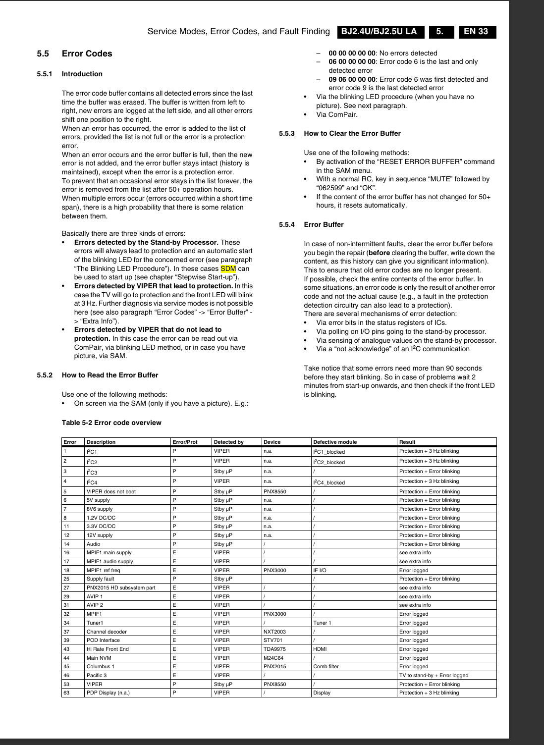

I have a Philips TV that would not turn on and enter protection mode with error led with 8 blinks, This indicated no 1.2v present.
