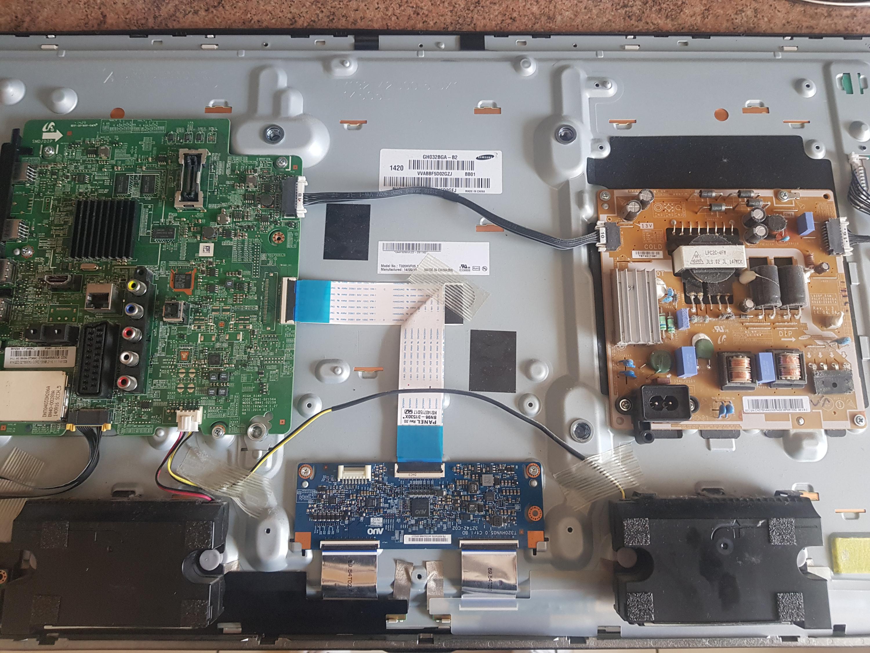

    Hi
    TV has backlights but no picture

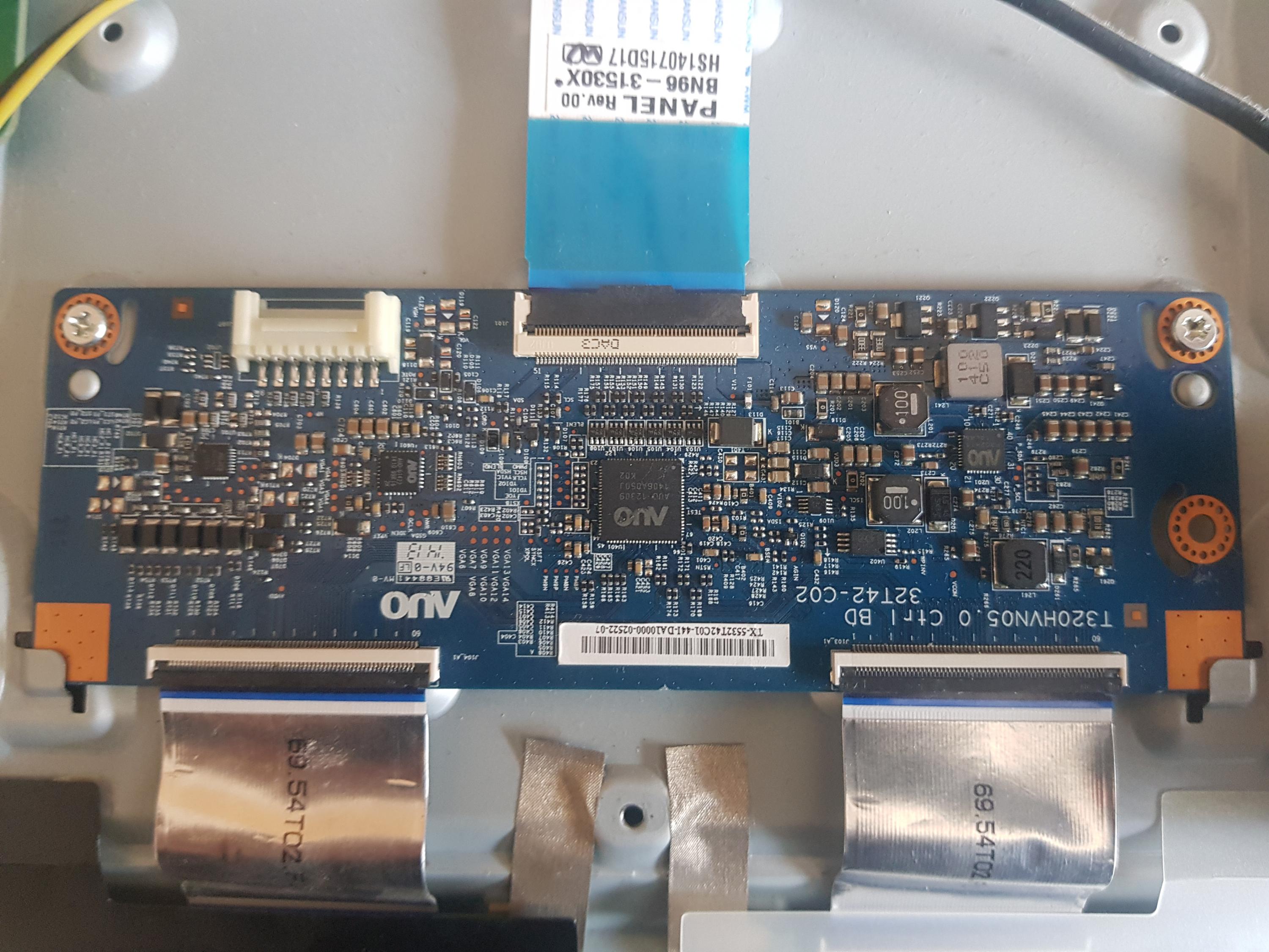

    Tcon fuse is showing on both sides 12v
    If I remove each tcon ribbon one at a time I have a picture of a samsung logo so that's good but the only thing I have noticed is if I remove tcon ribbon from the screen VGH is measuring 30v but with both ribbons reconnected I'm getting no voltage of VGH
    So my theory is the screen is possibly faulty ?

    Have you measured VGH resistance to chassis. If it's not short circuit could you supply 30V from a power supply with current limit set and see what happens?

        Are the tab bonding boards on the bottom edge of the LCD panel?
        Inspect the tab bonding boards for any sign of damage and also check the resistance on the MLCC's (Multi Layer Ceramic Cap) of the tab bonding boards to see if any of them show low resistance reading.

          No both sides are good if u disable the tcon ribbon one at a time it's only when you connect both theres no picture
