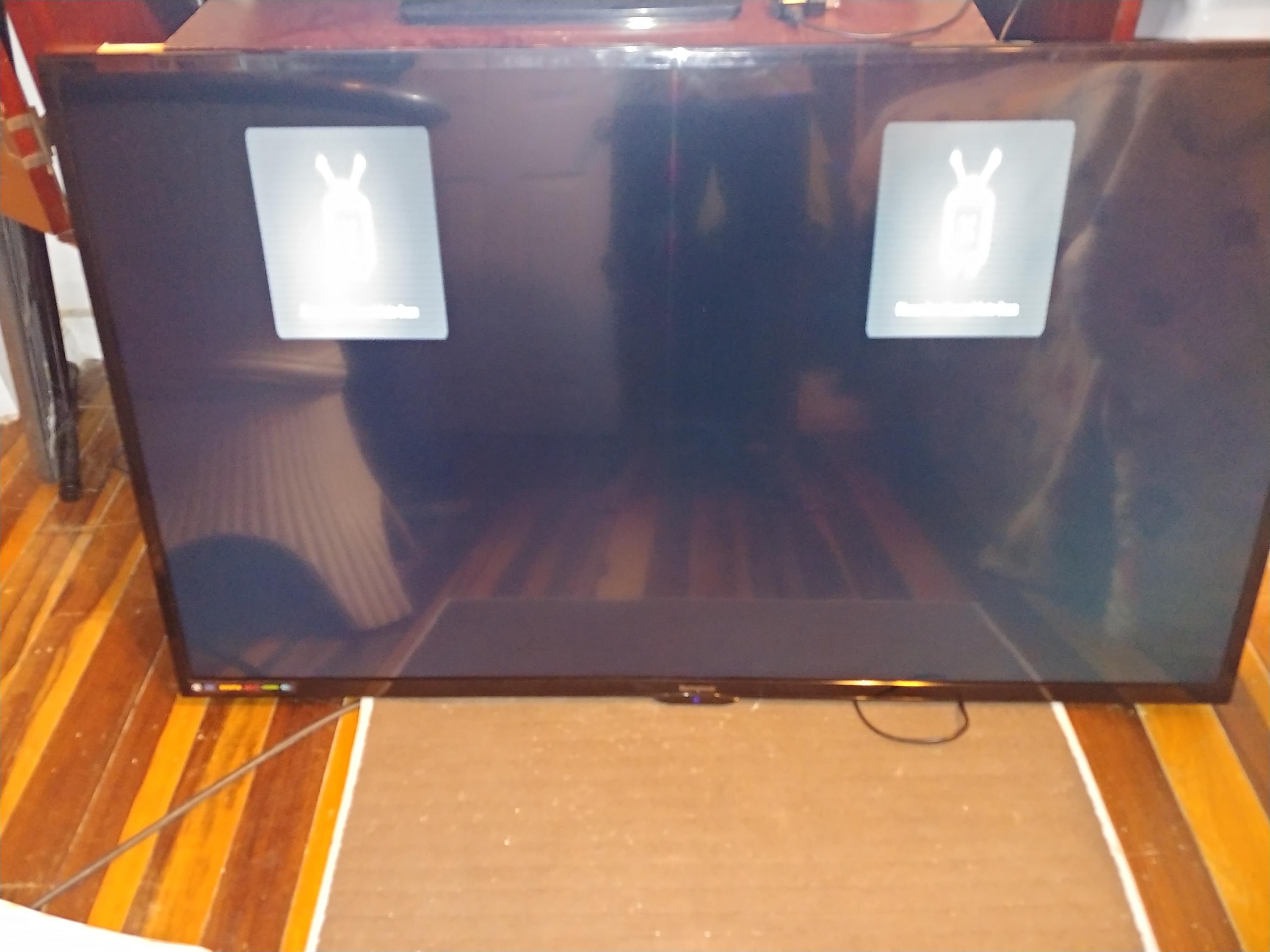

    Westinghouse WD55UB4560 4K TV Now have split video

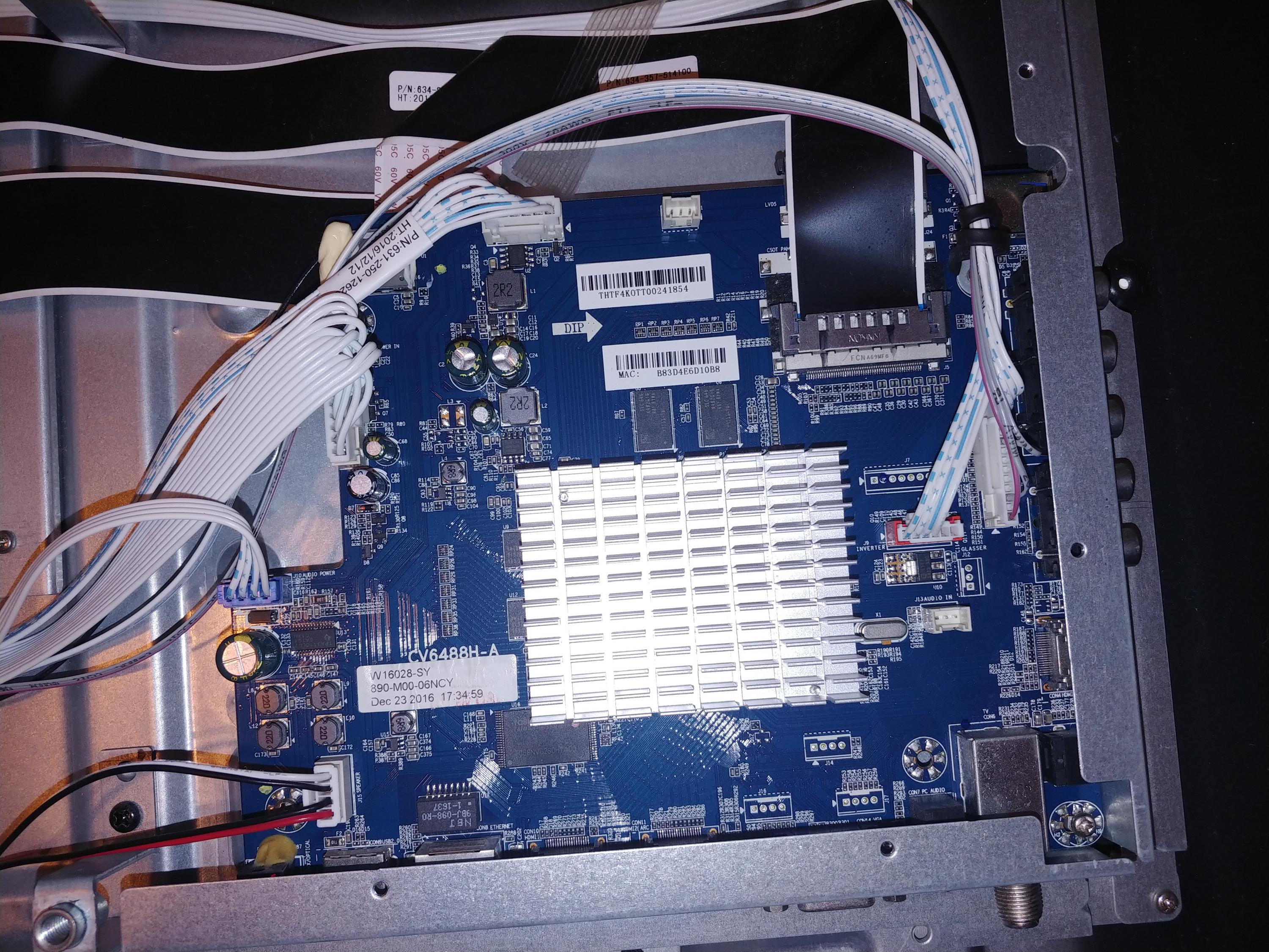

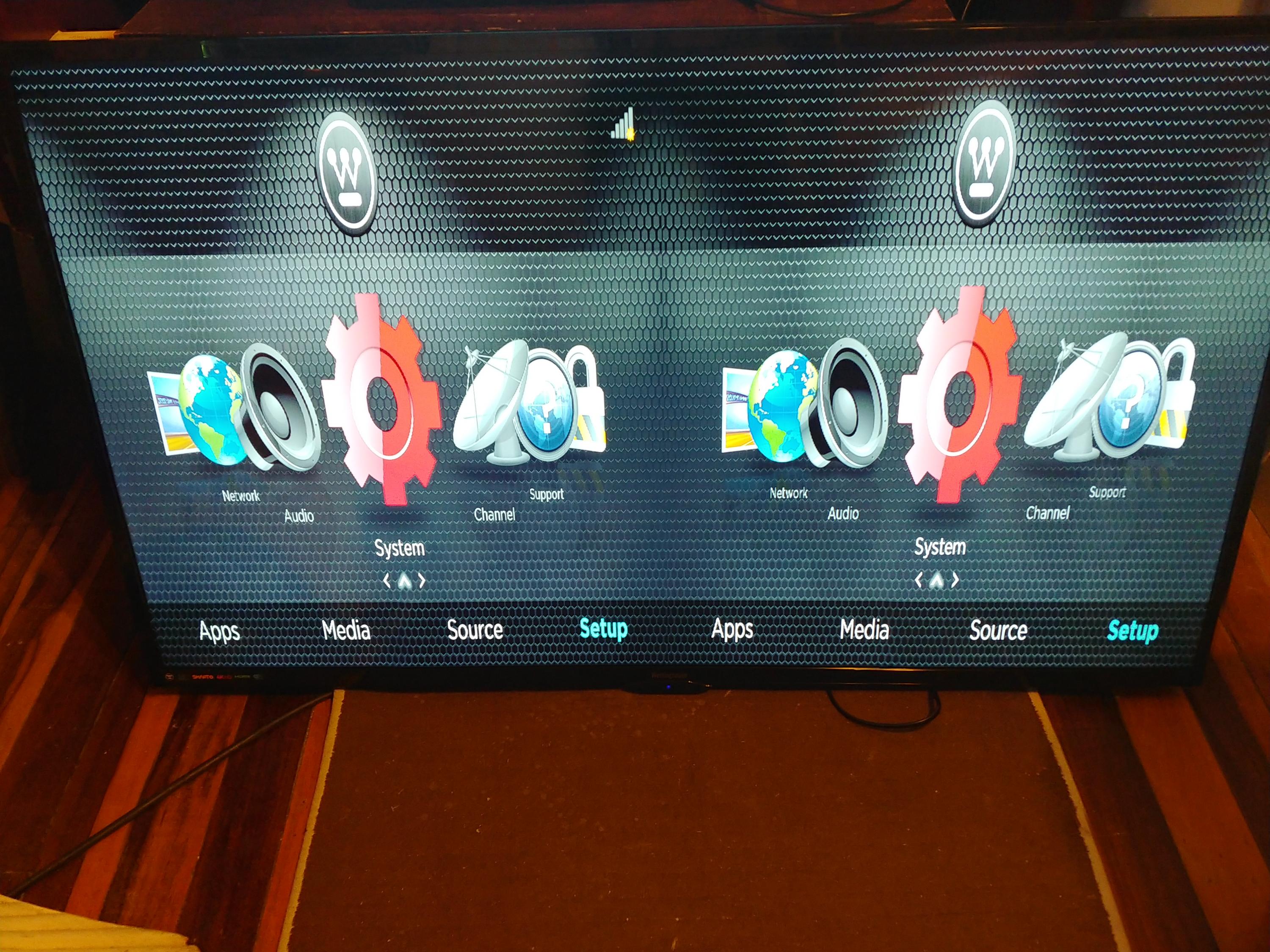

    I bought this Westinghouse WD55UB4560 4K TV from an individual who don't wanted it fix the original problem it had was no video I check some voltages on the FRC board it wasn't sending voltage to the T-CON board so I replaced the FRC board that's giving this results split video. Any help to resolve will be greatly appreciated.

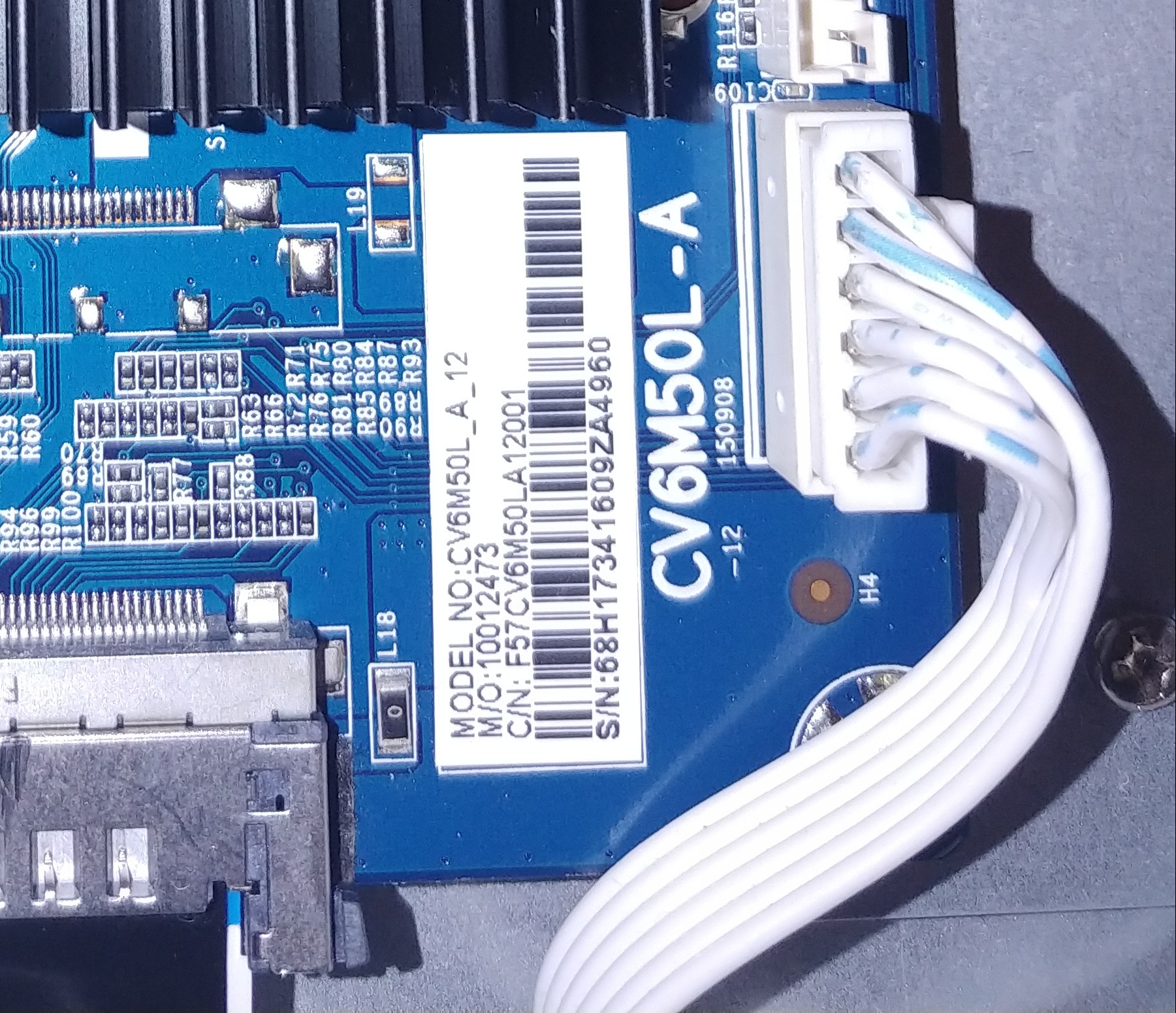

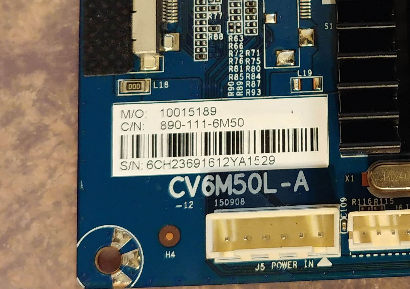

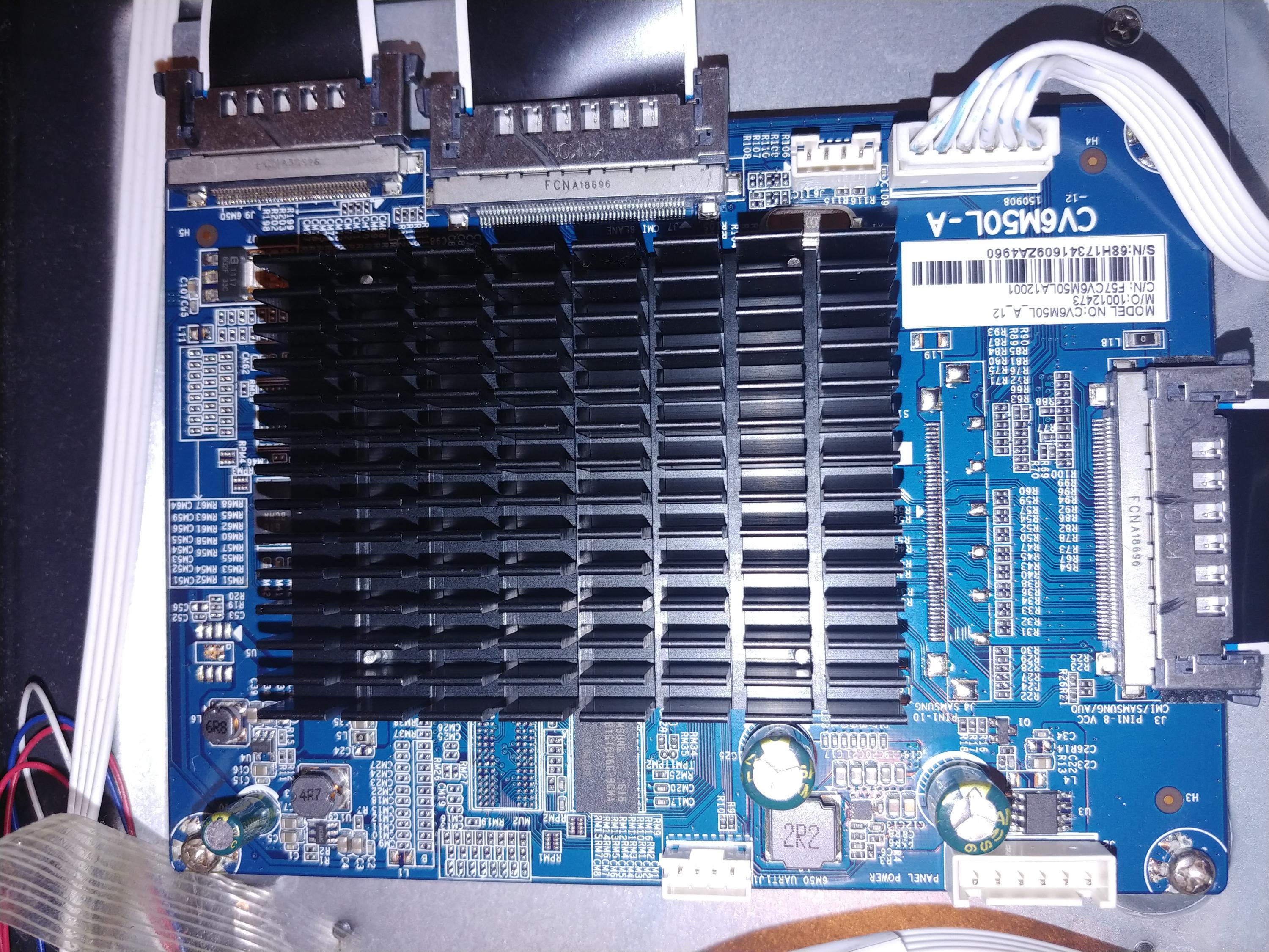

      Re: Westinghouse WD55UB4560 4K TV Now have split video
      The part number CV6M50L-A-12 matches but the M/O and C/N doesn't as shown in the attached pics. The first photo is the old defective part and the second photo is the new part installed.
        I think you have a mismatch there.
          The M/O and C/N numbers have to match? Will update when i get a match numbers.

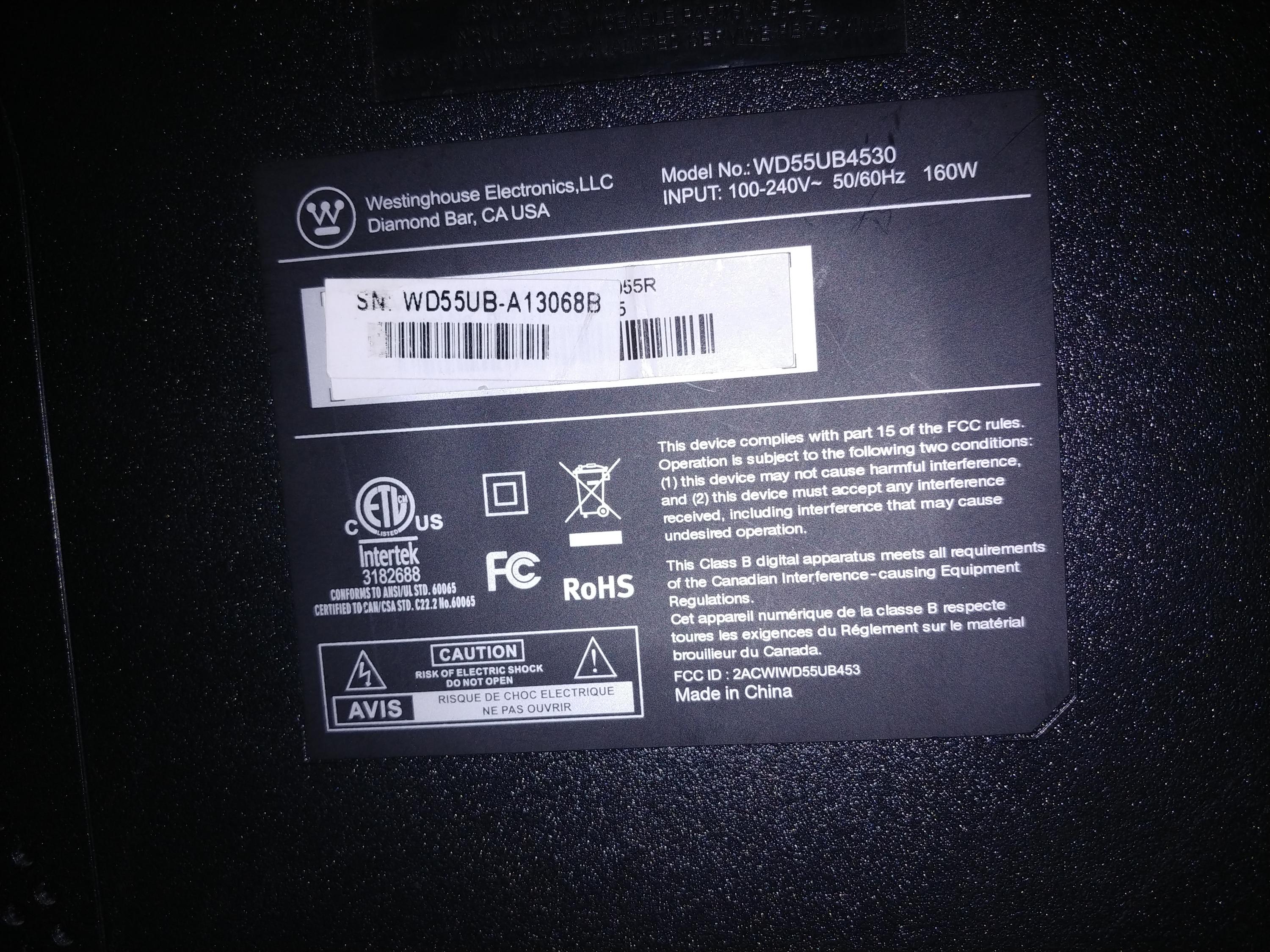

              Can you recheck and make sure of your tv model number on the back cover?
                What's the version number of tv? should be on back cover near the model number.
                  CV6M50L-A is the blank PCB part number, blank PCB can be stuffed to make many different PCBA'Ss
                  Shopjimmy: see the notes about matching the version number to the model number.
                  You can have same TV model with many difference version.
                  For examples:
                  https://www.shopjimmy.com/westinghou...w-04531-c050g/
                  https://www.shopjimmy.com/search.php...y=890-111-6M50
                  You can try contacting Shopjimmy.
                    Here the label of the back of the TV
                      Yes I think you have a mismatch, check the two frc boards here, the 2nd one down, see how it says match W16028-SY? And you do have that matching sticker number on your original frc board: https://www.ebay.com/sch/i.html?_fro...B4530&_sacat=0
                        The first two are both a match, the C/N numbers match too but they seem like a pretty steep price for a frc board.
