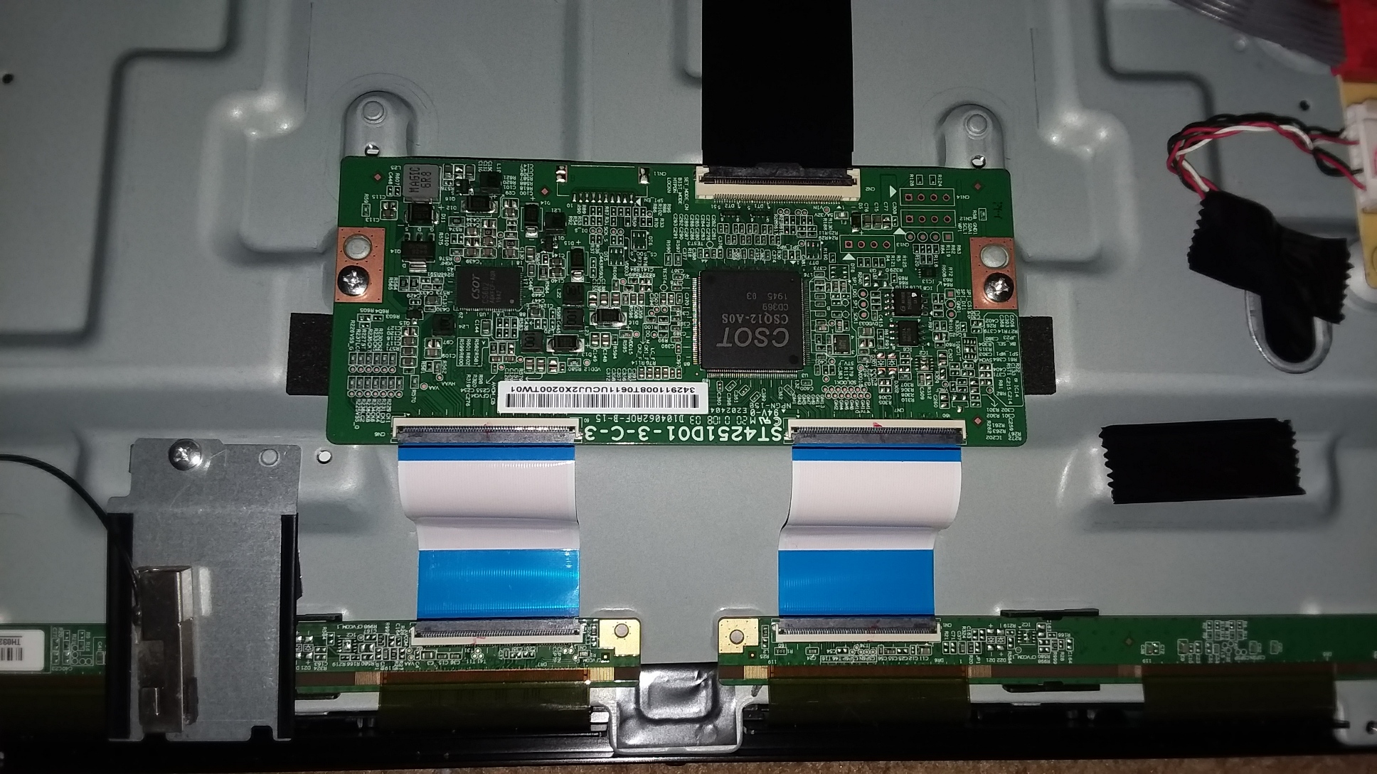

    Was given this new TV that has backlight but no picture.
    - When both T-Con ribbon cables that run down to the driver boards are
    connected, I get no picture - just backlight.
    - When I remove the left-side ribbon (facing back of TV), no picture.
    - When I leave the left-side connected and remove the right-side ribbon cable, I get a good image on the right-side of the screen. Seems to be exactly half the screen.
    - I've swapped ribbon cables and there's no change so I know the ribbon are good. I've inspected the T-Con and driver board and don't see any obvious burnt or missing components. (not that I expected to)
    QUESTION: Is it more likely that the problem is with the T-Con board or the driver board? OR, is it anyone's guess?
    Any suggestions on further troubleshooting? Do I start looking for shorts, etc.?

    Backlight but no video tcon is first suspect and boards are usually fairly inexpensive. You can try connecting one side at a time between tcon and panel. If one side is good, you have a fault in the panel on the bad side.

      I did try that.
      If I disconnect left side cable (from T-Con to driver board), I get a good picture on right side of screen.
      If I connect only the right side, I get nothing on any part of the screen, just backlights.
      Does this mean bad panel or something on the driver board?

        If you get a good image on one side, it means the tcon is good and there is a fault on the bad side. You can try blocking some pins from the tcon on the bad side with the tape cutoff method.
        https://techhometravel.com/repair-of...lines-on-a-tv/
        Sorry only scanned your original post. Assumed you didnt test one side at a time. You should have posted pics of the screen.

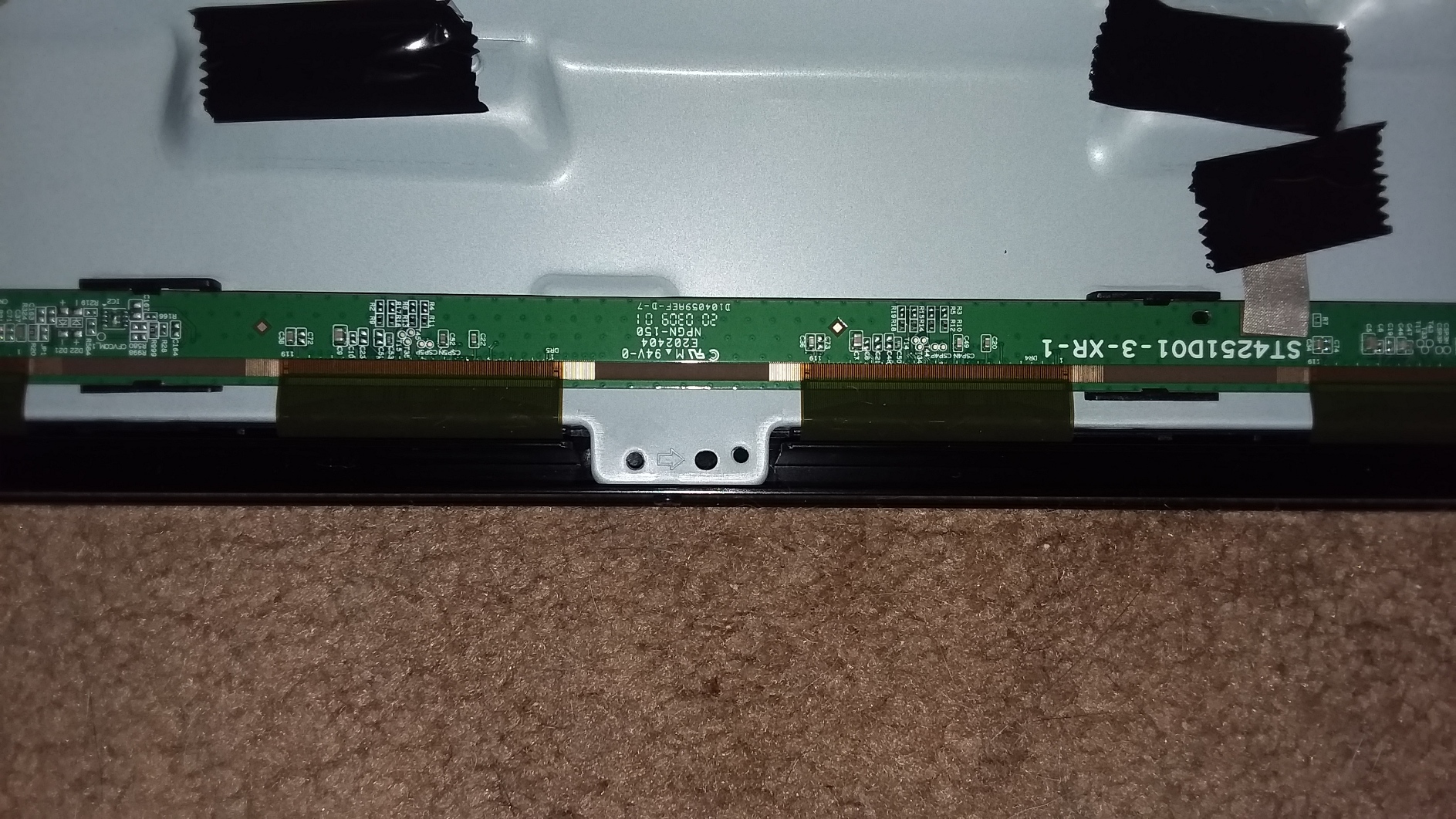

            On the bad side of the lcd panel board check for any shorted smd capacitors i have seen a few sets with bad smds causing this issue

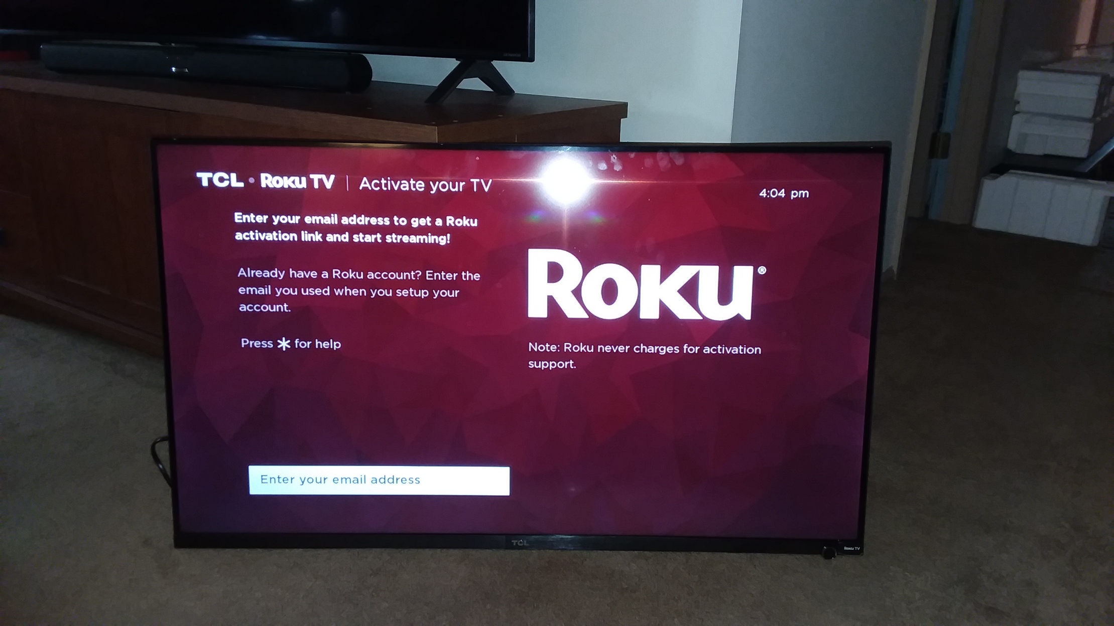

                neilc6, I watched some videos and did the tape cutoff method and narrowed it down to one clock signal line. Once I taped off just that one line (like doing micro-surgery), the TV looks perfect.
                Thanks a million. I never would have known about that method.

                        Ok so the tape method worked for me though I have some questions. Right now I have 8 or 9 pins covered and the screen looks as it did before it went blue. No horizontal lines that I can see. Should I go through and try to eliminate pins one by one? Or can I leave as is?
                        How long does this fix last?
                        What am I missing on screen with all the 8 pins covered?
                        Thanks in advance for your thoughts on this.
