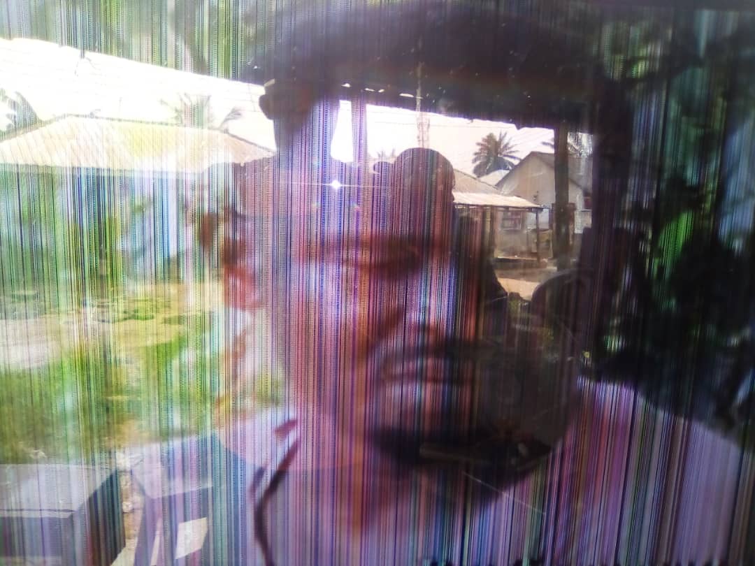

    This samsung is having vertical colored lines

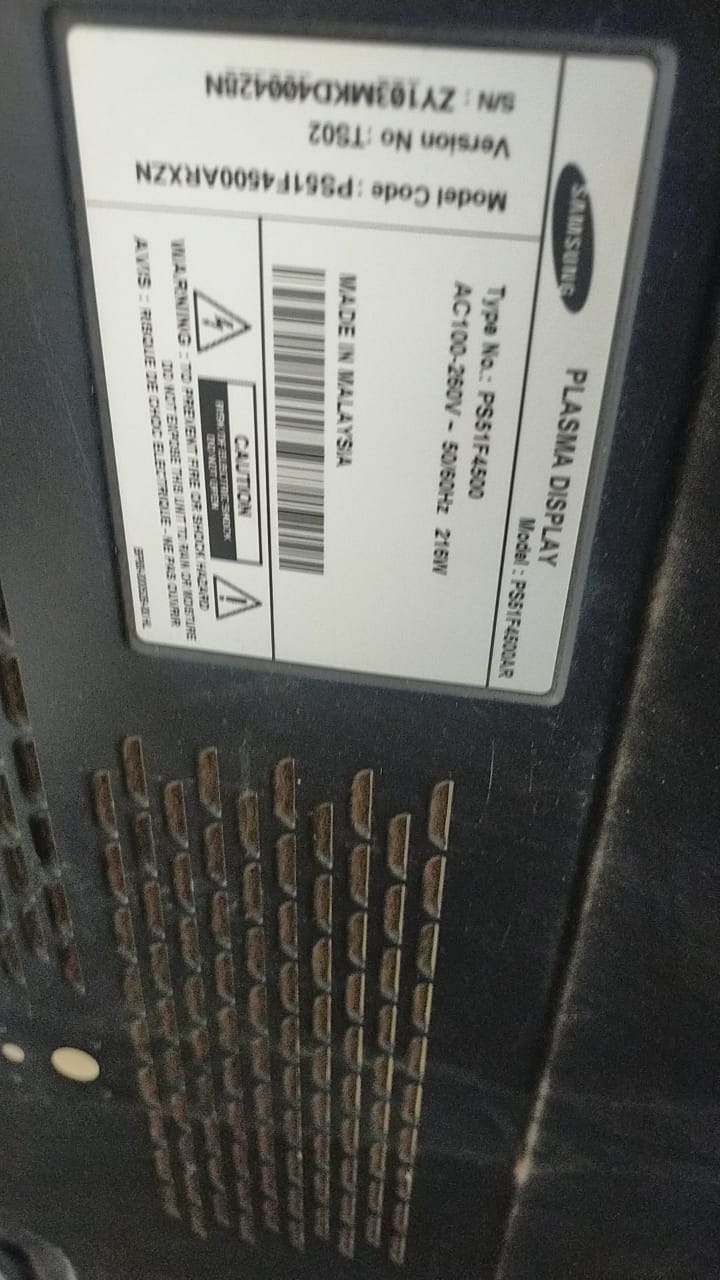

    Ps51f4500-?
      Re: Samsung UE55ES7000
      No is not a plasma. Is an led smaet tv
        Really ? It says "Plasma" right on the label. You must have posted the wrong label pic.
          Am very sorry please. The model is UE55ES7000

              if you look at the bottom of your display, it looks like all off the screen starts to drop out/no display. I'd look for moisture damage on the driver boards between the screen and the tconn?
                I have inspected up to the sceler board, i didn't see any damage. Am suspecting the cof ic. And the ic's are 14 in numbers . 7 each side. And if you look at the screen only corner is having good picture. So am asking if i replace the rest about 13 chips if it will work ?

                  You want to replace the COF's ? Not sure if anyone here has tried that...
