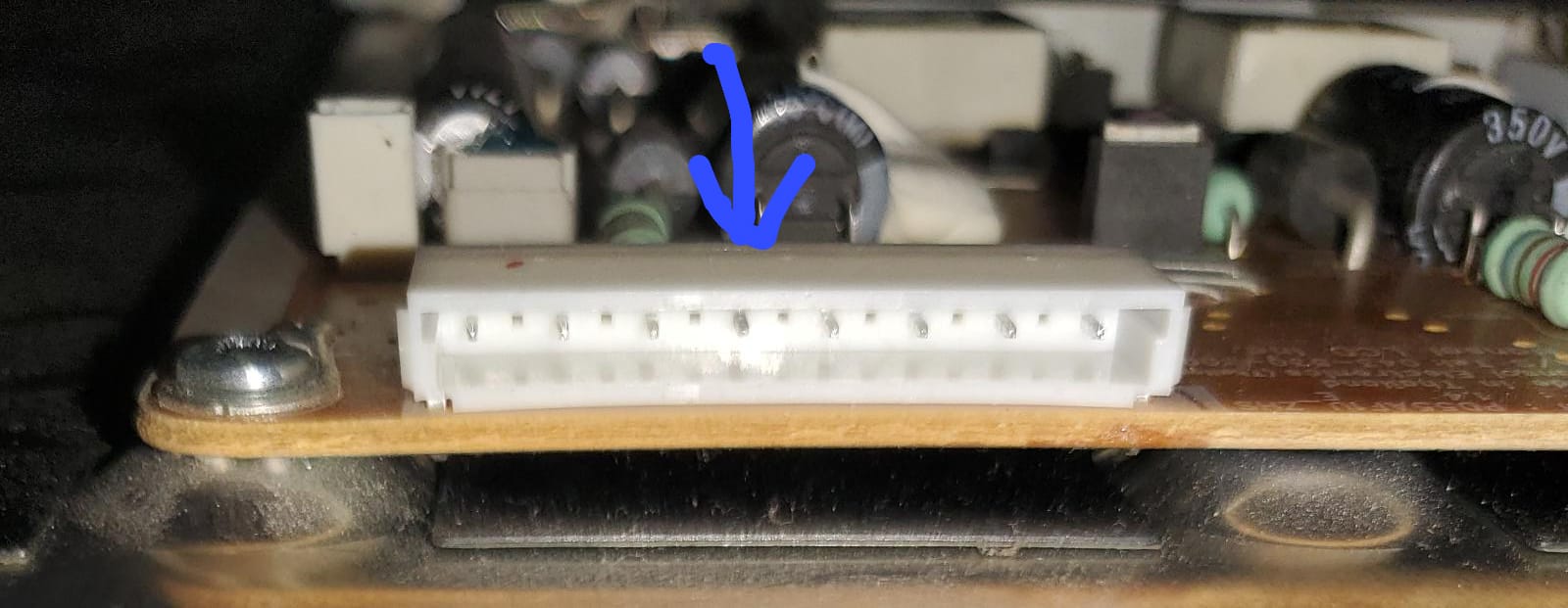

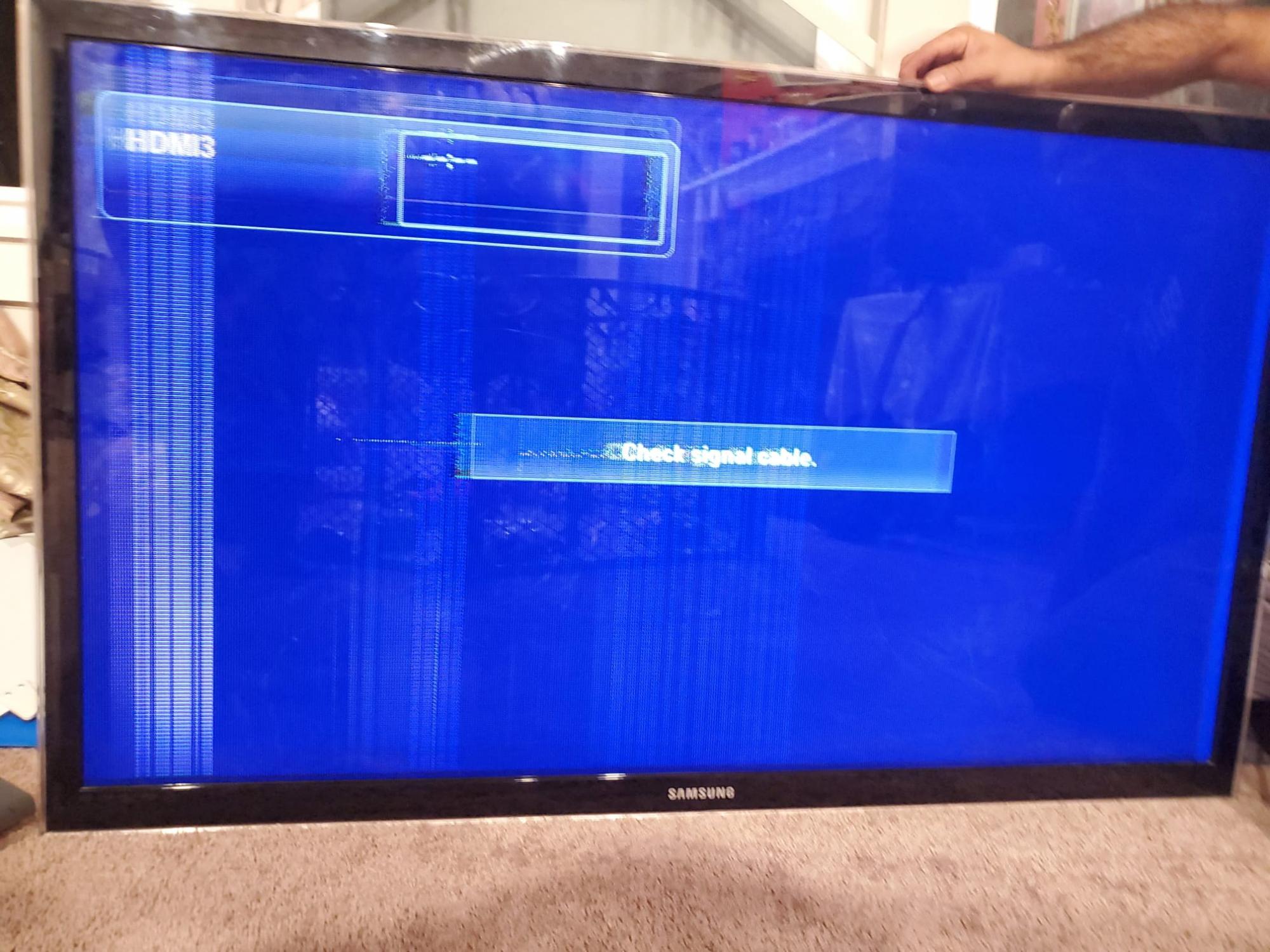

    I have a Samsung 55inch TV (UN55C6400RF). It has started showing colored vertical lines. I have opened the TV and the power board had one pin (out1-) which is discolored (Model # bn44-00358b). Can this be bad or is it the T-Con board (Model # D03464E0J09B6012066). Any recommendations on diagnosing the issue?

    Need photos of defect and the rest. Anyway Out1- is for the baklight and does not affect the pixels, anyway it has to be checked for voltage / resistance.

      Attached is the pic of the screen and the Out1- pin as compared to the other pins. Moreover I am hearing a humming noise from the power board. I will read about how to test the power board.
      I checked shopjimmy.com and it doesnt have the powerboard Model # bn44-00358bn for my TV, nor an alternate. Any recommendations where I could find an alternate version of the power board?

        The problem is on the tcon board or the panel, most probably the panel, i'm trying to diagnose same problem on mine, probably a bad chip or couple of chip on tcon.
