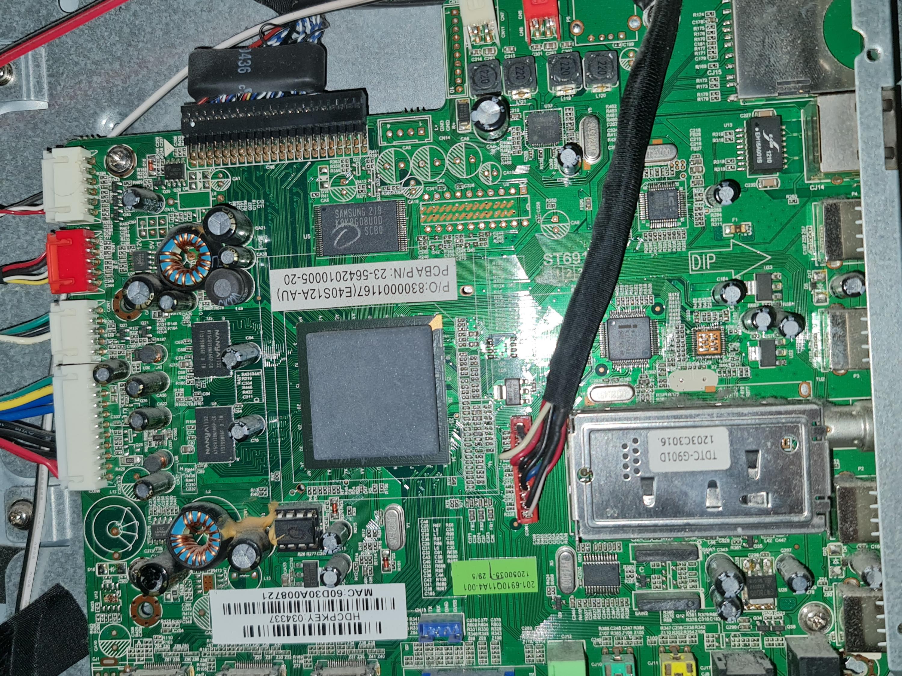

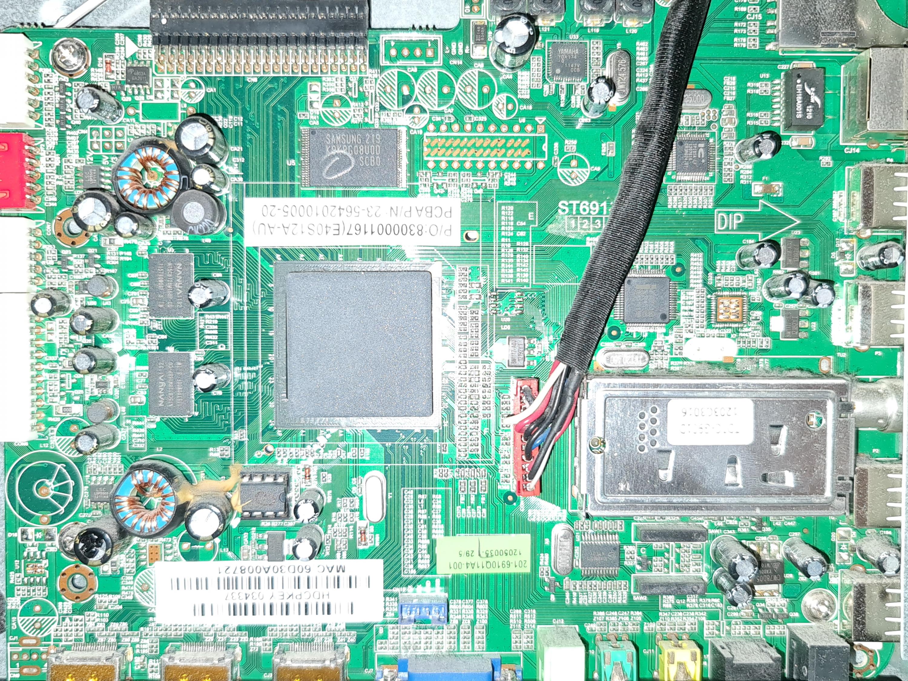

                Can you post some good clear photo's of your boards.
                • Eggbert43
                  • Jul 2014
                  • 47
                  Re: Soniq E40S12A-AU Stuck In Standby
                  Sure, let me know if you need something zoomed in or something better etc

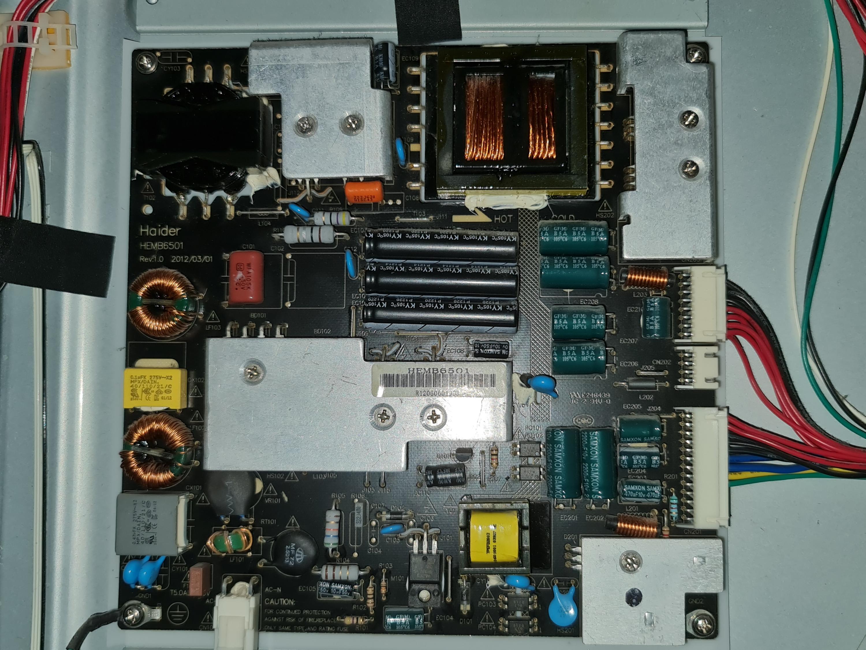

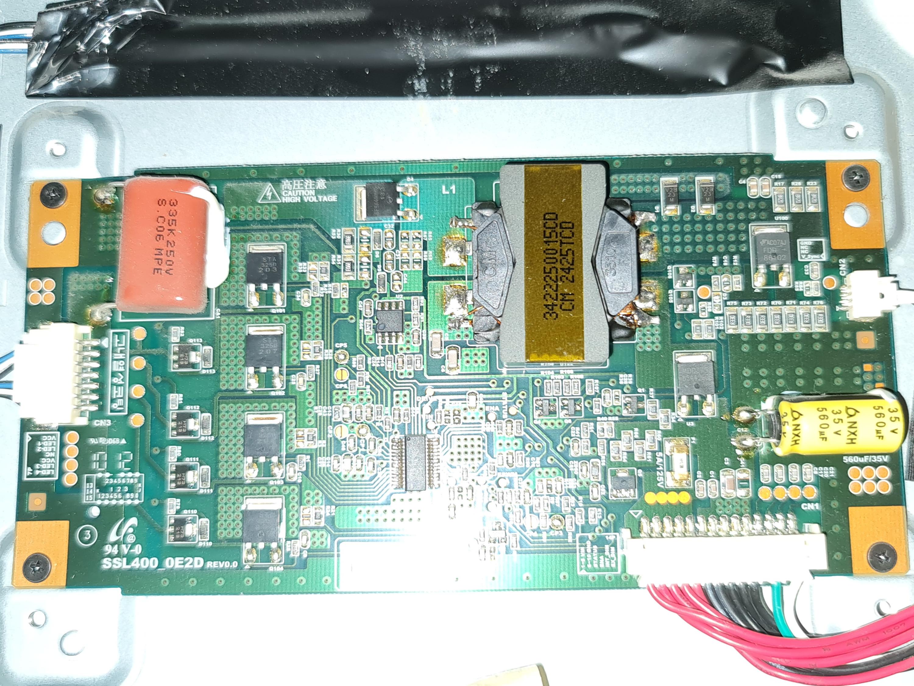

                    I would check the output voltages from the power supply. I believe that the Samxon capacitors are notorious at failing. Pehaps one of the supplies is falling after switch-on.
                    Also check the supply voltage to the led board.
                    The flash makes it a little difficult to make out everthing on the boards

                      So when you say check the supply voltage to the led board, do you mean check that yellow capacitor?
                      I'm not sure how to check capacitors so I will do a little research & get back to you, thank you.

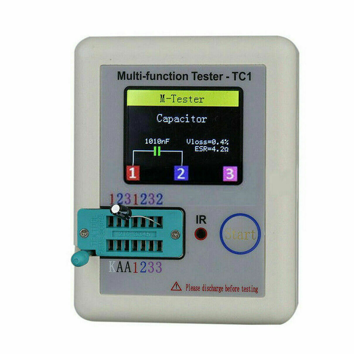

                        Ebay sell cheap component tester which are pretty good.
                        This one is OK but there are cheaper ones available. They will test your diodes and capacitors.

                          • Eggbert43
                            • Jul 2014
                            • 47
                            I have ordered the exact component tester pictured in the above attachment/post, but whilst I await delivery, I did my best with a basic Multimeter:
                            In an attempt to do as you suggested & check the supply voltage to the LED Board, my only idea was to test the Yellow Capacitor labelled 'NXH 35V 560uF' on the LED Board.
                            When Resistance Is Set 20K, the capacitor's resistance reading climbs to 1.31 but refuses to climb higher.... But when I unplug the Power Board from the LED Board & repeat this test, the capacitor's resistance reading climbs to infinity as expected.....
                            The resistance reading climbs to infinity for all the electrolytic capacitors on the Power Board. I am yet to investigate the various other/smaller components etc
                            Does this tell us anything, especially the bit about getting a different resistance reading when the Power Board is unplugged?
                            Thank you
                              Capacitors are not so easy to test especially in circuit since they have other components connected to them.
                              I would be more interested in what voltages you have on the white connectors CN1 and CN3. Where does CN2 go?

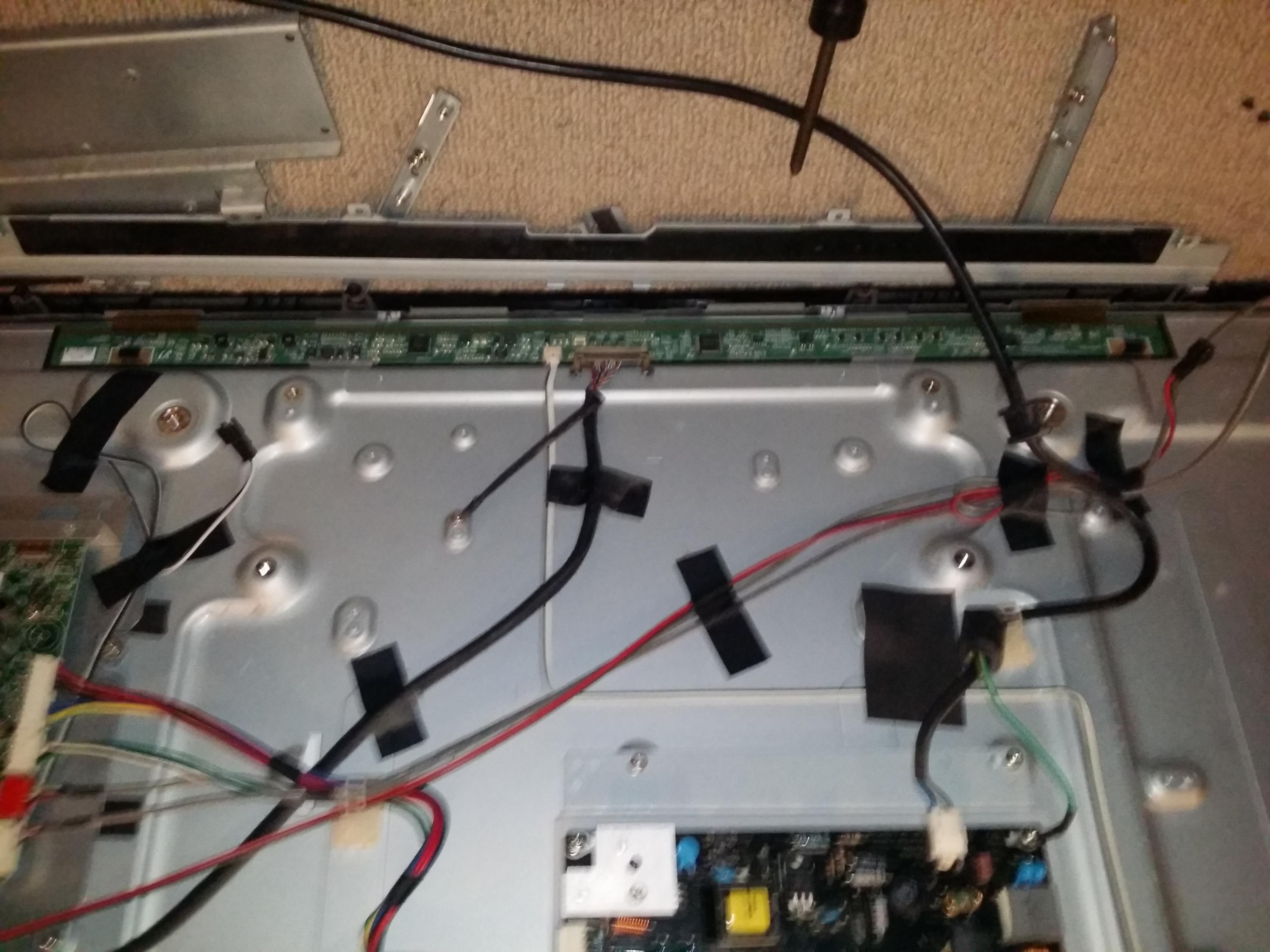

                                CN2 goes down to the very bottom centre & plugs into something I haven't inspected yet?
                                There is some sort of board running horizontally along the bottom. Took some effort to expose; please see attached photos...!
                                Any thoughts?

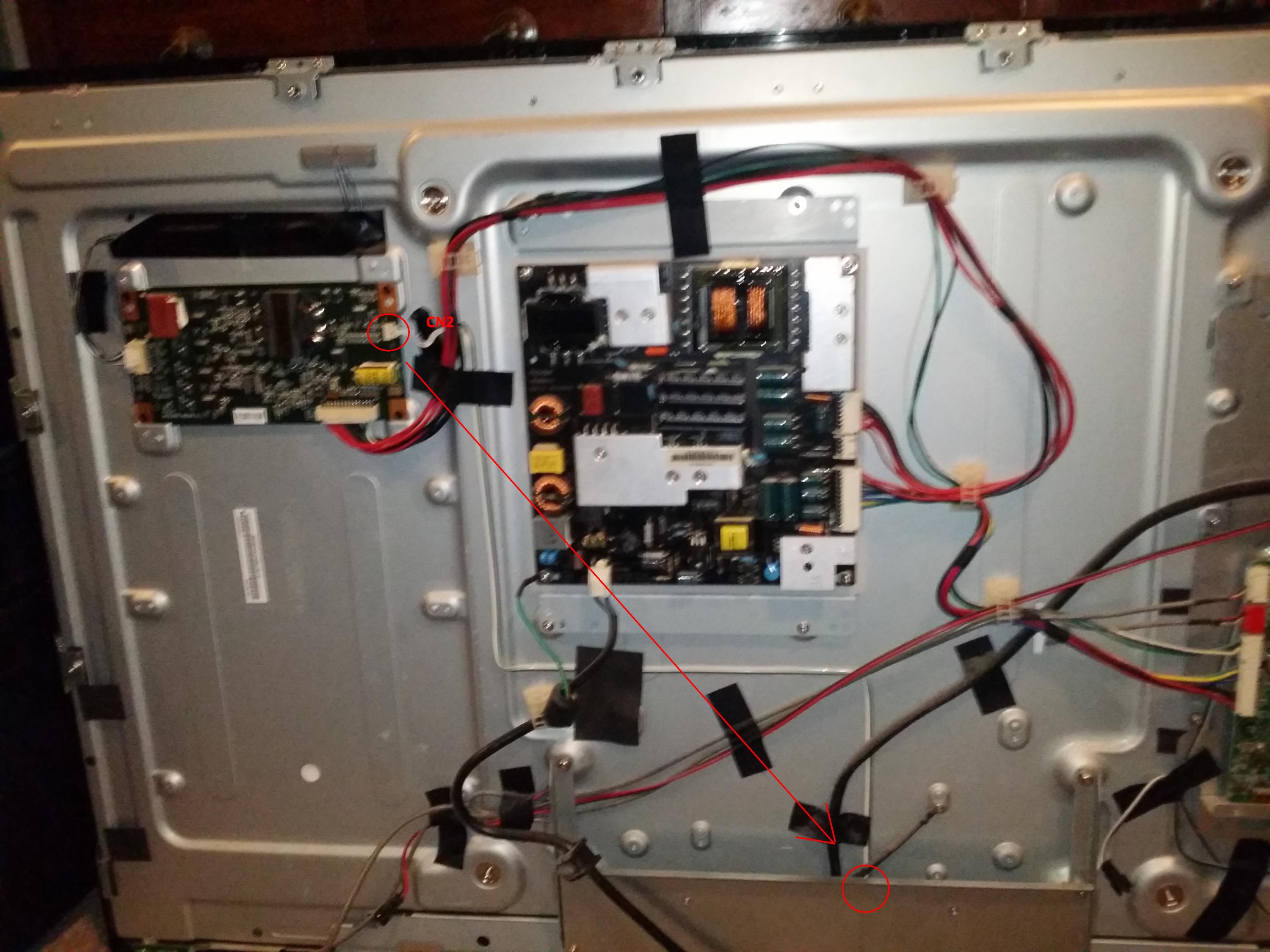

                                  The first image is upside down sorry, the one where the board is exposed.....
                                  Let me know if any close-ups might help, thanks....!
                                    It looks like its the Local Dimming signal cable from led controller to Tcon
                                    In Local Dimming backlight, LEDs under the LCD panel are divided into many small zones. Using content-adaptive backlight control, the brightness of each zone is adjusted according to different display content. A local dimming backlight allows the display to have “darker blacks” and “brighter whites”.
