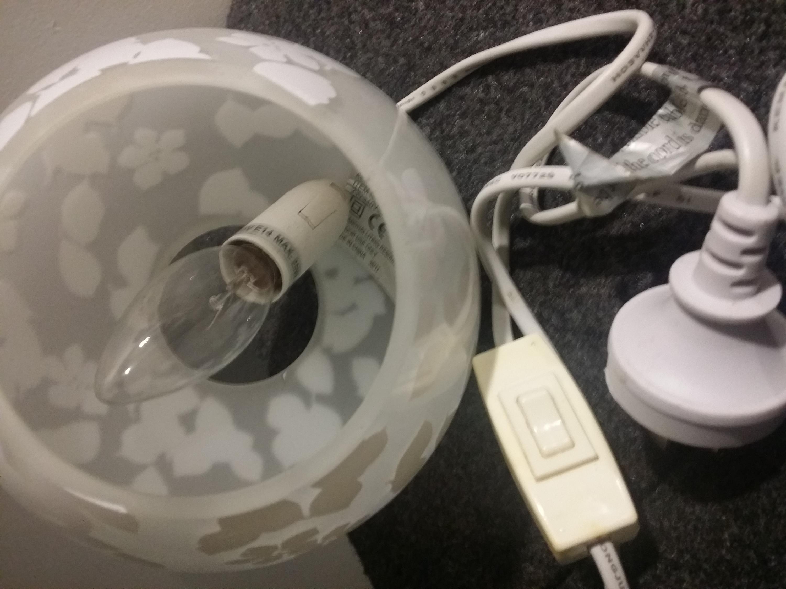

      Re: Soniq E40S12A-AU Stuck In Standby
      Originally posted by Eggbert43
      I'm struggling to grasp where the wires come from?
      which wire ? the photo i added to you.. its any table lamp with filament bulb will have only 2 wire only which take AC from wall socket... this 2 wire one you connected with the wirw which you need to slide it out from the BL socket and the next of the bulb go to the socket at pin3
      sockets on power boards PIn3 -------- table lamp ------- the wire go to backlight

          #64
          I have just found a table lamp; see photo.
          However, I am still unsure where the wires you speak of are going to come from?

            #65
            Do you mean for me to cut the end of the power cable that plugs into the wall off & use those wires?

              #66
              yes
              after u cut test it in wall to be sure it work and its switch are on on.. then put it in tv as told.
              you can open the switch and take out the wire from there.... no need to cut

                #67
                Yey I got there in the end...!
                So, I will do as suggested, making sure that the lamp is switched on before switching on the TV....
                Are we hoping for the screen to stay on & the bulb to light up?

                  #68
                  its your hope too,
                  the bulb will never light on... it will be as resistor only

                    #69
                    No joy, it didn't help....
                    So, in terms of taking the TV apart more, do you have any tricks to bypass the bad LED once it has been identified & we are looking at it?
                    Are we sure that this problem can't be caused by a bad capacitor on the Power Board or something?
