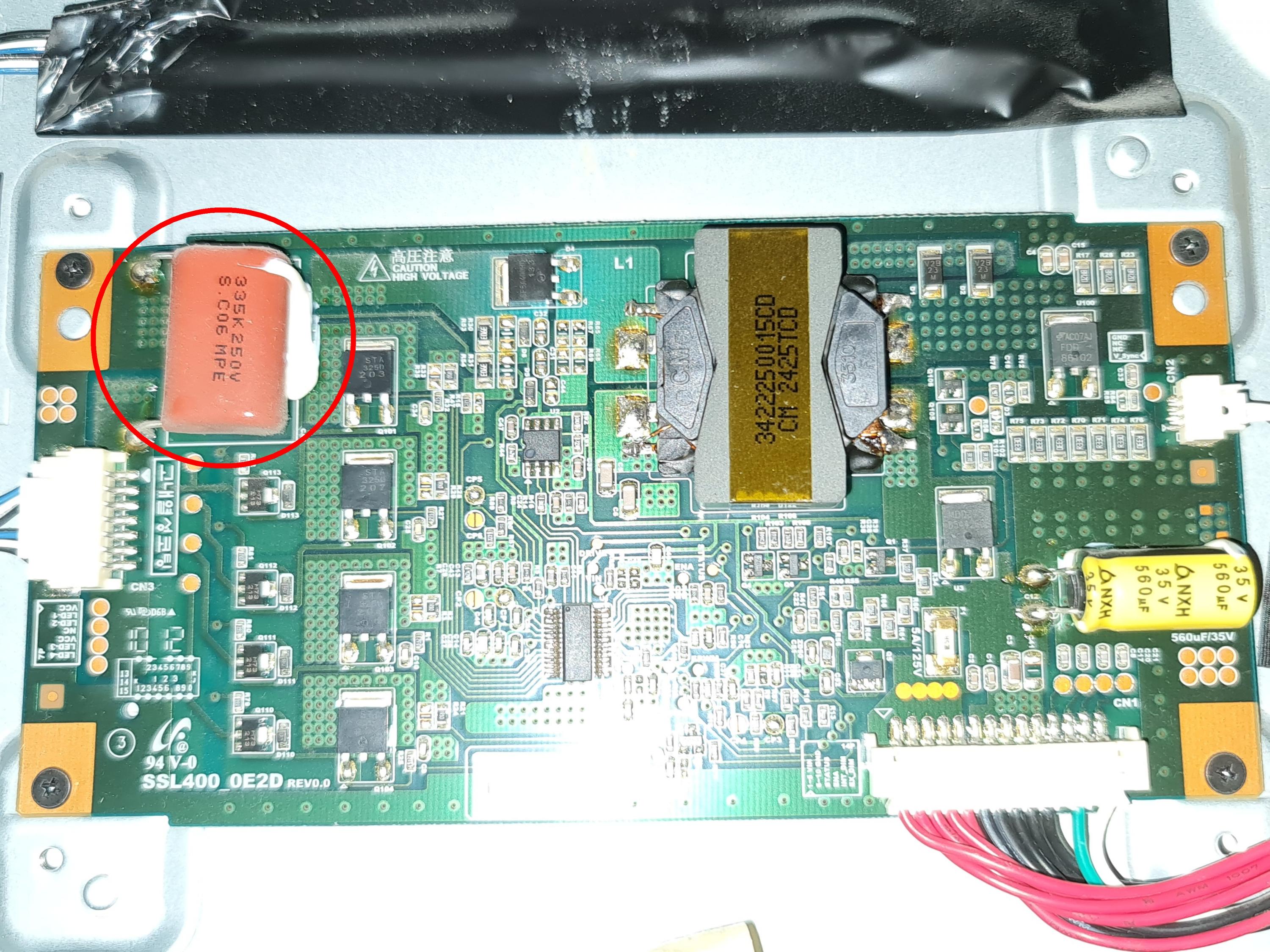

      I'm not confident that I accurately measured the Voltage on Pin 6; maybe my DMM plugs weren't touching the pins properly or something. So I'm going to put Pin 6 back & test again, before possibly trying my luck with Pin 2 removed.
      I do however have another idea which I would like to run by you; it involves the MPE Capacitor located right next to the connector in question, circled in red at the top left of the attached image. My TC1 LCR Tester is telling me that it's a Diode!!
      Is this a sign that it could be damaged/faulty?
      Could this component, if faulty, be responsible?

        No, this ceramic cap are fine.. dont play with inverter boards to avoid make damage.

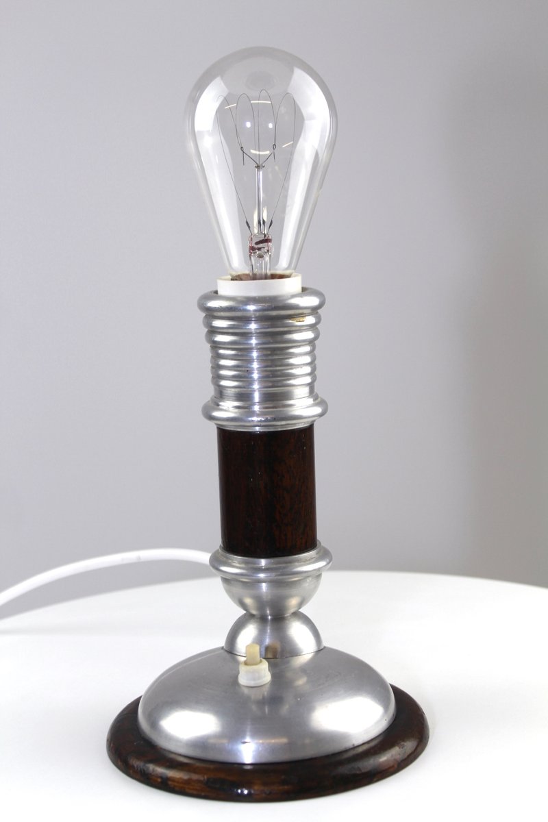

                            let us add resistances to this line to trick the circuit keep on in case need.
                            if you have "table lamp" with filament Lamp from the sockets take out the 2 wire of it and connect them between pin3 ( after you slide it out from sockets ) and the sockets pin3 , just try will not harm the BL or the circuit.
                            if you dont have then you must take out the screen.

                                  normal bulbs used in table lamp etc which u used to plug it in wall socket AC ... dont beak it to take out the filament LOL.... just use it as it. so if it installed in table lamp example the socket of the table lamp where you pülug it in wall take the wire out and put them end to end between the mentioned pins. ( dont forget if you use any table lamp or other device with this bulbs be sure if there switch need to be ON LOL

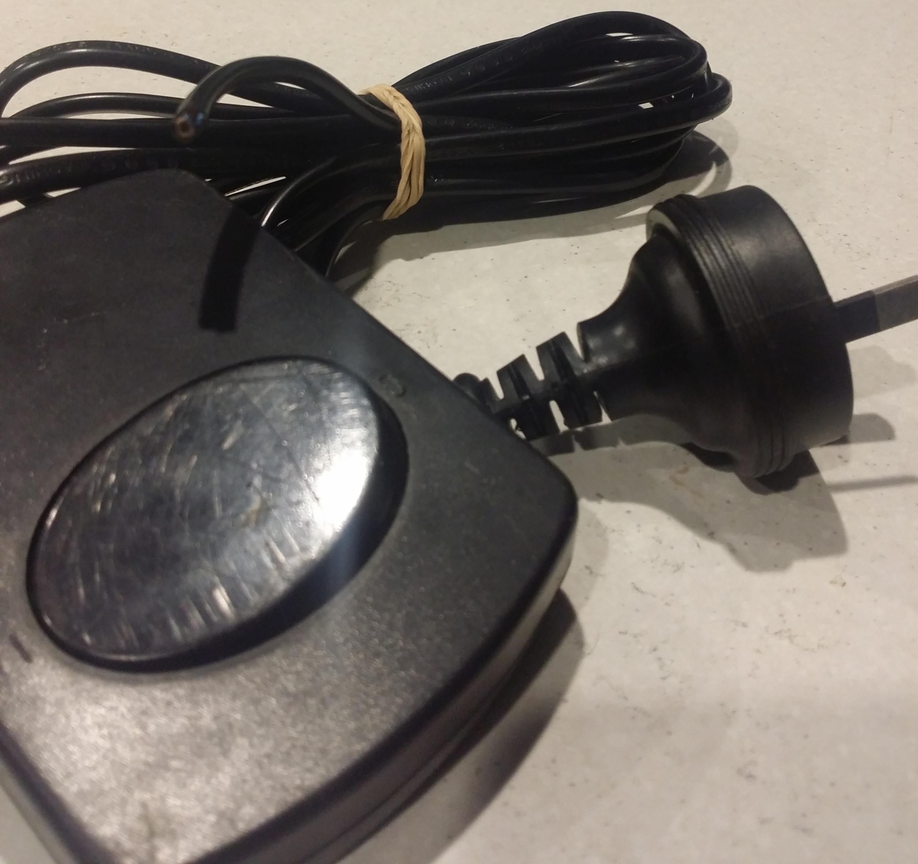

                                    If I'm understanding you correctly, I may have something suitable; please see the attached photo & let me know if I'm on the right track?
                                    It is basically a switch that plugs into the wall, with the two bare wires available at the other end.....
                                      where are the bulb ??
                                      man its just table lamp... what do you call it in yours country ??? take a look

                                        I'm struggling to grasp where the wires come from?

                                          if you dont have at home... dont go to buy LOL
                                          we just want to add it to this pin 3 line to increase resistances in hope the circuit remain on so you can use the TV.
