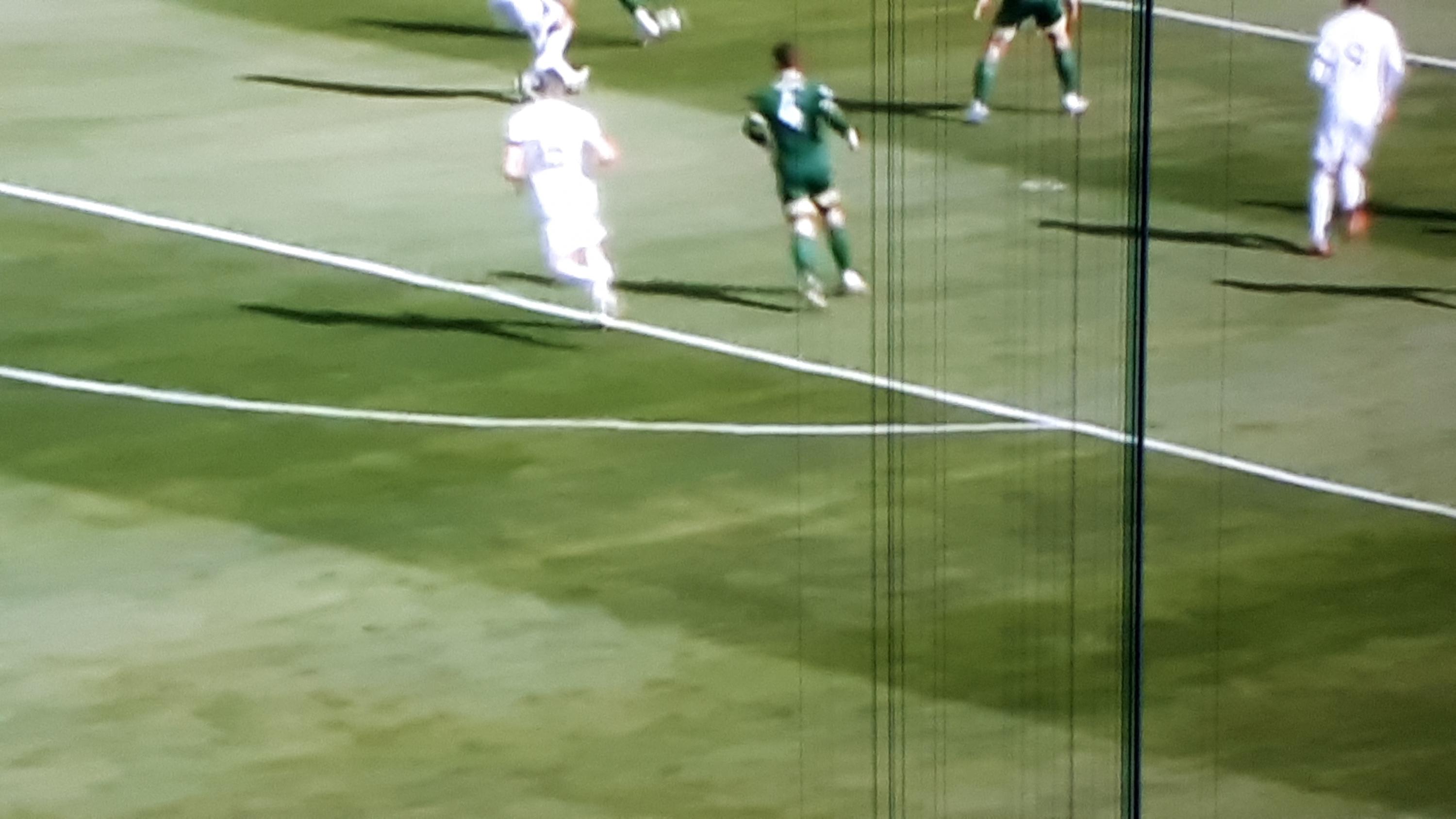

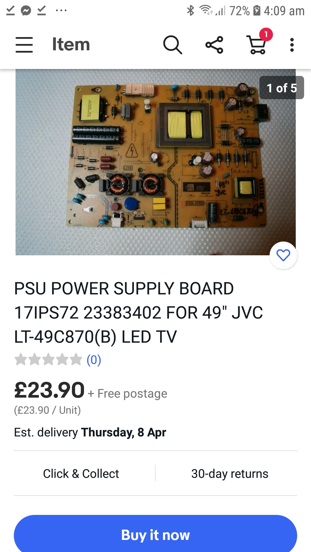

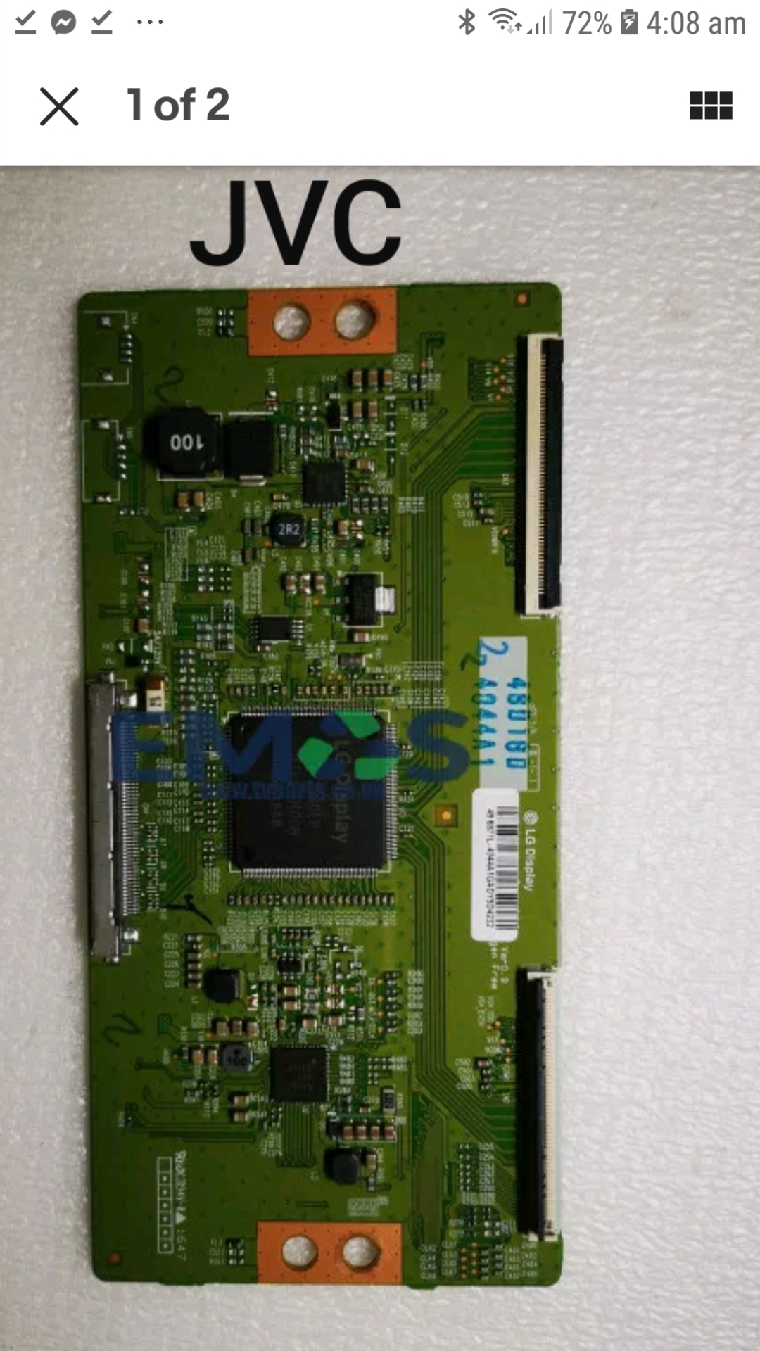

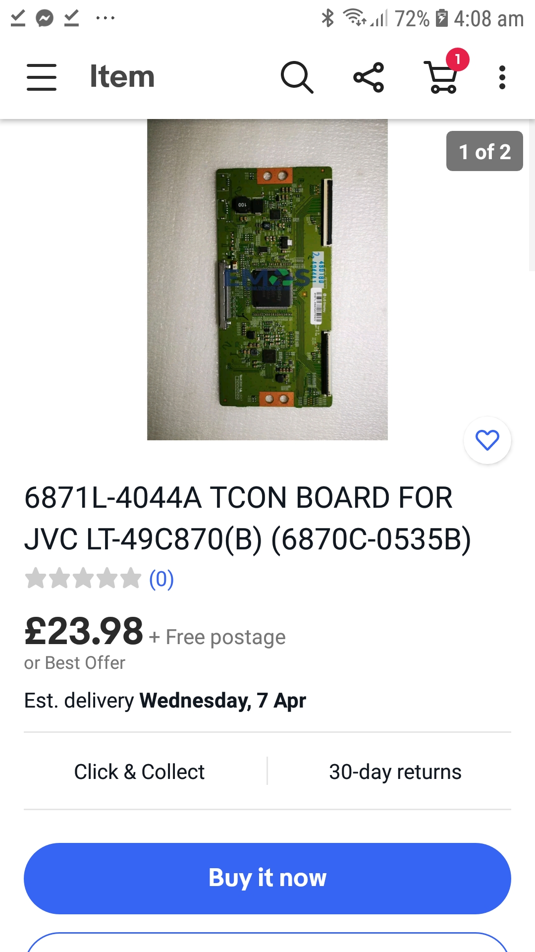

    Hi all, I haven't actually got this tv yet, I just thought I would ask about the problem in advance of getting it.
    It's a JVC LT-49C870 (B) and it has a vertical line running from top to bottom on the right side of the screen. I'm hoping it's a tcon board but would appreciate any input. I've googled the model for the boards and uploaded pictures of them .

    Re: JVC LT-49C870 (B) line on screen ?
    It's a Vestel TV and a single line would suggest faulty panel not tcon.

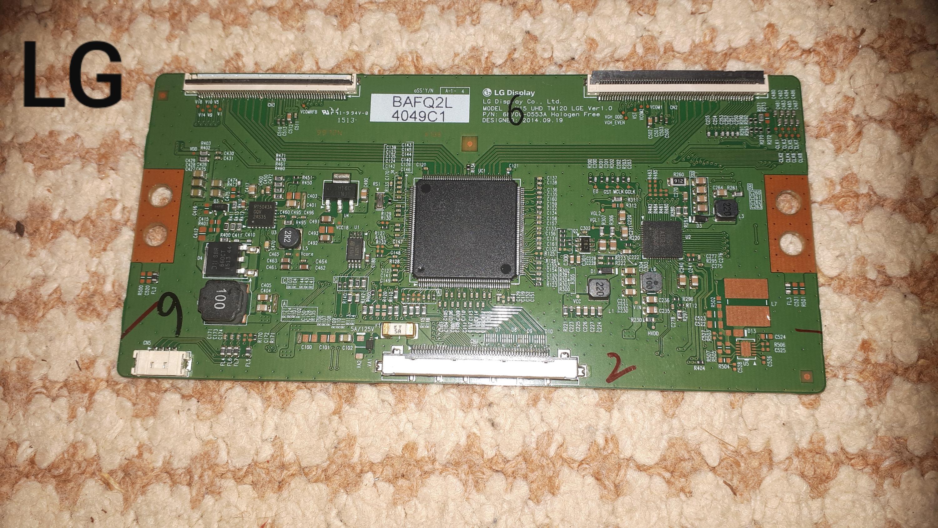

      Thanks for your input, I have the tv here now, I had a feeling it was going to be the panel before your reply (only because ive got the same issue with a Hitachi 4k I've got. I'm still going to have a mess around with it to see if I can get it any better . I'm not on a mission to blow it up or anything lol but what is the worst that can happen if I stick a similar tcon board on it ? It's got the same fittings & looks pretty much the same apart from various components missing , also it's from an LG49UF850V ..

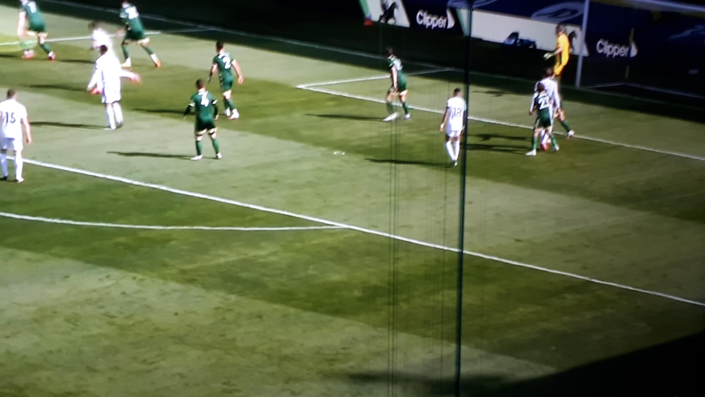

        Just making sure before scrapping the tv, the original picture I uploaded looked like a single line , I still have a feeling it is the panel but I would appreciate it if you could check out my photo as it isn't a single line but a cluster of lines in the same area of the screen ...
