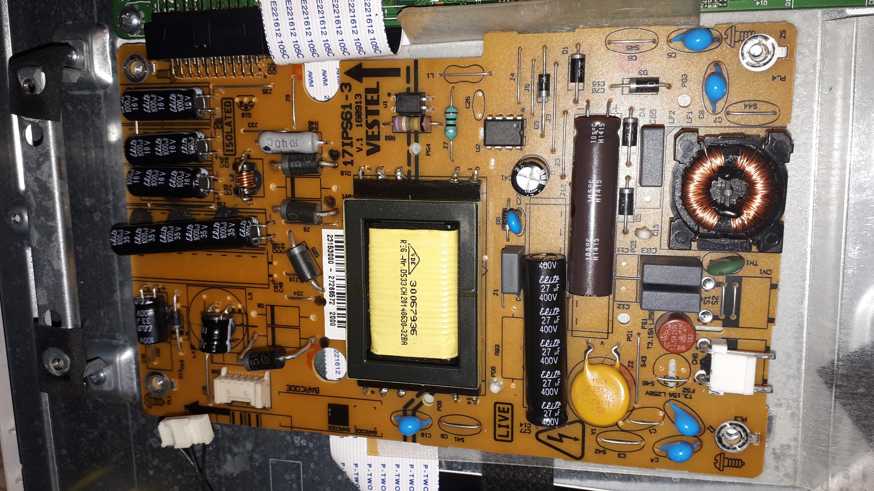

    Hi all , I thought I could tackle this problem without having to bother you's lot "AGAIN".
    Toshiba 24d143db (Vestel 17IPS61-3) , I thought was going to be a straightforward diode replacement , however after replacing diodes D9 (UF5402) , D10 , D12 & D25 ( SB5B0 )I'm still left with exactly the same problem, not turning on & standby light flashing red/green. I've ended up resorting to Google & I'm seeing it could be a firmware issue?

    I think you're on the right track, did you try it?

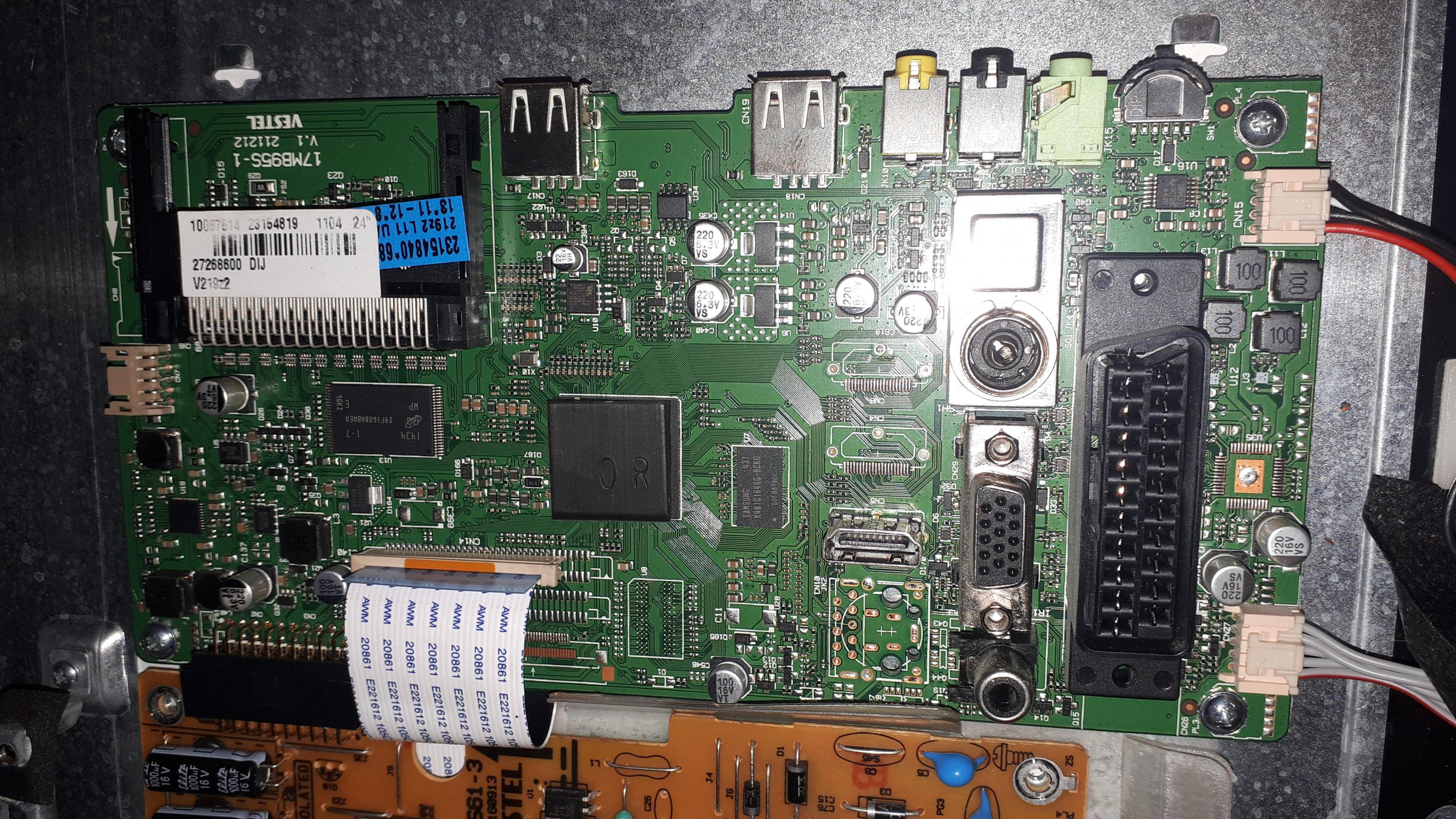

        Re: Toshiba not working, standby blinking red/green
        download the firmware for your model, put it in usb and plug in botom usb at tv while unpluged from main power.
        plug main power and press ok at remote control.
        should work.
        im having similar problem. i tried programing nand and now it does not blink led anymore. i read this nand usually break at this vestel boards.
        im waiting to have my own programer to try and see if i can just program my nand or order a new one
        i did a firmware brick and lost backlight. when i tried to reprogram nand lost the blinking led
        p.d. when you plug usb and plug tv to main power, led blinks faster when ok is pressed that means tv still has response to remote and should start update.
        i lost that blink light reprograming nand this last try. i think my nand is broken took too long to read and write. maybe the programer i use... dont know hope to find out soon

                Re: Toshiba 24d143db not working, standby blinking red/green
                LED blinking because short circuit or corrupted firmware. If Firmware deleted led not shining.
                When upgrading firmware press and hold “ok” button until led blinking fast.
                      Originally posted by arizanotlari
                      I think mb or pwb is faulty.
                      but i brick it, i saw this tv working with vestel firmware.
                      then i break it installing wrong firmware because vestel firmware does not work with toshiba remote
                      maybe i have broken the mainboard or power board by firmware?
                      then i did spi programing, no changed, then nand programing and i think something went wrong at this point. then tv led does not blink i want to try do it again as soon i have my own programmer

                        I read first message and you write about pwb fault. That’s why I suspect pwb.
                        Vestel, toshiba or other brands including 17MBxx chassis detects rc signal when booting. Remote control type (vestel or toshiba) not important until tv boot up.
                        If standby led not blink resolder nand. If you need dump try this https://yadi.sk/d/AgEnj8vsddVttw

                              mine is already fix and working so ok for me

                                Thank you all for your input, before reading your replys I managed to get a bang from the power board so instead of messing about with the original pwb I rebuilt another VESTEL 17IPS61 that I had been using for components, I managed to get it back to the original state , I got impatient and passed it on ..
                                    So what exactly was your fix pep2k21, reprogramming your original nand?
                                    reprograming nand memory with correct firmware. first time my friend did and his programmer did not worked fine. slow reading and writing but no errors. i ordered a tl866ii plus, arrived this morning and today did my first tsop soldering looks not too bad
                                    tv started as a new configuration. everything perfect
                                    https://www.badcaps.net/forum/showthread.php?t=94206
                                    but think i did a real disaster most of the times can be done with usb
