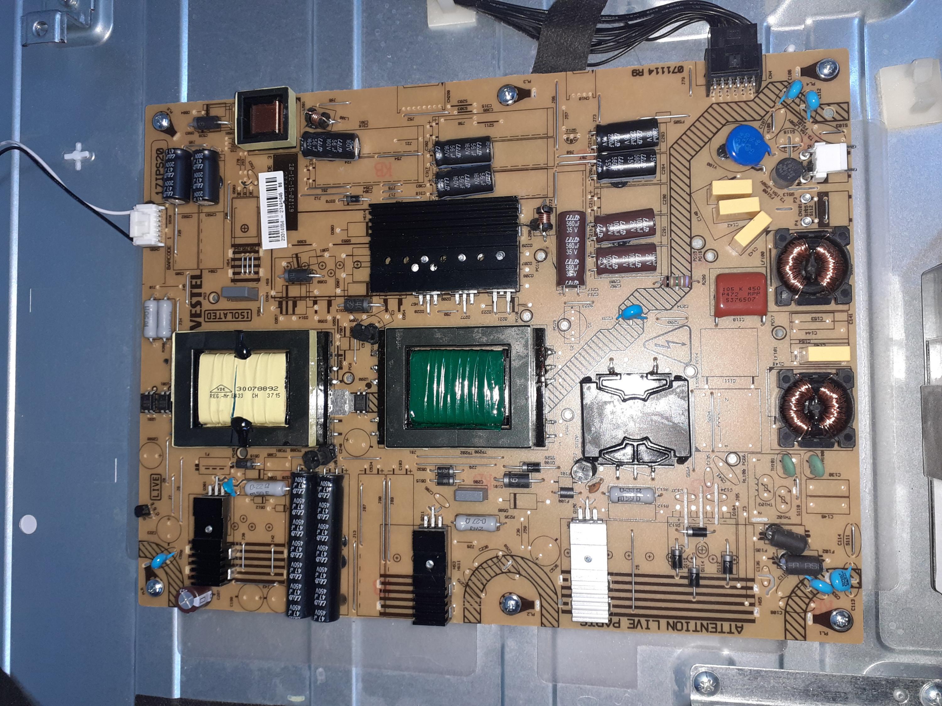

    I have replaced the PSU board with a new one. I can post pictures and a short video with the issue but I do not know how to post them

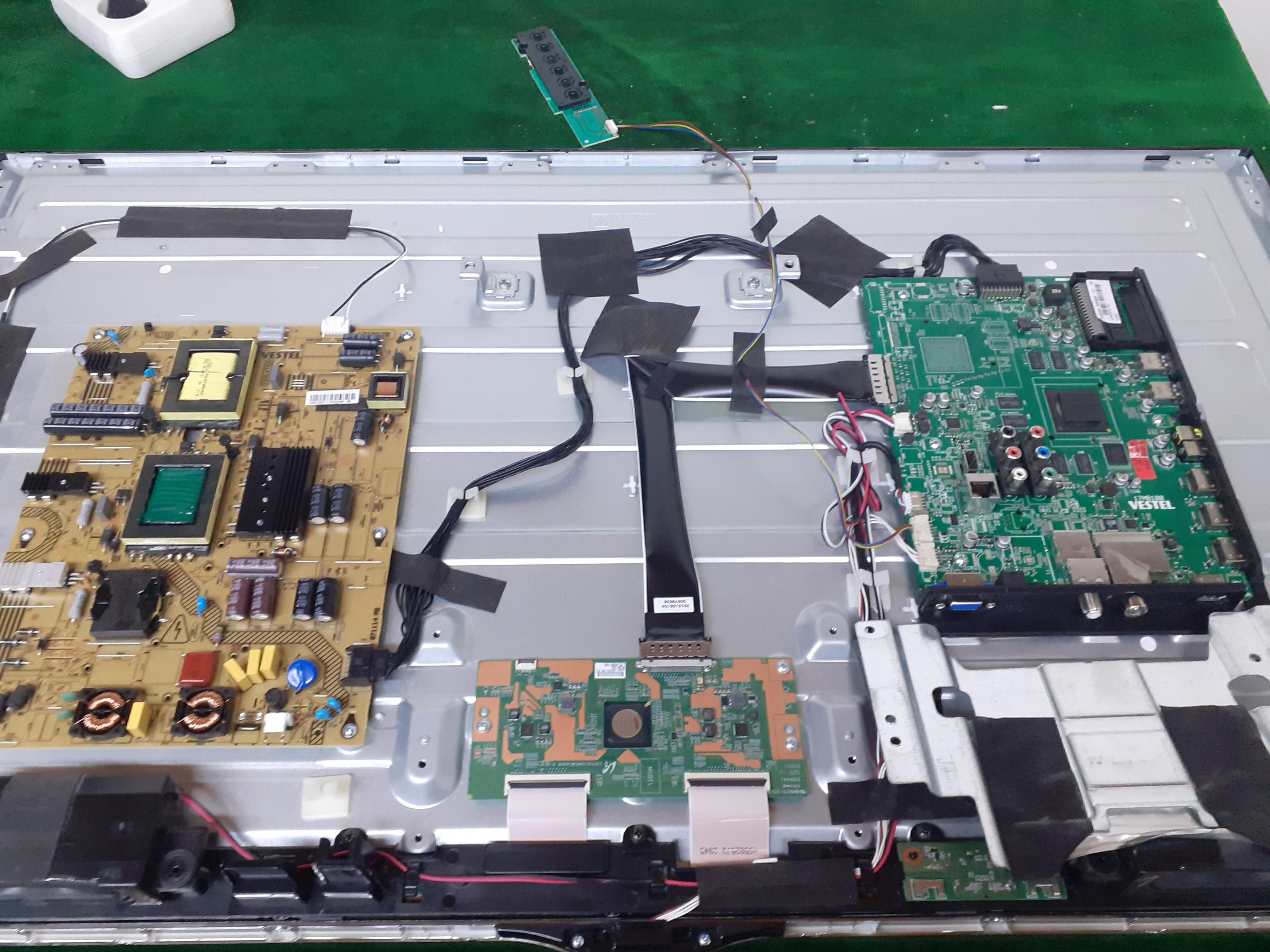

      Attach pictures of the whole backside of the tv, to see how they are all connected and of each board, does the tv have a stand alone tcon board? If so test that you have probably around 12 volts on each side of the fuse on the board, black probe to metal chassis ground, if you haven't already.

        Re: JVC LT-40V953 standby light flashes and stays on but no picture

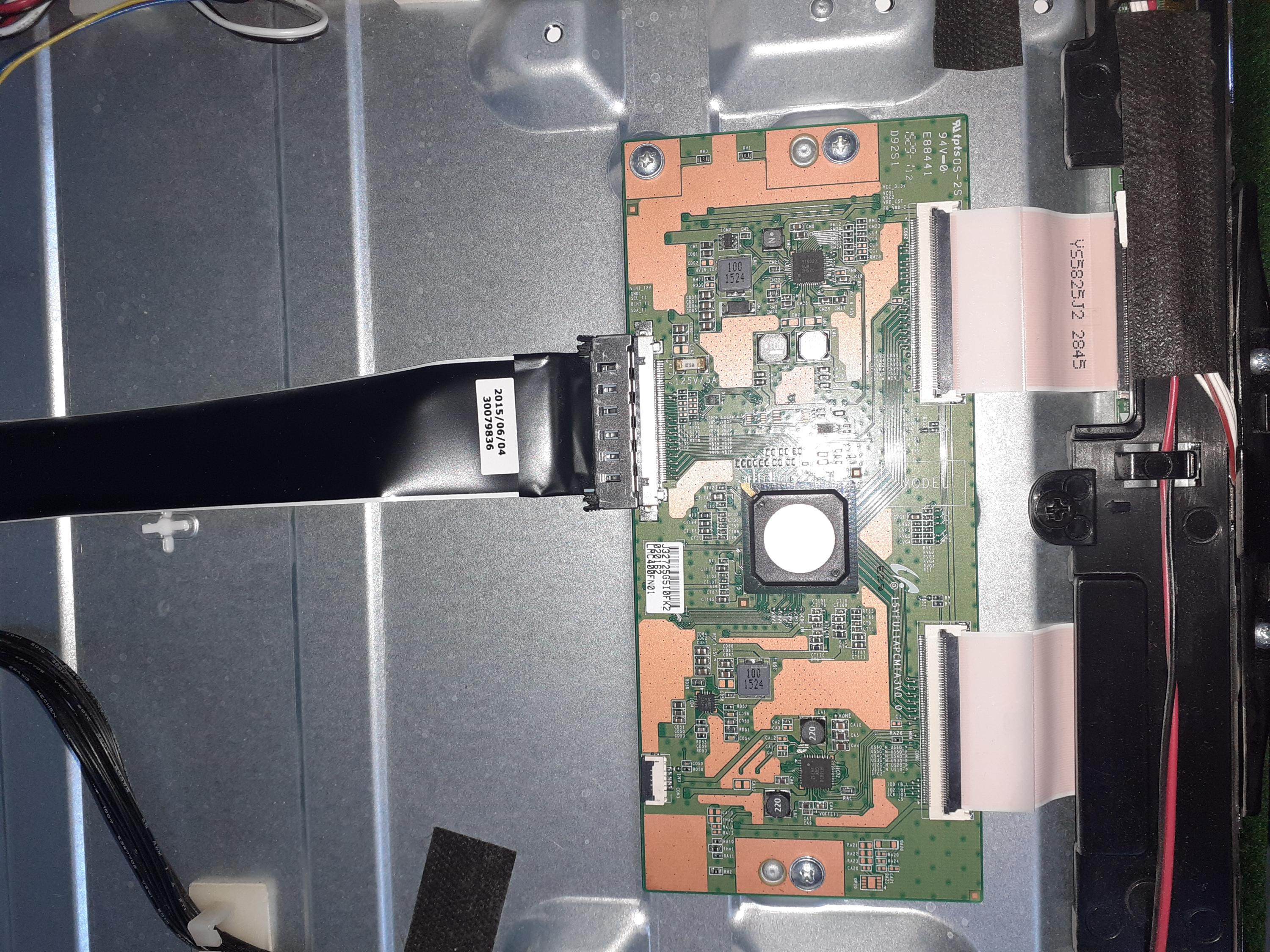

        Tomorrow I will upload more photos from all tv boards. I have checked the t-con board fuse but not getting the 12V

          You tested it as in this video, correct?: https://www.youtube.com/watch?v=iuHrnvAKlGw
          • nomoresonys
            • Jan 2013
            • 12074
            • U.S.
            Here's another, see if you have those 12 volts there on the LVDS ribbon cable, if not check those components he's checking on the mainboard: https://www.youtube.com/watch?v=ocqnqmBxiqY
                  My mistake. I measured the 12V at the T-con.

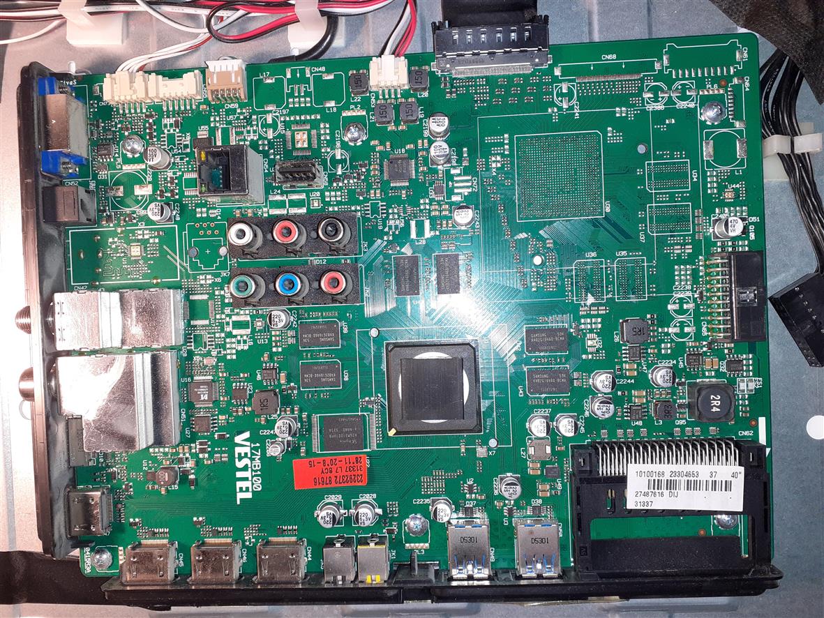

                    The URLs from my google drive are:
                    https://drive.google.com/file/d/1iXi...ew?usp=sharing
                    https://drive.google.com/file/d/1iCZ...ew?usp=sharing
                    https://drive.google.com/file/d/1i70...ew?usp=sharing
                    https://drive.google.com/file/d/1evS...ew?usp=sharing

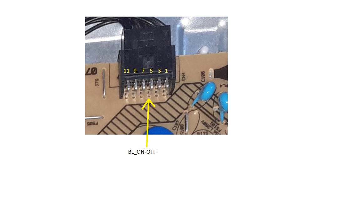

                          Monitor the voltage ACROSS the black and white wires going to the led's when the tv is first turned on, Does it go up to about 160v then drop down?
                          You could also check the voltage at D504 when the tv is first turned on.
                          Also check if you have BL_ON-OFF voltage (3~5v)
                              BL_ On-Off 3.3V
                              LED connector 72V and dropping (Voltage across black and white)
                              D503 voltage 172V and dropping (D504 does not exist on the board)
