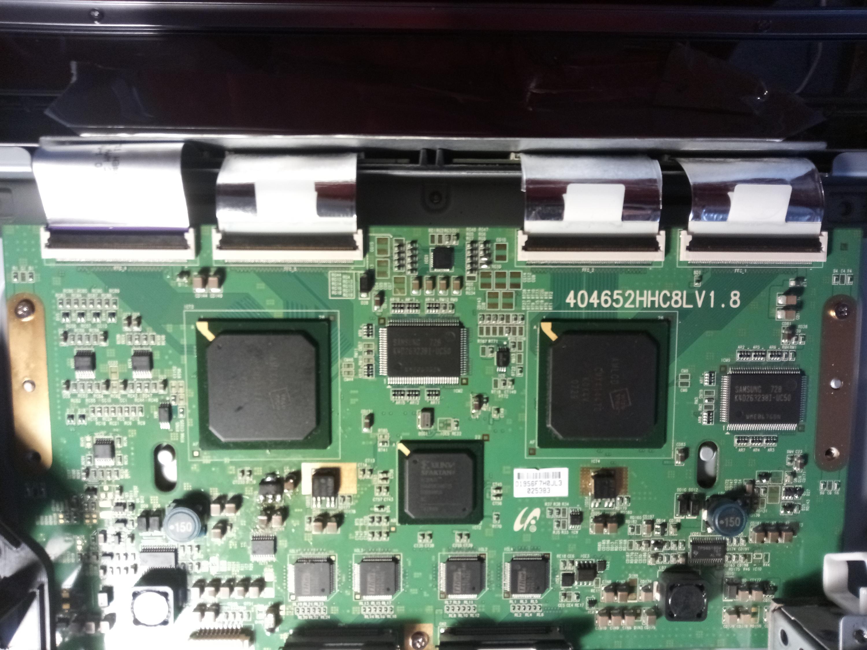

    EDIT: it tell T-CON issue.. can we see yours t_CON

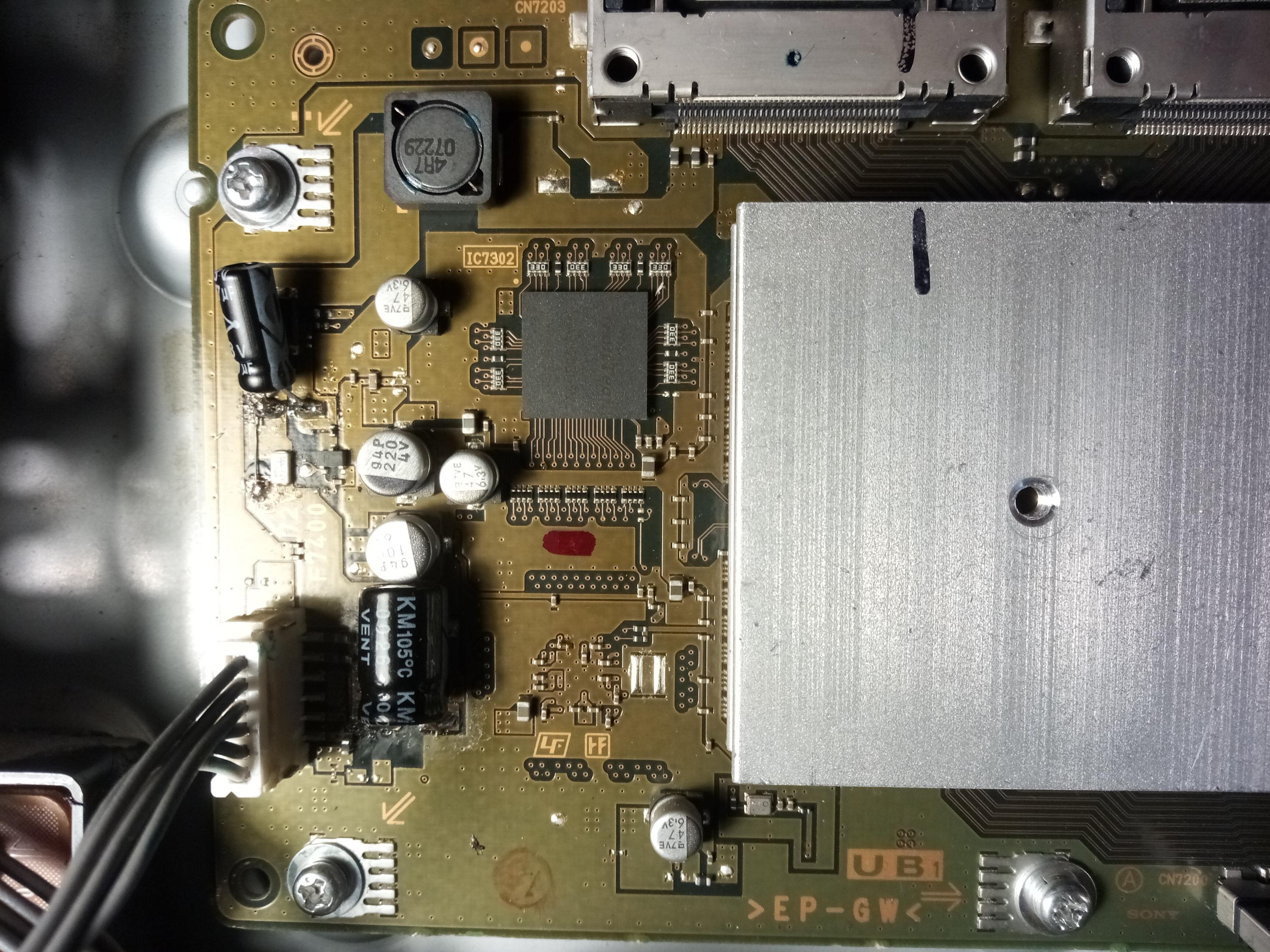

                          so as you sugested i had a close look at 12v supply.
                          first it goes to logic board and is 12.1v
                          then it goes through 8 pin ic type tcp 8109 q7403
                          the i/p to this is 12.1v but o/p is 11.4v ,
                          pin4 of this device is a control pin
                          so the volts that arrive at t con are low just as you said .
                          after checking for any low resistances , none found .so i unplugged connection from logic board to t con and voltage came up to 12v as you would expect under no load
                          please see cct ub1 board page 155 bottom right corner
                          try to upload cct for some reason wont work will try again

                              the two 47uf on the i/p to q7410 replaced
                              the 4.7uf on the o/p c7455 replaced

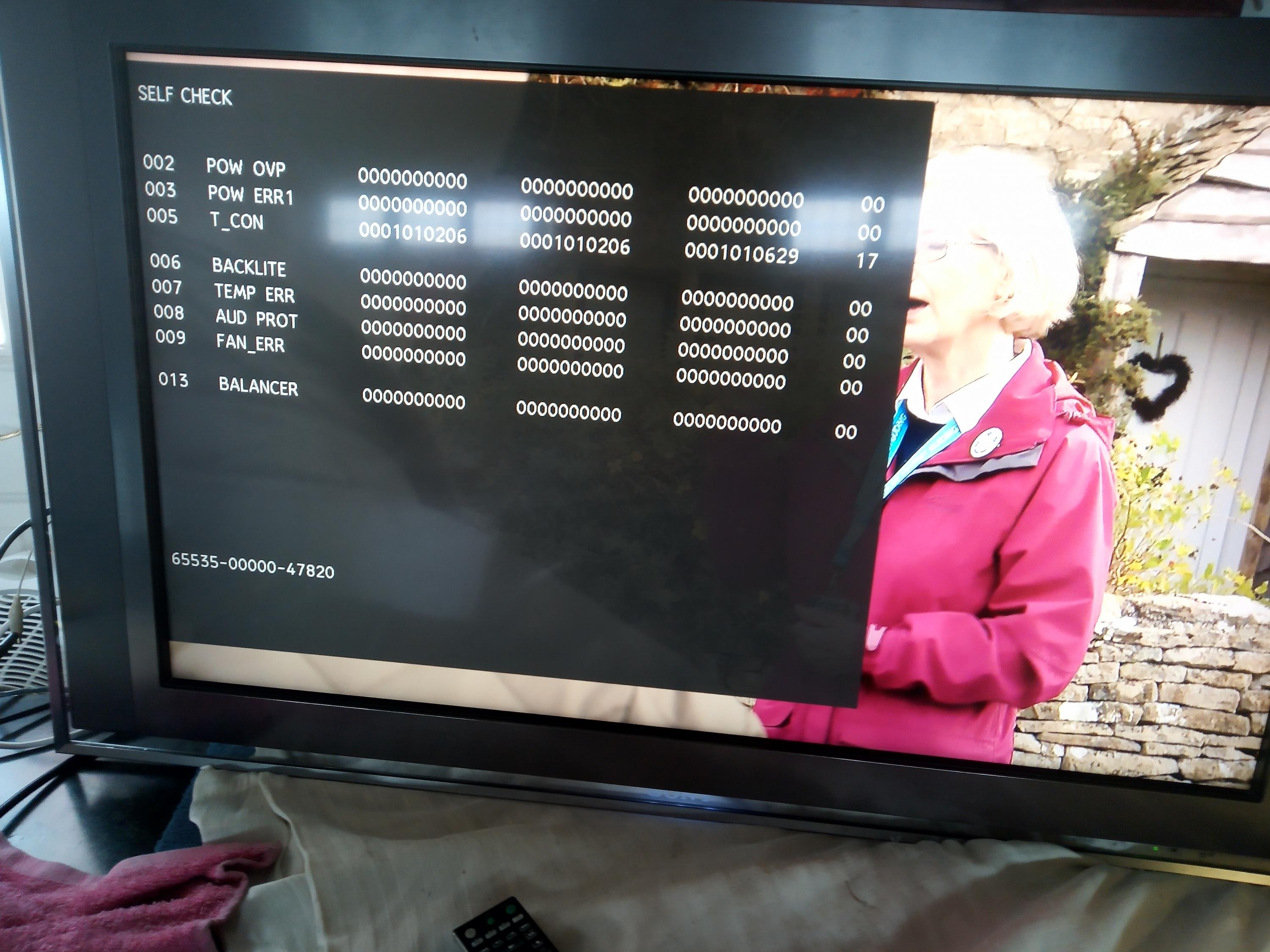

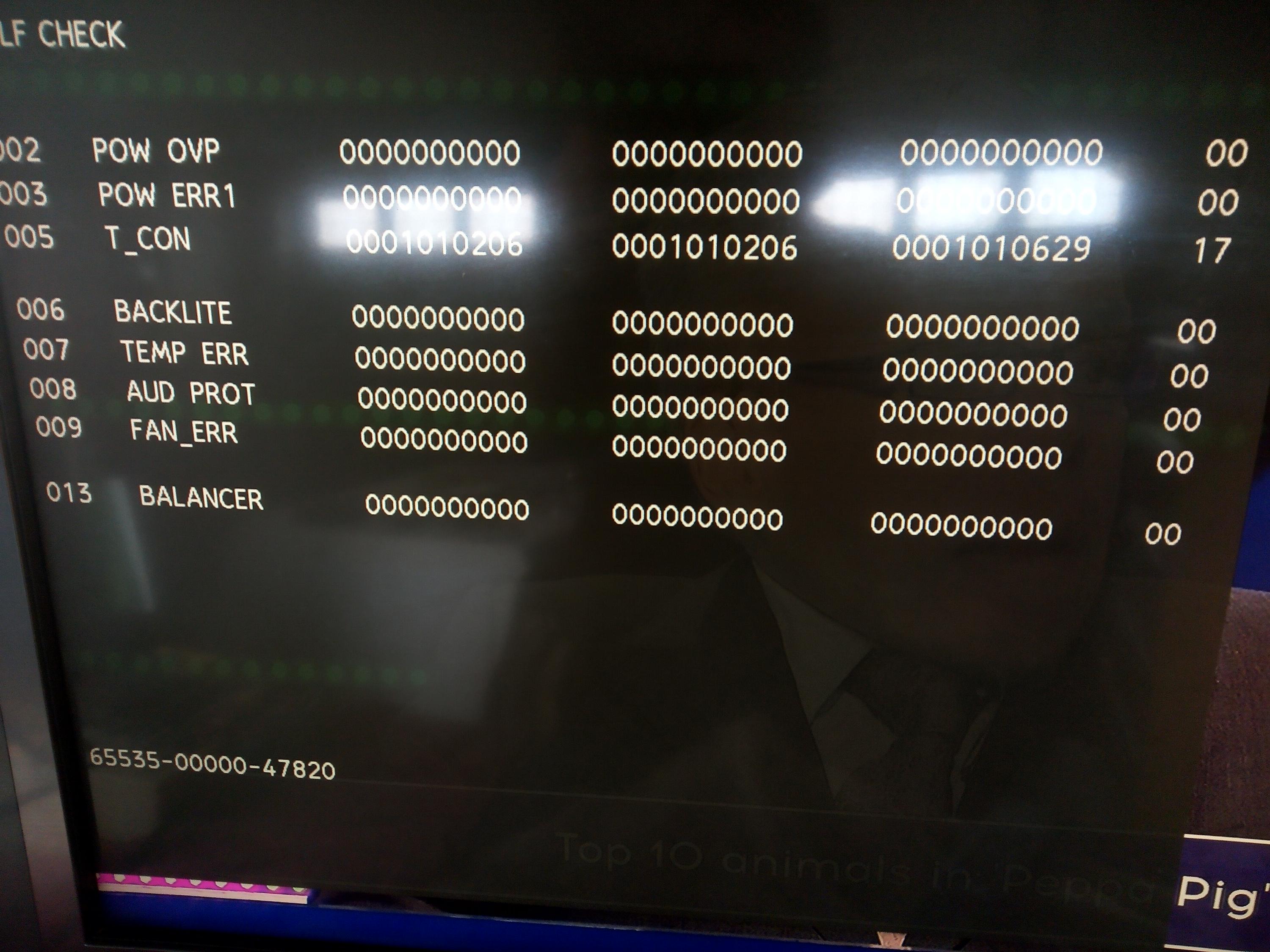

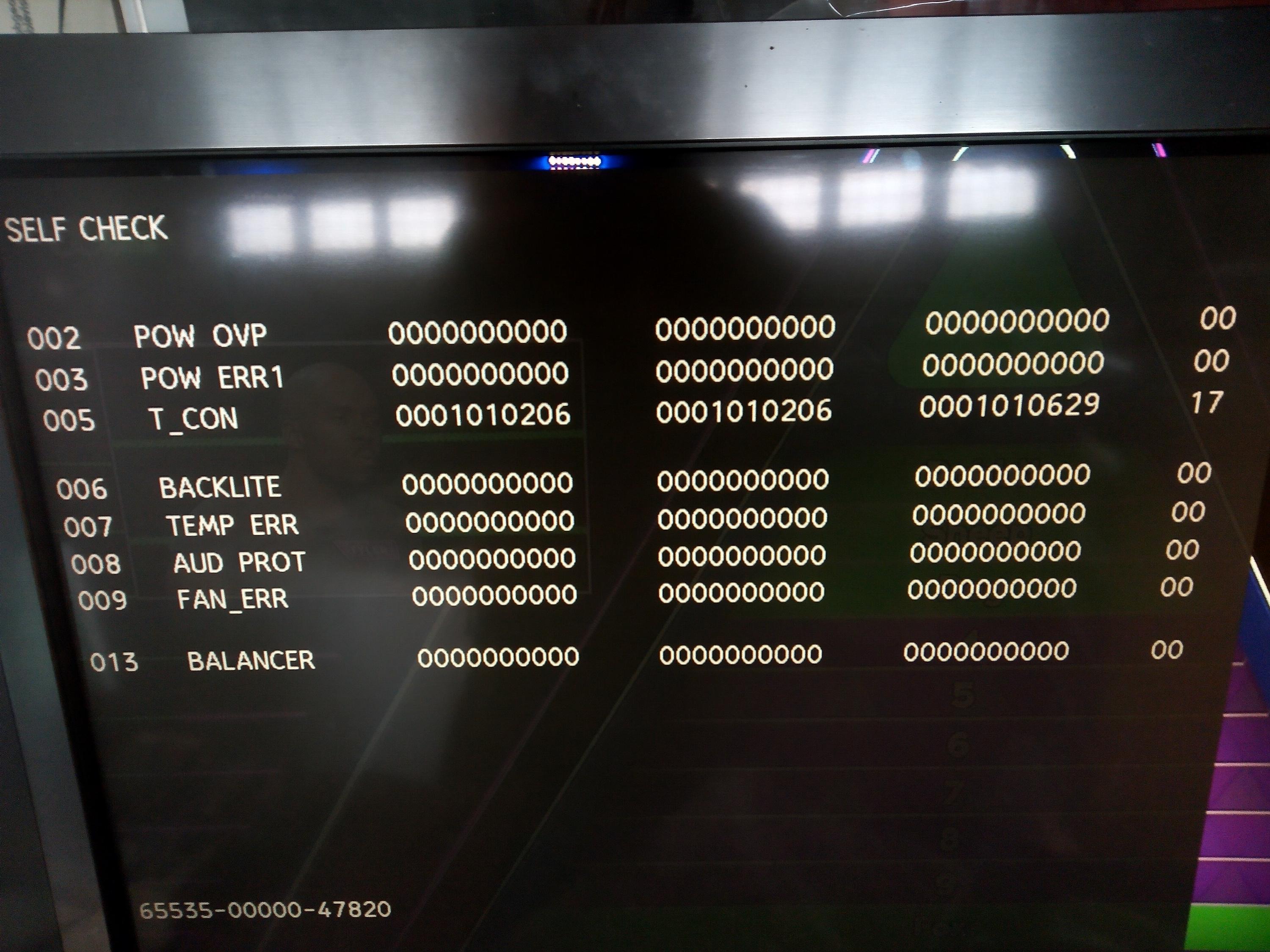

                                heres some pics of tv in diagnostic mode with TEMPORARY link across i/p and o/p of q7403 8 pin device mentioned above
                                pic 4 shows why its worth trying to save it from landfill
                                it still goes off with 5 blinks after a few minutes

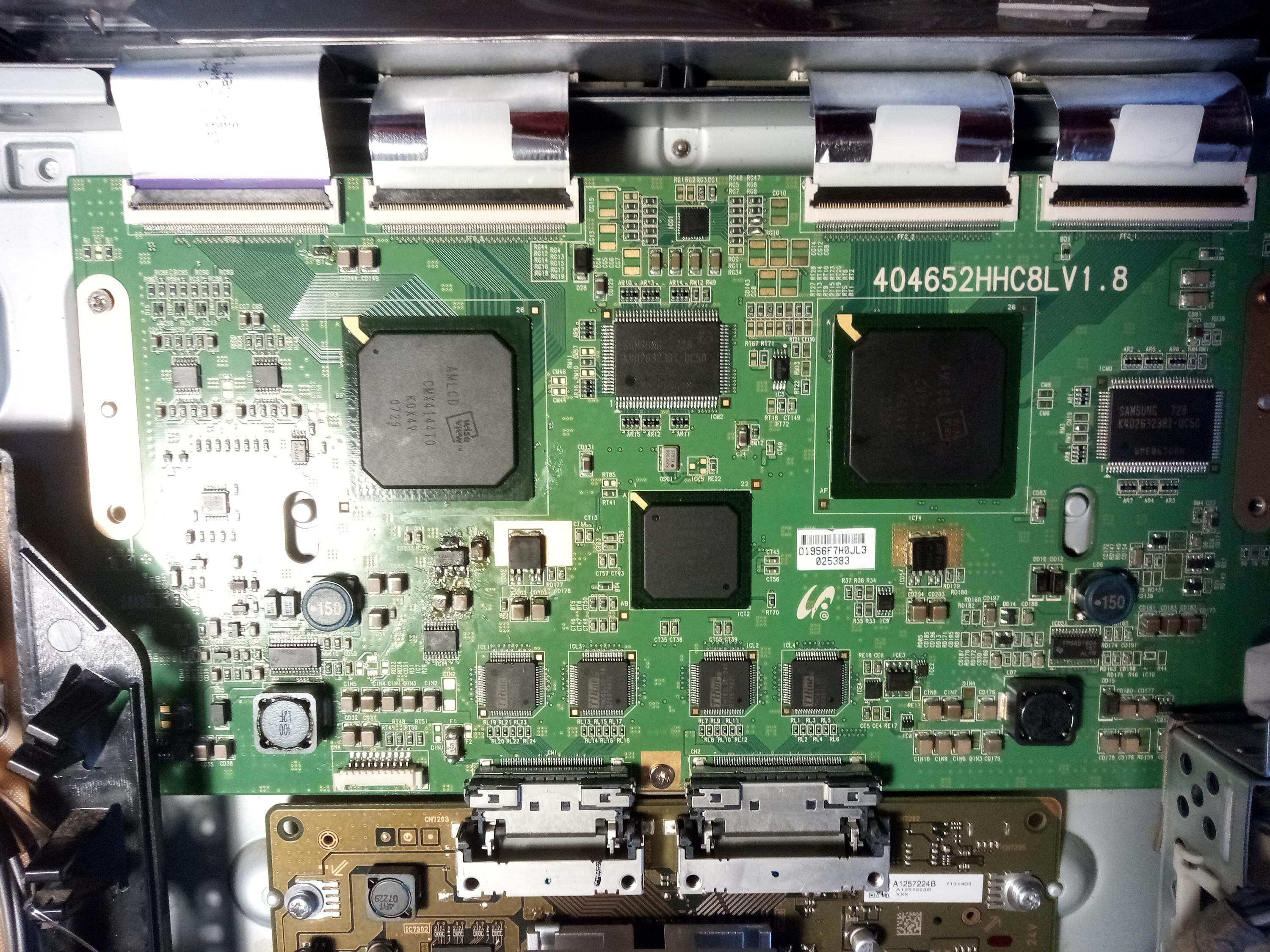

                                  on page 18, did you try :
                                  1- reset ( setting shipping condition ) ?
                                  2- at same page 3-8-5 T_CON error ( point No 1 ) i cant trace it on the manual pdf. as my screen non PC
                                  & let see yours T-CON how its look

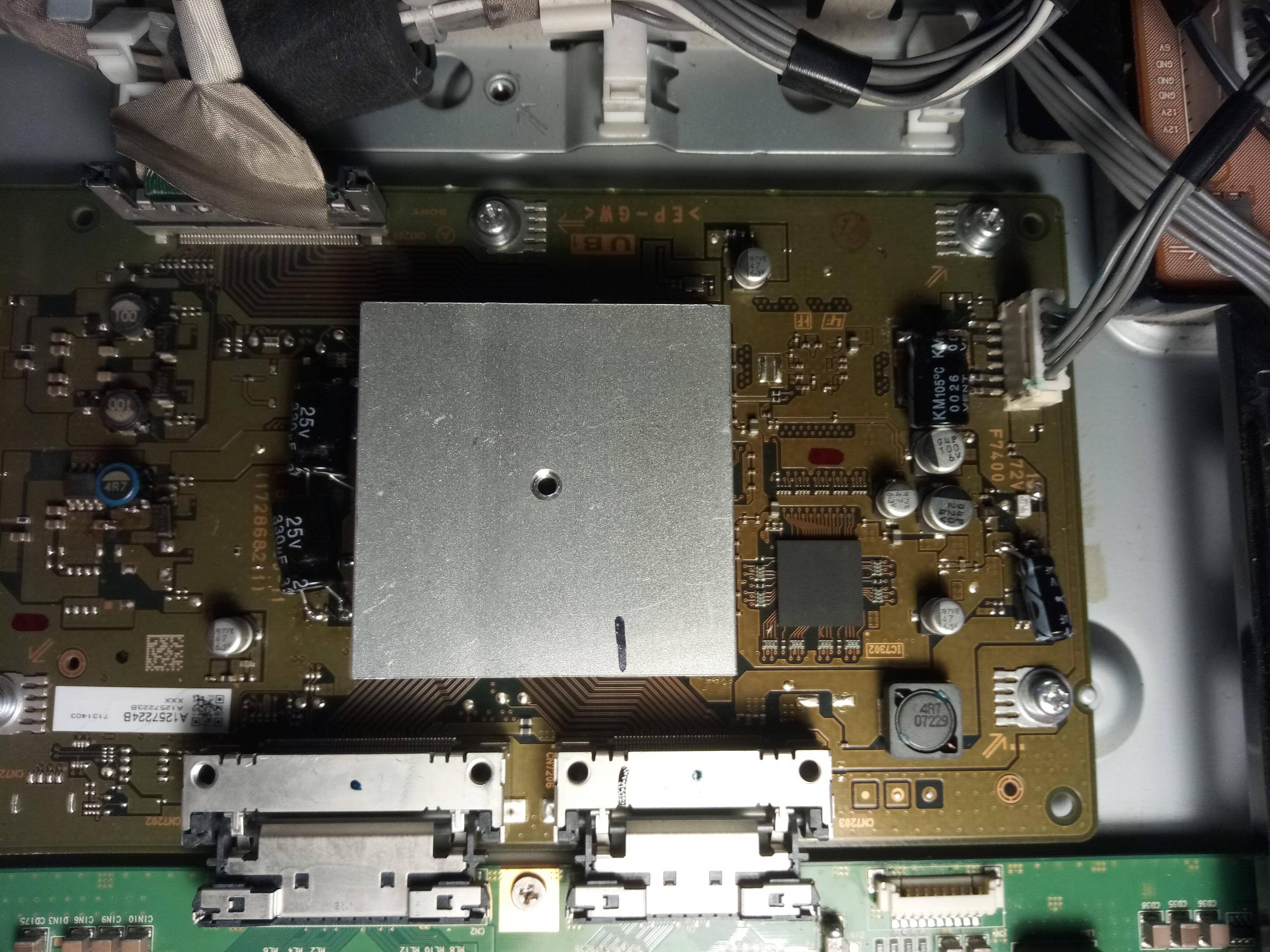

                                  • jimbofz
                                    • Apr 2013
                                    • 539
                                    • uk
                                    #37
                                    Re: firmware for sony KDL40X 3500
                                    1 yes i tried reset shipping condition
                                    2 the advice sony give is :check BE micro pin 128 on fb2 board
                                    replace board
                                    i tried to find correct pin of this ic to see if pin 128 was going high or low when fault occurs
                                    but i couldnt be certain which was pin 128 on this 176 pin ic and didnt want to short out any pins with my mini meter probe

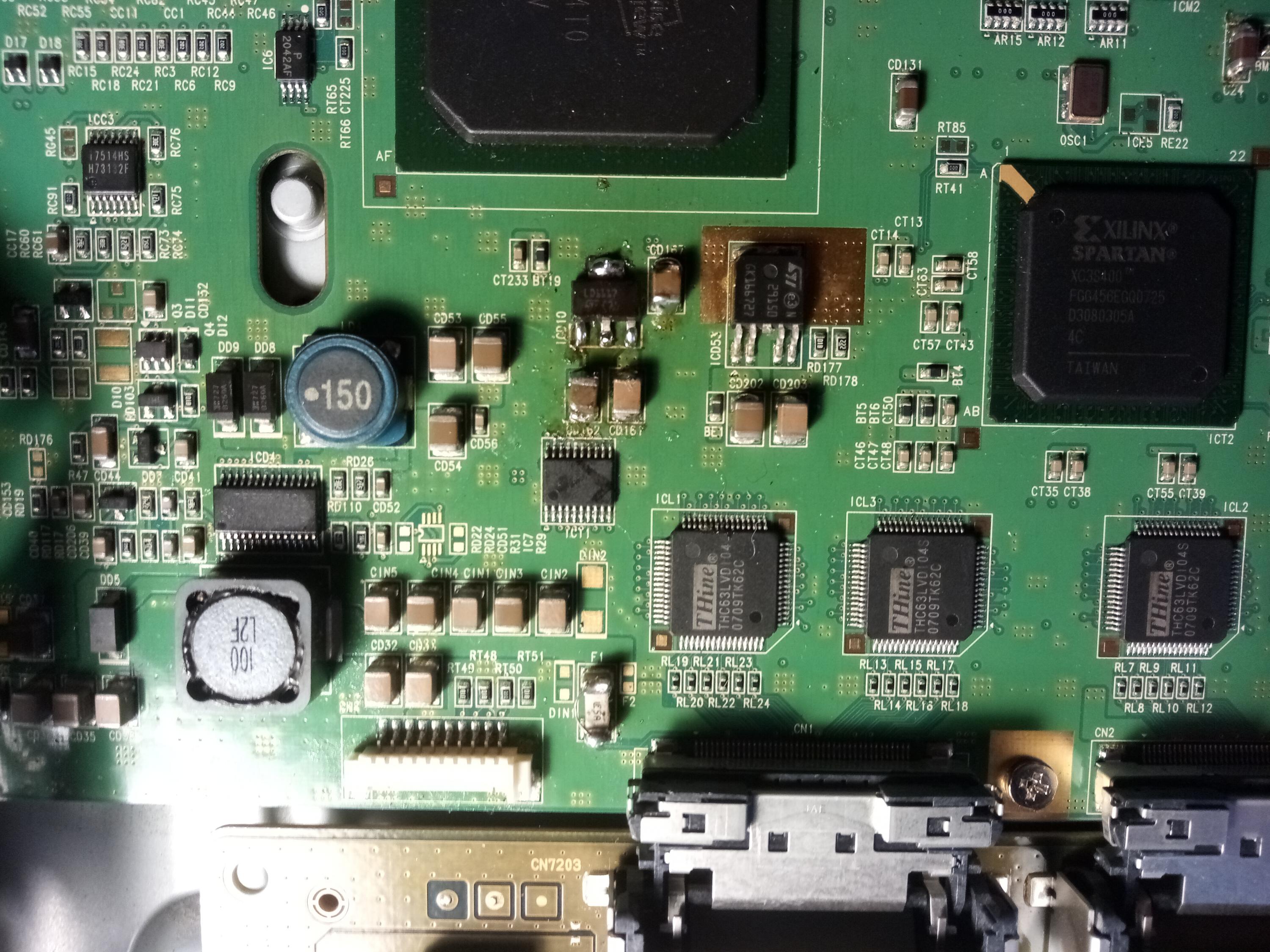

                                    i will post pics of the logic board and the t con
                                    but im now thinking fault is caused by logic board dropping the 12v supply voltage ,as the 12v goes first to logic board then to t con
                                    you will see in pics that i removed 10 amp fuse and fitted 5 amp jumper wire ,.this is only during fault finding and correct fuses will be fitted when i finally sort this fault so dont be alarmed i have new correct fuse ready to fit
                                    • Diah

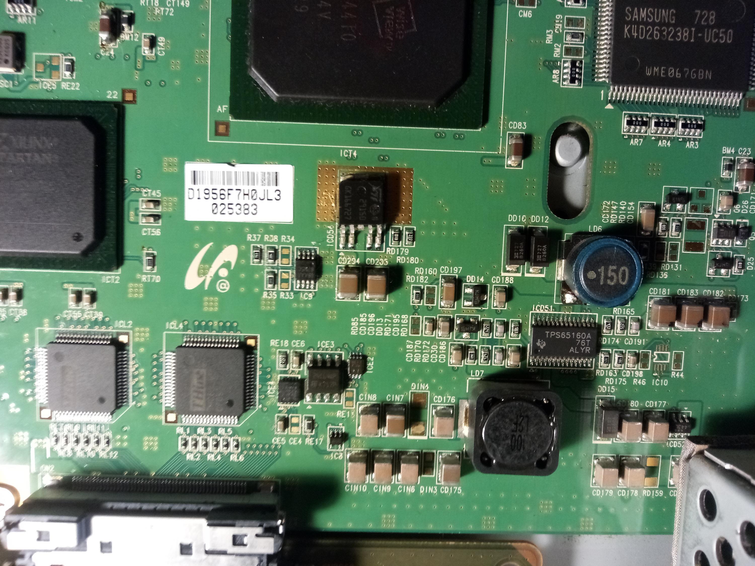

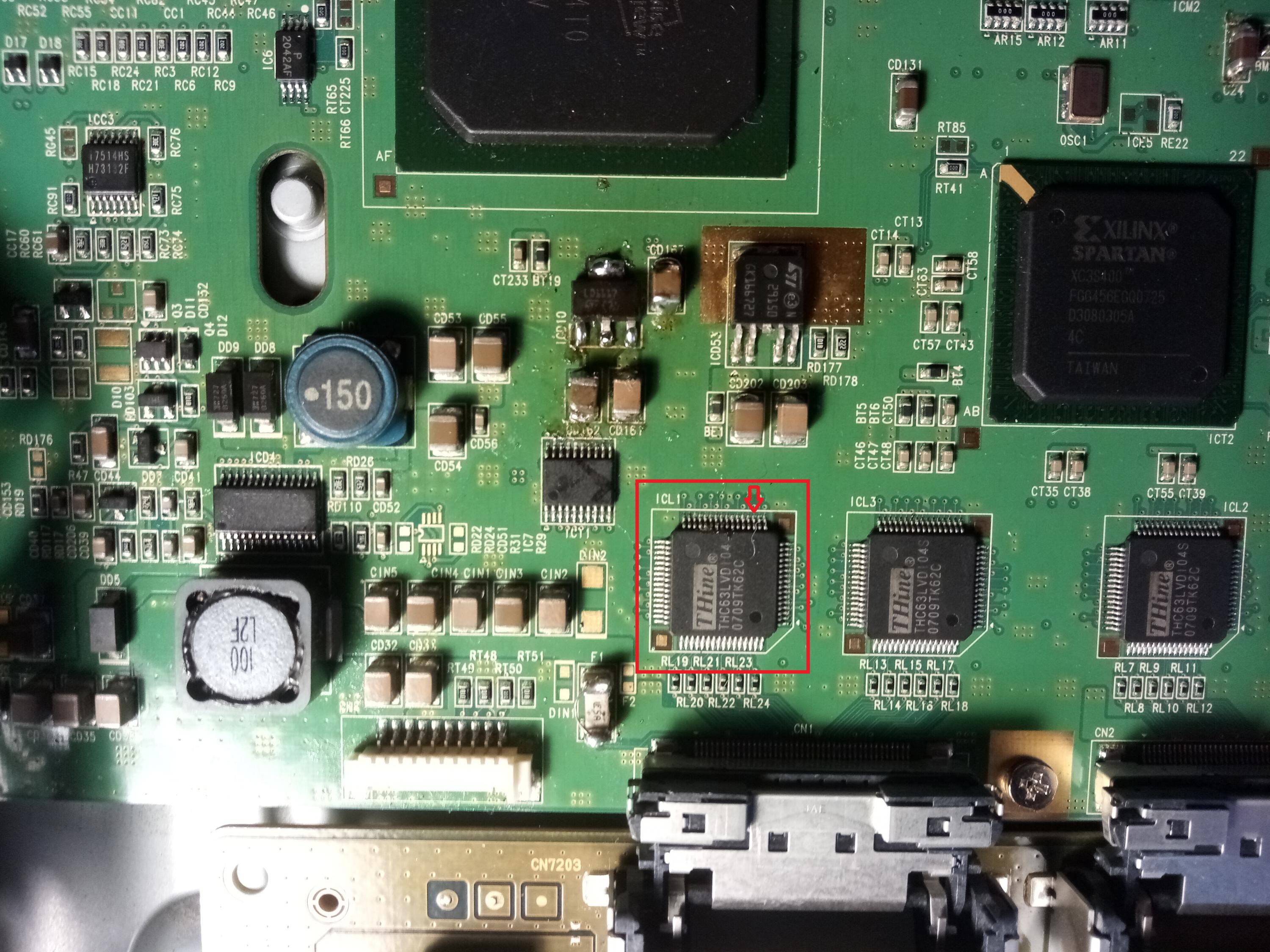

                                      let us clear one things... did you find F1 on T-CON Open before??
                                      • jimbofz
                                        • Apr 2013
                                        • 539
                                        • uk
                                        #39
                                        yes
                                        • Diah
                                          • Feb 2013
                                          • 6435
                                          #40
                                          Originally posted by jimbofz
                                          yes
                                          check this IC short you have on 2 pin as the photo remarked.
