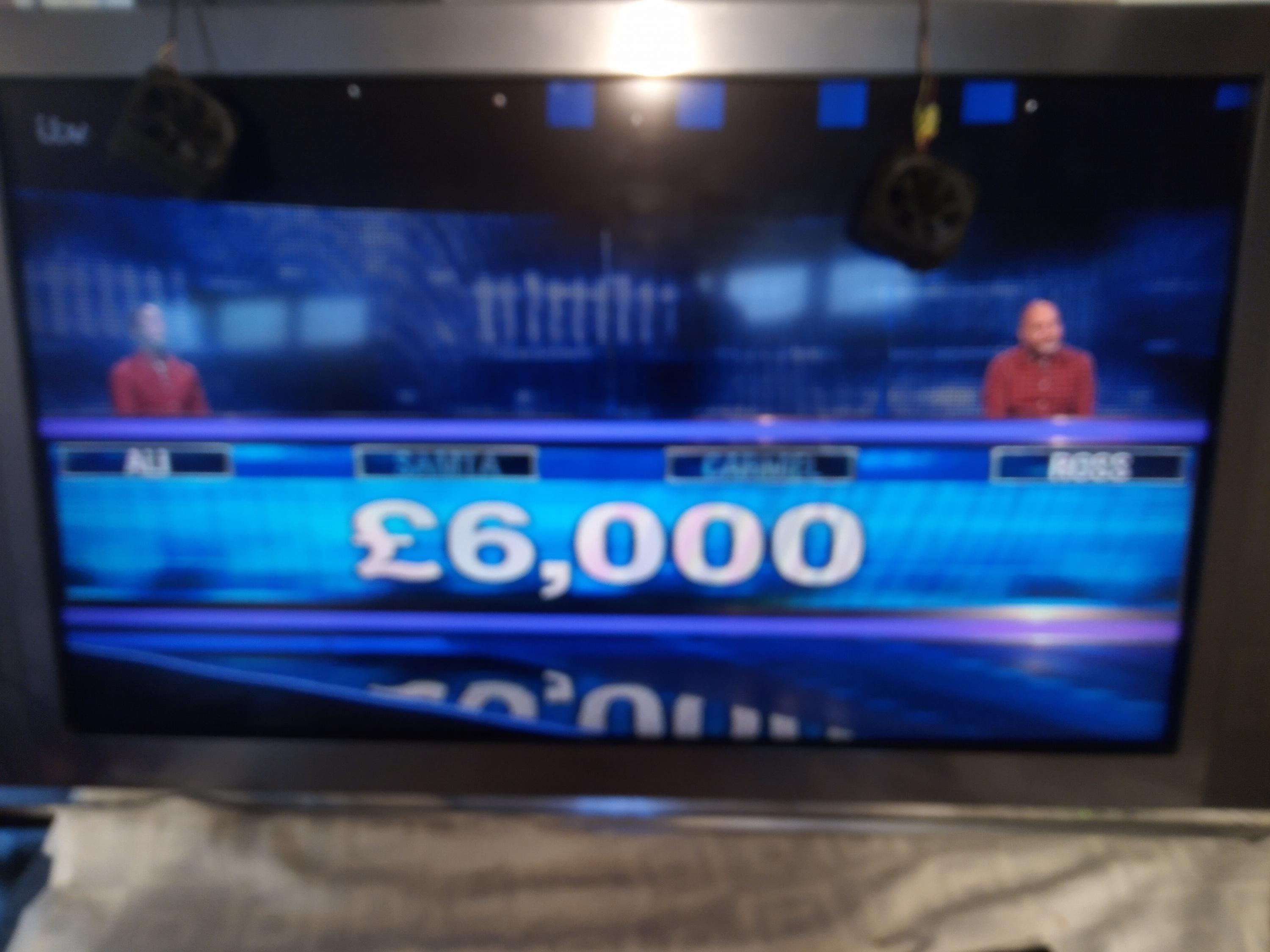

                                  • jimbofz
                                    • Apr 2013
                                    • 539
                                    • uk
                                    Re: firmware for sony KDL40X 3500
                                    Originally posted by Diah
                                    1- set with out Fan connected will not work
                                    2- yours way of testing sorry to say wrong... no need to heat or any other... you have spins issue.. you need to Oil the shift of the original.. see if the shift fits exactly and there no play move on sides . put pc fan and switch on.. your set will working.
                                    thanks ,i cleaned and oiled the original fans , same fault
                                    i removed them
                                    and replaced them with some from an old hitachi plasma
                                    same 12v ,3 lead type but just bigger in size.
                                    .same fault see pic (.i left them hanging over the top )
                                    the pic is blurred because i dont have enough time for camera to focus before tv goes off to 5 blinks
                                    during testing i use scart i/p as this usually means tv will auto select scart and i always get sound
