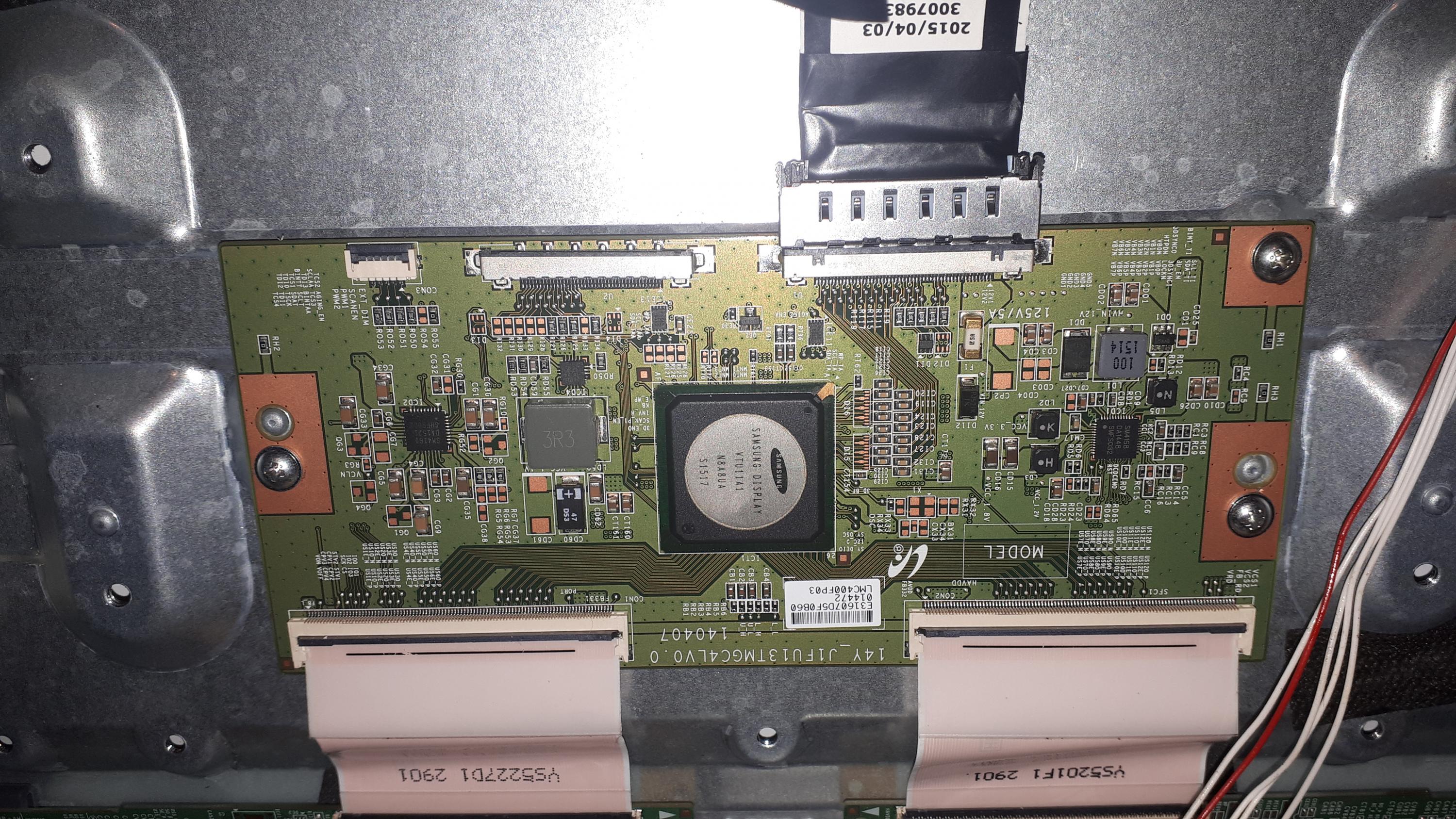

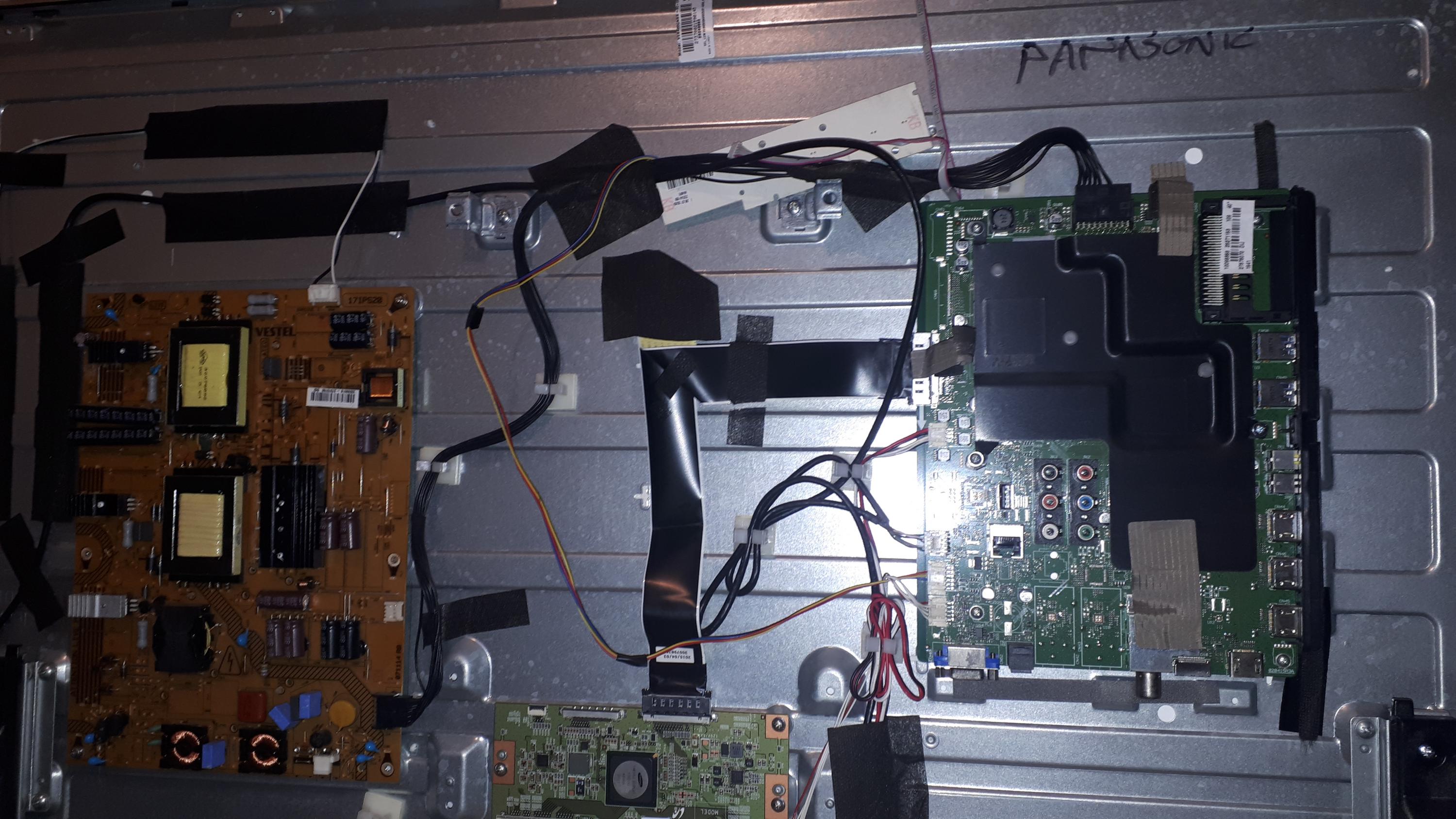

    Any photo's of your boards. The power supply is 17IPS20-R?
    • Chrissygizmo
      • Mar 2021
      • 108
      • United Kingdom
      Re: Panasonic TX-40CX400B backlight problem
      I have got these ones on my phone , if you need better ones let me know . Thank you
      • Chrissygizmo
        • Mar 2021
        • 108
        • United Kingdom

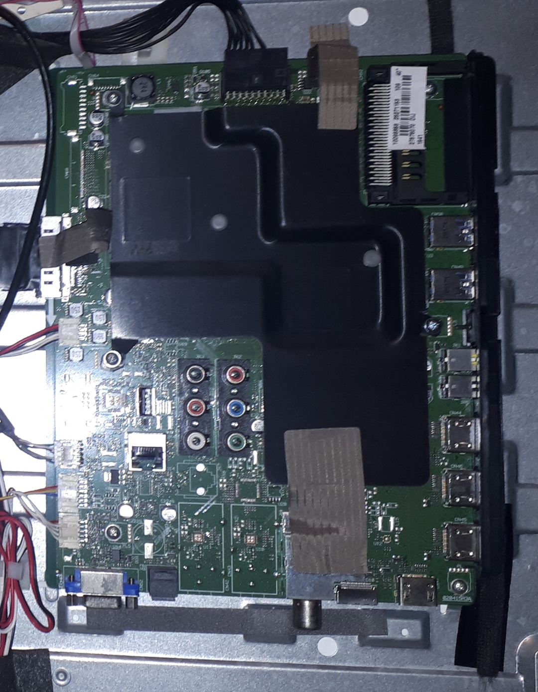

        I don't know if these photos are good enough, I will get better ones if your needing close ups etc . Thank

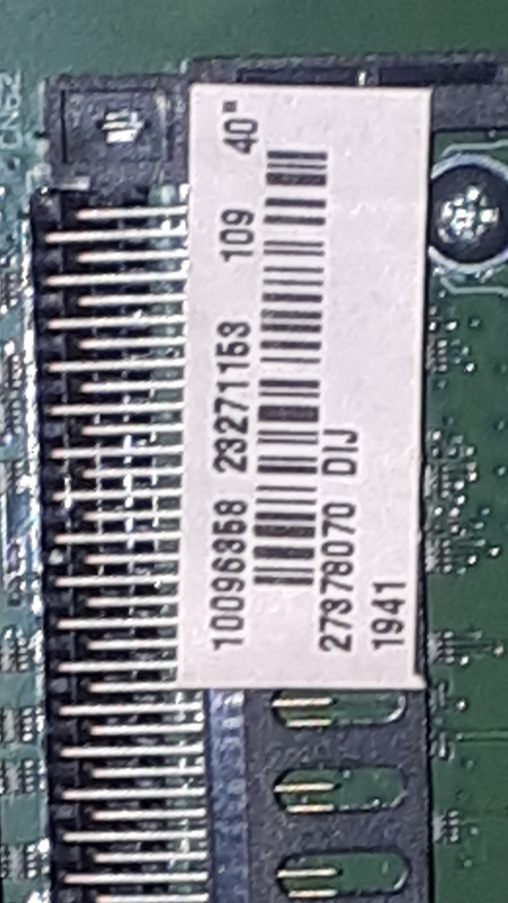

          Whats the number in the red box? It looks like ending R9?

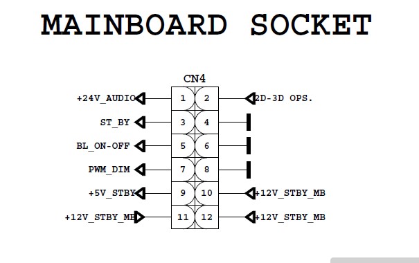

          Can you give the voltages on the black connector that takes the power drom the power supply to the mainboard

            With the set powered off remove the mainbpard from the power supply and connect +5V_STBY to ST_BY using a 1K resistor and also +5V_STBY to BL_ON-OFF using a second 1K resistor then switch on.
            If the backlights remain on then it would appear to be a mainboard fault. If they fail then you most probably have a led(s) or led connection problem.

              Hi , sorry about the delay in replying, i really appreciate your help, I've looked at the photos I've uploaded and I can't see the red box you mean? I'm going to have another look at this tv soon so I will post clearer close ups later on tonight. I will also give what you mentioned a try and let you know the outcome.

                Just realised your picture with the red box DUH ! I will get back to you
                  Looks like R9 to me
