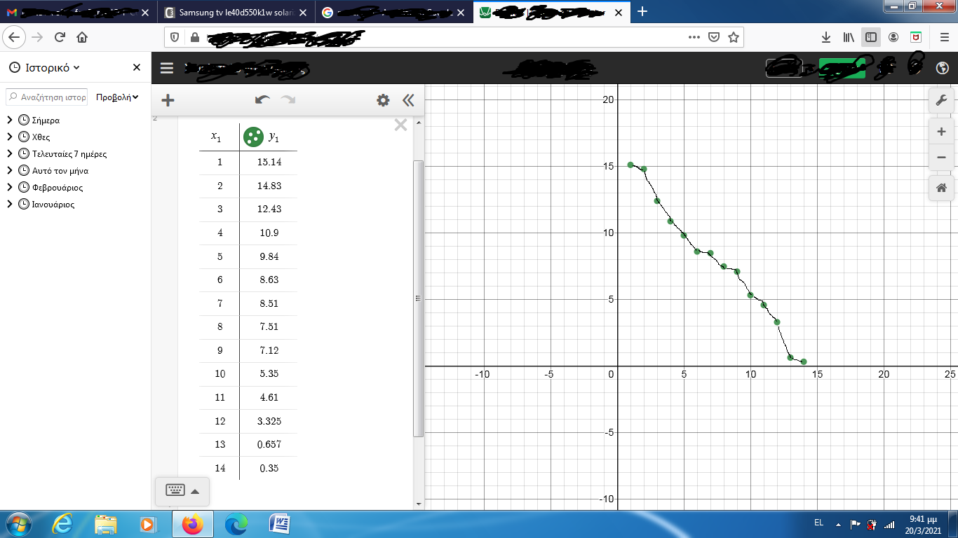

    I finally measured the trends to draw a conclusion about the Gamma, I believe that the measurements are good, I would just like someone experienced to confirm it
    I have a doubt about Vcom on my Tcon board 31T09 -Col T315HW04 VB part number 5540T04C12 I did not find a VCom point only VGNDE and I measured it in terms of ground (chassis of the TV) 0volt but if this point is the same as the potential of the earth it seems logical but I can not to understand how else VCOM can be mentioned.
    The other trends I have always measured in relation to the chassis
    of the TV are
    VGH 28VOLT
    VGL -6VOLT
    AVDD 15.84VOLT
    VG1 15.14VOLT
    VG2 14.83VOLT
    VG3 12.43VOLT
    VG4 10.9 VOLT
    VG5 9.84 VOLT
    VG6 8.63 VOLT
    VG7 8.51 VOLT
    VG8 7.51VOLT
    VG9 7.12VOLT
    VG10 5.35VOLT
    VG11 4.61VOLT
    VG12 3.325VOLT
    VG13 0.657VOLT
    VG14 0.35VOLT
    in addition the complete one that is responsible for Gamma was relatively cold in no case did it heat up
    What do you think of ordering a new Tcon?

      Re: Samsung tv le40d550k1w solarized problem
      The gamma voltages are off. VG6-VG9 and VG13.
          How so? I don't see a problem with the gammas.
            Really ? I was confused now the only trend I could not find was Vcom I measured one that said Vgnde which I thought was this
            As for Gamma now after two different points of view I am in a dilemma because I find my own part number only from America and it will cost a lot so I wanted to be sure
            What do you suggest I do?
              this is the graph of gamma in relation to the trend does not seem to me and so linear do you agree that you are more experienced? or
              does it seem normal to you?
                Looks fine to me, if there's a problem I don't see it.
                  thank you sir for your opinion but if you are right then unfortunately it is the panel
                  I have changed mainboard as I mentioned above I have cleaned and reinstalled cables I have done factory reset firmware upgrade I hoped it was Tcon board
                  But as it seems from the measurements, it is probably Panel if you are right and not Mr. Diif, so the repair is not worth it
                    It's supposed to be a straight line between the first and last point. It clearly isn't.
