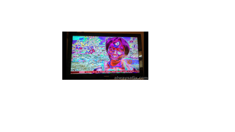

    Hi to all
    I have the above TV and it shows distorted colors.
    I searched on the internet and it seems to have the so-called solarized problem.
    I am sending you a photo i borrowed
    my TV has a similar picture with green and purple more instead of the red of the picture
    I had also seen a video that someone from the servise mode tried to change the DDR from LINE TO SAMSUNG and a similar problem was fixed with mine but my own TV entered the service mode and I did not have such an option
    thanks

    Re: Samsung tv le40d550k1w solarized problem
    possible wrong lvds setting in service menu has this tv been worked on and had replacement boards fitted?
    This video shows the fault caused by it https://www.youtube.com/watch?v=_FtFxe6h8Jk

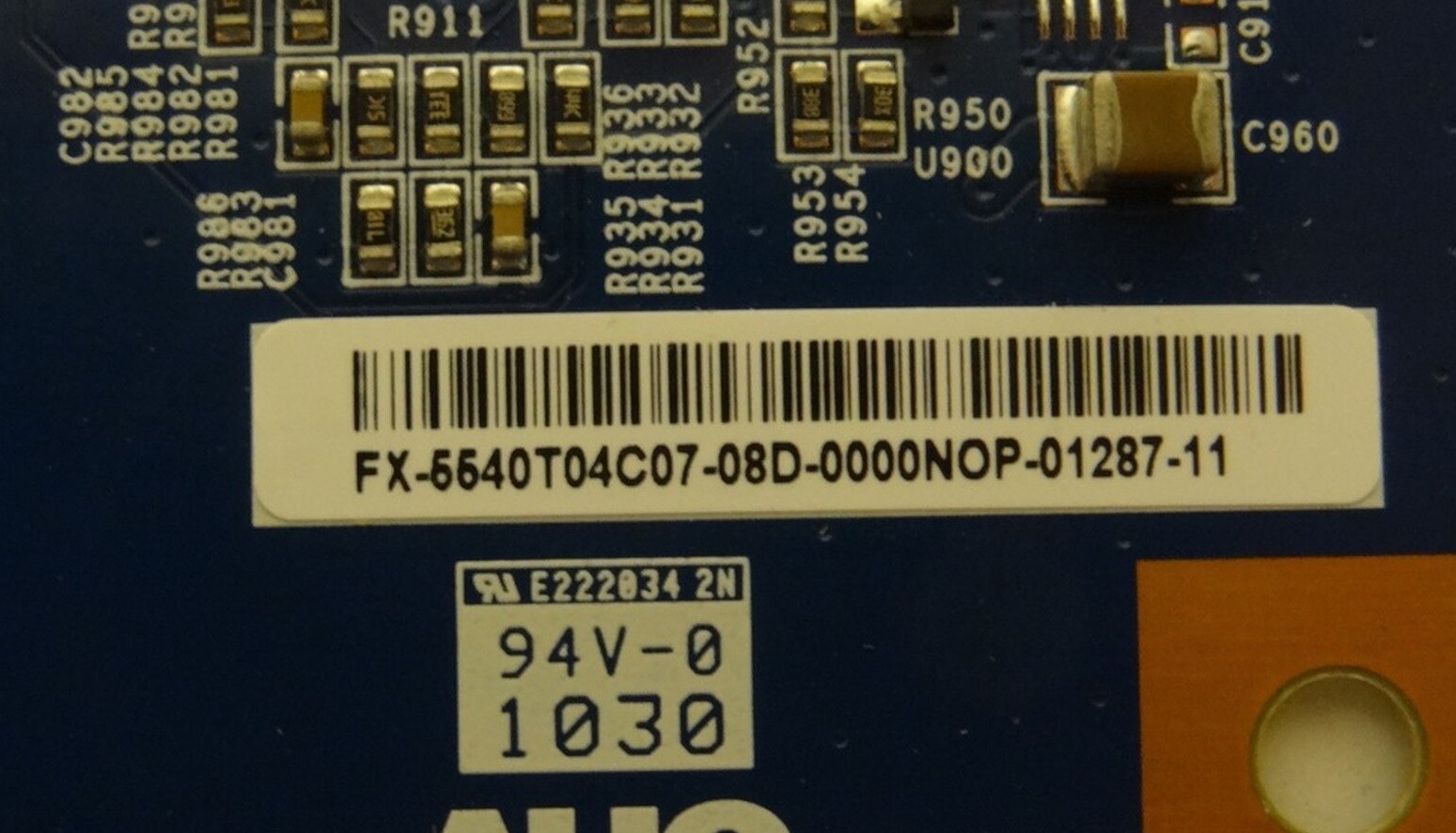

                                    • William1967
                                      • Nov 2017
                                      • 214
                                      • Netherlands
                                      Check the white label on the t-con , there is a bar code but also a number starting with 2 letters followed by 5540CxxTxx, that is the number you need.
                                      See example.
