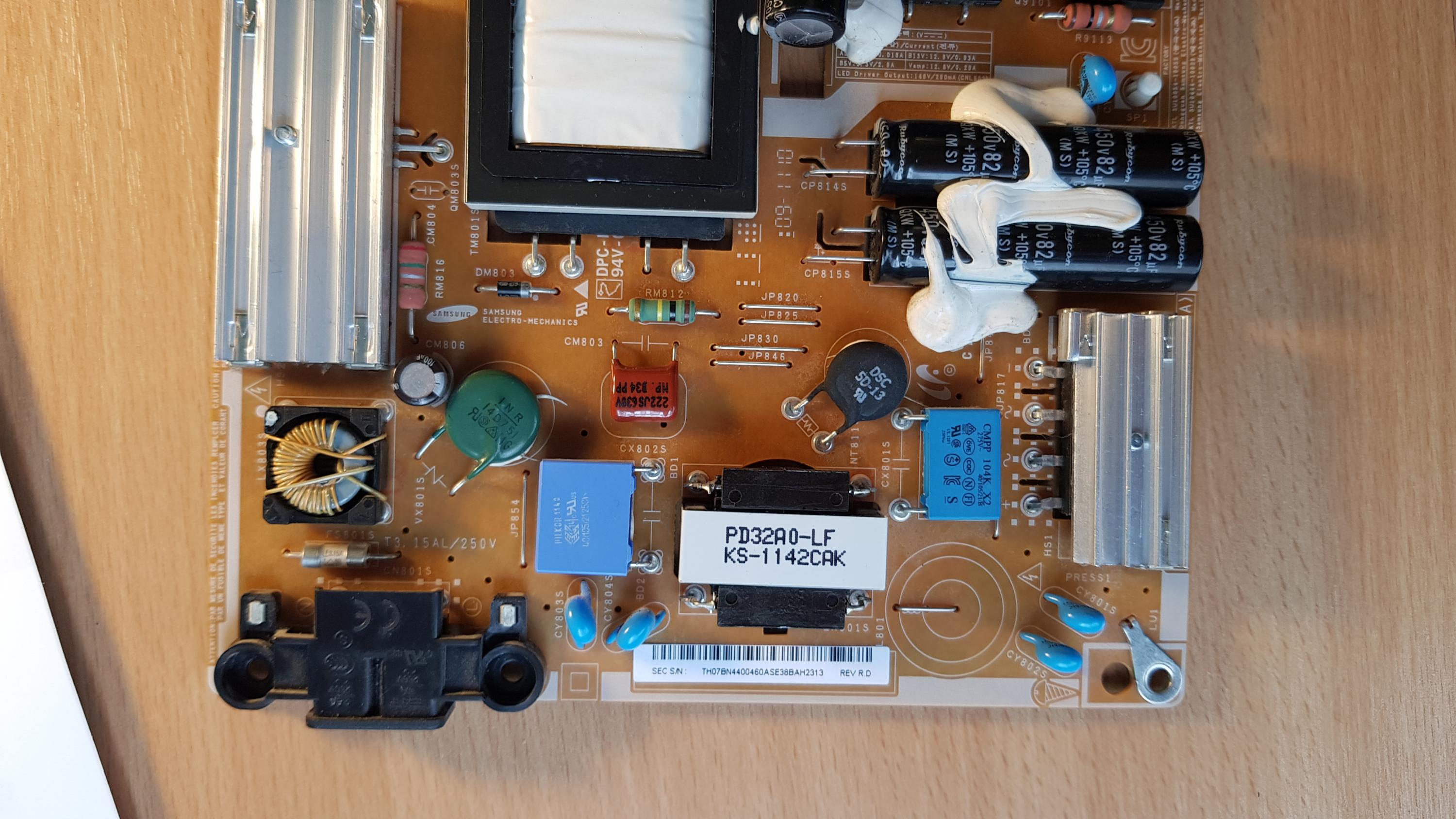

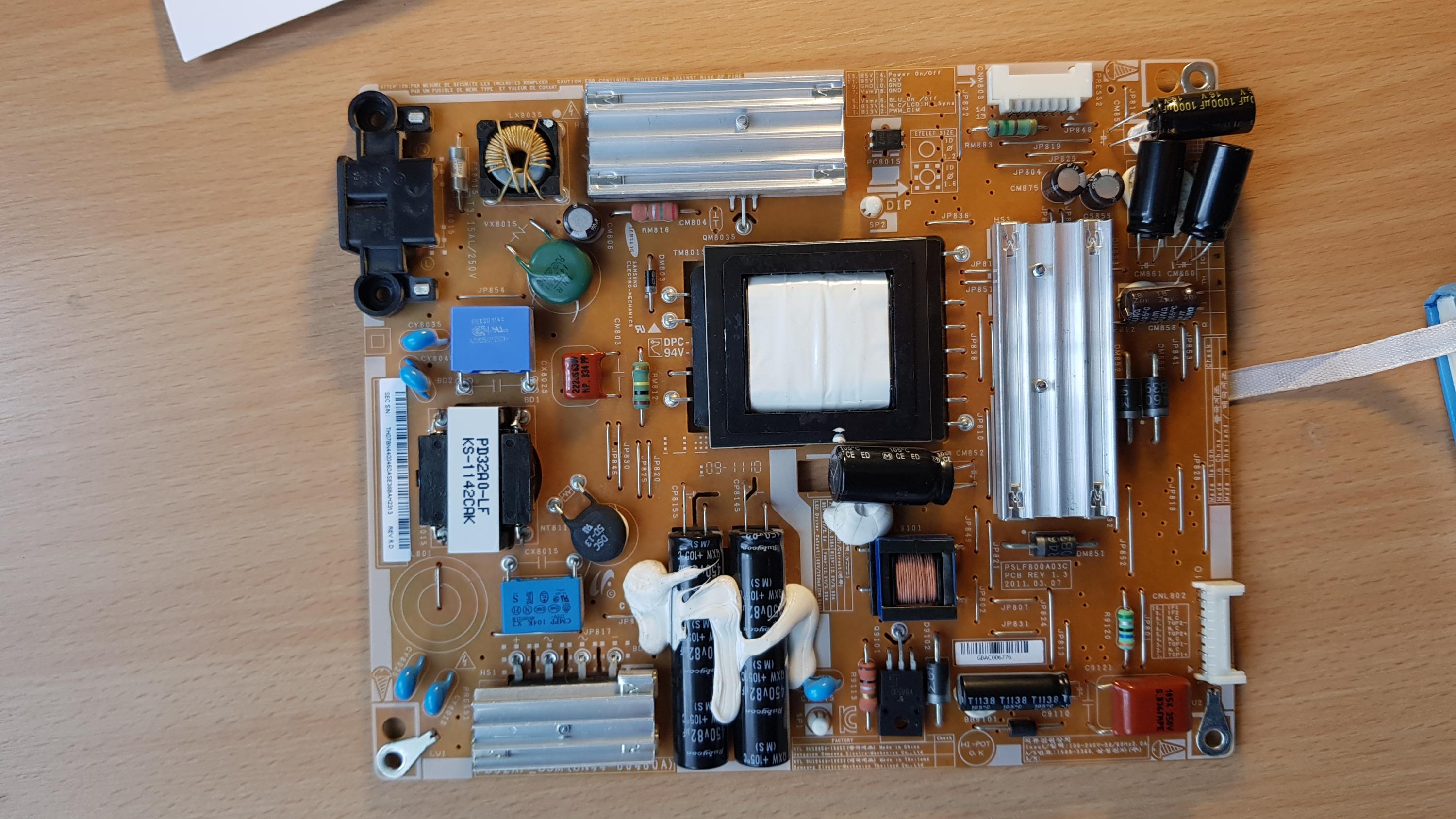

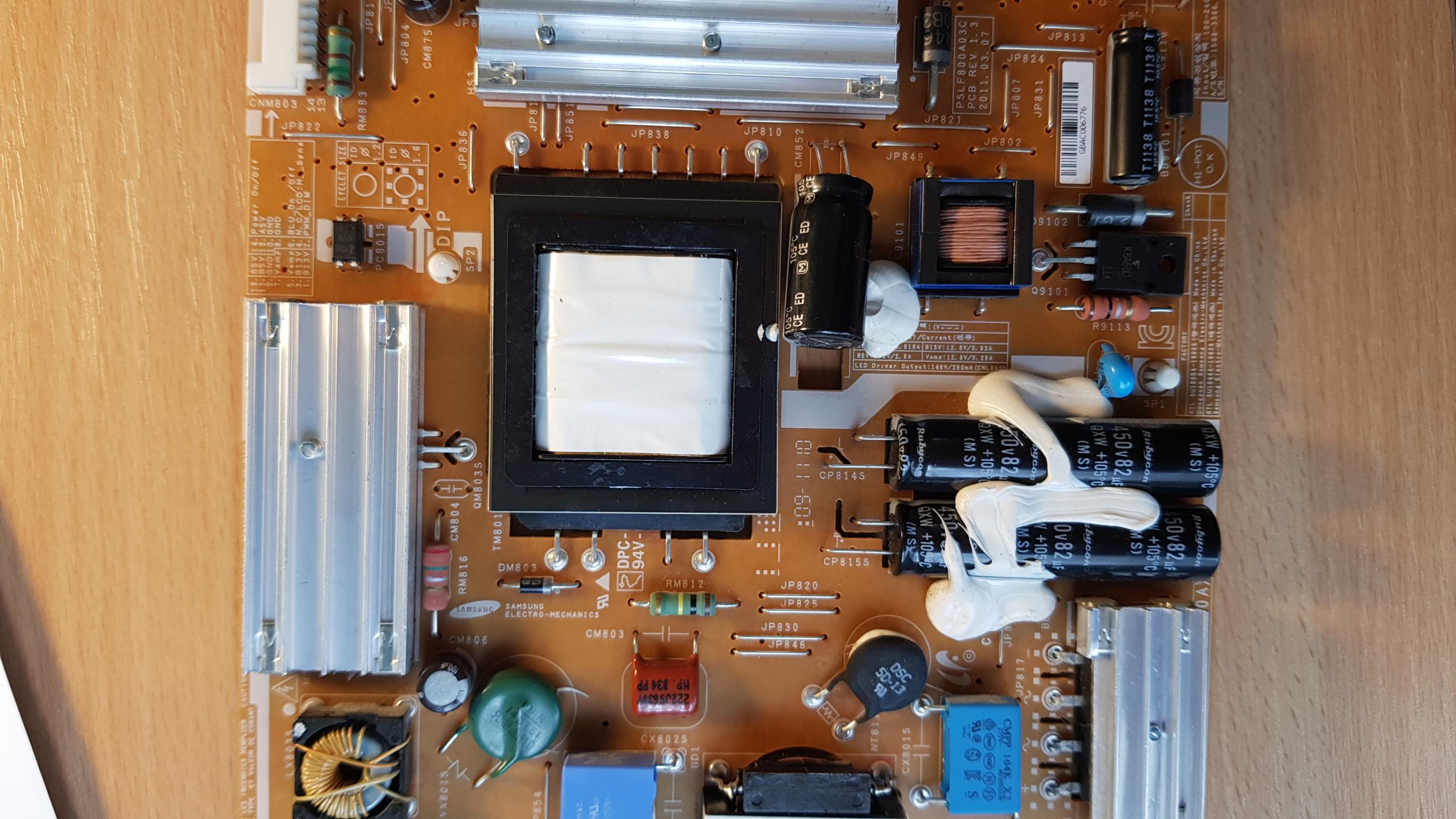

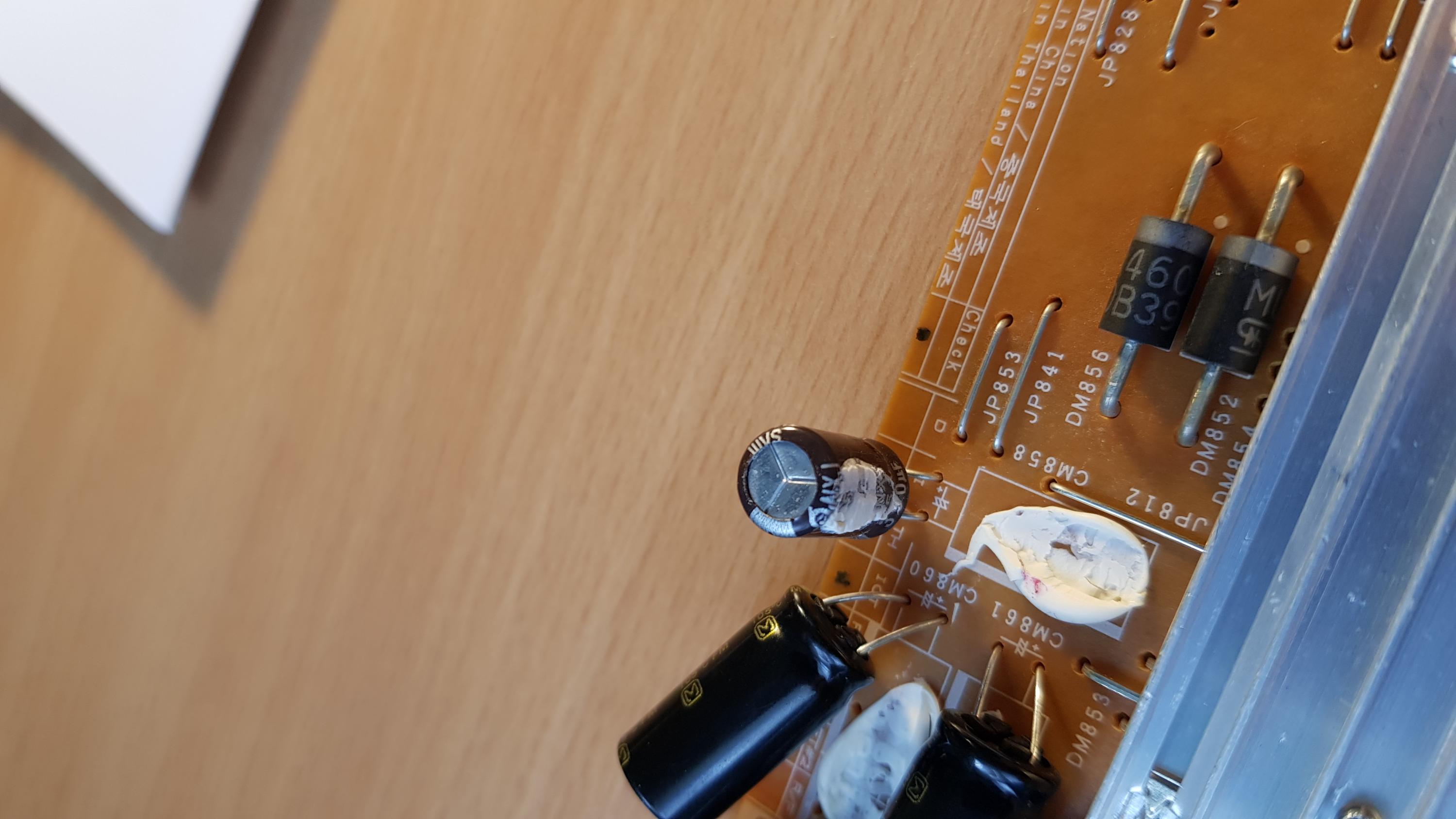

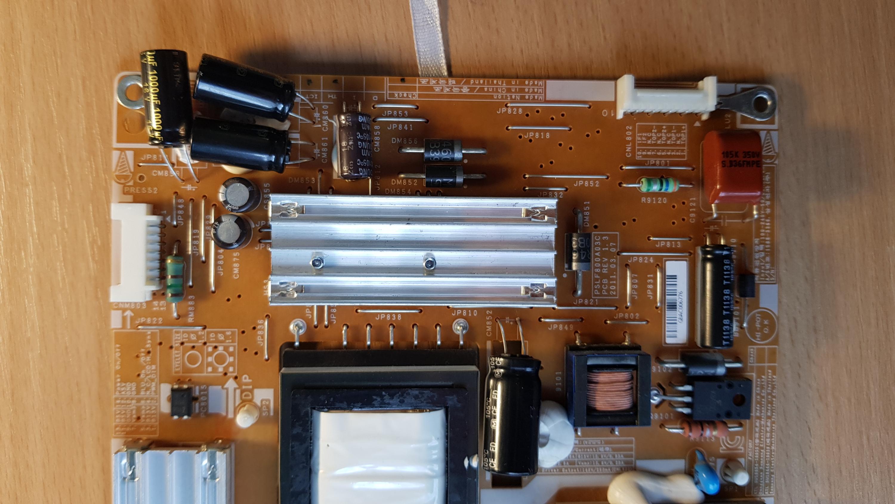

    I'm having an issue with my son's Samsung UE32D5520. The television will turn on and off within 3-5 seconds. The screen starts, I get the Samsung logo, then it goes black and off. I have replaced 3 capacitors (2 x 16V 1000uF and 1 x 200V 68uF) on the power board (BN44-04660A) as a shot in the dark after reading some information online.

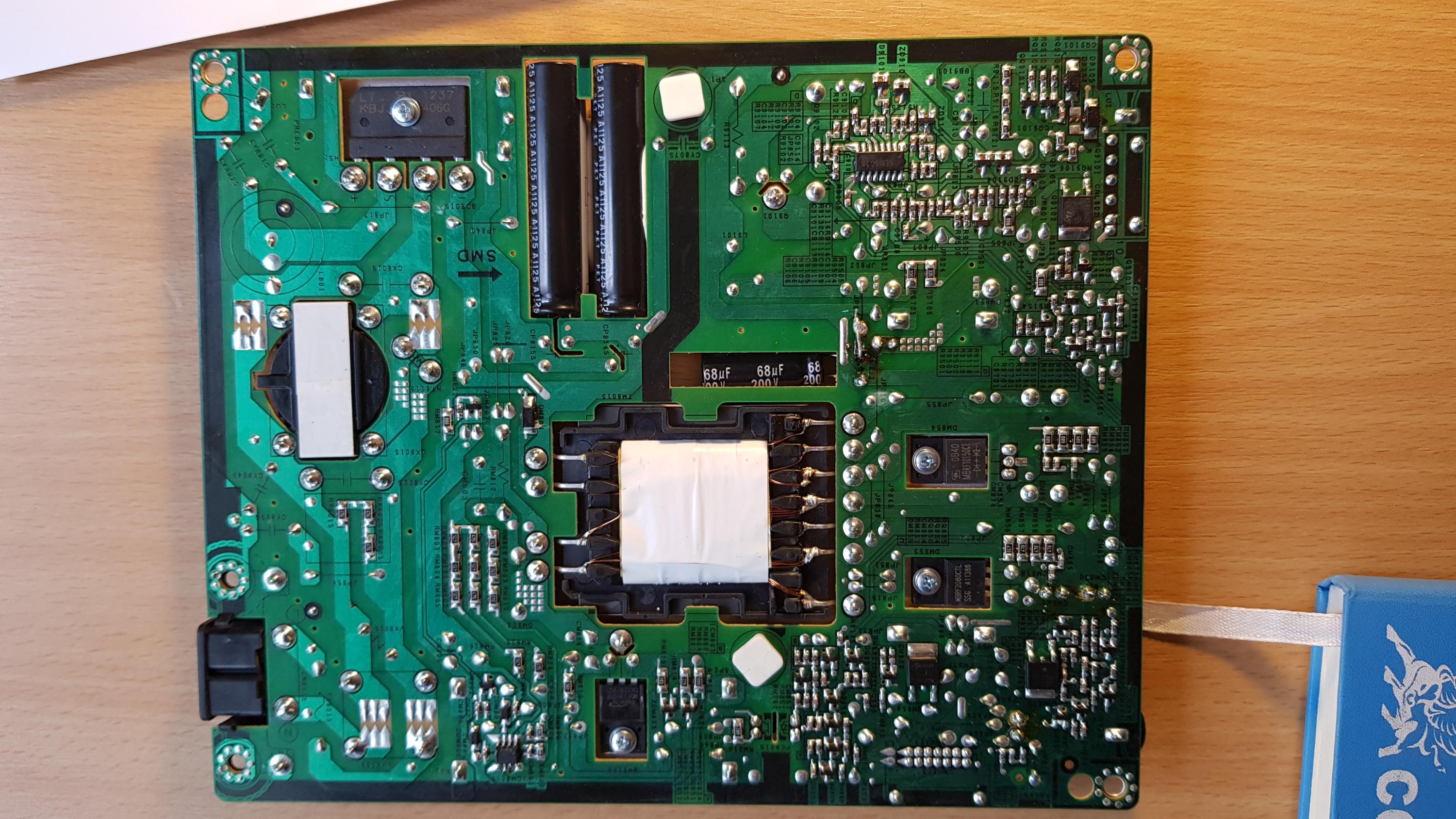

    From opening up the television and inspecting the power board there is a humming/buzzing noise coming from the board although it's difficult to pinpoint exactly where this is coming from.

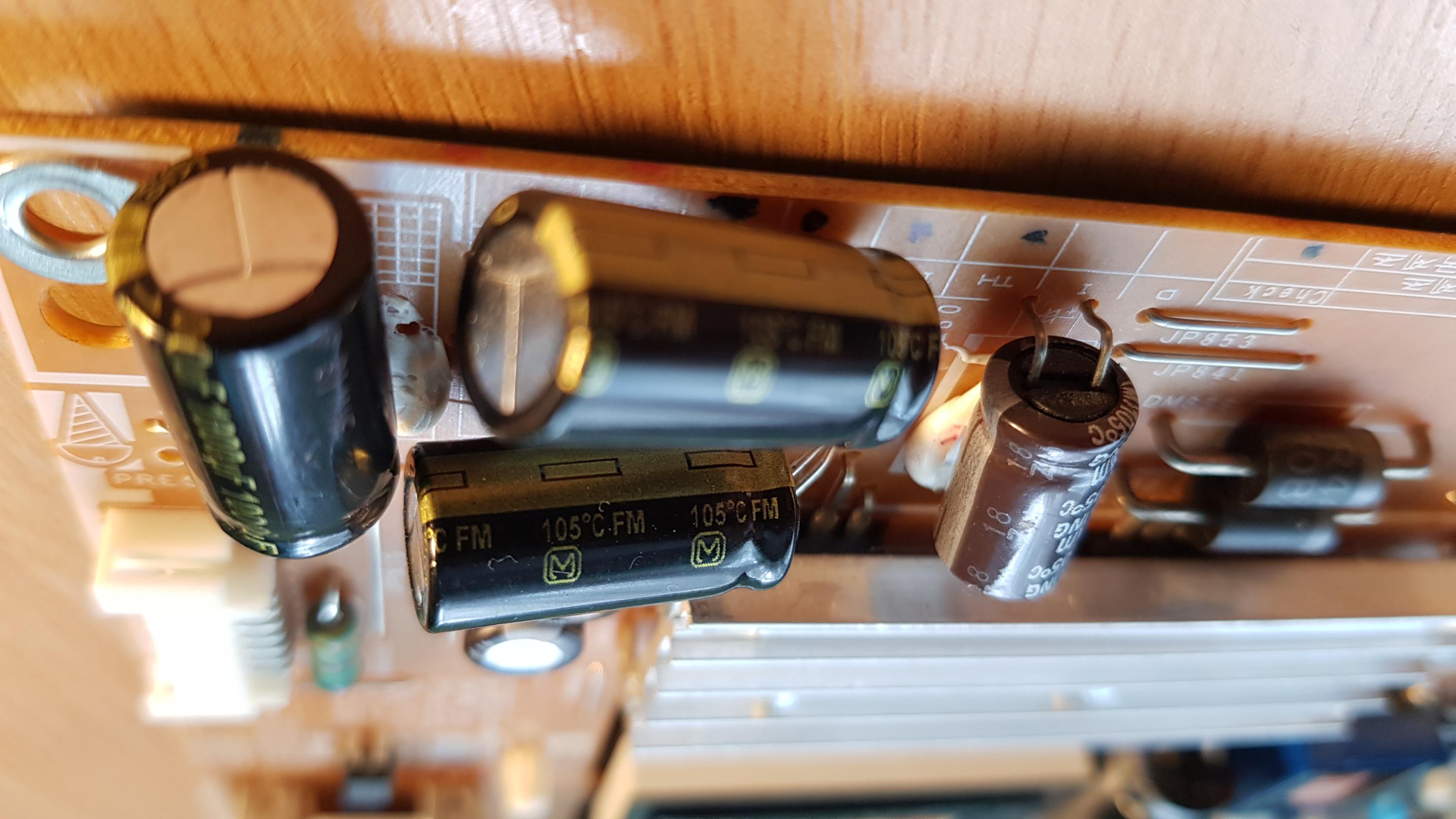

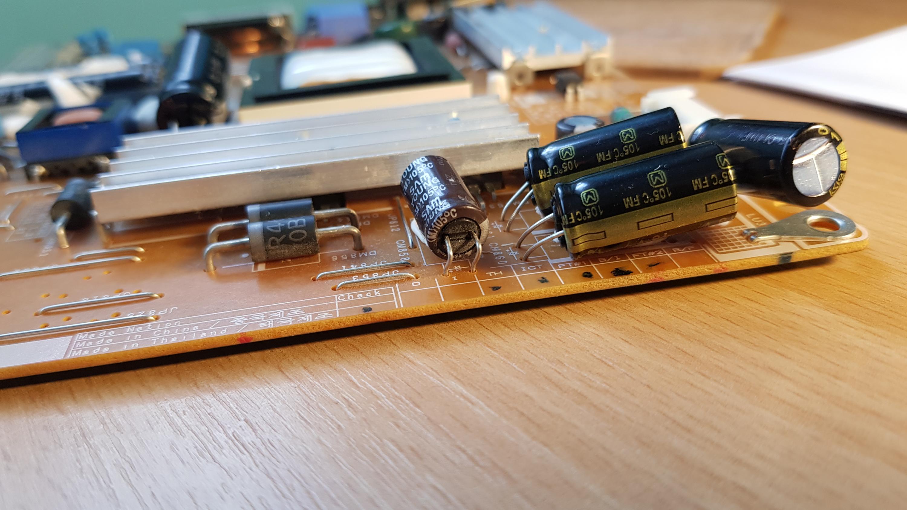

    I enclose pictures of the board below and excuse the slight burn mark on the reverse of the board which happened when I was replacing one of the capacitors
    Any tips or suggestions or am I better off just buying a replacement PSU or a new TV?

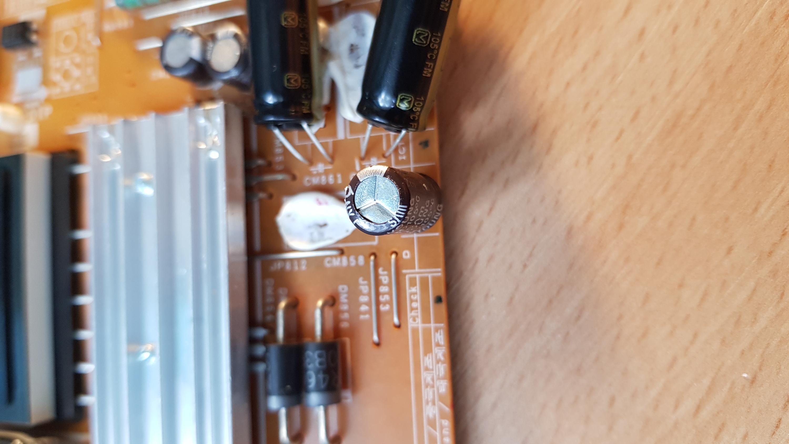

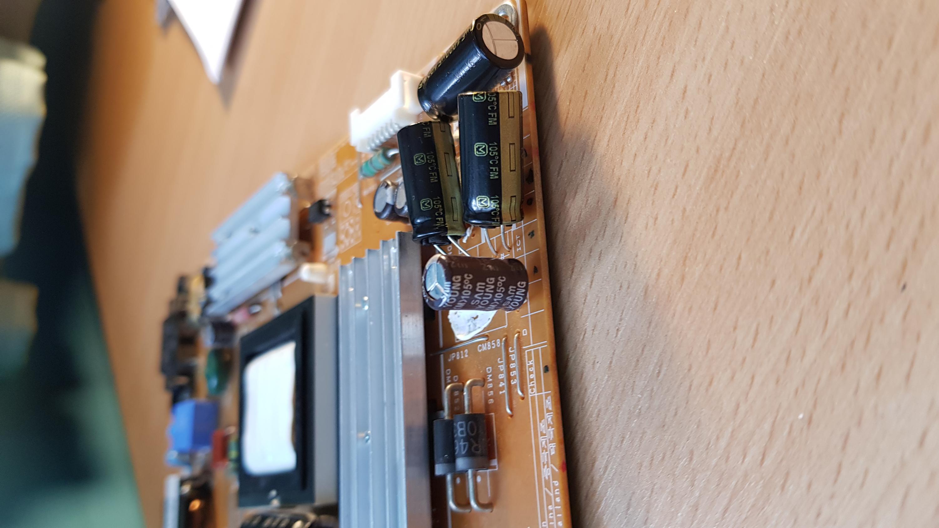

    Re: Issue with Samsung UE32D5520 turning on and off
    Is CM858 also showing signs of bowing on top?
    If you disconnect the power supply from the mainboard and power up do the backlights come on and stay on?
    Is the 68uF 200V capacitor connected securely to the other components on that track? One leg looks as though it needs to be soldered again.
    You can clean the flux away with alcohol or I believe nail varnish remover if nothing else at hand. No pun intended.

      Just a bit more information.
      When the main board is connected to the power board I can hear a buzzing/humming noise until the TV turns off. When the main board is disconnected, the backlight stays on and there is no humming/buzzing noise.

        Thanks for the response Dick.
        In relation to the 68uF 200V that you highlighted, that was one of the capacitors that I replaced in my attempt to correct the issue. I will clean it out and re-solder again as suggested.
        In relation to CM858, it looks ok to me except for the top of the capacitor is slightly indented on one side. I have attached photos of the capacitor below.
          Another image with the indent highlighted in red as it is difficult to see in the photos.

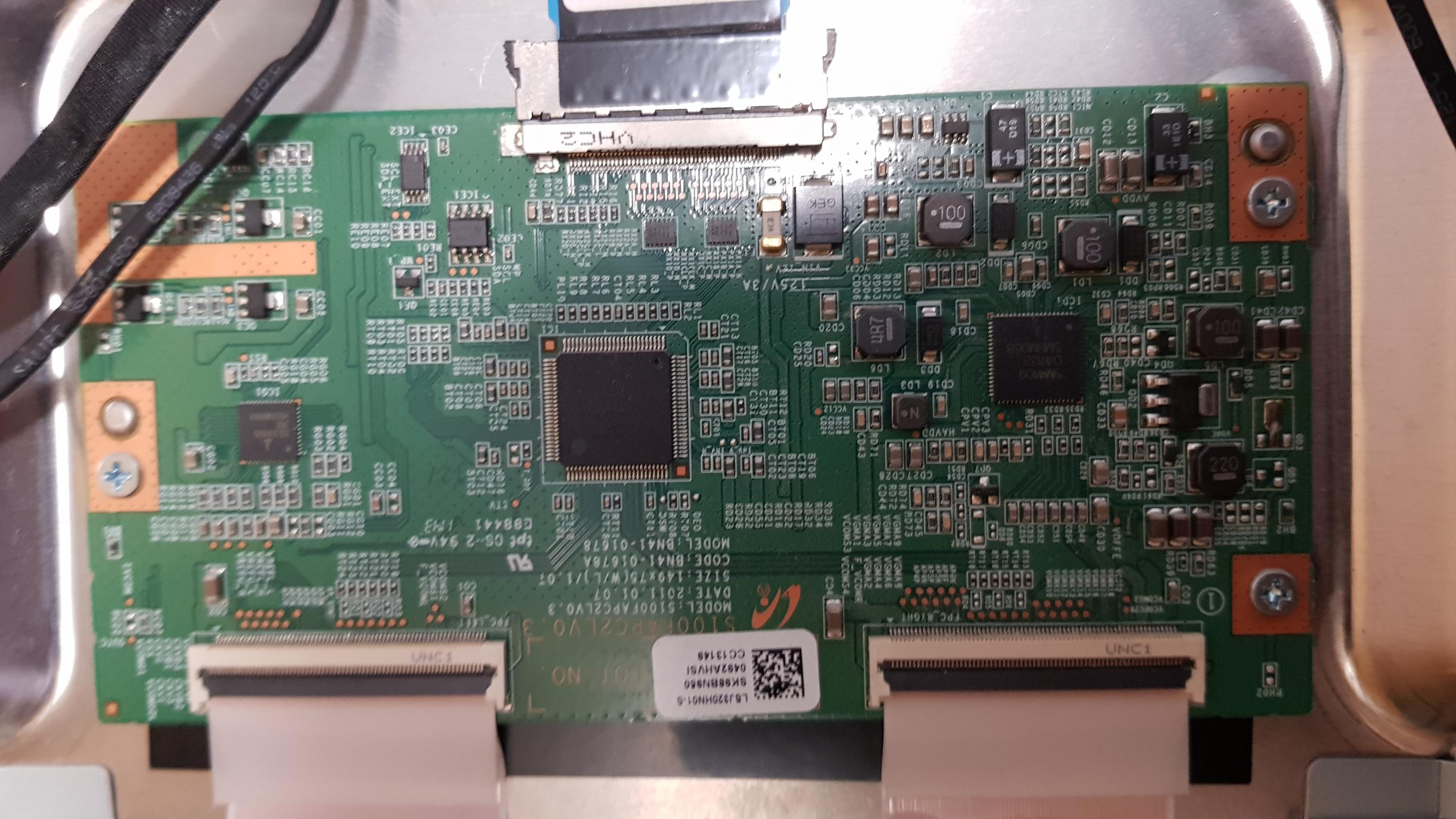

              Check the lights on your tcon board if you have a stand alone one, I bet they go on and off with the picture too.

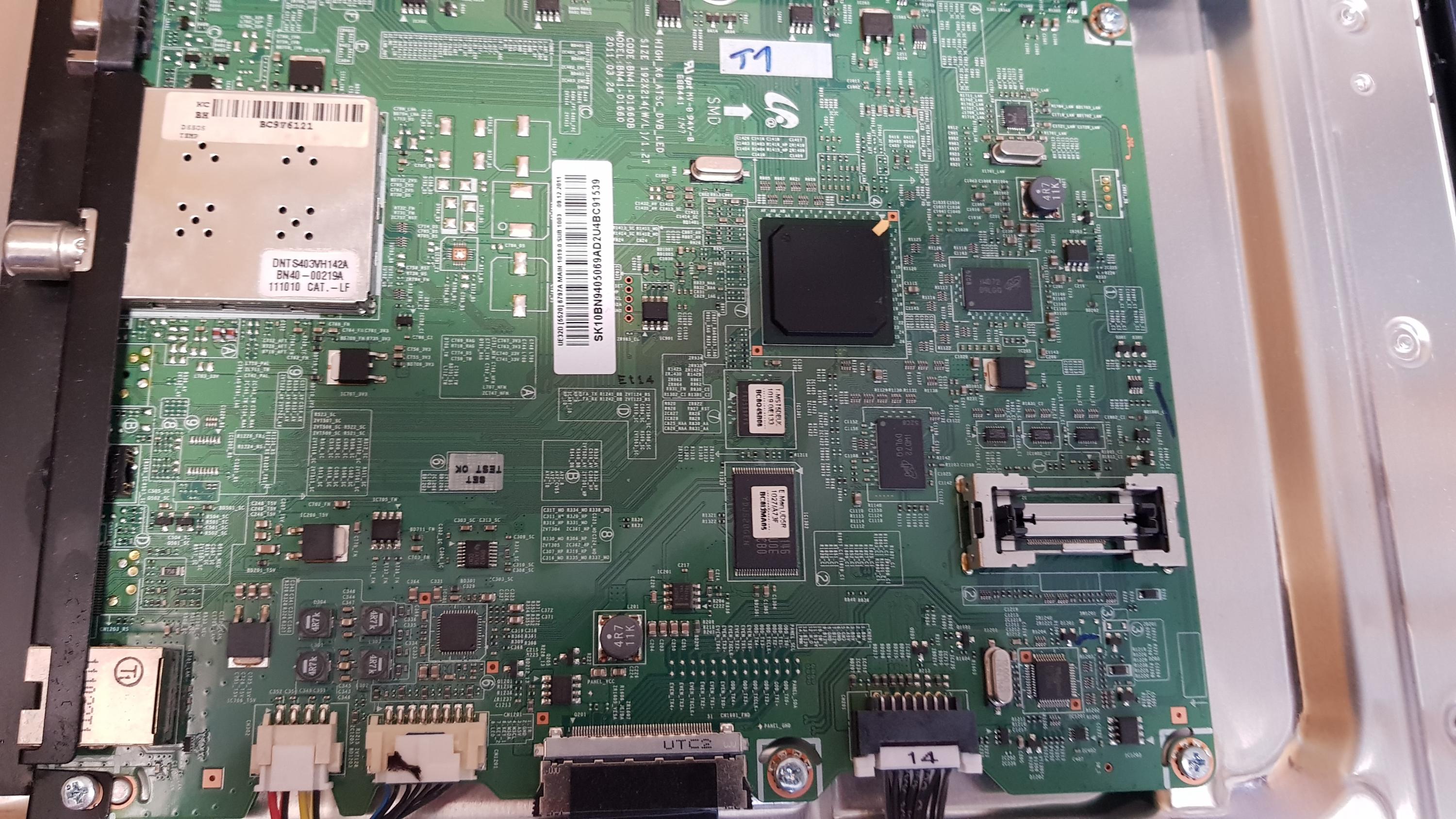

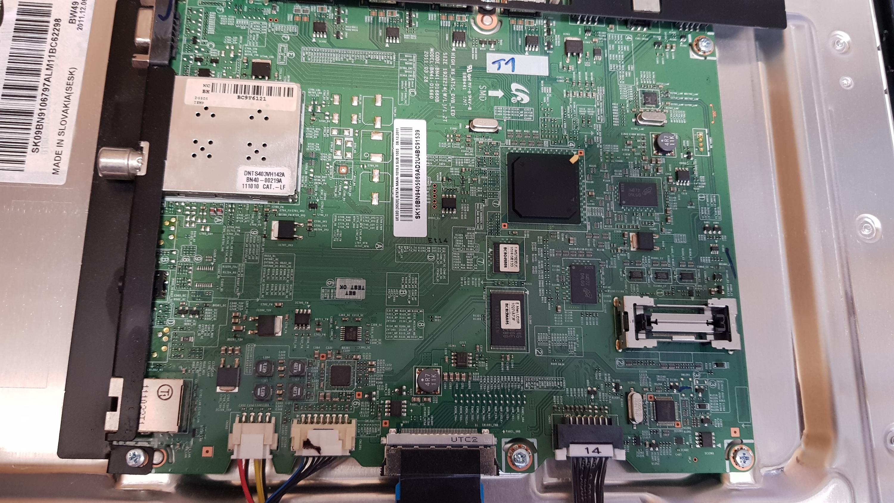

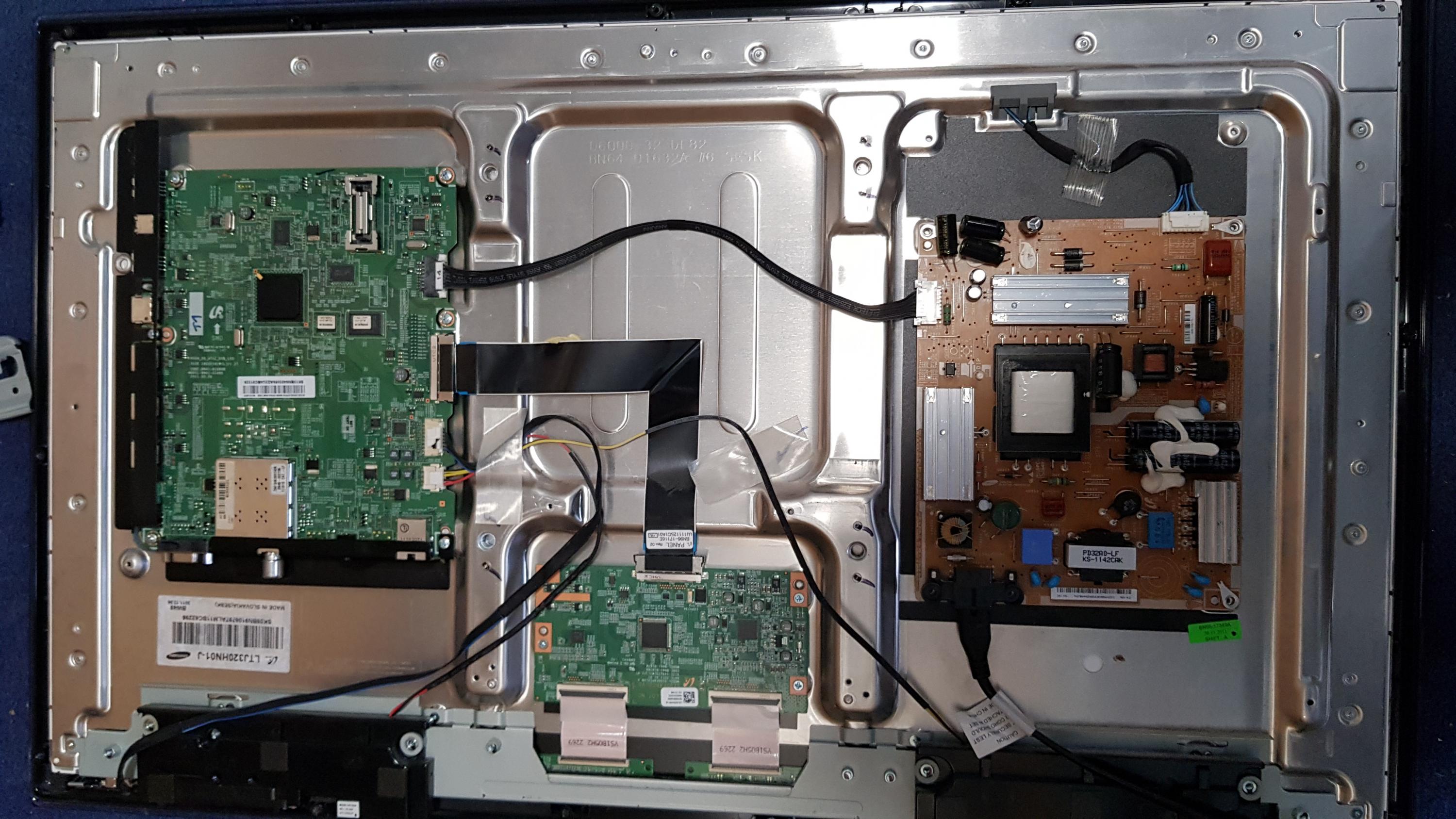

                    Thanks, I'm not sure what a Tcon board is. I have attached images below of the boards on the unit.
                    I wonder if this is a firmware issue that a lot of these smart tv's appear to suffer from.
                    Firmware file https://www.samsung.com/uk/support/m...E32D5520RKXXU/
                    Thanks for the suggestion, is it possible to install an update when the TV is powering on and off? I can't currently use the menu or settings as it won't stay on long enough to go that far.
                    • dick_barton
                      • Aug 2015
                      • 6642
                      • Wales
                      Picture 3 of 4 is your Tcon board
                        Thanks, can't see any lights flashing on the Tcon board.

                            • cheeky2
                              • Dec 2012
                              • 337
                              • uk
                              Nand failure of these boards is a common issue with the main board. You might if you are lucky freeze the nand and allow it to boot up then immeadiately update it with the firmware for it with usb stick. Make sure you have the usb memory stick fully prepared before freezing the nand. With luck you maybe able to get it going without replacing the nand on the main board. Main boards for it will be expensive as they regularly fail and need to be replaced!

                                    • diif
                                      • Feb 2014
                                      • 6978
                                      • England
                                      The K9GAG08U0E has bad blocks. This model suffers from it.
                                      It requires a new NAND, they are available pre programmed for around £20.
