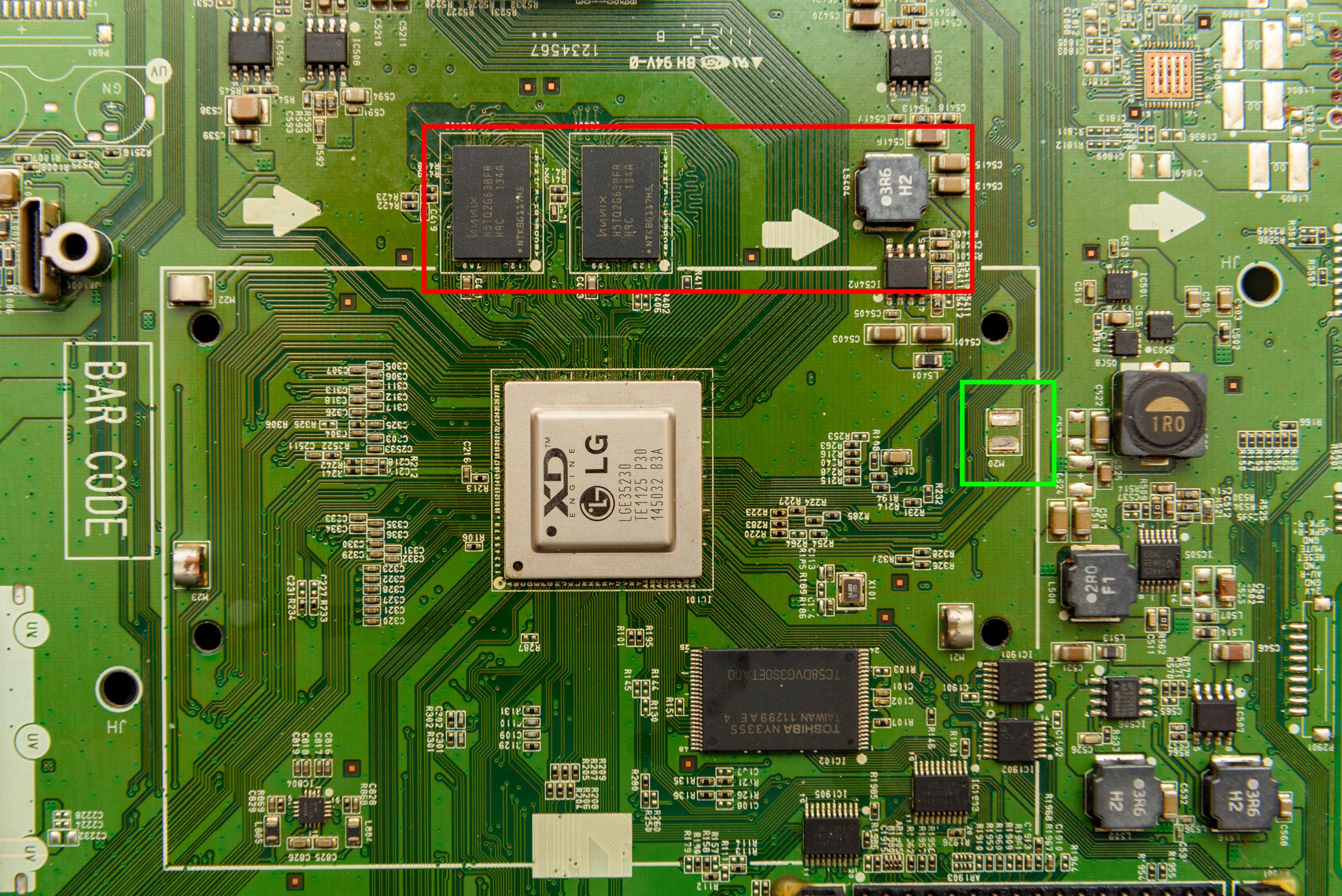

    Anyway, I decided to look myself. I turned on via remote and as before the power LED goes off.
    I can hear a very faint ticking noise and using a audio field recorder to monitor the sound, I've sort of narrowed it down to the area highlighted in the red box (Image attached).
    When I took the image, as I was editing it I also noticed something odd.
    The box I highlighted in green, seems like a component missing?
    Can anyone guide me or have experience with these TV's.
    Thank you

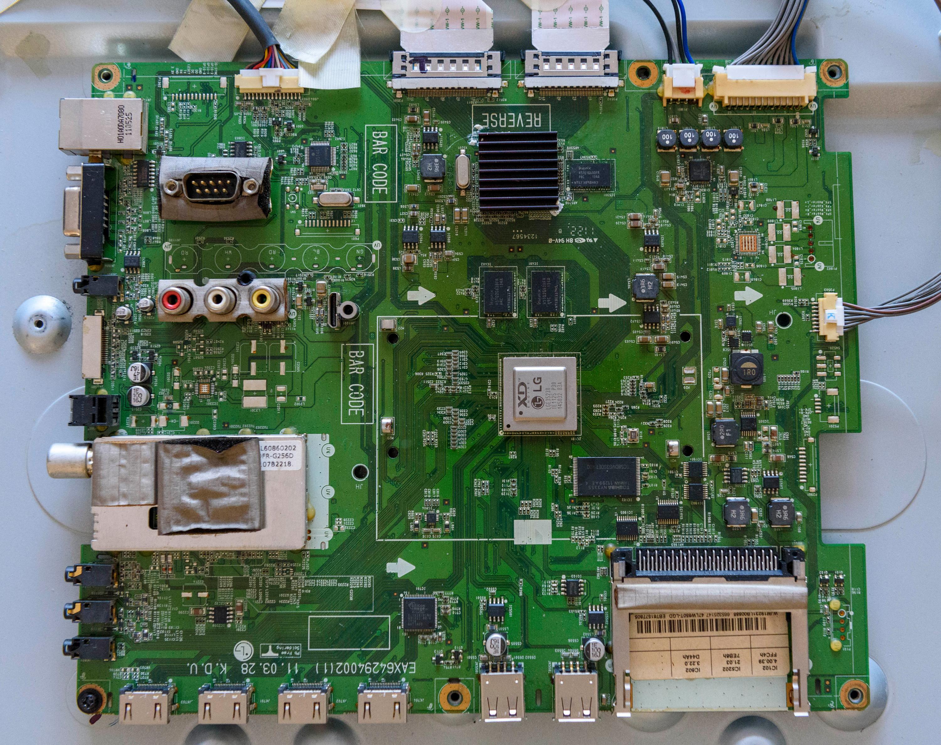

    upload complete photo of yours mainboards
    BTW : did you see if there are sign on the mainboards after you turn it on... if there optical audio output -- its led lid on... or if you insert USB drive if the led of the usb drive blinked ??

      Well you're at least missing the heatsink that covers those chips, did you get it back? there's good pictures of the boards there if you click the image, the heatsink covers that area you refer to tho: https://spares2repair.co.uk/sound-vi...av/lg/42lw650t
        heatsink yea but i dont think there parts missing..

          Probably not, seems that if you look real close you would see signs of solder if there was anything ever there.

            The missing part at M20 is the same part M22, M23, (metal loop), they are used to keep the heatsink away from the board, I suspect someone removed it when they tried to re-heat the ic's, there does look like some flux residue around ic101

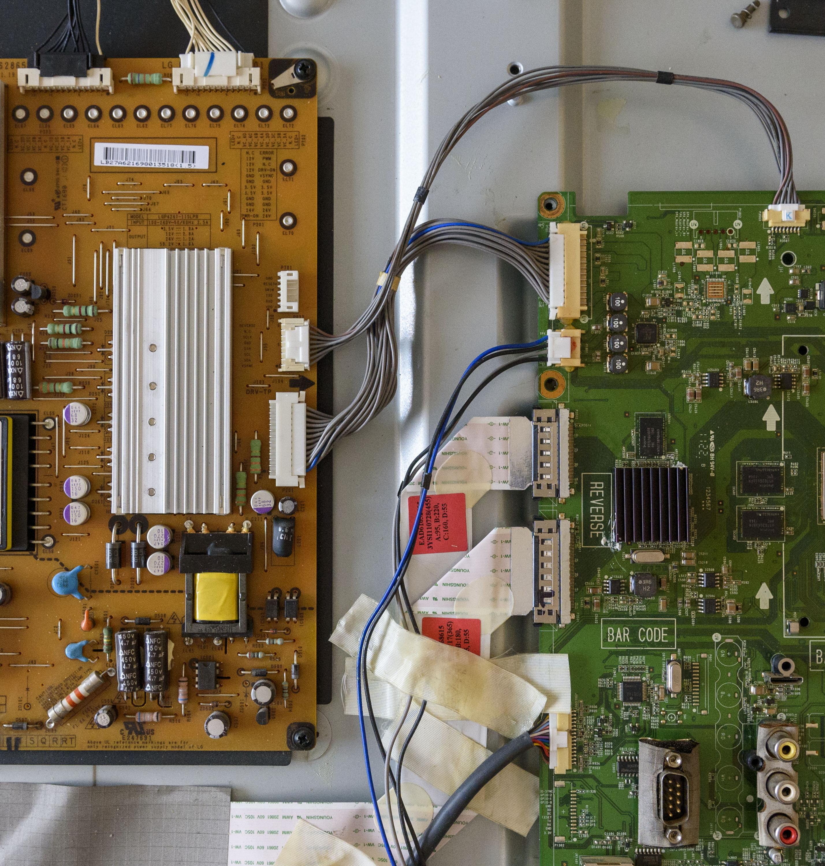

              Good suggestions. There is no light from the Toslink port and plugging in a USB flash drive, it's indicator light does not flash. I also tried the USB drive whilst plugged in before turning on. Nothing.
              I have uploaded images of the two main boards.
              I had taken off the heatsink myself, to check where the sound was coming from and see if the CPU gets warm, very slight only.
              Indeed you are right, just some sponge type pads that sit underneath heatsink as per other part designations.

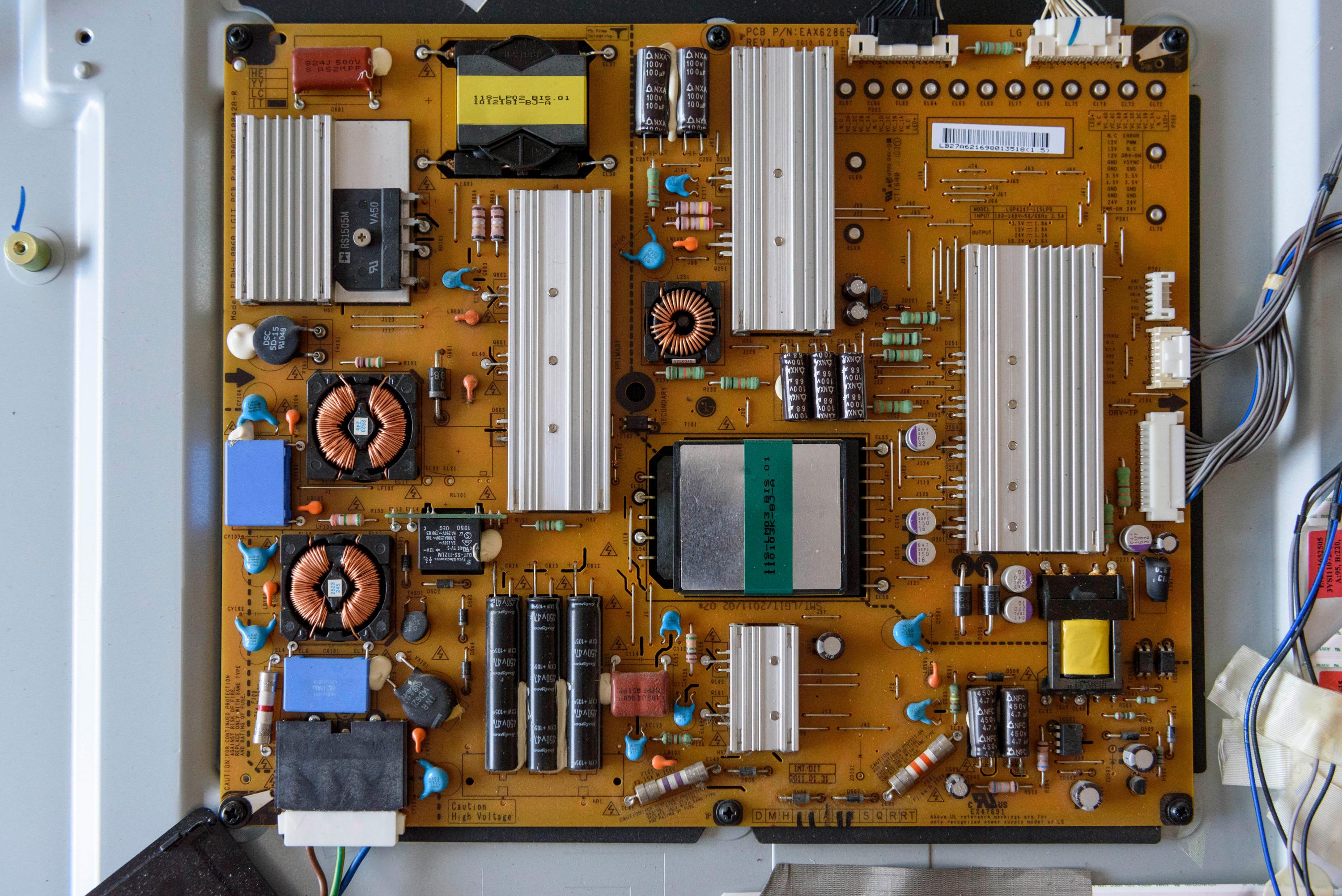

                Re: LG TV turn off/on also ticking noise
                now we need some measurements on the sockets at powerboards which it goes to mainboards.. turn on the set ( did it response to RC to power on?? ) while the set on and during the time front led indicator blinking measure the 12 & 24V on the sockets if it exist and remain. if you have missing one of above Voltage. then you need to disconnect the mainboards totally from powerboards, locate on the sockets this pins to make jumpers ( to run powerboards as stand alone )
                3.5V and PWR-ON
                3.5V and DRV-ON
                with this 2 jumpers in place you should have 12 & 24V on the same sockets.
                • TheDragon
                  • Feb 2011
                  • 69
                  • UK - 230 v
                  Plugging in, all 3.5v rails are fine
                  Turning on via RC:
                  12v rails read 11.8v
                  24v rails read 24.1v
                  3.5v rails read 3.5v as before.
                  So far so good? (12v rails being 11.8v)

                                      good mode you did indeed..
                                      yours mainboards sound no communication between NAND and main IC.
                                      you need to buy mainboards at any way. or you can throw yours MB complete in oven ( not with air ) for round 10 minutes who knows it could give others sign what you are missing now
