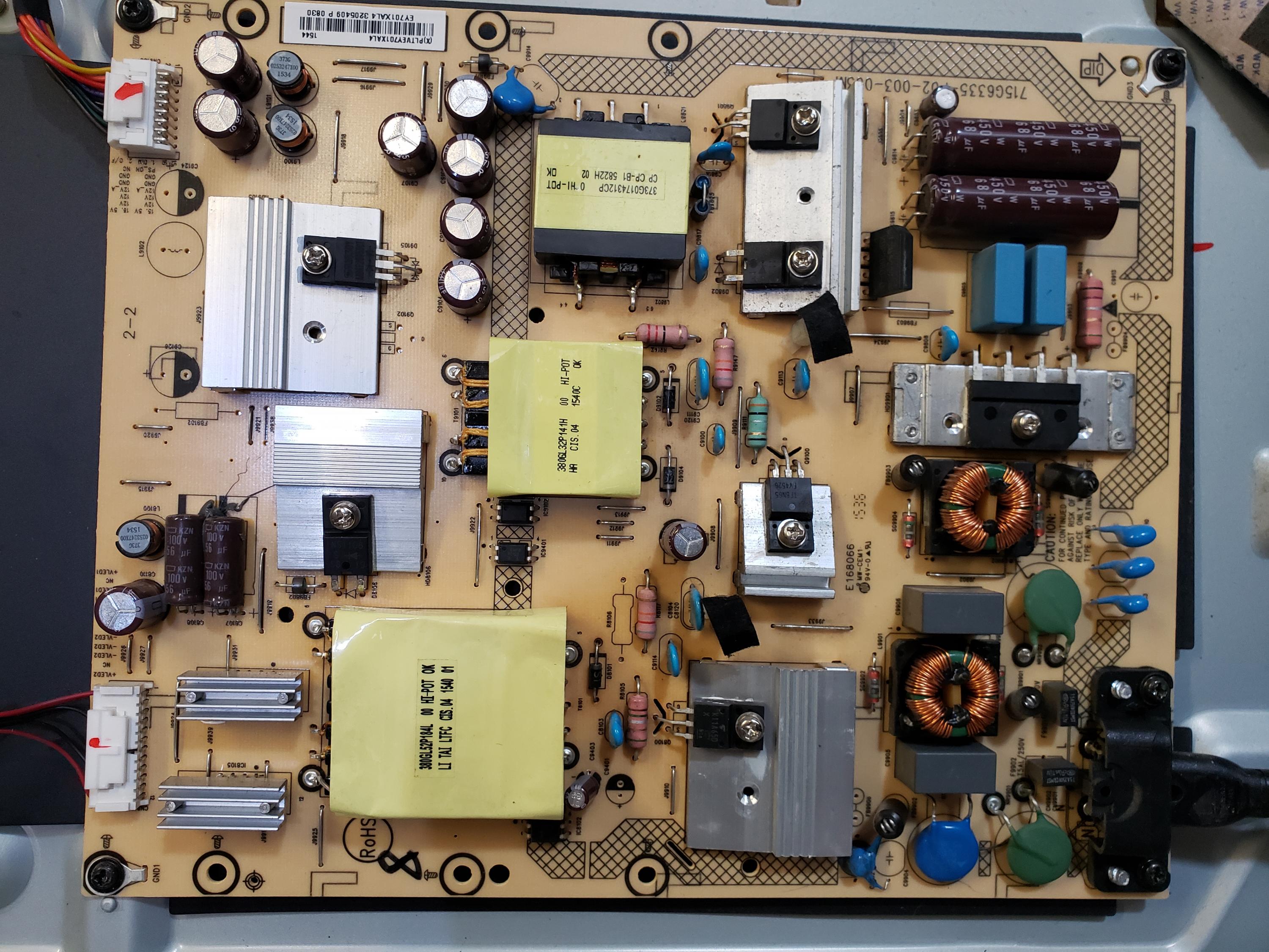

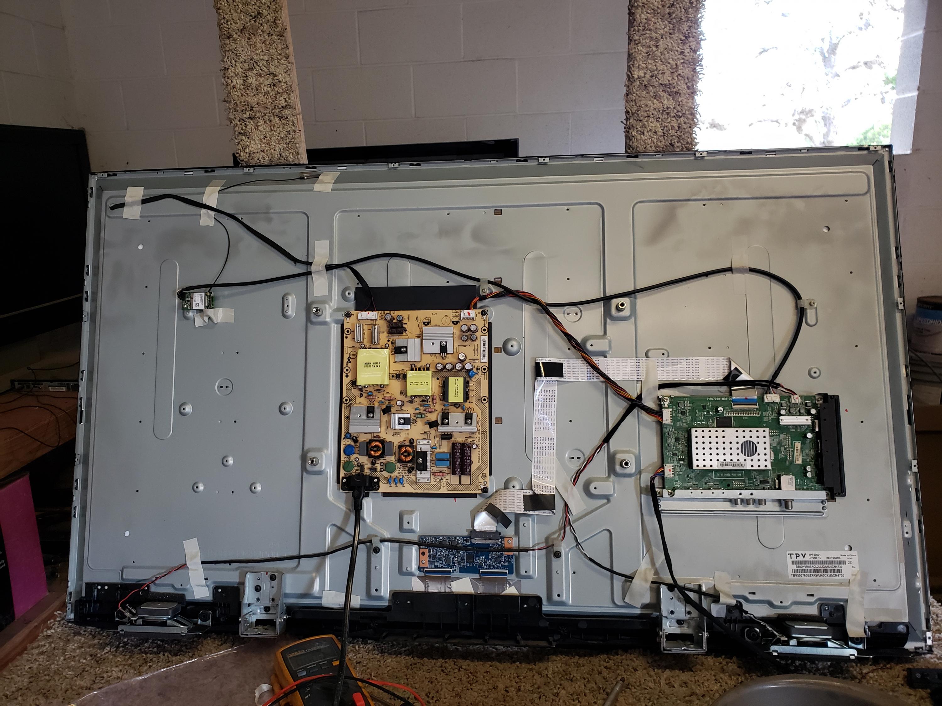

    When power is applied, red LED comes on bright, then dim, then flashes slowly.
    If I push the power button, the flashing will stop and LED will remain lit. If I push power again it makes a clunk audio sound and LED is off. DIM pin on smps changes from 2.4v to 3.3 volts. PS ON has continuous 3.3 volts if set is plugged in. Pins 15 and 16 measure 0 volts in all states of operation. All pins marked 12V do have 12 volts and GND pins are grounded. At no time does backlight come on. I did find 3.3 volts and 12 volts on the TCON when set was in what I think is ON state.

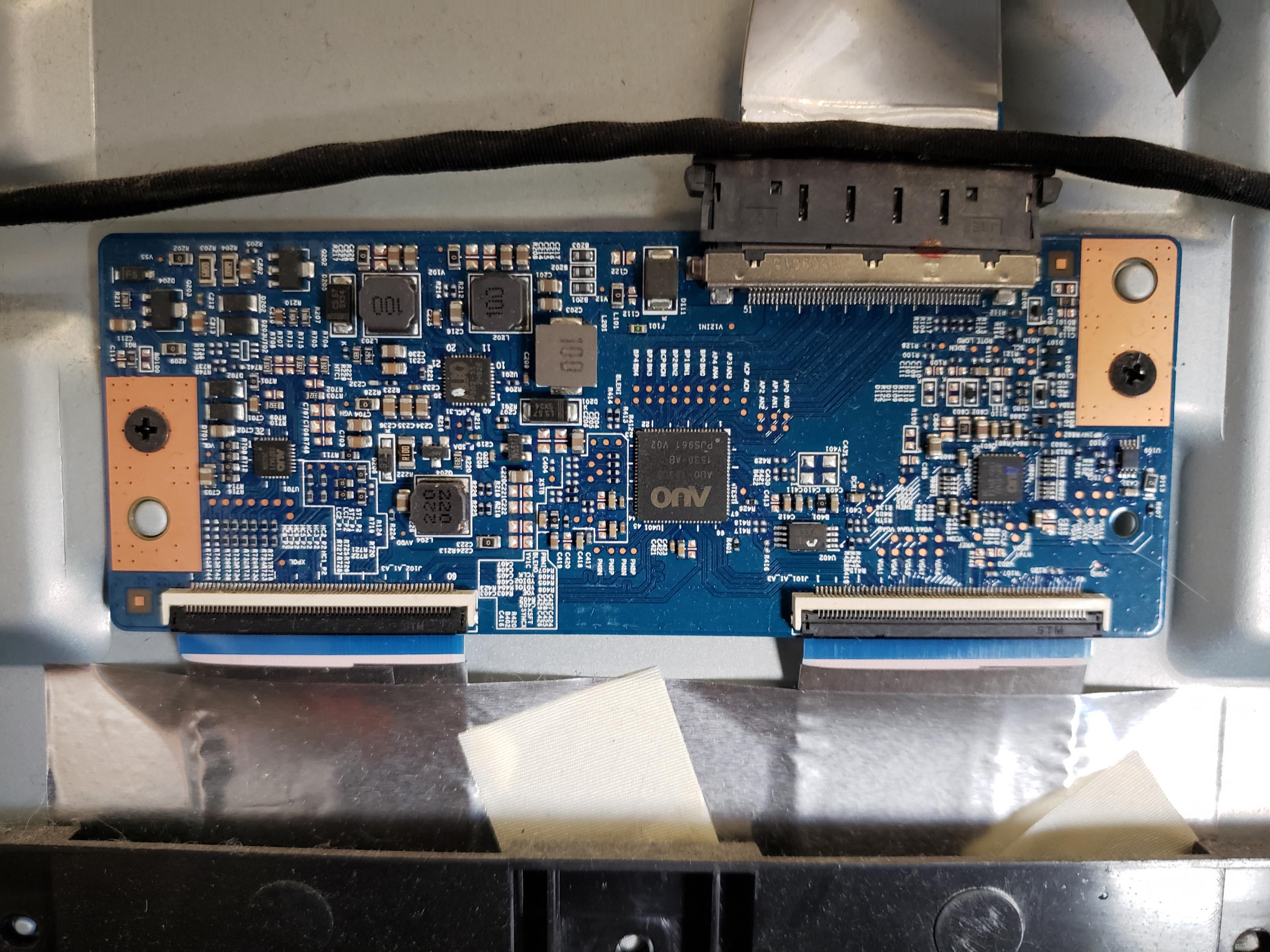

    Here is TCon. Sorry I left it out.

      This Sharp series is notorius for bad leds. Do flashlight test or check leds with a tester.

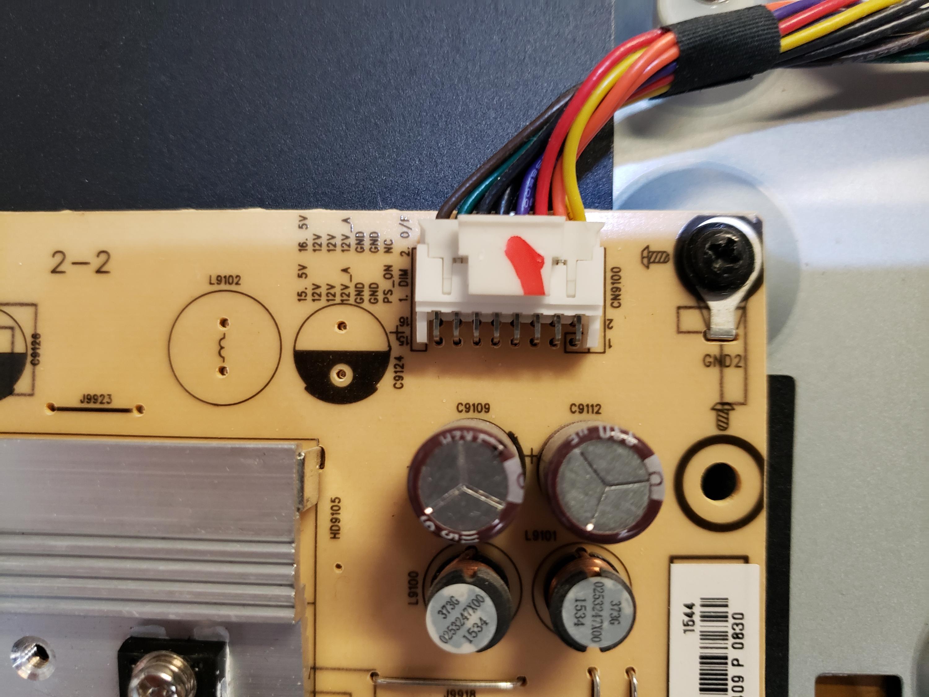

          Re: Sharp LC-50LB371U
          How about Voltage on pin 2 O/F (BL-ON)?

            Pin 1 = 2.4V, Pin 2= 3.3V
            Flashlight test shows getting started screen.
            V+LED1 = 65V to chassis, V+LED2 = 65V to chassis. V+LED1 = 0V to V-LED1, V+LED2 = 0V to V-LED2.
            LED1 circuit = OL, LED2 circuit = 2.3Mohms
            I think the LEDs are shot!
