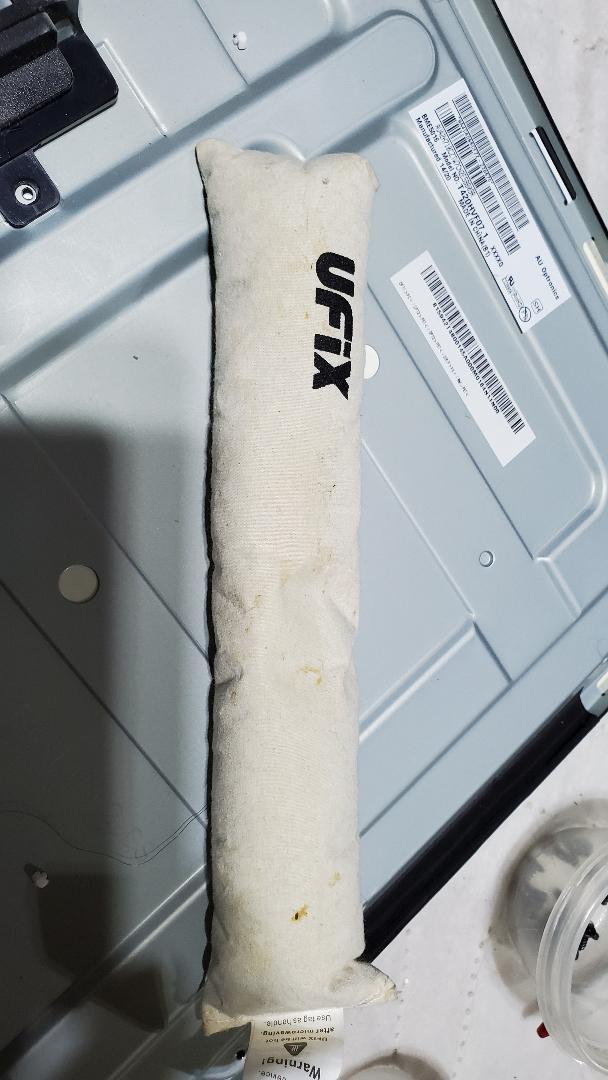

          • brucetv
            • May 2015
            • 281
            • united states
            Re: Removing screens
            One of the safest ways I have found is to heat a Ufix bean bag up in the microwave for about 1-2 minutes and lay it on top of the panel where the adhesive is for about 3-4 minutes and slide a plastic playing card carefully underneath the panel and once it starts to slice through the adhesive leave the card in place and go onto to the next section so have the whole deck of cards ready. If it's a bezeless design the adhesive will be all the way around or on 3 sides only depending on the model. On some models you will be able to see the white sections of adhesive barely sticking out like on some Sony's so you can see where to apply safe heat to loosen the adhesive. You can get the Ufix bean bags at cell phone repair supplier's or shops or try Ebay. Good luck
